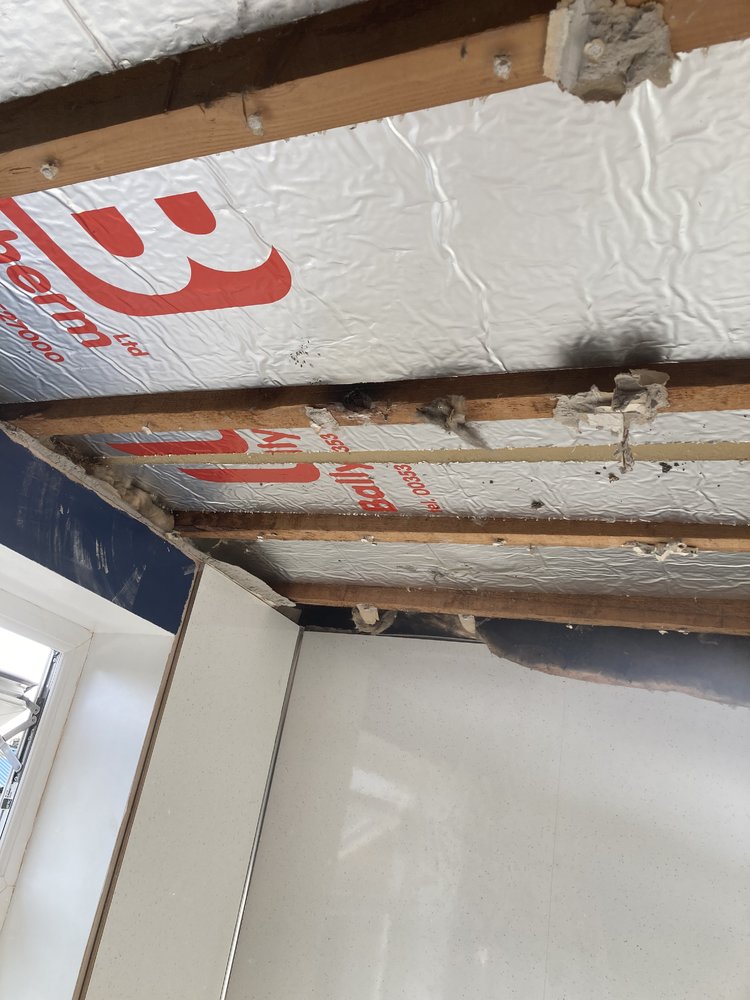

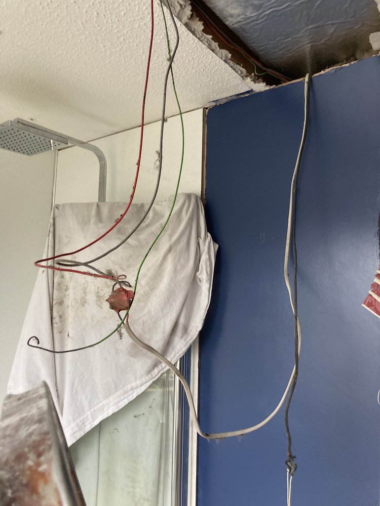

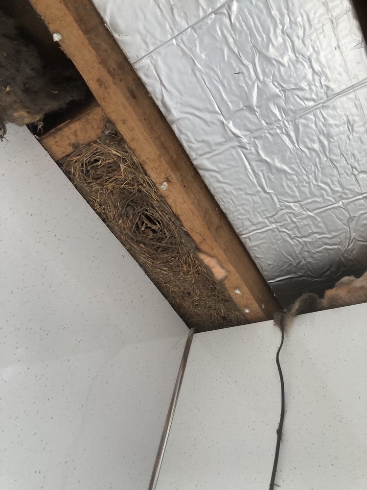

Looks like your classic DIY job!what the f is going on here View attachment 371604

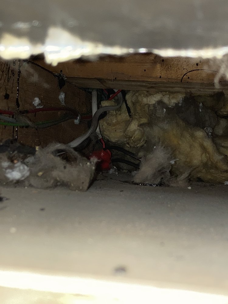

I’ve already terminated the old electric shower feed in the attic so not sure…..I'd keep hacking it out until you find the old rose! It's hard to tell from the picture but could those singles be an old electric shower feed? They look to big for 1.5mm T&E.

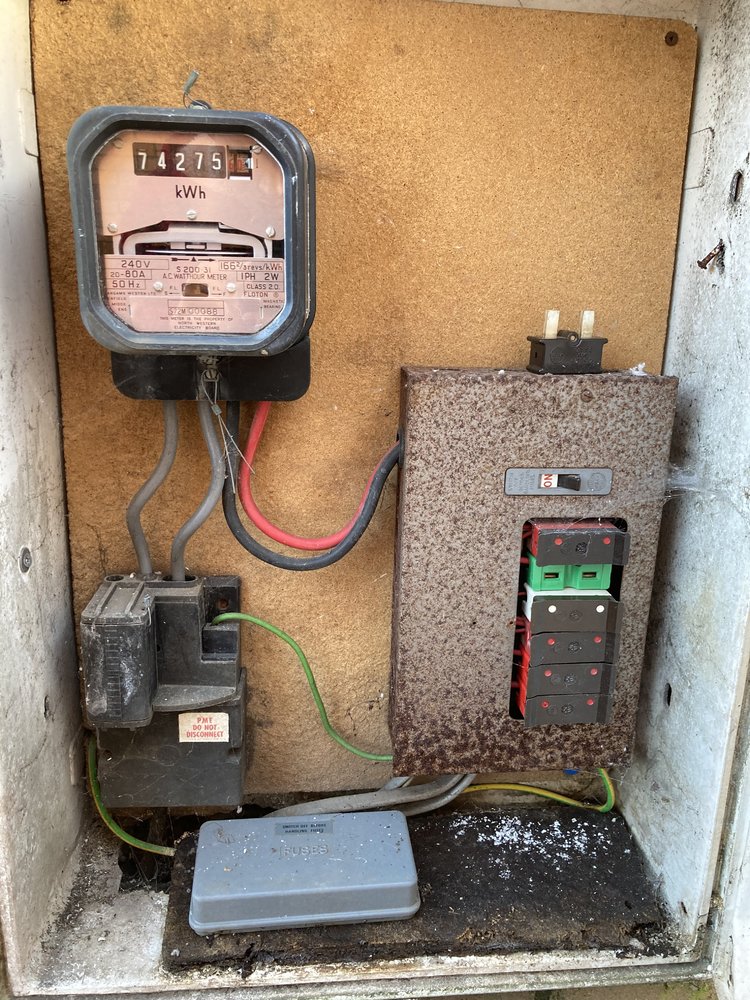

yeah been thinking about that, need a new consumer unit n all, would it make a difference if i do the EICR before or after i get a new consumer unit?Based on that it looks like an EICR would be a good shout?

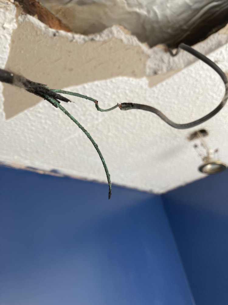

that’s what i thought, the insulation was all charred too!How the hell did that not catch fire?
for reference this is what i’m working with atm
