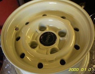

As I mentioned earlier, it's primarily about the look. In the mini world, rally replicas use steel wheels, group 5 flares, rear spot lights etc. It's what I have planned for my MkII mini. There are alloy wheels which ape the Cooper reverse rims, but they have a really scary offset as they enable you to run standard mini 8.4" disks with a 10" rim. The wheels sit outside the brake disks. Your wheel bearings would last maybe 500 miles?

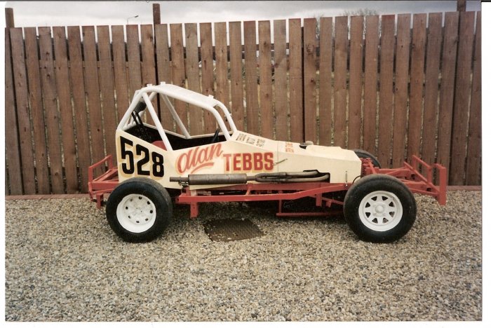

tack welded them together checked for run out . if all was corect weld away a clean up with angle grinder job done .they are allways used on the rear of stockcars but standard rims are used on the front as for road cars . wide wheels are ok on dry tarmac great .narrower wheels are better and safer in the wet as they will cut through the water better
its not a good idea to have wide wheels on the front steering stub axles as its hard on the steering and bearings . the only other issue as has been said tell the insurance company as its a good cop out for not paying out . heres an old piccy of banded wheel on stockcar
