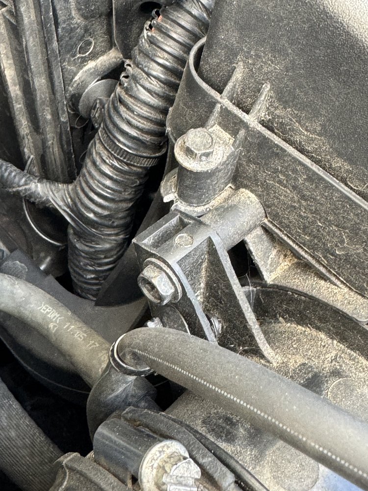

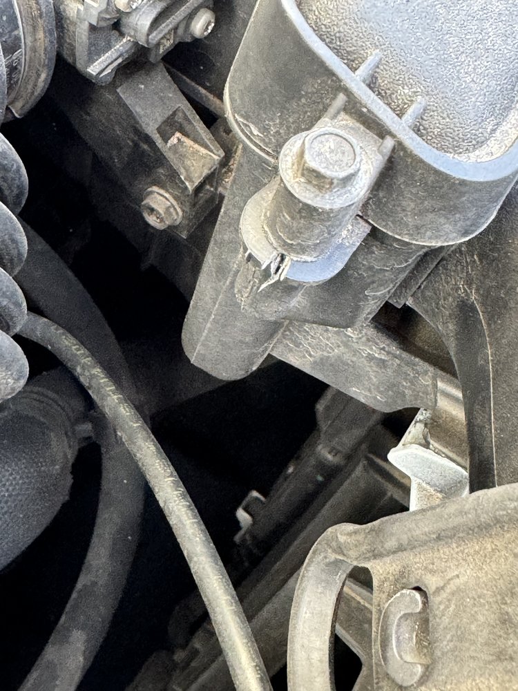

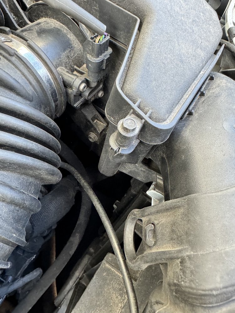

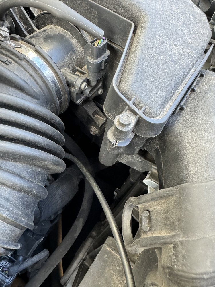

I love my Ford Ranger but the customer care and service at Ford was so shocking, I vowed I would never buy a Ford again.Found more "professionals" handiwork.
This was either Allen Ford or Just Transits.
One of them has used an impact on the 7mm self tapping bolts on the airbox. Every single one is cracked.
Luckily it still pulls down tight.
View attachment 450913 View attachment 450914 View attachment 450915 View attachment 450916
It's knowing who done it Gaz. And proving it.id have videoed it myself and presented it at the ford place
before i hit them with shoddy practice and an intent to damage said vehicle air filter damaged by use of ratchet gun failure to maintain vehicle to exceptable standared with due care and diligence
i would bet the bearings have lost a fair bit of their lifespanYes not good.
Hopefully no damage occured to the box.
