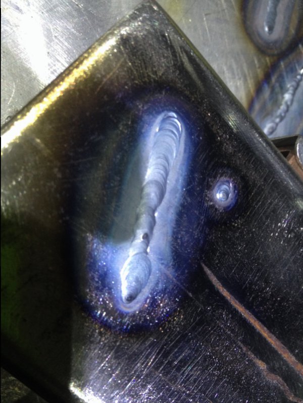

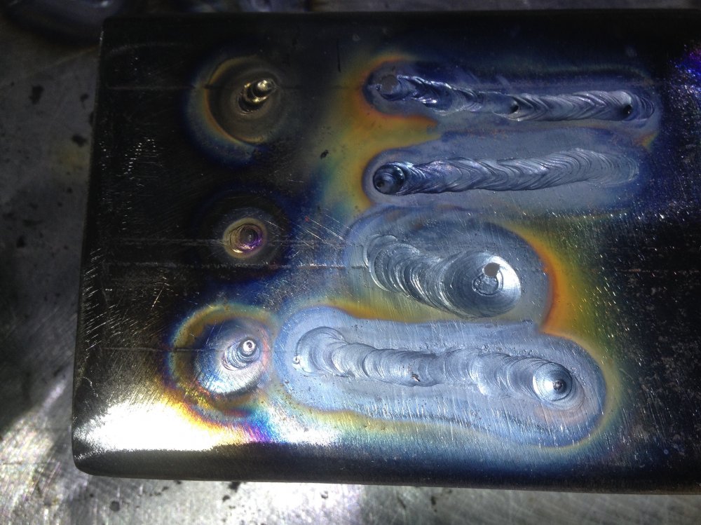

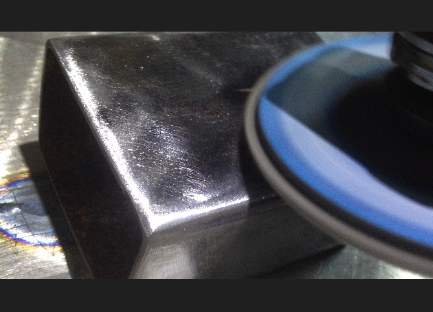

Ok I've just done the spot test exactly as Pauls link suggests identical settings etc..
I've added photos to show the results..
The steel was cleaned via a flap wheel and then cleaned via acetone..
Spot tests as per link.. @60amps
Below.,Next.. Short beads again as per link settings 1.6 mm tungsten..no filler rod.. Gas same @6
amps 60...
The upper right 2 beads = settings as described above but with a 5mm stick out.. No filler..
The third one down.. Now with er70S rod and 2mm stick out.. Gas @6 amps now at 90amps..
Bottom bead was with a 5 mm stick out Gas @ 6 and 90amps with er70s rod..
Both wobbly but as tight to the work as I could go!

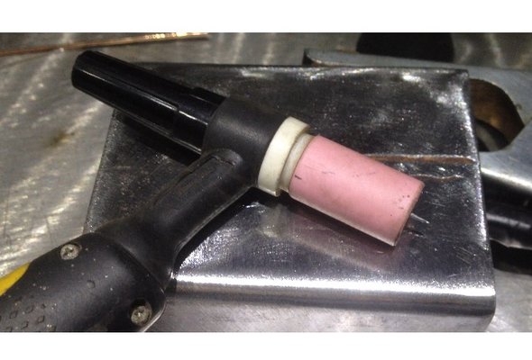

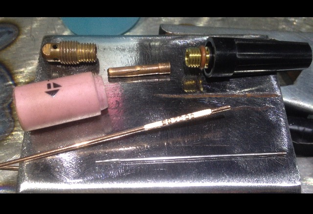

Above my tig torch set up.. With Sif ER70S rod supplied by Elmdale ..no 7 ceramic..
Pure Tungsten fired and pea shooter attached showing gas reading at torch head.. Reg was set to a flow of 6..

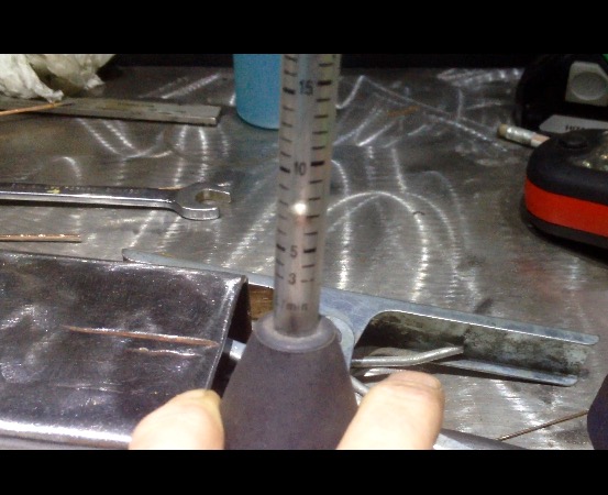

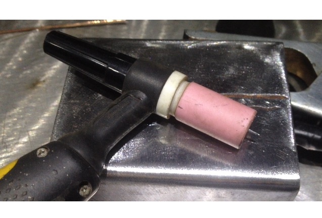

Last pic..
Same settings again 6 for the gas.. 90amps and 5 mm stick out.. Same rod..
Torch set with 5mm stick out..
One thing I did notice was my tungsten although I didn't stick it! Soon got cruddy at 2mm setting.. At 5 mm it stayed cleaner..
Was going to show my technique via video, unfortunately only got one helmet so couldn't cut out the UV on the camera..
Any questions... Fire away..
