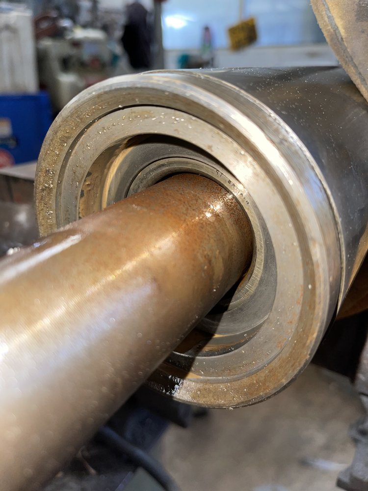

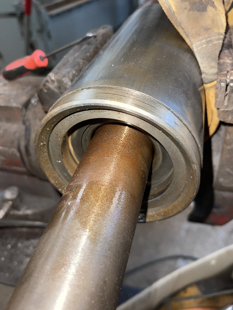

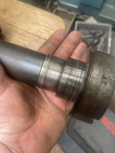

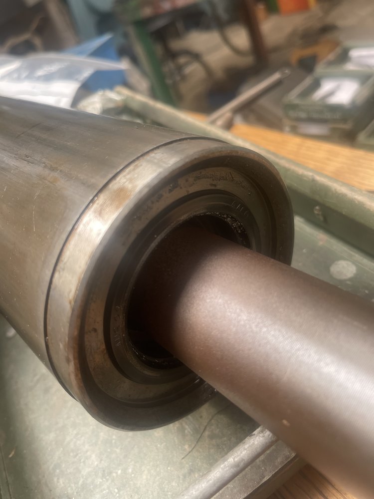

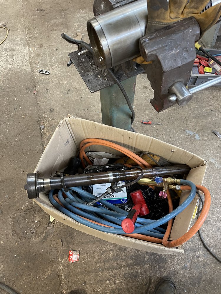

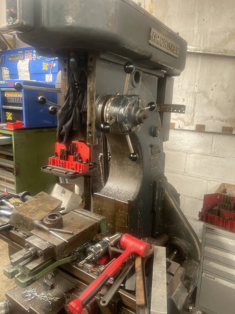

Nice to see the thread back on topicUsing the mill and found it was getting harder to engage power feed.

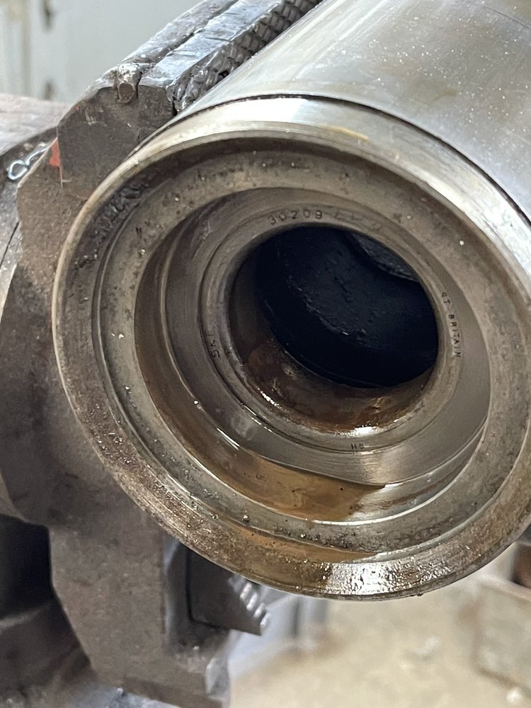

Bearing is behind this nose piece which I cannot figure out how to remove.
I've tried the strap wrench already, a lot clearer in the videoI wonder what options there are for its form of retention? To me, it is either screwed in or pressed in. What mitigates against the threaded option is there is no visible means of unscrewing it. Is any part of the outer bearing race visible if you look down the other end of the quill? Any notches in the outer race seat to allow a drift? Maybe the safest way to proceeed is to assume it is threaded and put a strap wrench on it and try to rotate it. If it turns and unscrews, great. If it turns but does not unscrew, then it is likely a press fit but with little thought given to disassembly without harming the bearing. Original factory assembly would be OK as nothing would push on the inner bearing race going in.
Potentially, make a clamp that goes around it (bore out a piece of plate the exact diameter of the nose piece, cross drill for a clamping bolt, slit with a hacksaw). Clamp it on tight and then you have something to hammer on or press against. As the quill is a lot longer than the nose piece, a similar clamp made of wood, say 2" thick, would probably work OK there.

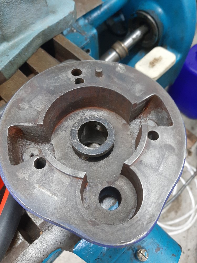

Do you mean rotational axis of the spindle or linear z travel of the quill?So its just a transmissoion? I thought it was used to fix the spindle in position....

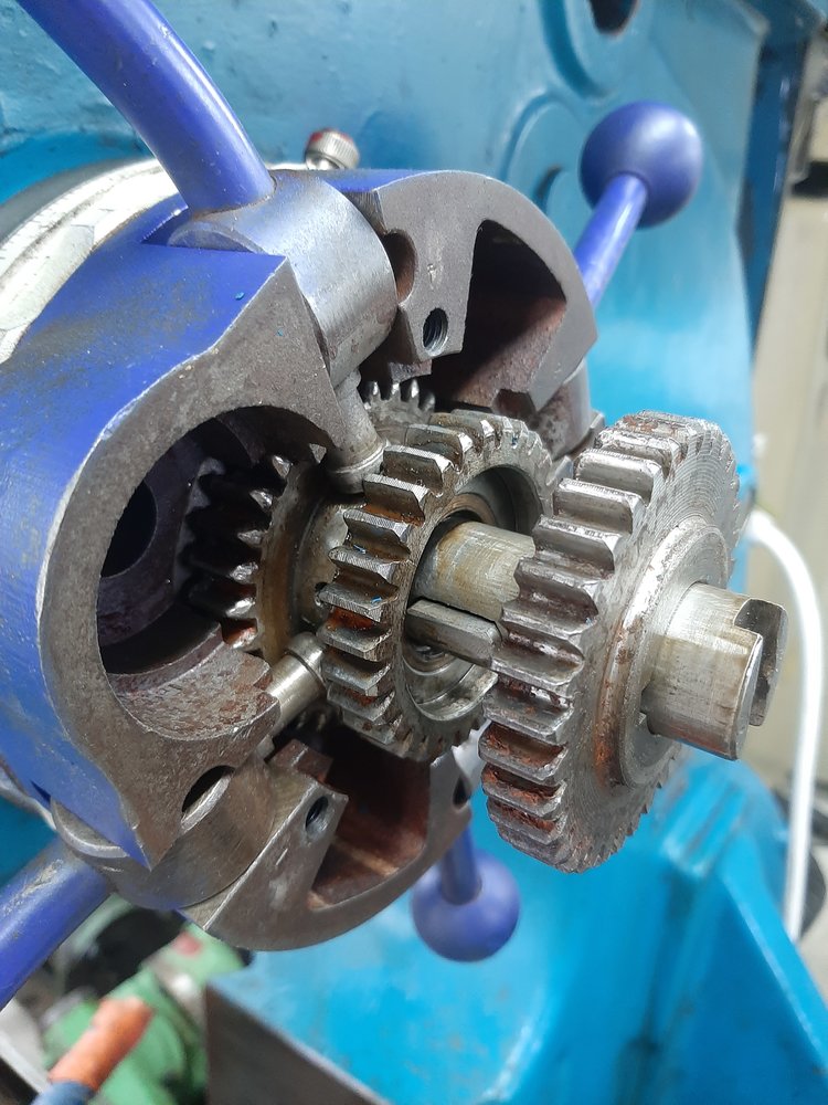

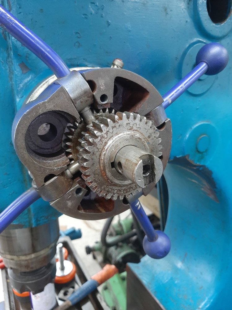

Obviously a countershaft and pair of gears missing there??Hello brad,

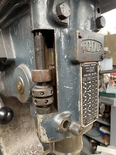

I saw that you also have an Archdale milling machine. I also just bought one, but mine is missing some parts... If you could help me find out what the missing parts are, I would be very grateful.
I think two wheels or axles are missing for the handwheel drive, I don't know exactly, but I can't turn that part off to the right (I think this would fix the height of the main spindle). I took some pictures so you can see what I have...
Thanks in advance for your help.
best regards
Levente
