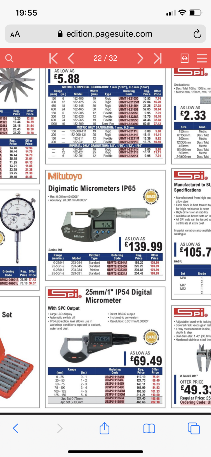

I can’t remember now. I think probably £200. Should be on offer this month. I gave £160 odd for the 1”.Any idea what the typical MSC offer price is for a 1-2" QuantuMike -

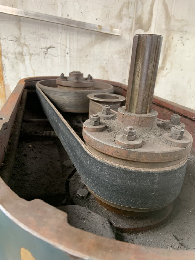

That spline drive for the spindle looks a bit dry should it have a bit of grease on it?

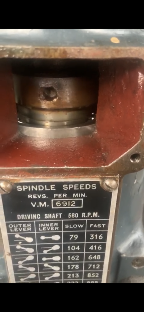

Unfortunately I think I need to do the bearings in the spindles on the mill.
Now I've got the hydraulic press, disassembly should be easier.
Not looking forward to seeing how much imperial taper roller bearings cost.
The problem is, someone has been in there, done the adjusting nut grub screws up so bloody tight, I need to strip the spindle to get in there and remove them. They've also used what looks to be a punch or chisel to preload the adjusting nut. It's a right mess.There is a good bit of slack in the spindle bearings on my Town Woodhouse - I will be adjusting them before stripping, might be lucky....
