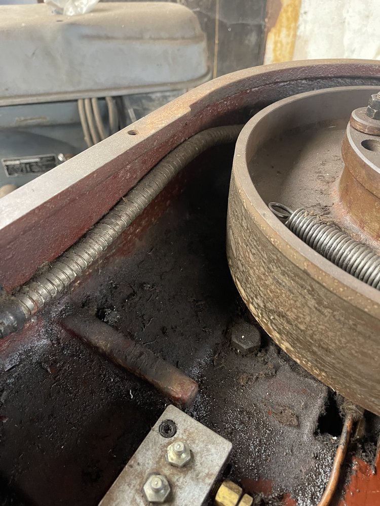

These things are built like brick turd houses. Doubt there will be much wrong with the pump, probably carp in the oil. Takes a very heavyweight oilI was thinking about the z-axis, yes, I found that clamp, but I thought there was some other structure in addition to the handwheel

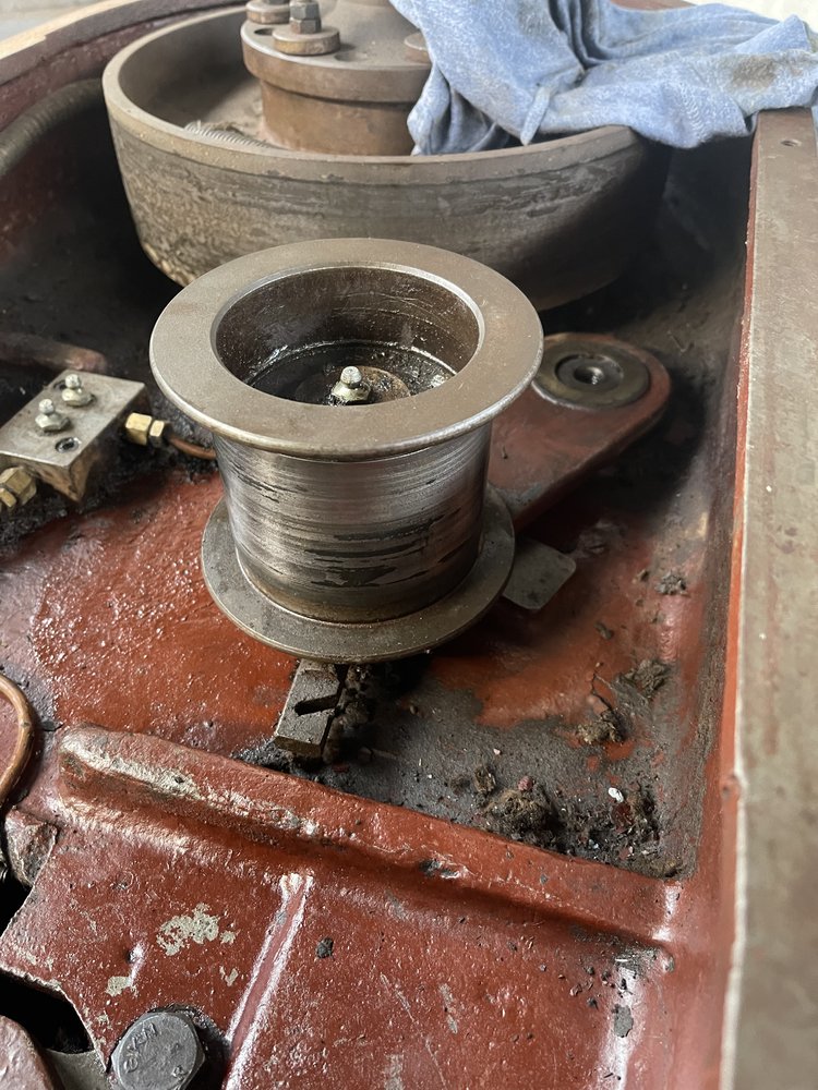

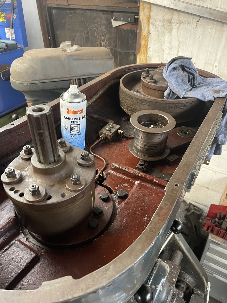

I'll take the cover off now to look at the pump.

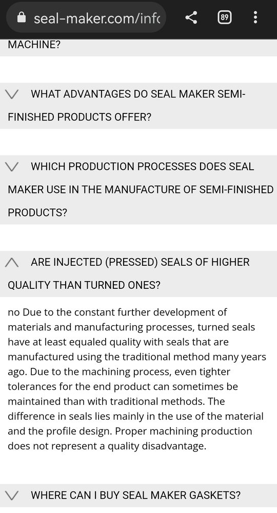

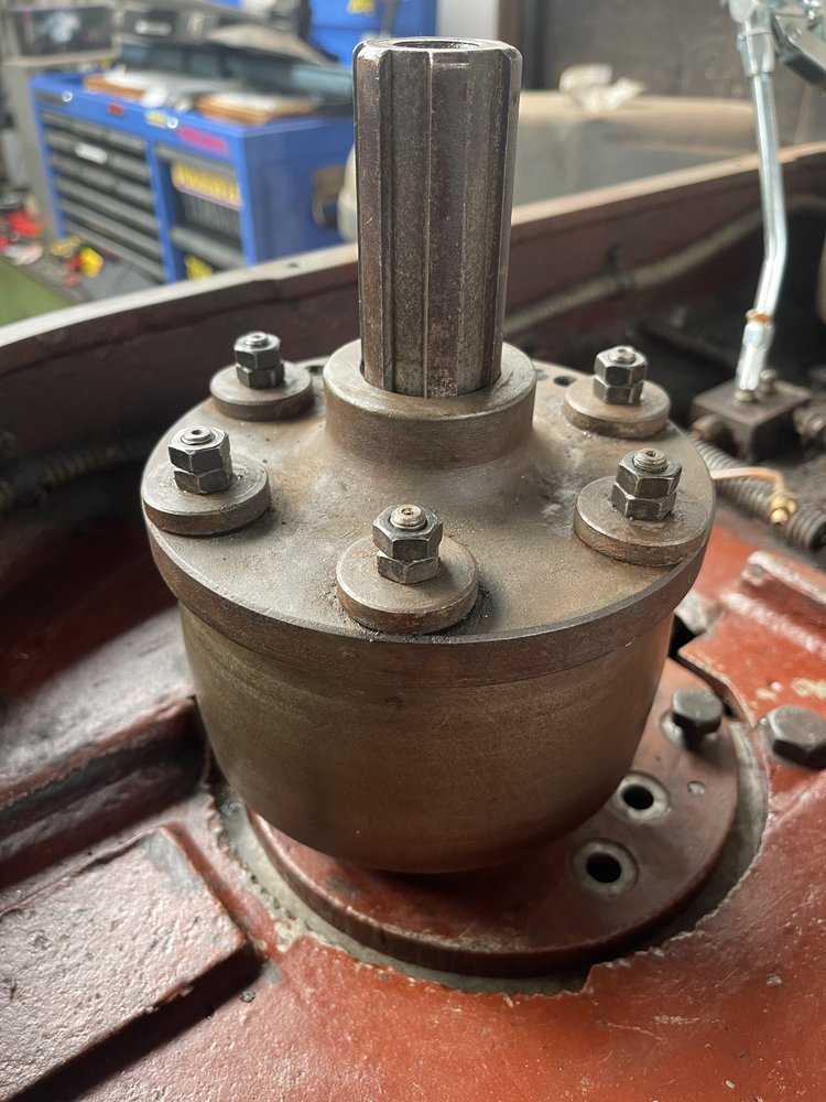

Order a CNC-machined oil seal, for example?Update on the spindle situation. Cannot find what oil seal this machine is meant to have.
Ideally it wants a 5/16" thick seal but no such thing seems to exist.
I need to strip the spindle again and see how the ⅜" seal was working before. Maybe it's been modified. Who knows. All I know is a new ⅜" thick seal rubs on the spindle.
I didn't even pay attention until now, but my machine is also missing the pumpThese things are built like brick turd houses. Doubt there will be much wrong with the pump, probably carp in the oil. Takes a very heavyweight oil
Can't be. The oil pump is internal. The coolant pump is external.I didn't even pay attention until now, but my machine is also missing the pump

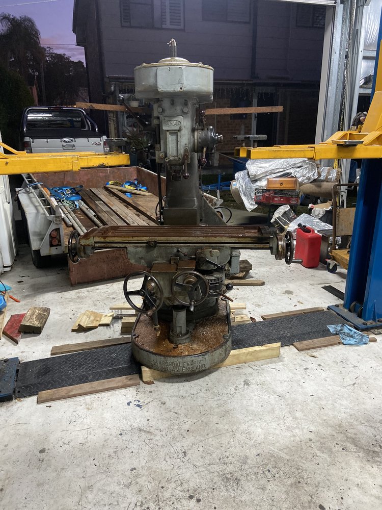

Yours is probably still an 18" vertical mill but not what they called the production model.Hi Brad thanks for your pictures and videos on this machine. I just purchased one and fixing it up. If possible could you please take a close up photo of the spindle speed plate as mine is missing. Also haven’t seen one like mine with handles on both ends of table. View attachment 364516

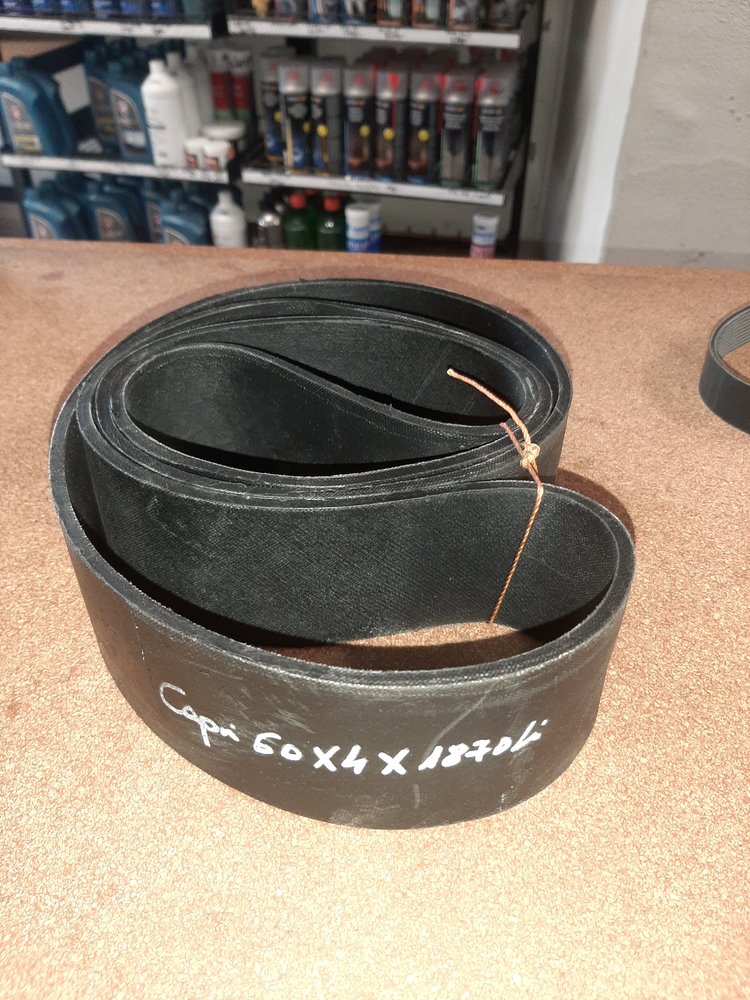

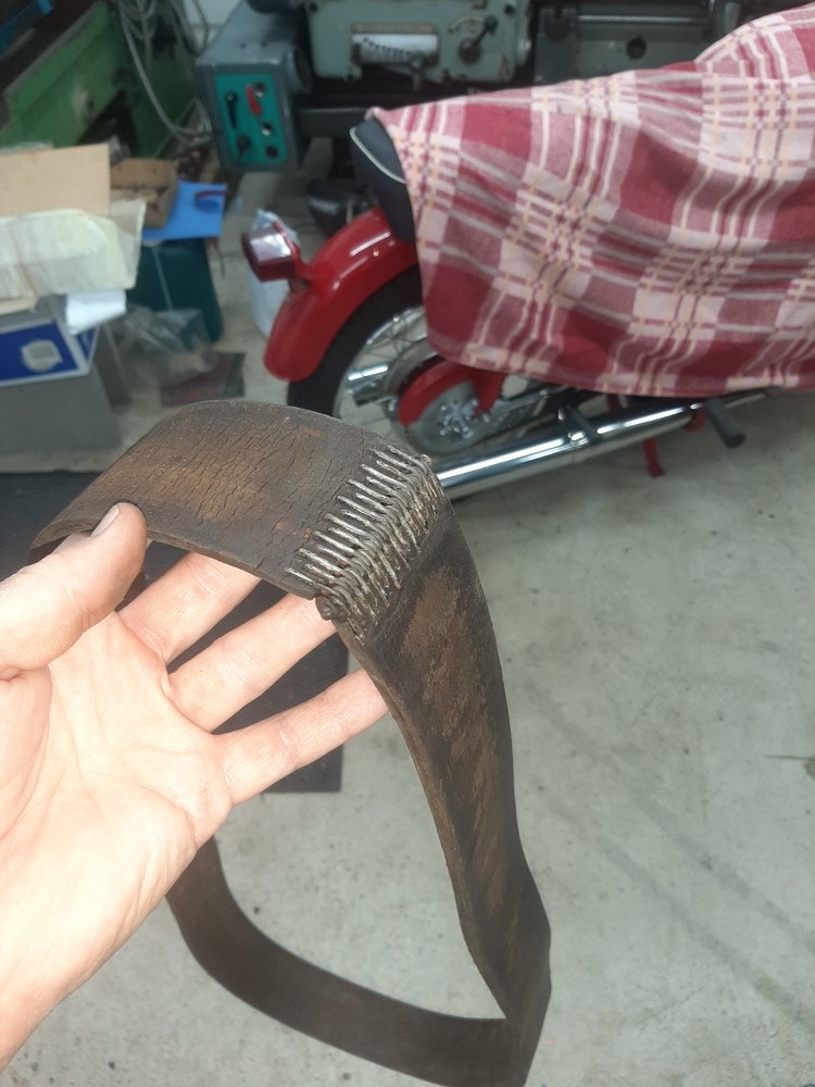

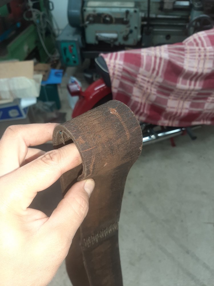

Where did you source the flat belt? Is it seamless? To be honest I was just going to go for a multi v beltlittle status report

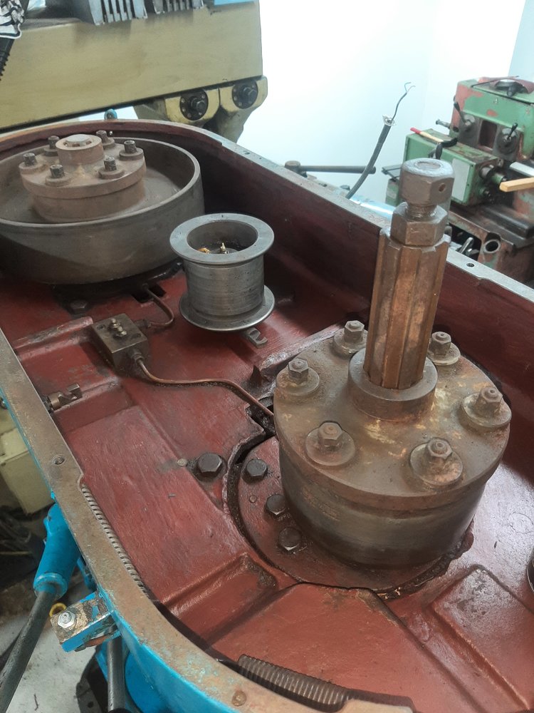

I changed the oils (the oil pump works)
I also cleaned the upper part, and it also got a new flat belt.
View attachment 365158 View attachment 365159 View attachment 365160 View attachment 365161
