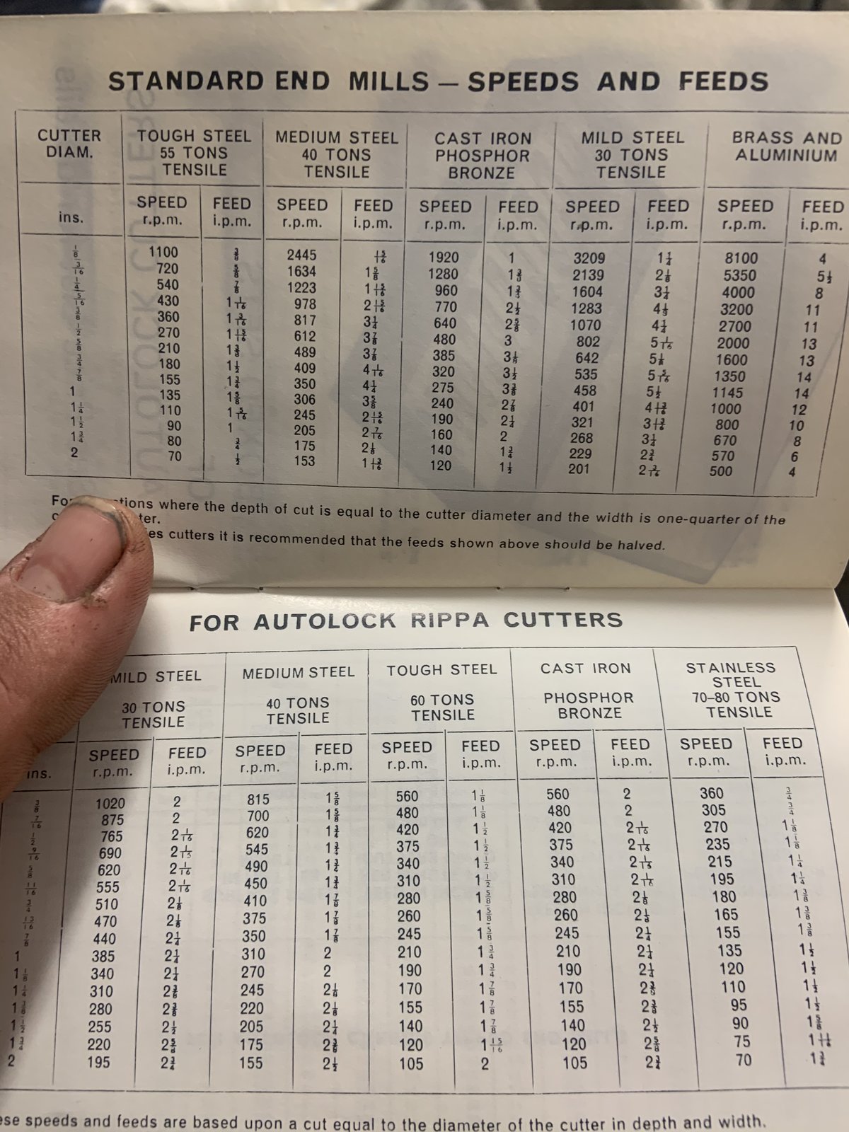

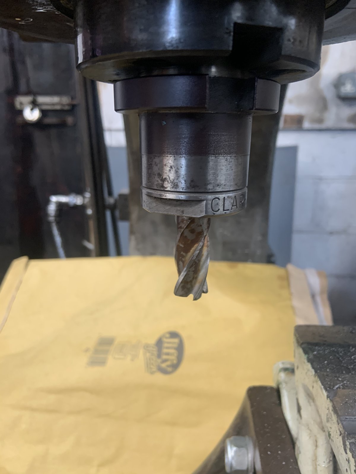

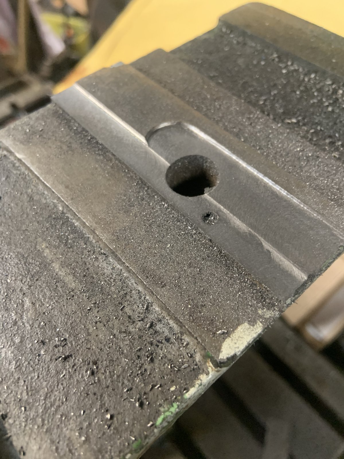

Dry.Were you cutting that dry or with coolant. Feeds and speeds are very critical with hss tools on mills
Cast iron should be machined dry.Get the lube going, but you know that.
I love learning, fair point.Cast iron should be machined dry.
search chip load calculatorLooking on my mill, the speed closest is 416RPM and I do have a feed rate that will get me close, 0.008” per rev, which would be 3.25” per minute of travel. Little bit fast but probably wouldn’t have burnt the tip up.
