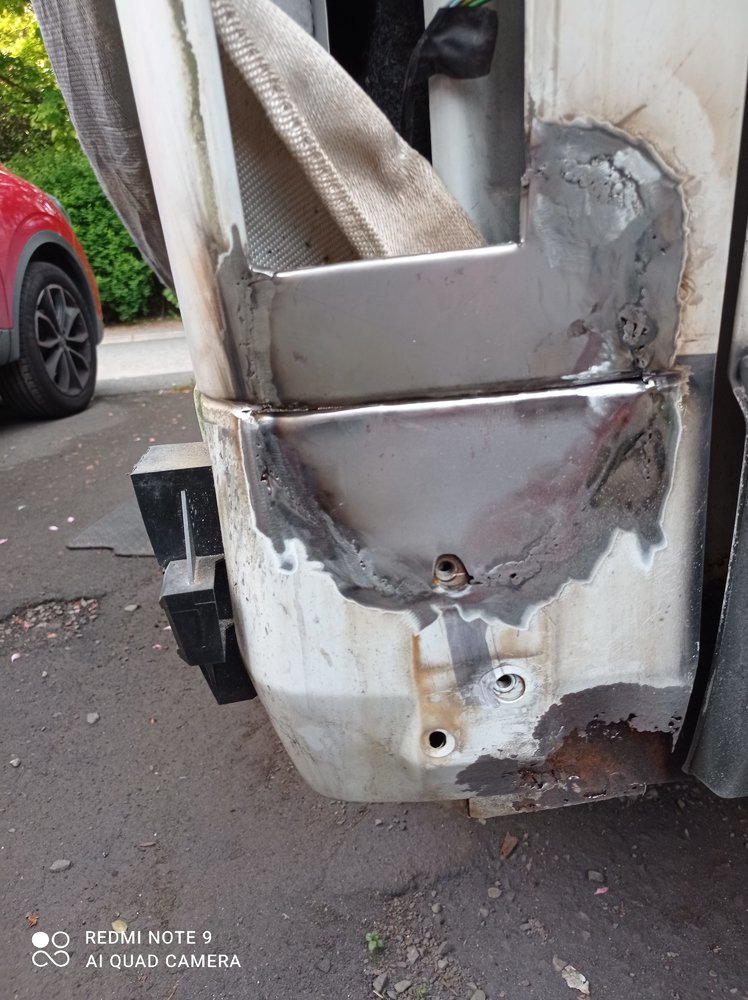

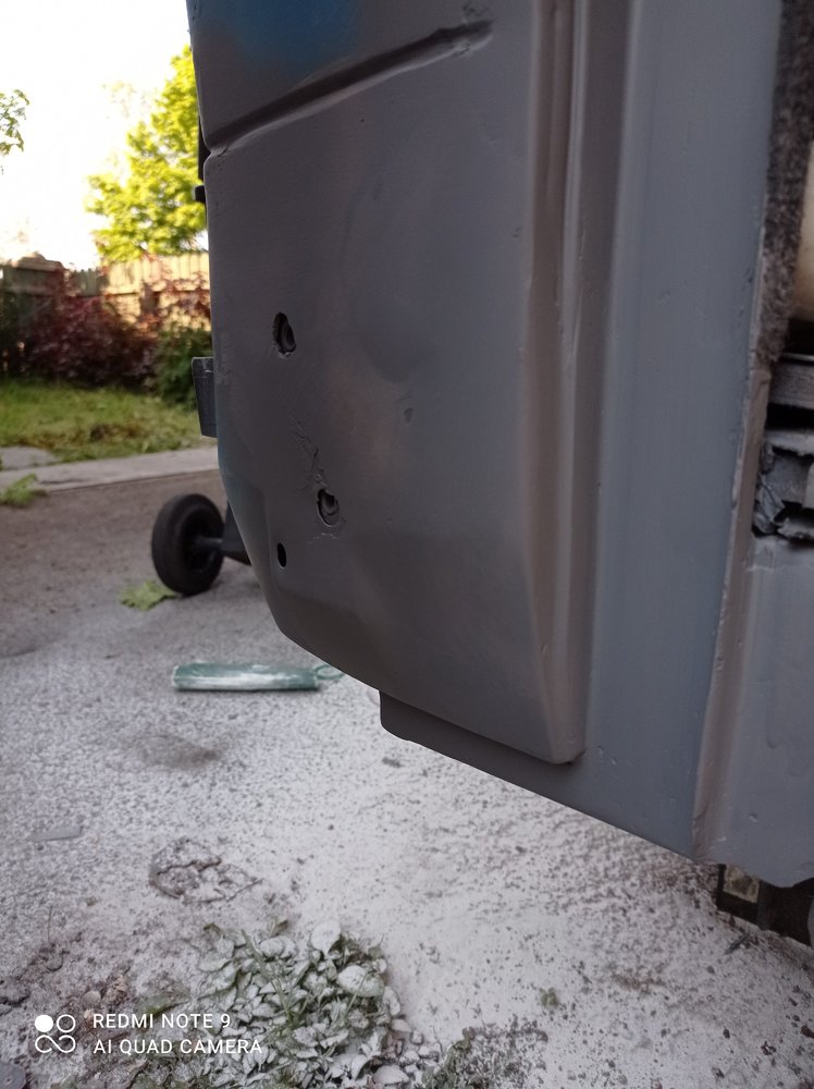

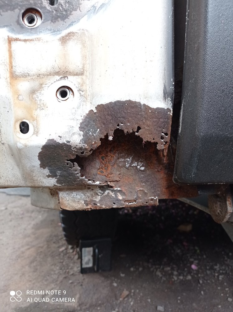

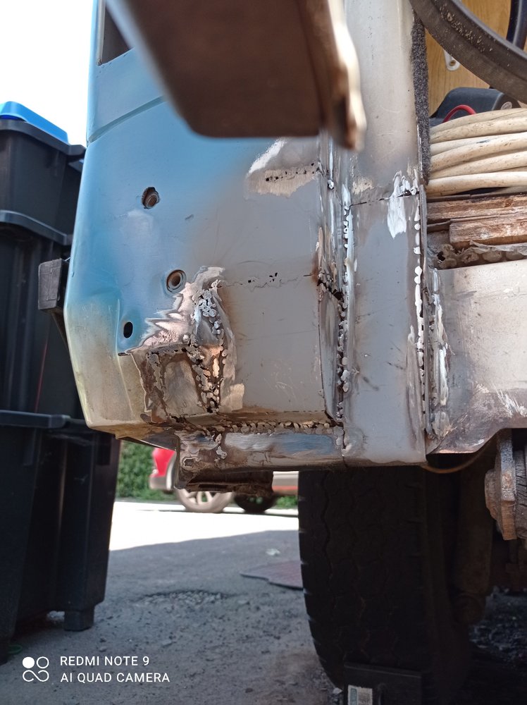

Here's a few picks of a nightmare job that turned out to be way more work than it looked at the start!
The welding looks terrible but hey at least I'm doing it! I usually just do enough to hold fabricated parts in place and then use body filler. When I started I warped the living daylights out of the thing that covers the side door runner so I try to rely mostly on filler to get things looking good now. Most of it is behind the bumper anyway so it should be good enough.
I've still to do a layer of stopper and then paint but I'll prob just leave it with the primer on till I've got the other bits of rust done.
Thanks for all the comments. This has been a most helpful thread!
