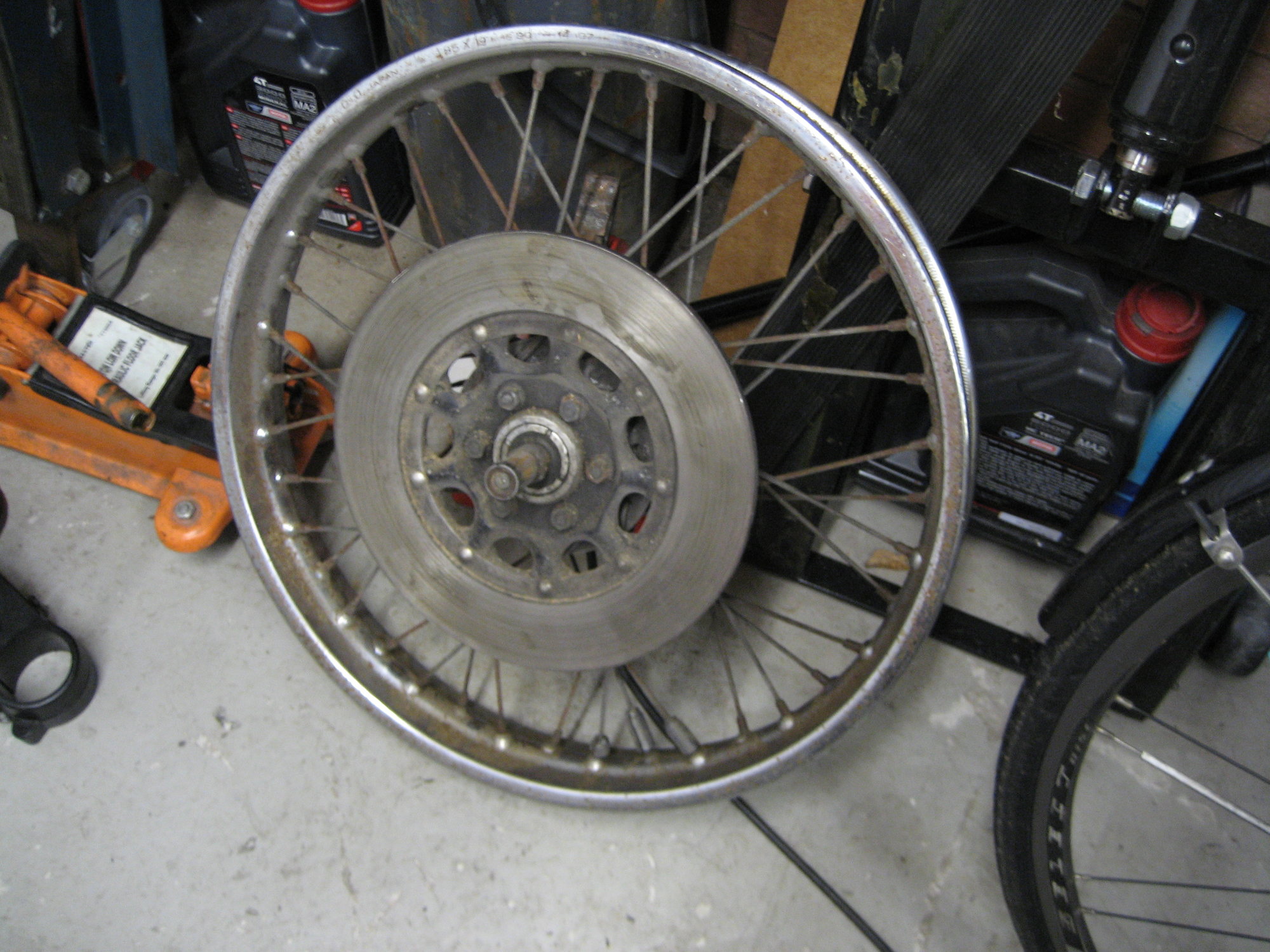

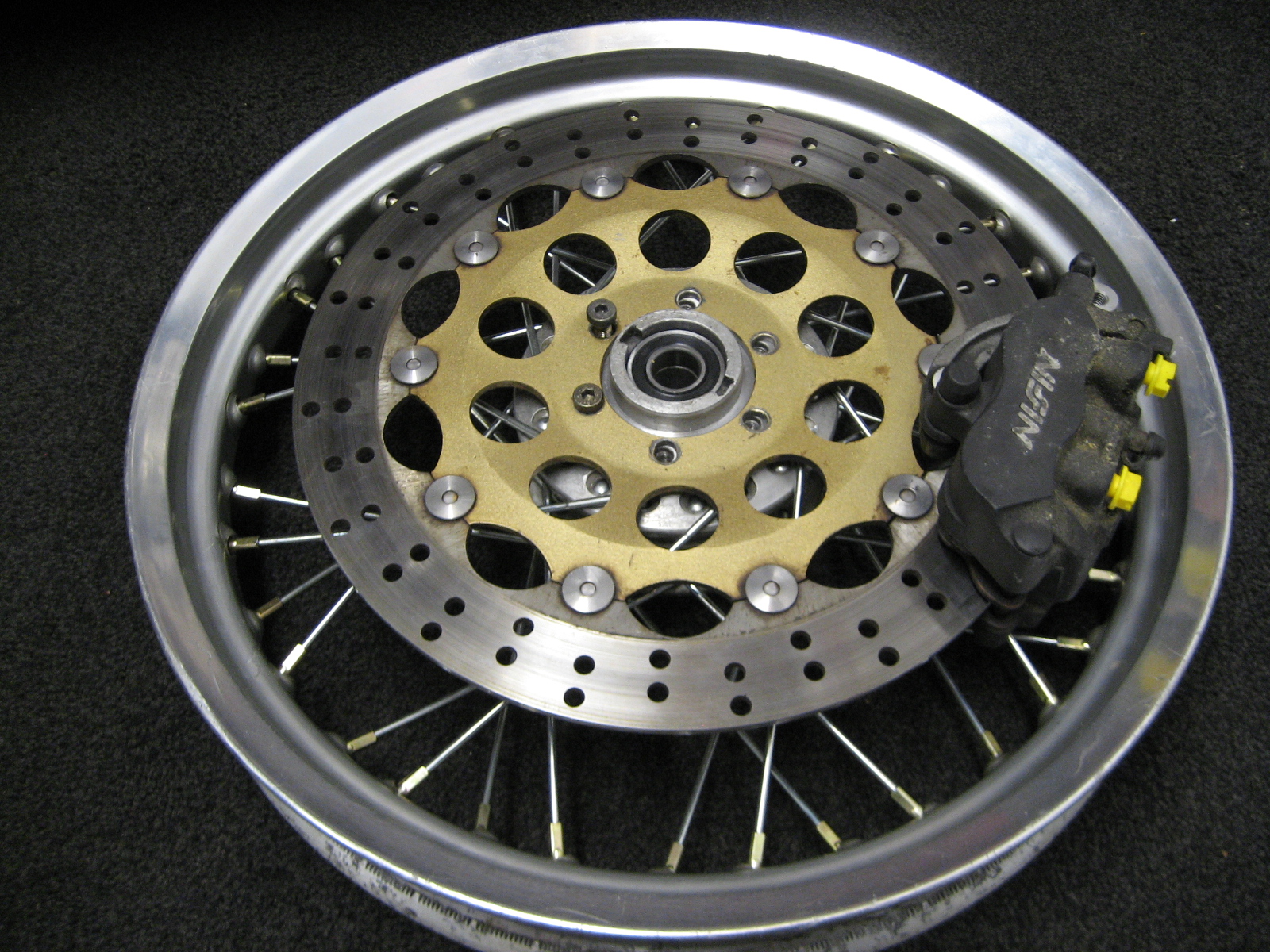

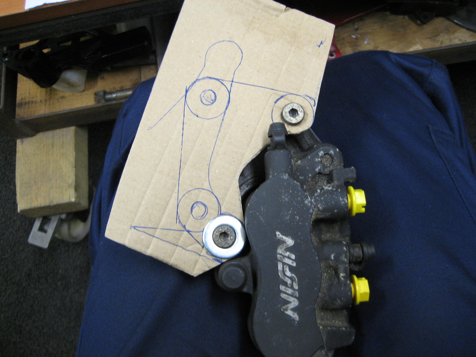

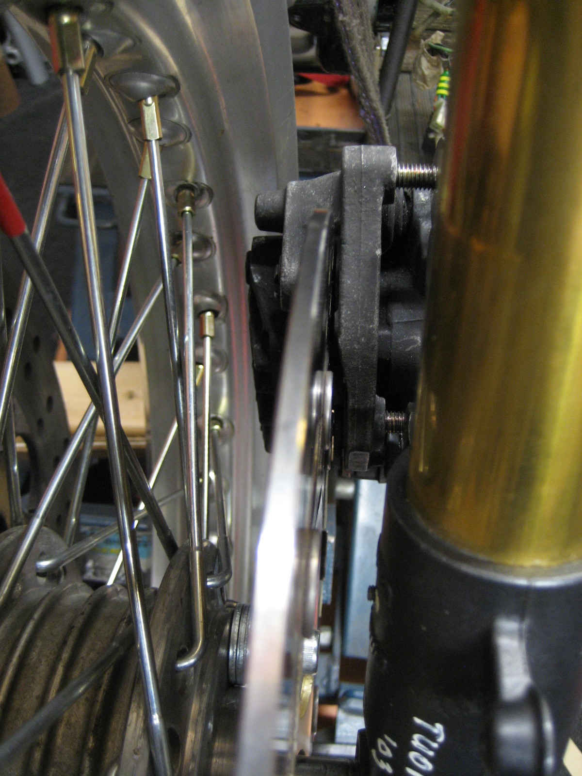

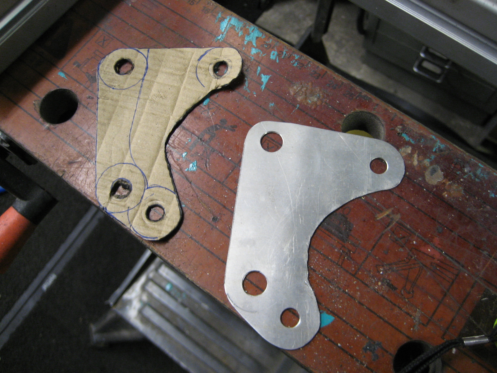

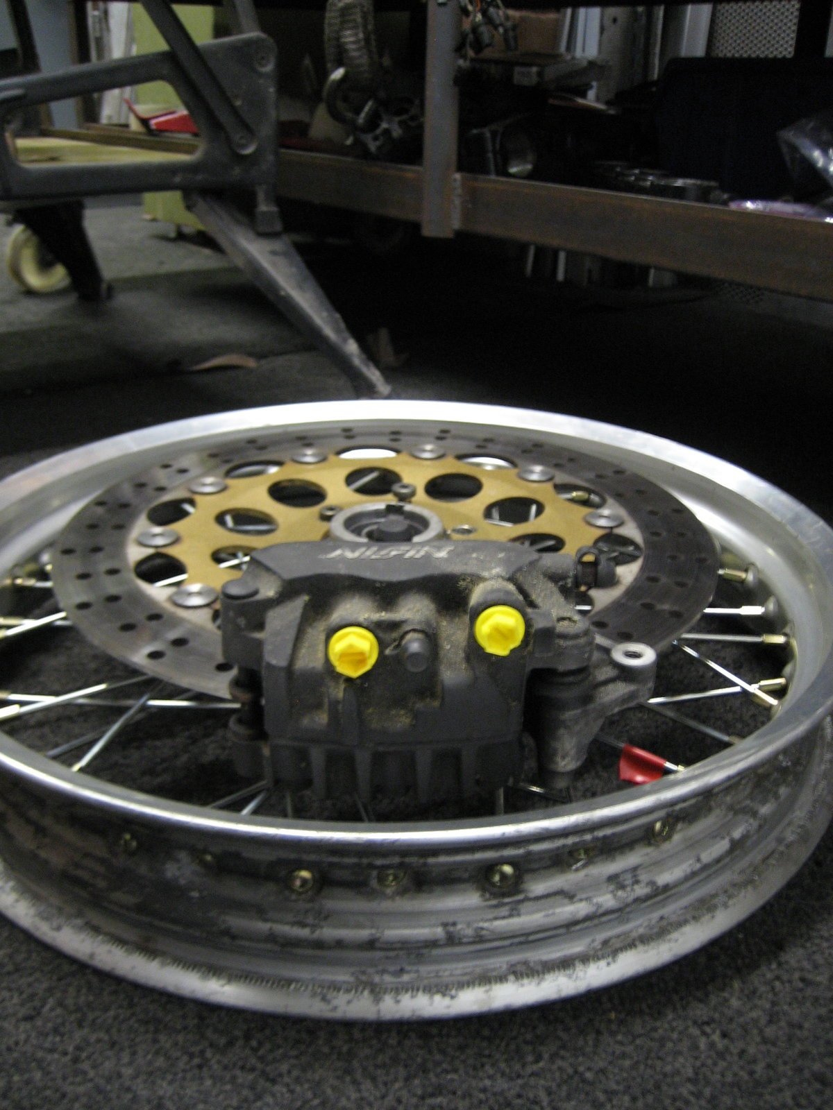

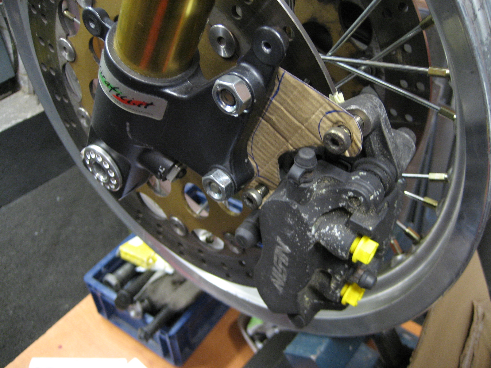

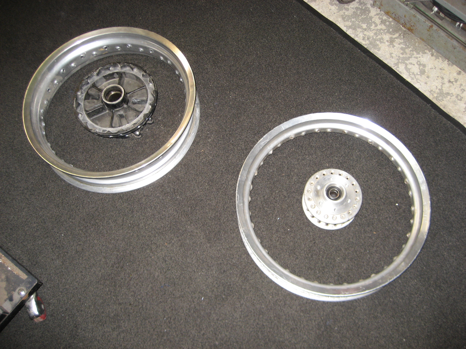

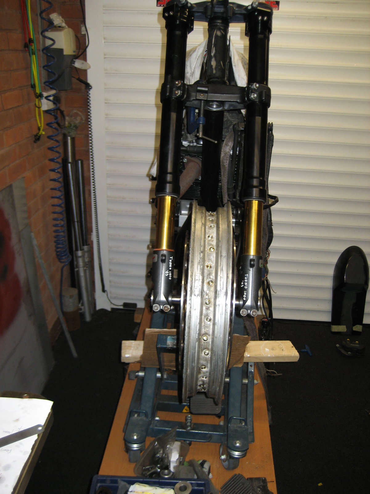

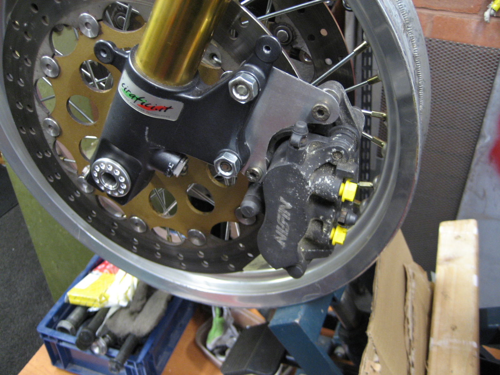

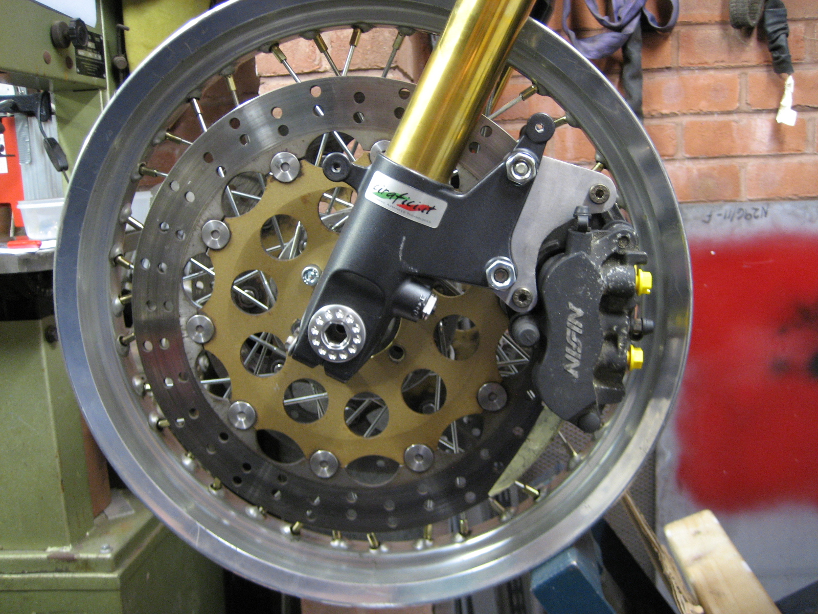

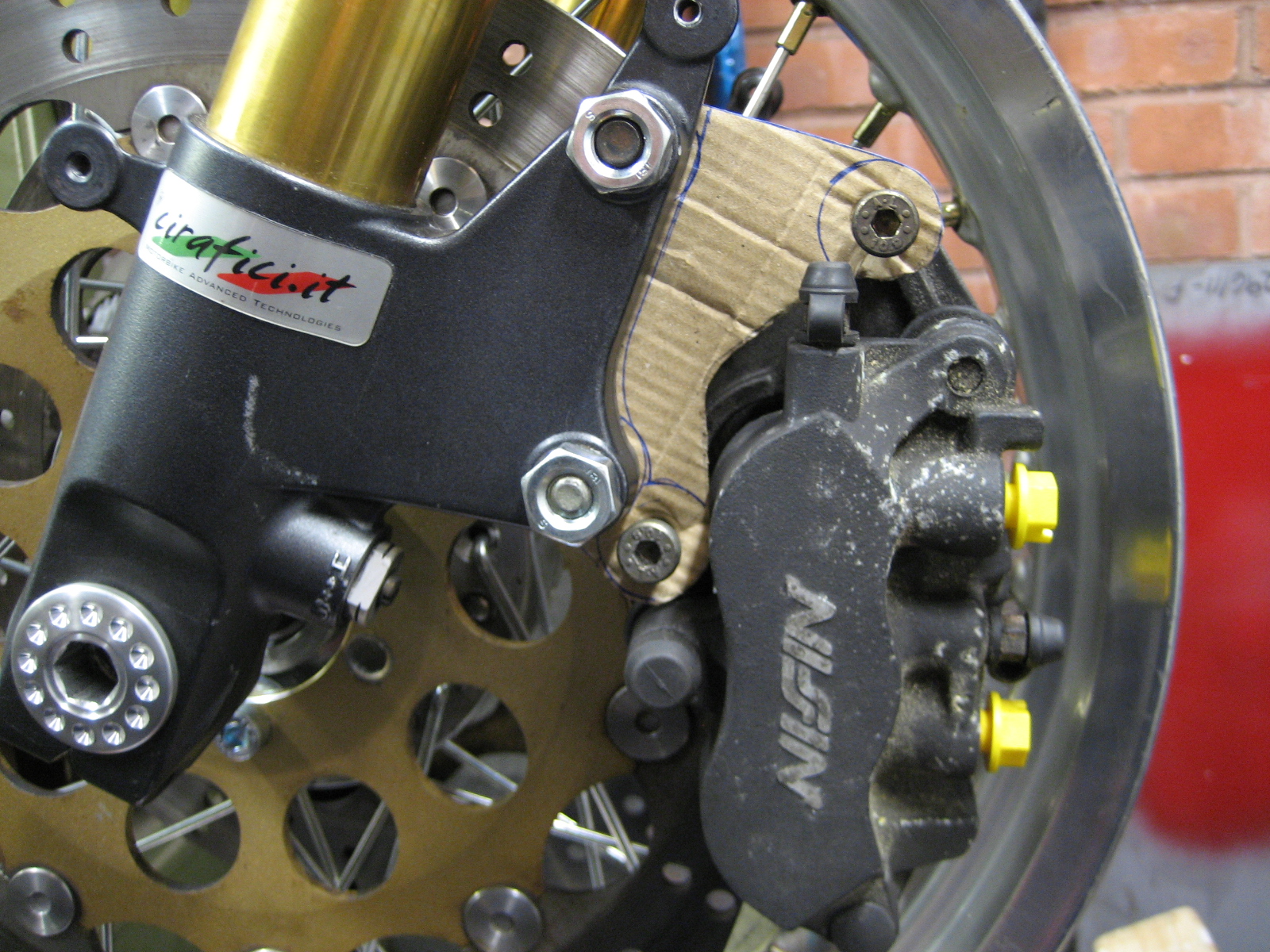

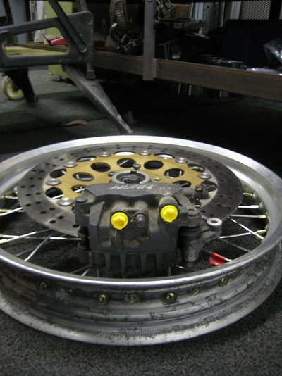

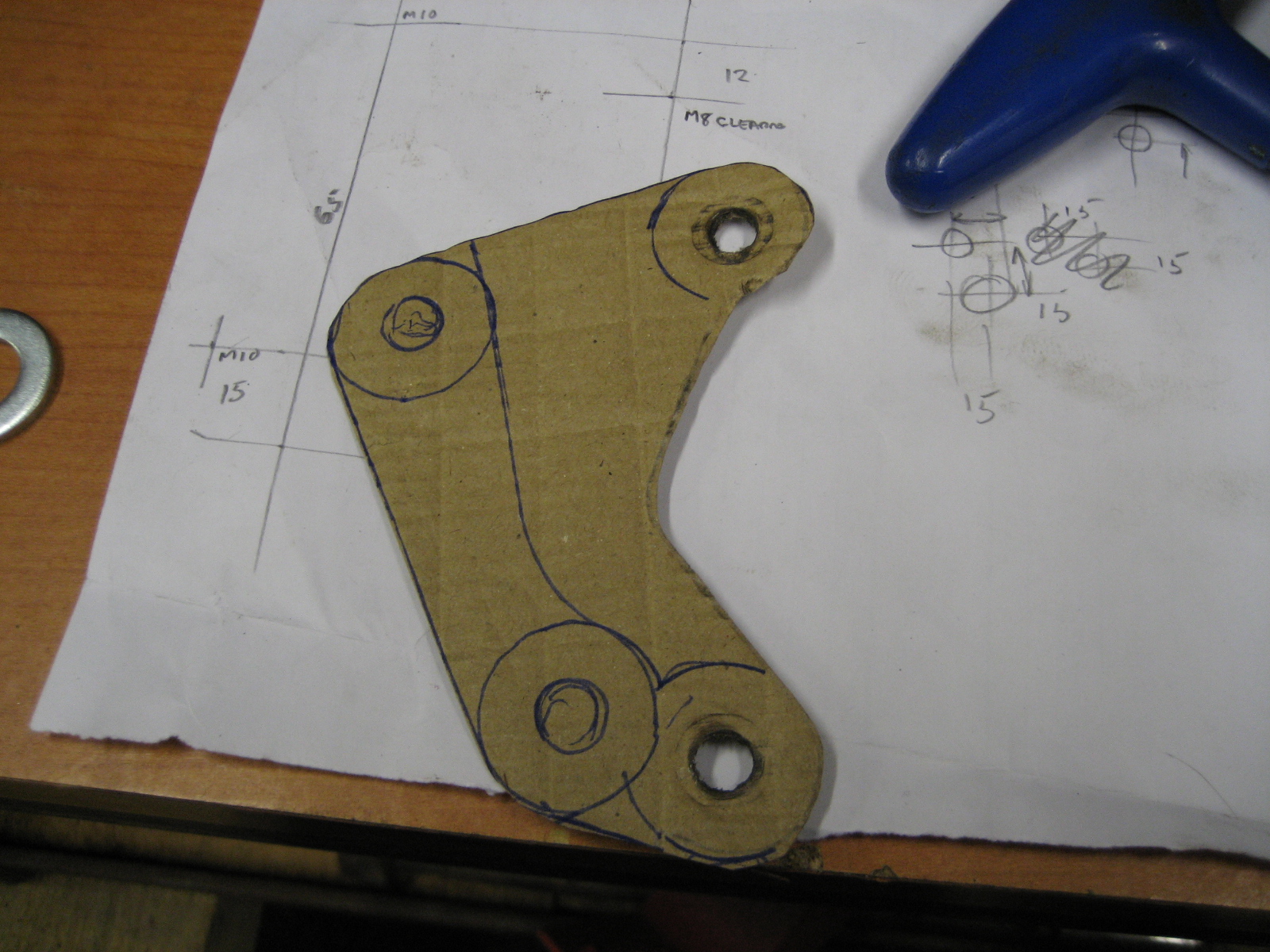

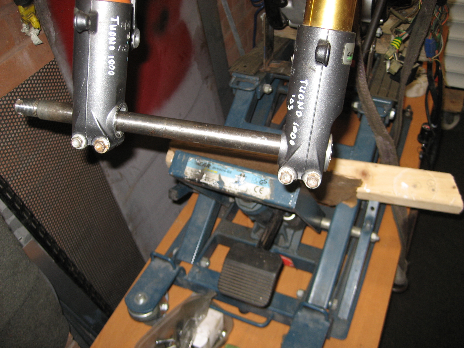

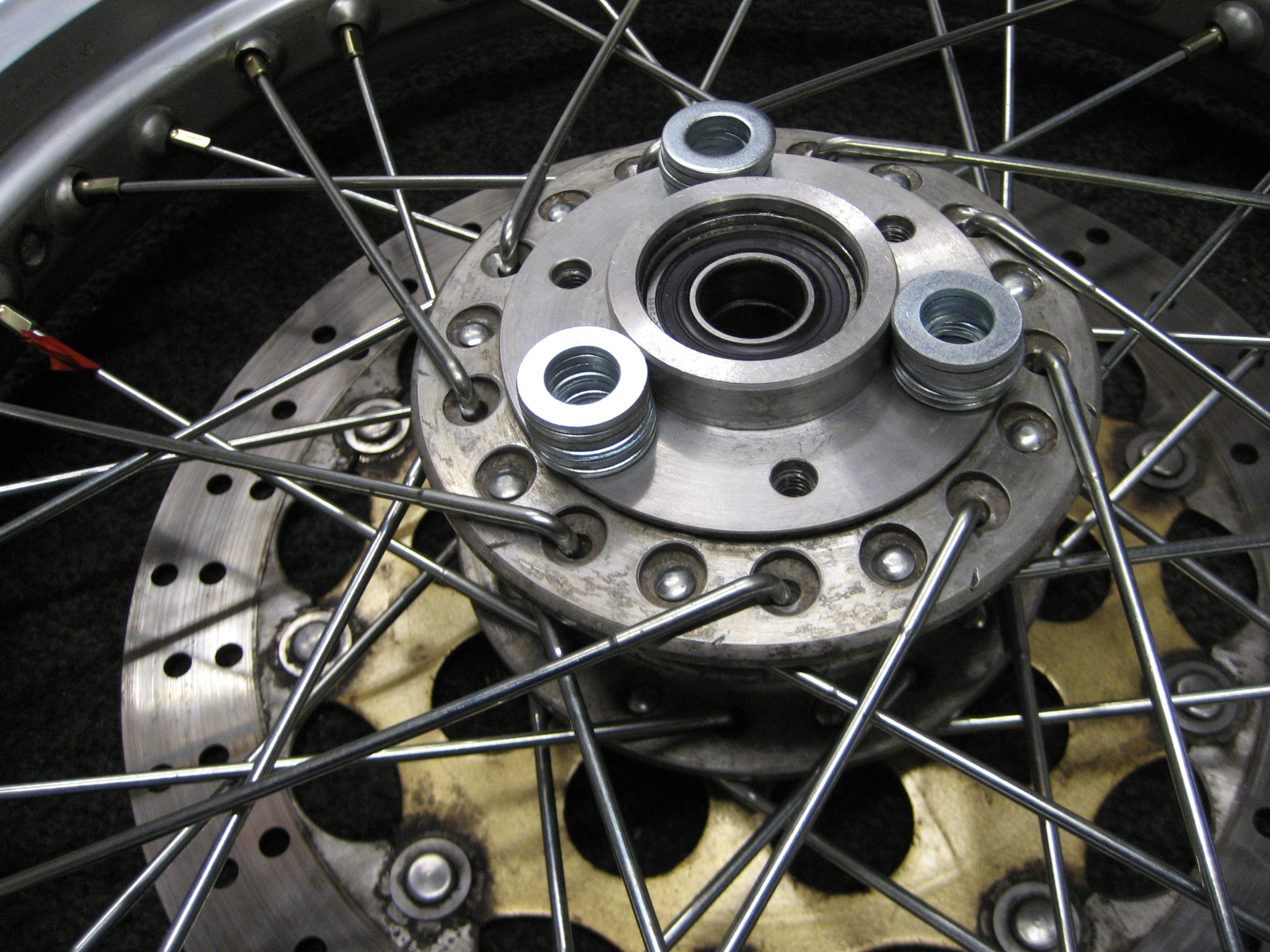

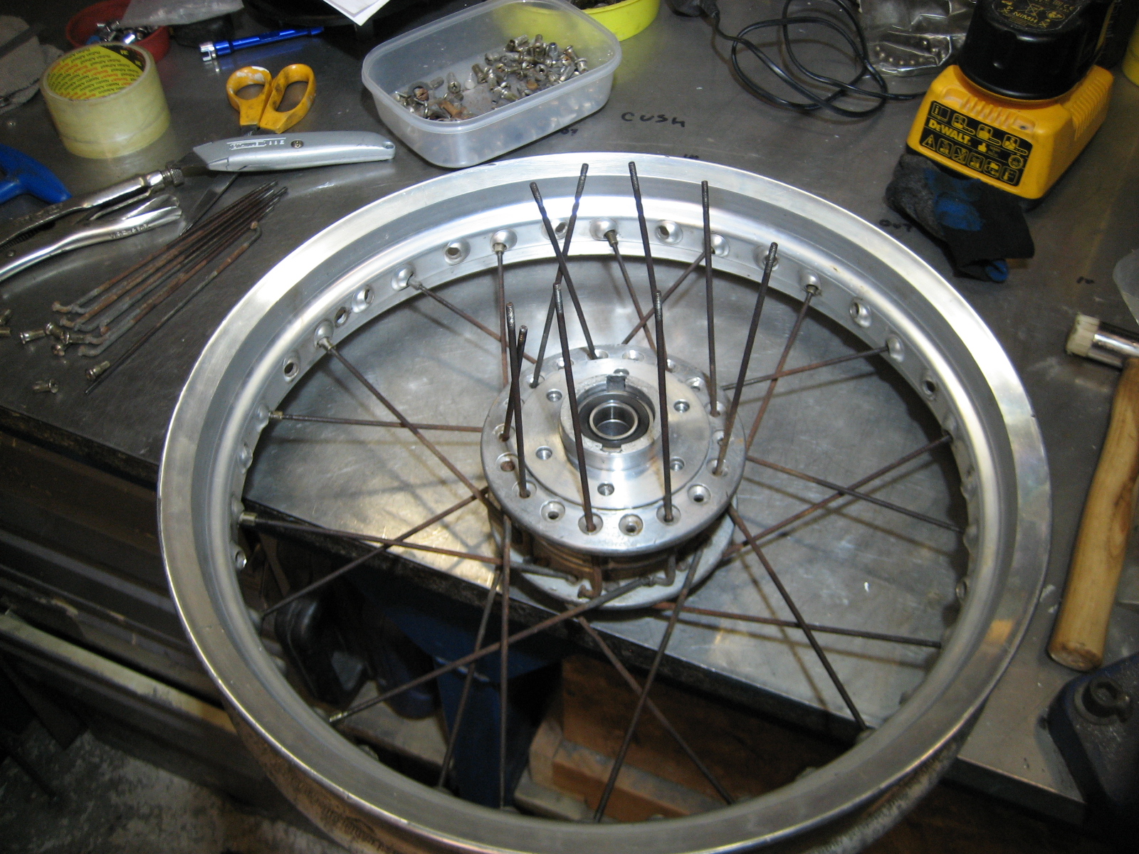

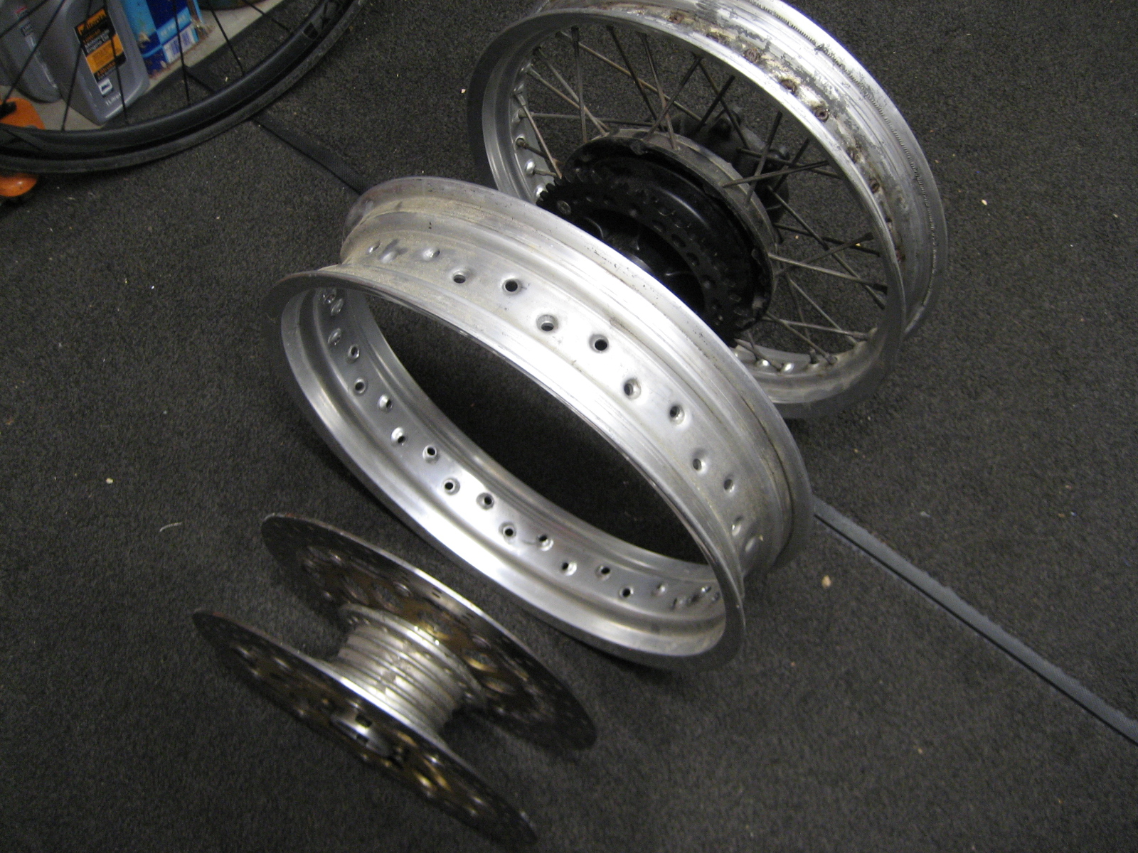

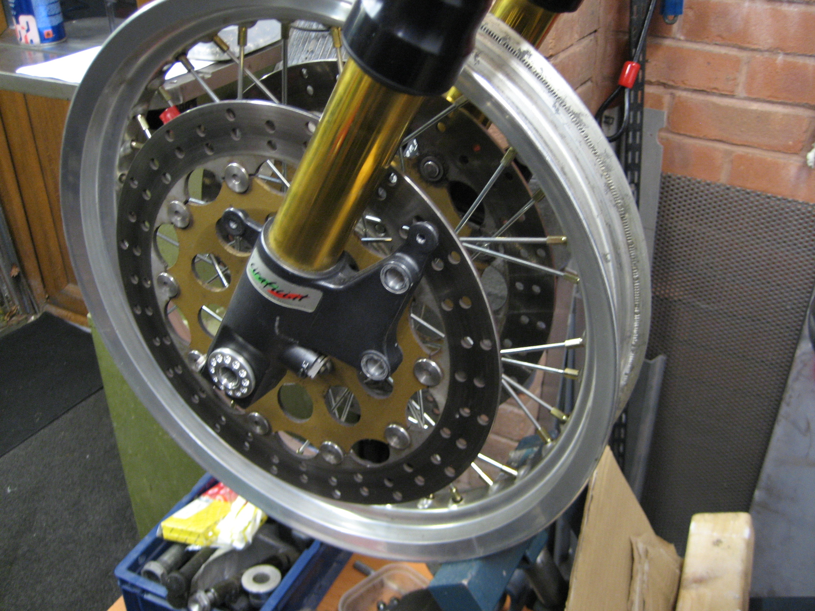

No just 3 pot. Same as I used on my last build. Opposing piston tend to be bulky towards the hub side hence why I abandoned the radial calipers off the gsxr. You can use them with a custom hub available from the states.....but they cost a few bucks !!!Are the calipers opposing piston?

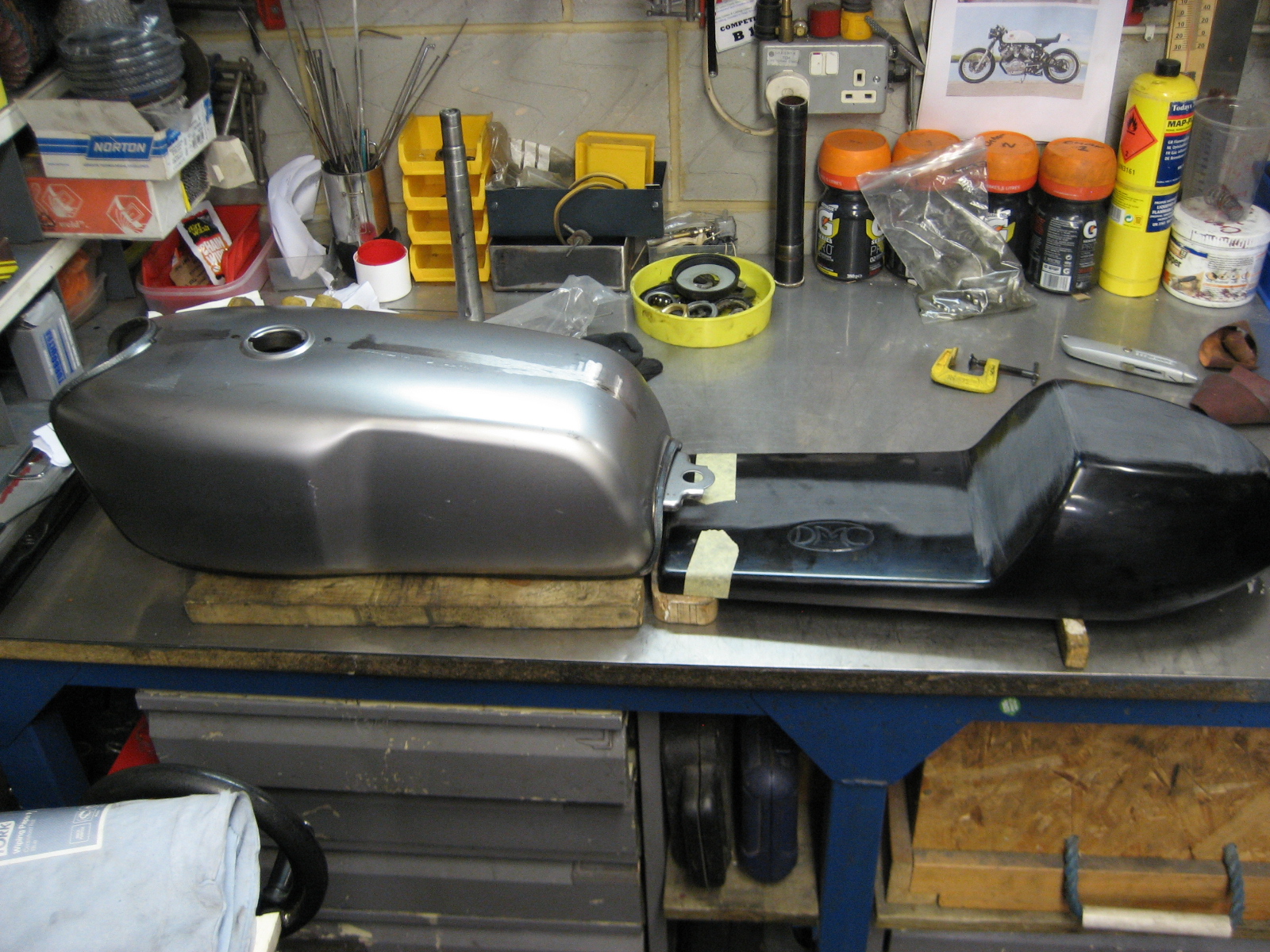

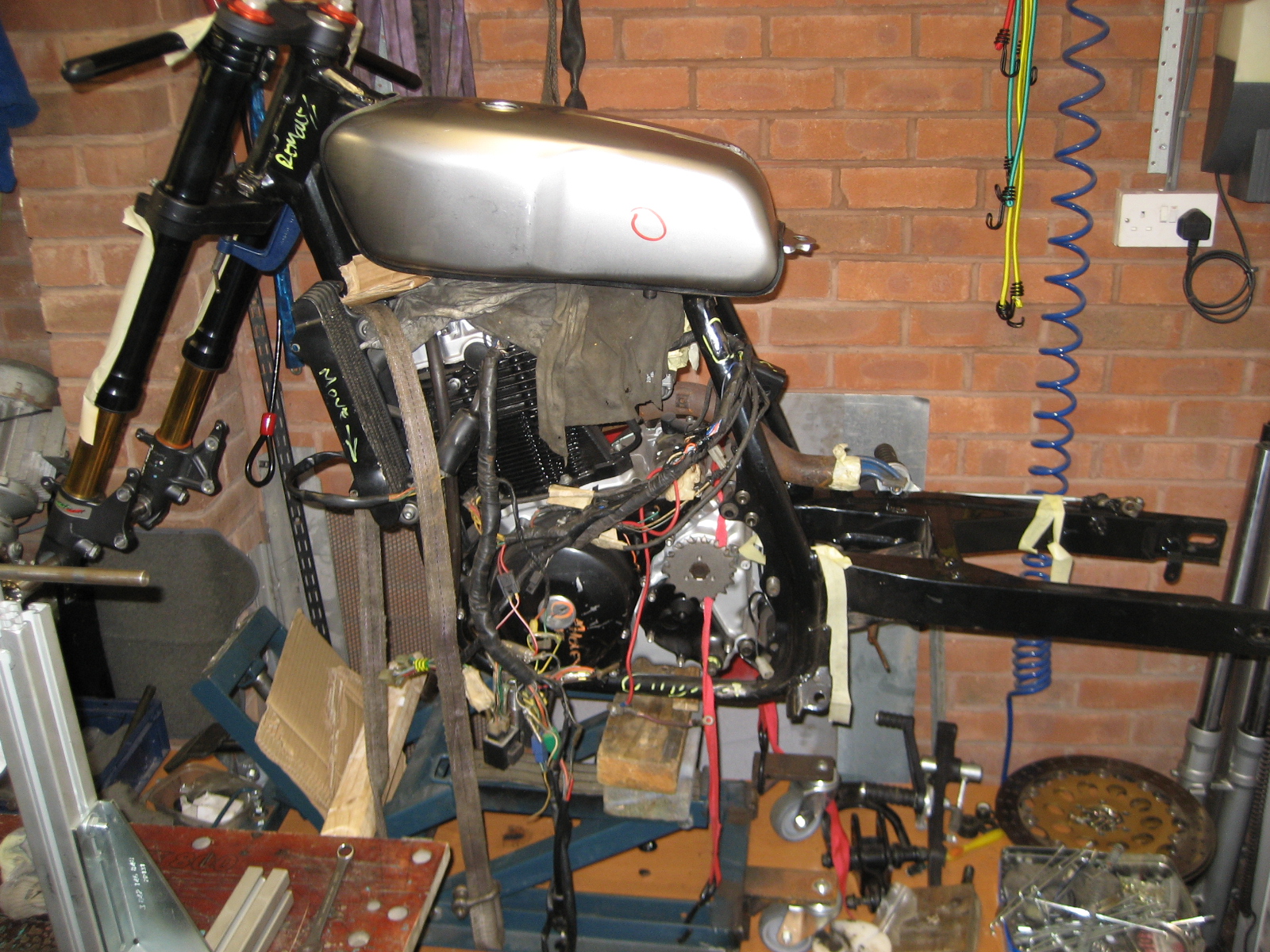

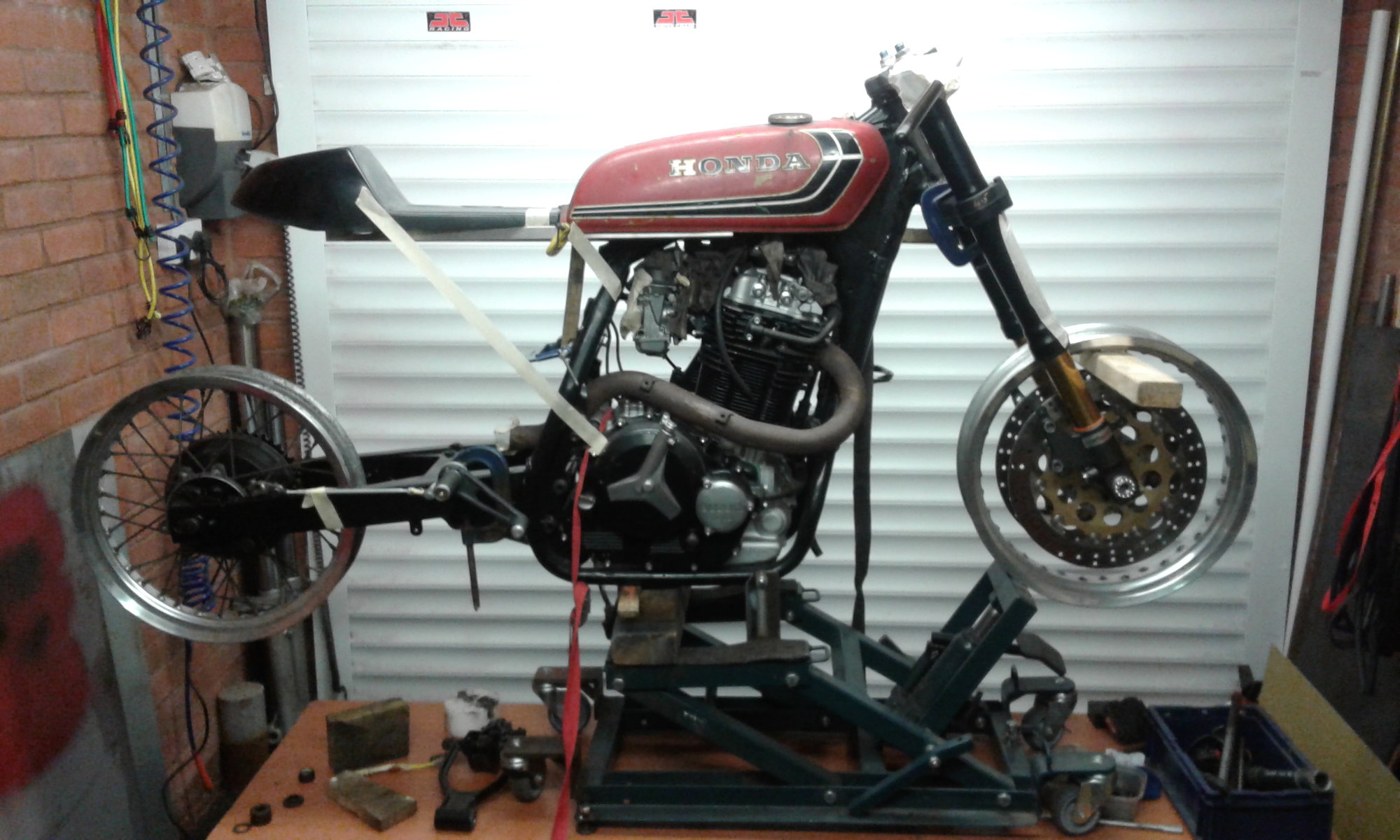

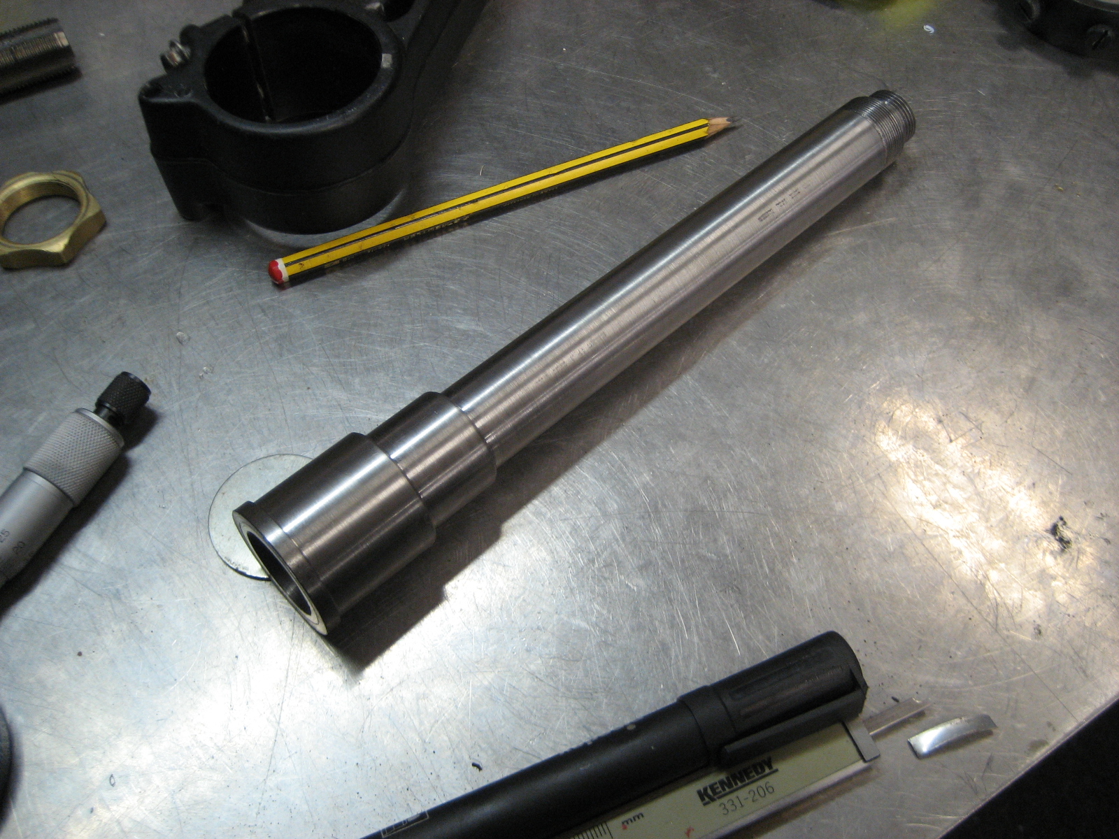

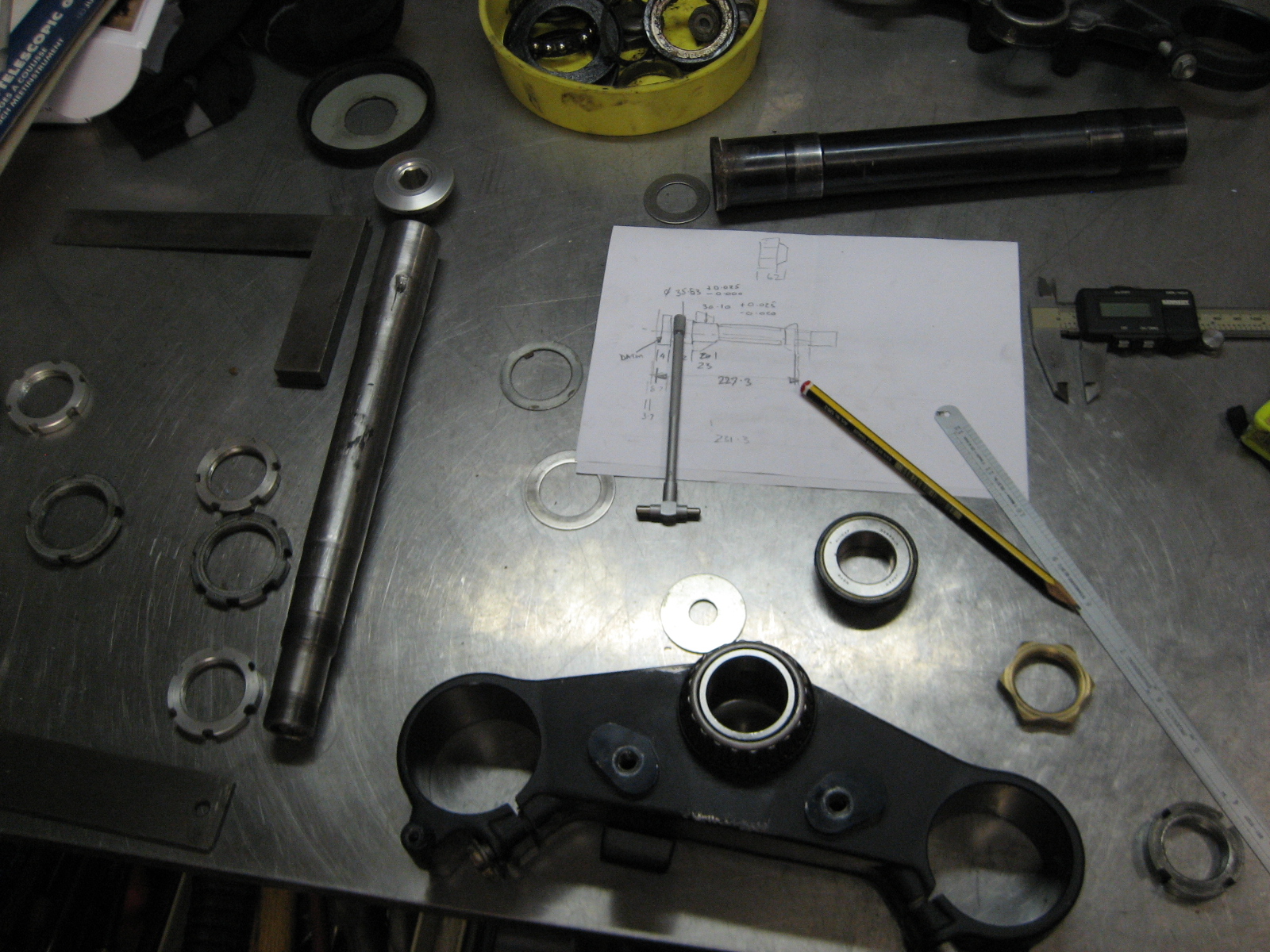

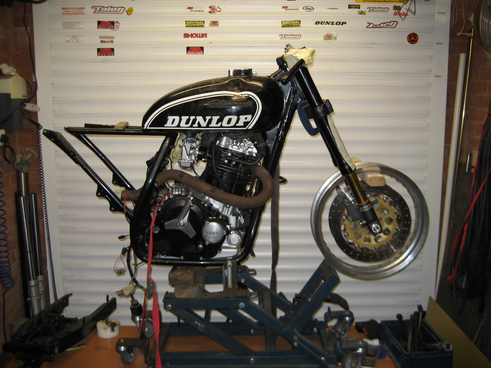

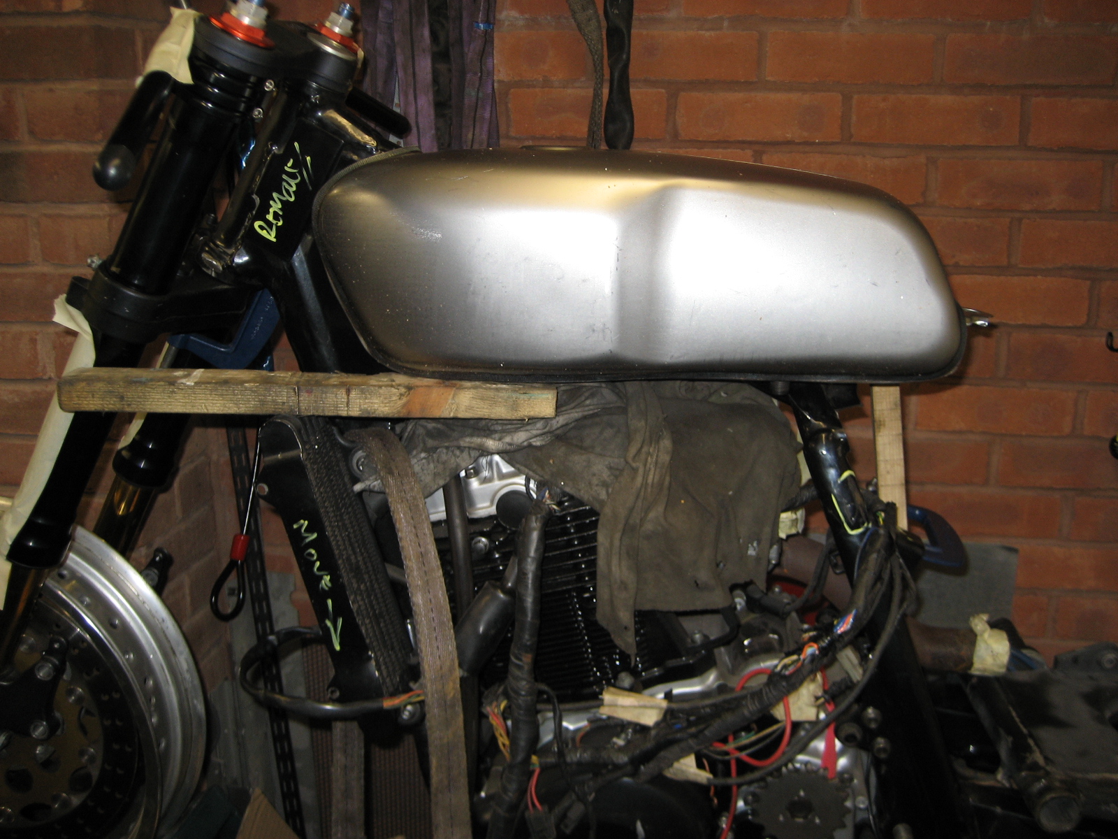

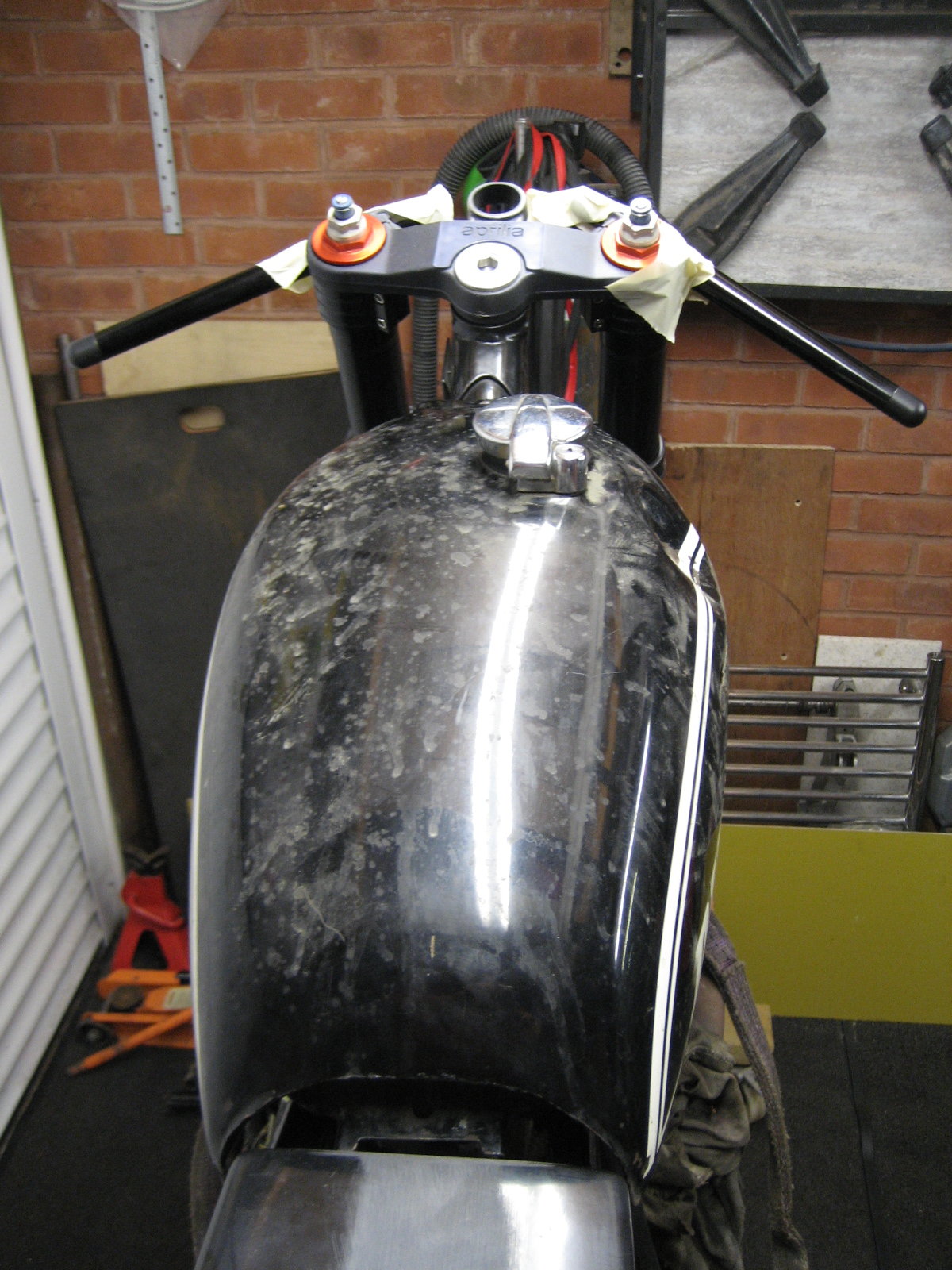

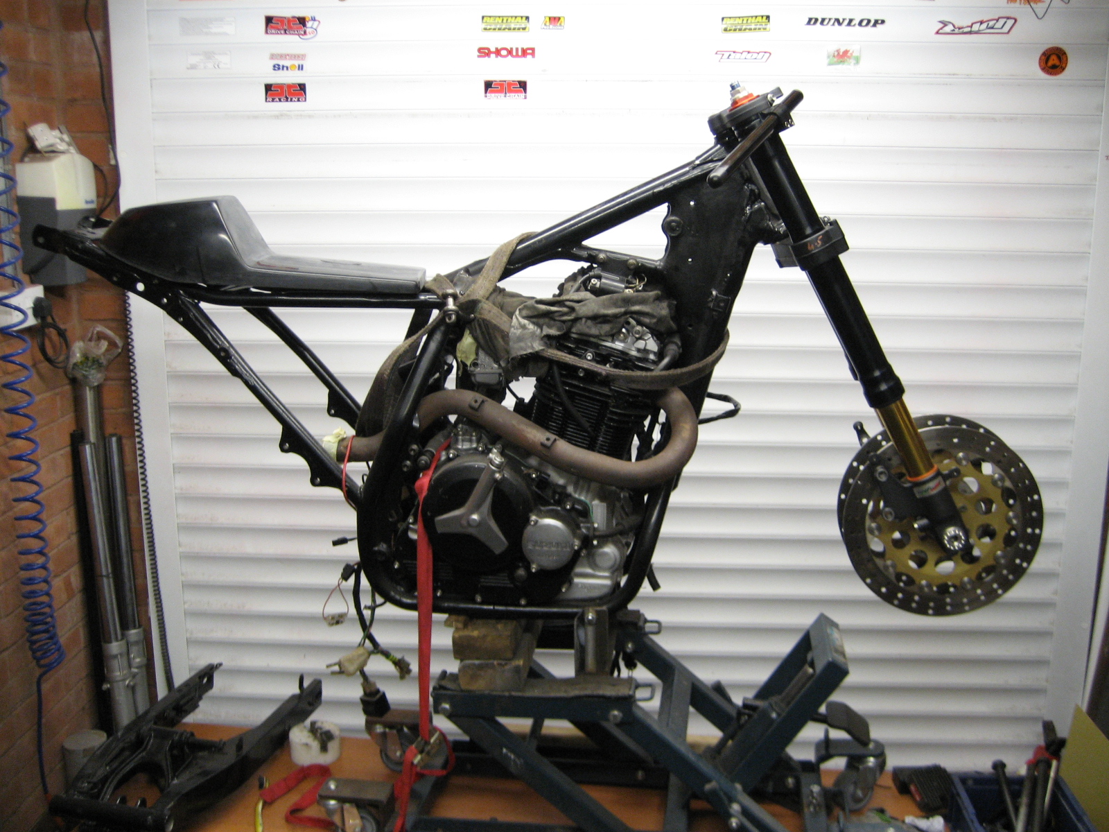

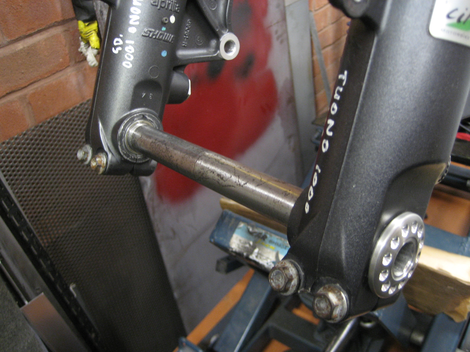

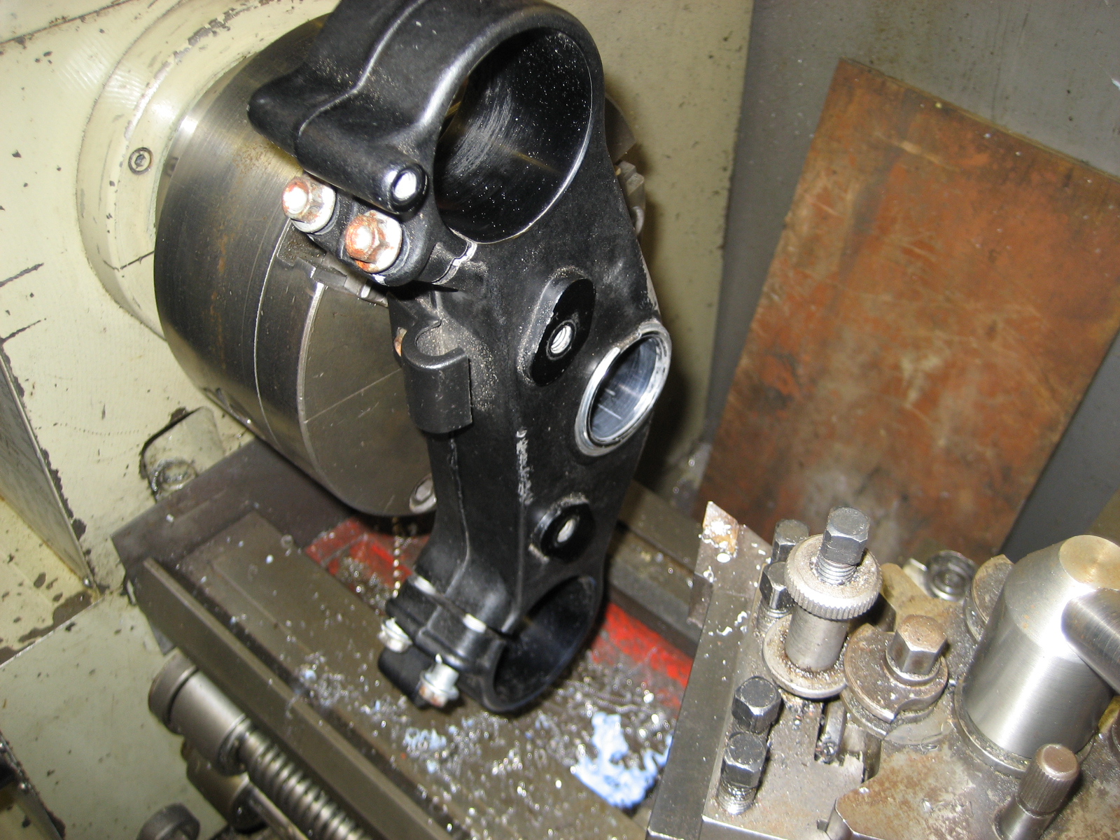

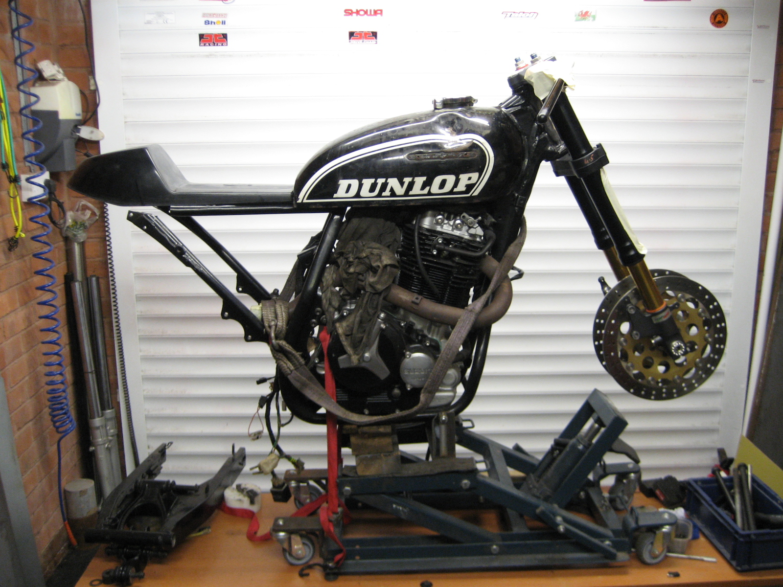

..................time just flies by these days. Its been a busy year what with a new job etc... 2017-18 Winter build season is upon us, time to "try" and get some garage time on the DR800.

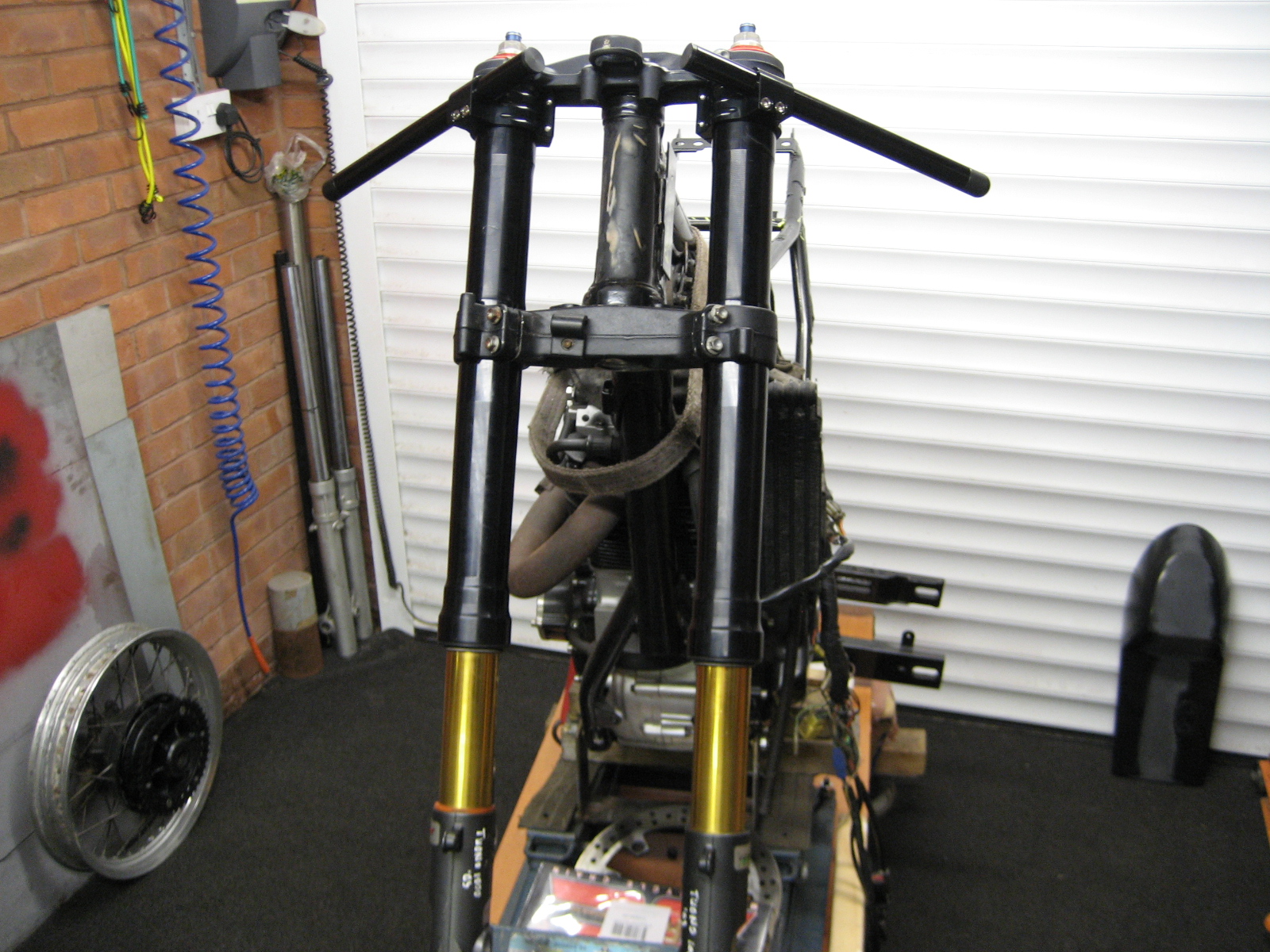

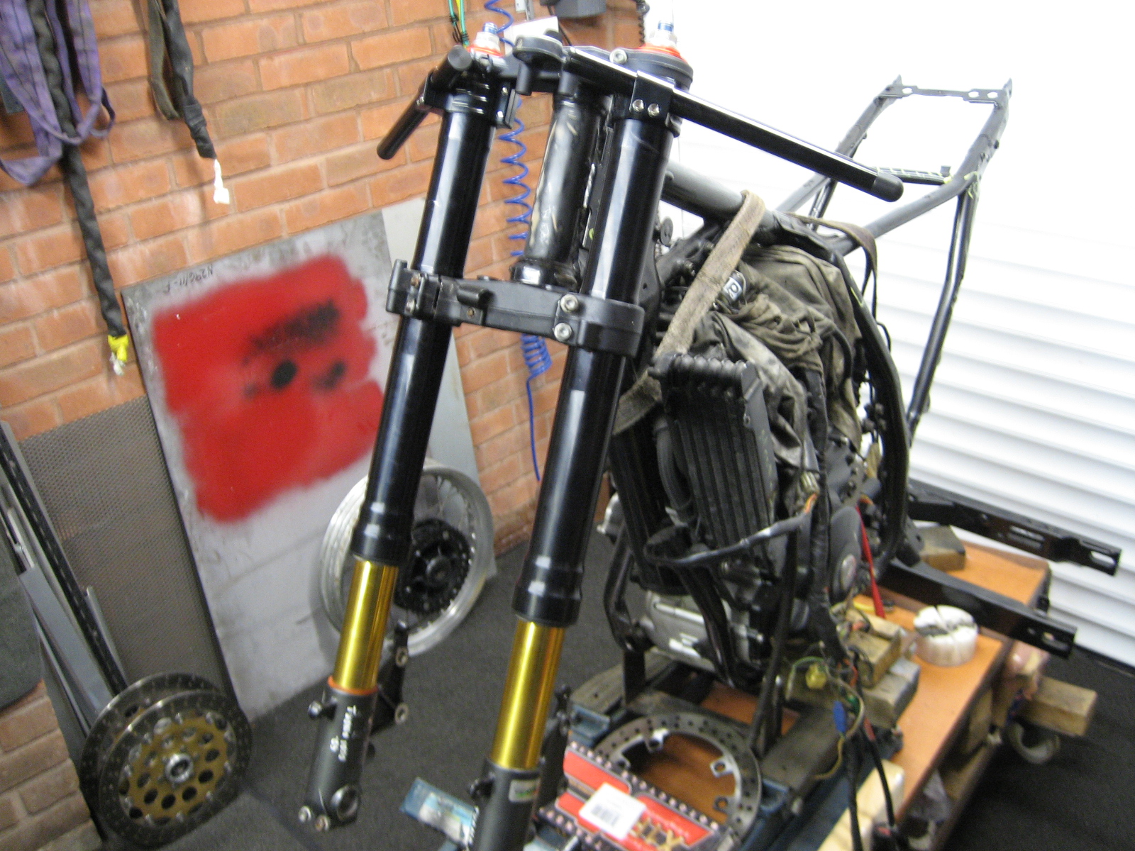

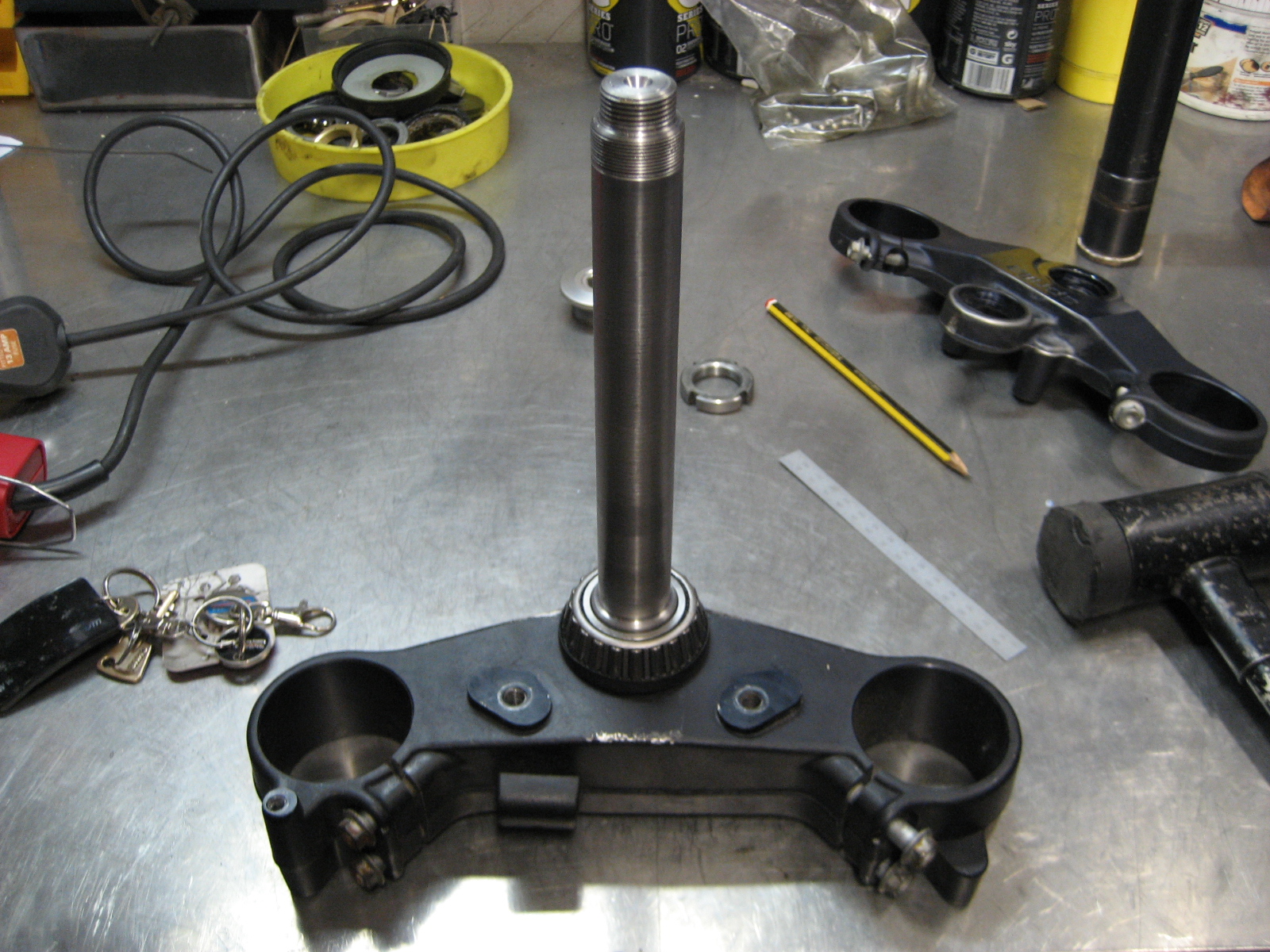

Swing arm is also surplus already decided it was way too long as pointed out. Geometry needs tweaking to compensate for shorter forks Converting it to twin shock....
