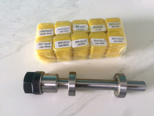

@MattF Something to keep me out of trouble tomorrow.I have a couple of ideas, ER16 chuck on a spindle running in a couple of bearings. Weld a length of 12mm bar to side of some 32mm round stock, clamp the bar in tool post to bore round for bearings.
Darn I now need a boring head.

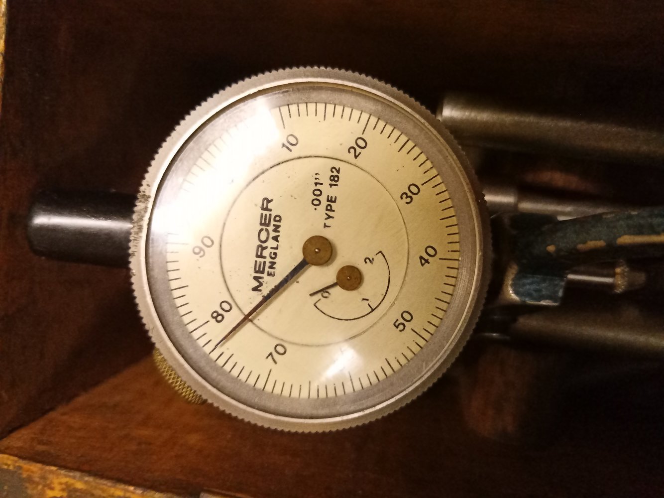

On that one yes as it says .001" if it has the extra digit (.0005" or .0001") it changes how it is read. There is also some metric thing but I haven't a clue about thatBearing in mind it's yonks since I last used a DTI, it signifying a couple of thou if it's moving two graduations on the scale?
Yes, quit when you are ahead and get back to relaxed turning, after all we are not buying close tolerance collets.That's why I took the photo. Thought it was that scale. So that's 0.05mm out then? I'm not farting about trying to set it any closer. Likely to just lead to frustration.
