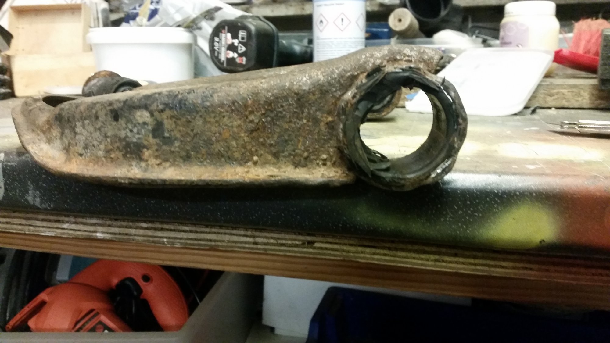

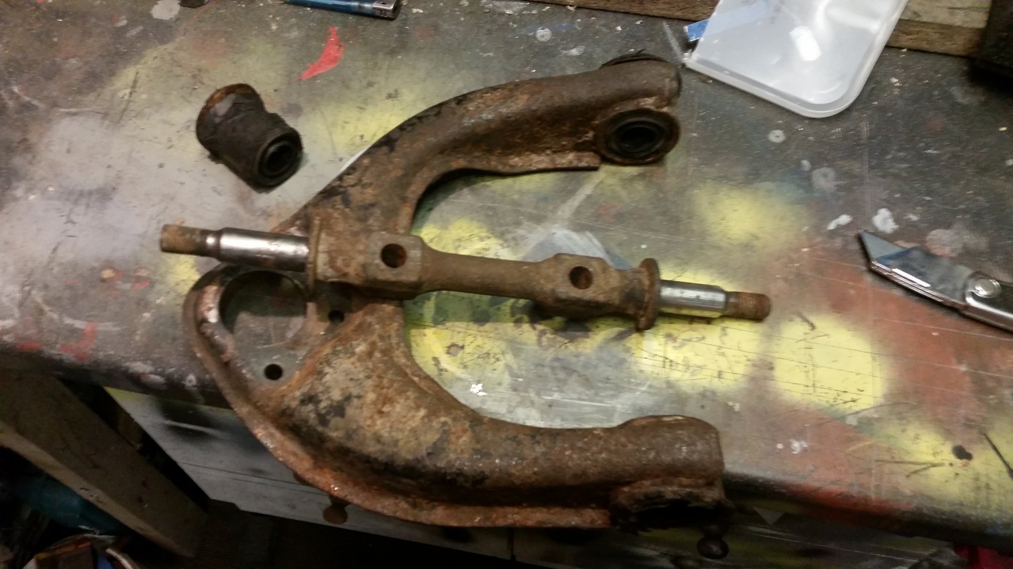

sounds like very cheap id rather pay that bit more, or have they done it so people dont need a press and can push the poly in with a viceme neither but its what the destructions say re-use original metal shell/outer cheap poly bushes
I don't get it either.
My polys just pushed in like this.
see post 1@123hotchef
Use a old socket what sits on the outer shell of the new bush.
Warm the wish bone.
Press in.
Feel smug.
they made the poly mould to smallok so i just re read the destructions and it is the uppers that say reuse old outer shells
