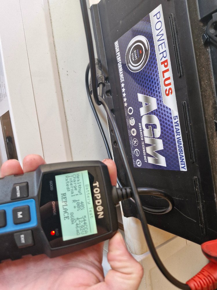

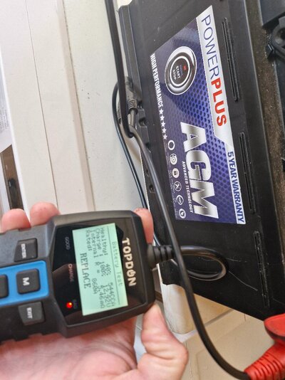

I might suggest also that the ONLY way to tell if a battery is any good or not is a quality modern battery tester. Such as Topdon units. Highly accurate. Eg
Sorry for the sideways pic but that's just an example of the readings. If it says replace then the battery is stuffed in my experience and only fit for the bin. 50% health or above is worth looking at. New batteries tend to test at 100% or over the stated CCA which is also useful to know what you are buying.

topdon chargers got a link ? and do so much ? im not hoping to revive 12v down to 1 volt batterys here just save a couple if we can if the batterys are 60 each the repair charger is 120 but works on 2 batterys a year for 5 years its worth doing but if the repair bit is tosh and does realy nothing its not woth it
