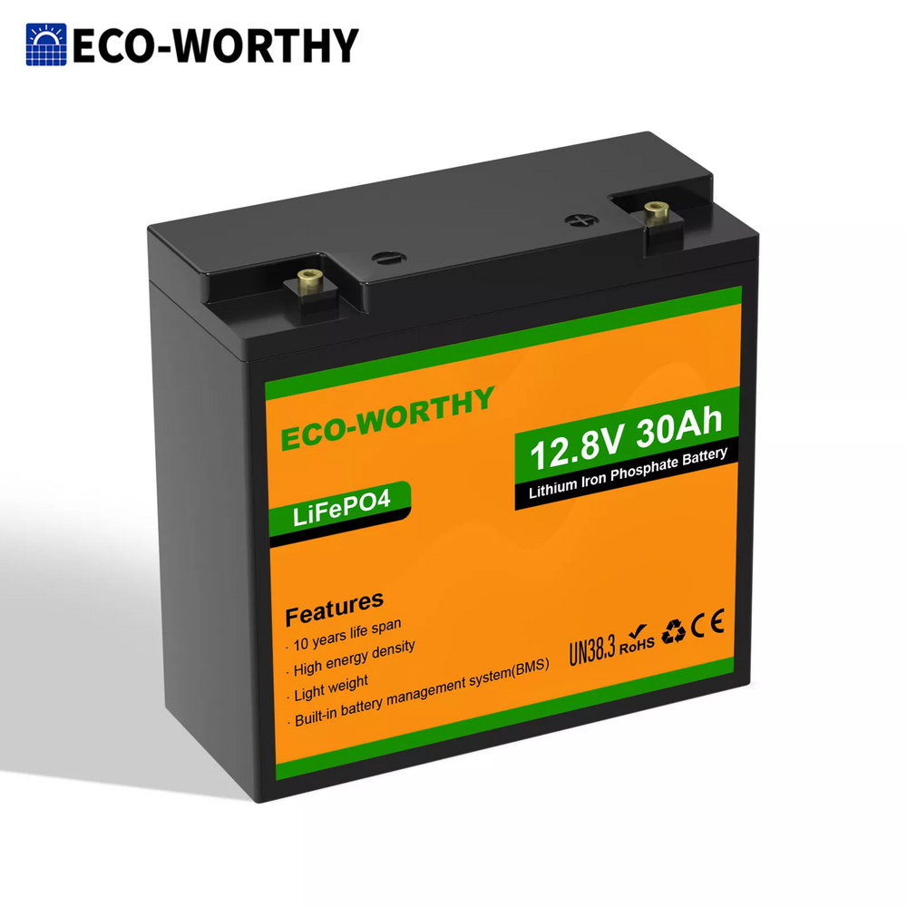

Switch to Lithium Iron Posphate batteries.
LIFEPO4 is what you need to search for.
ECO-WORTHY 12V Lithium Battery 30Ah LiFePO4 4000+ Cycles Wheelchair Boat Scooter | eBay UK
The 30Ah lithium battery weighs only 3.07Kg, which is only 1/3 of the weight of a lead-acid battery, easy to move and install. Solar Panel Kit. Solar Battery System. More information. [BMS Protection].
www.ebay.co.uk
Last far longer. Safer than lithium ion. Will be safe if not charged over winter. A lot cheaper than they used to be.
Only thing they don't like is being charged when the temp is below freezing. They work below freezing just don't charge them when it is too cold.
Below is an example. £80 but shop around.
Watch out for the BMS on the smaller models. Some may only be rated for 10 amps which could limit performance so read the specs first. Not an issue on bigger batteries depends on what cpacity you need.
Just about to replace the 2x 12v 100amp gel batteries on the wife's mobility scooter for 2x 12v 100amp LIFEPO4. Price £300 for a pair same as 2x quality leisure batteries.
