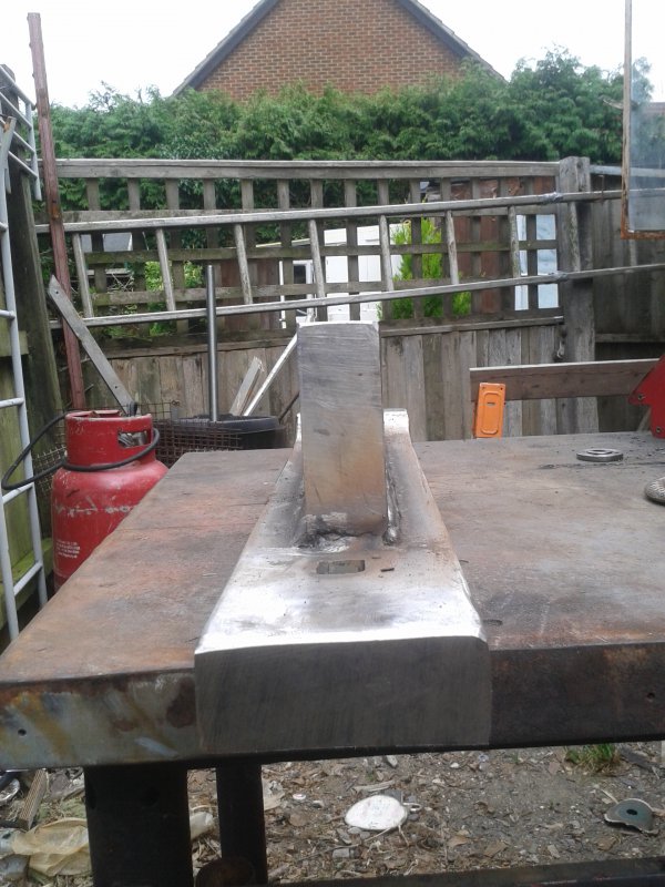

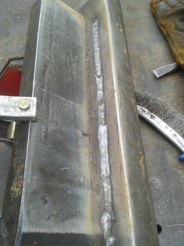

Thanks will doI agree keep the curve you will find it useful ,also as posted "Iforge iron" is a very good forum I use it all the time when i'm not on here.

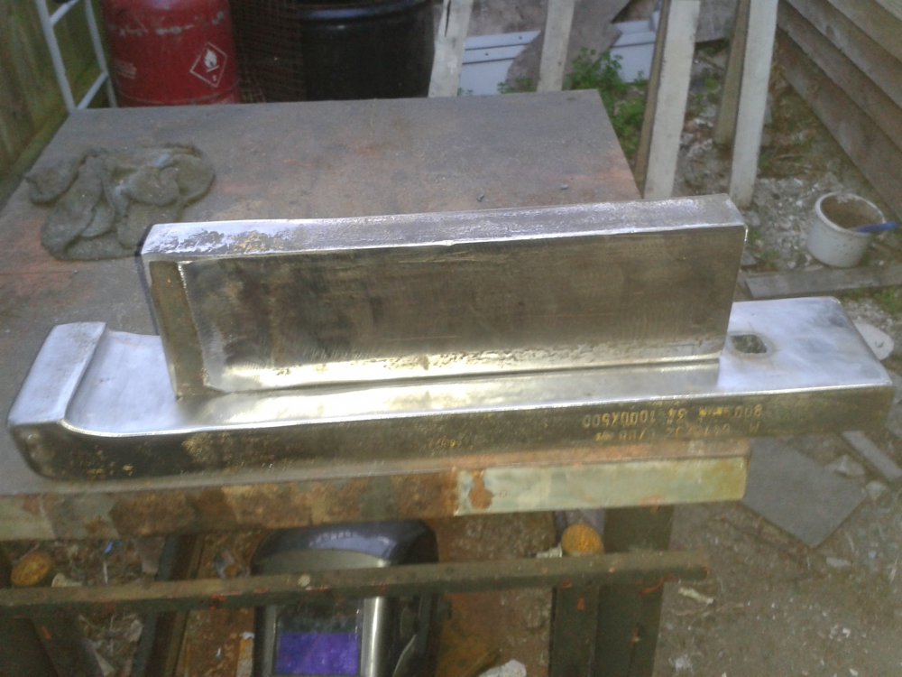

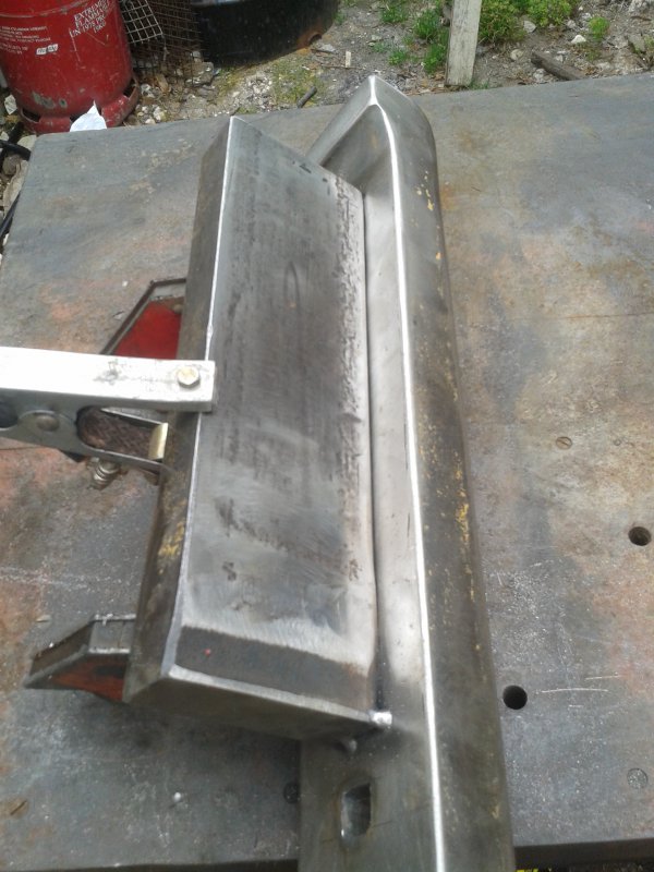

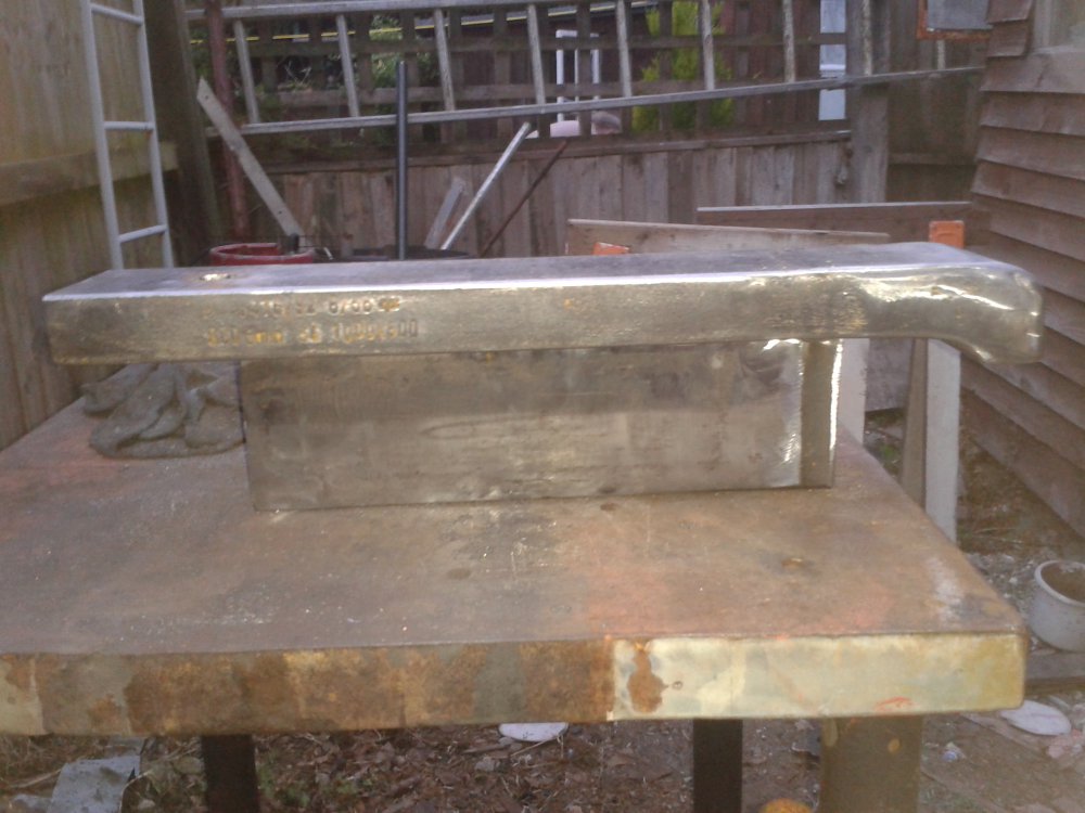

You need the mass so when you hit the hot iron you don't loose all the force of the blow.

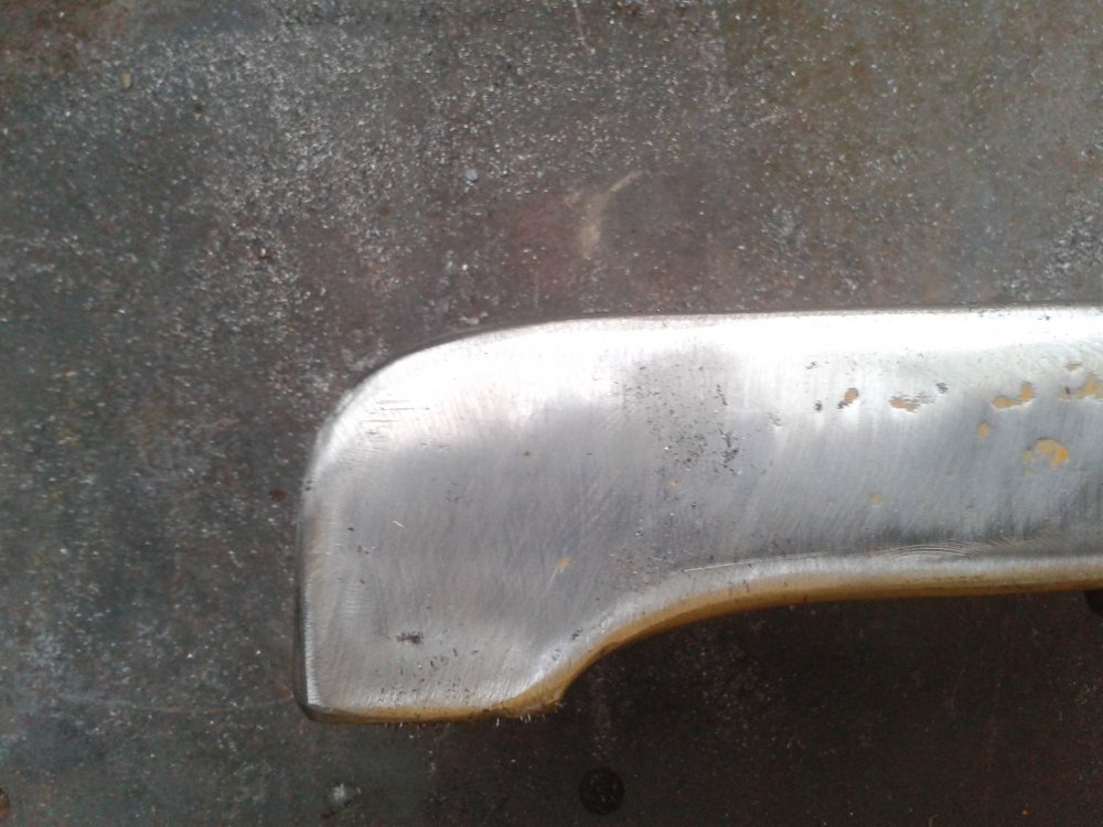

Most anvils do not have sharp edges google anvil radius, might be useful?.

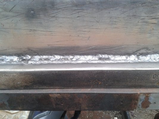

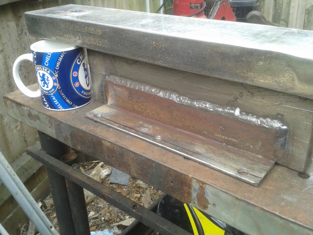

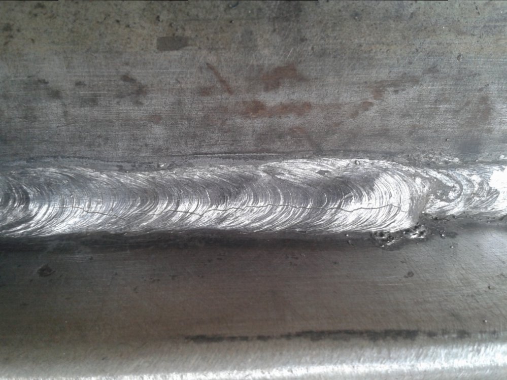

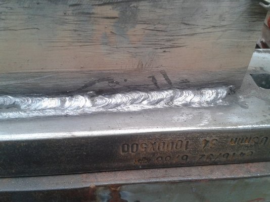

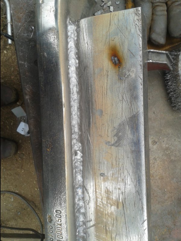

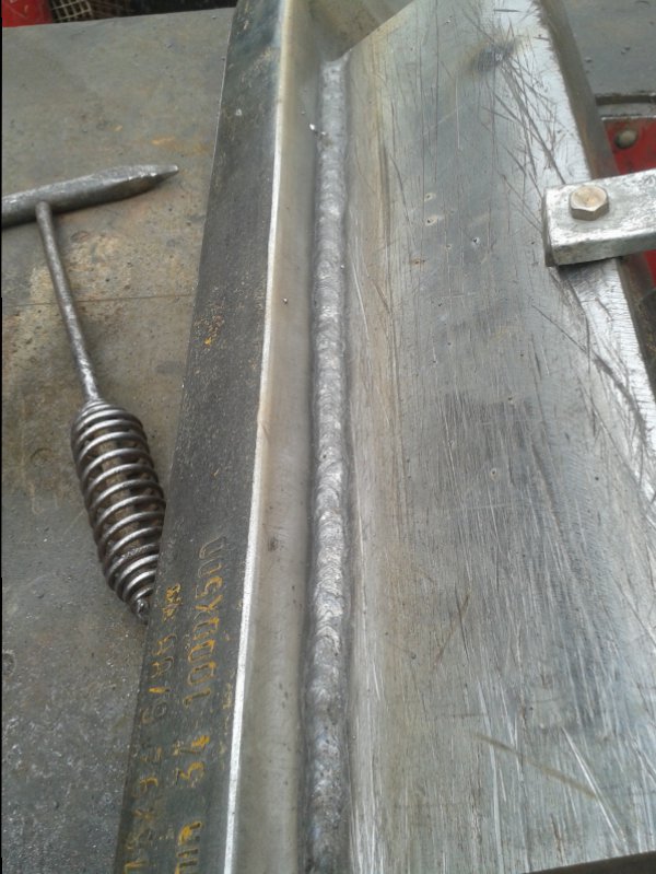

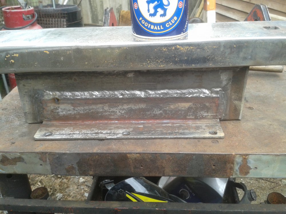

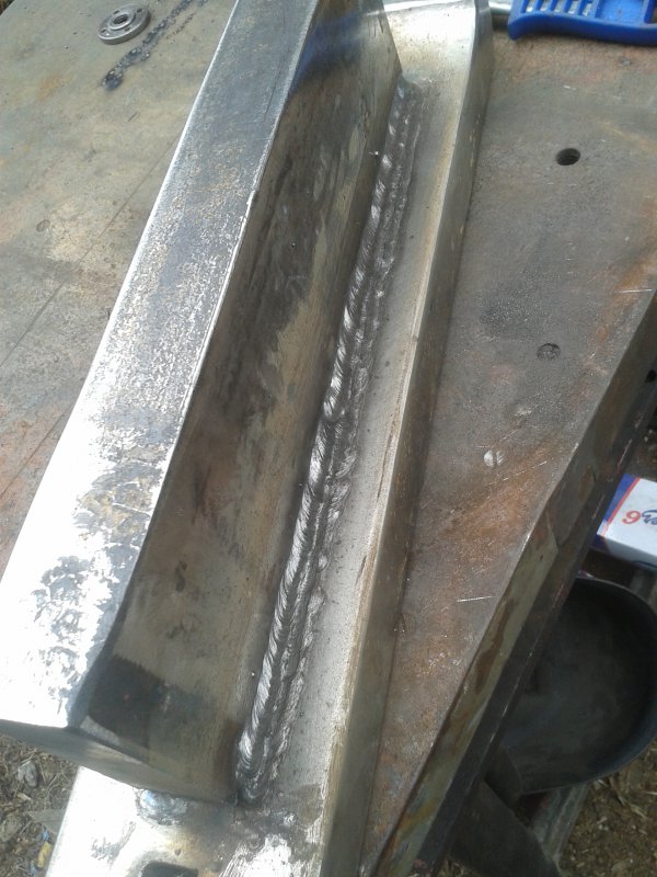

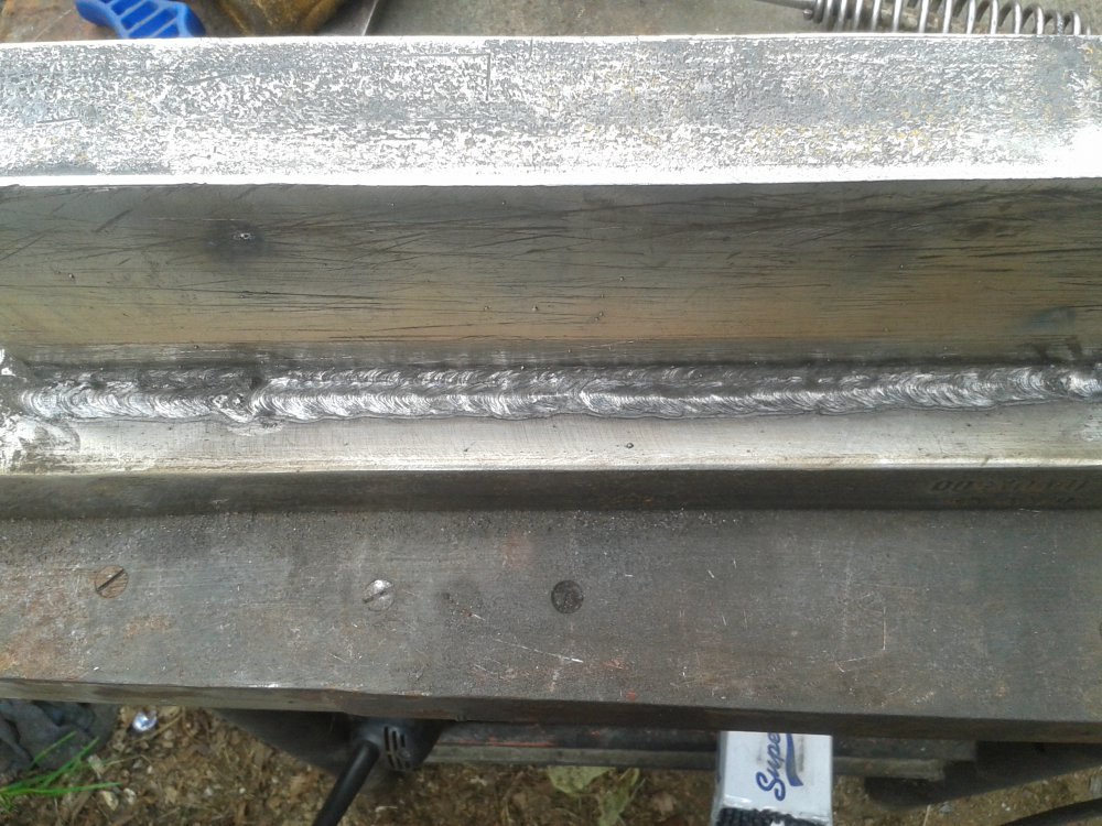

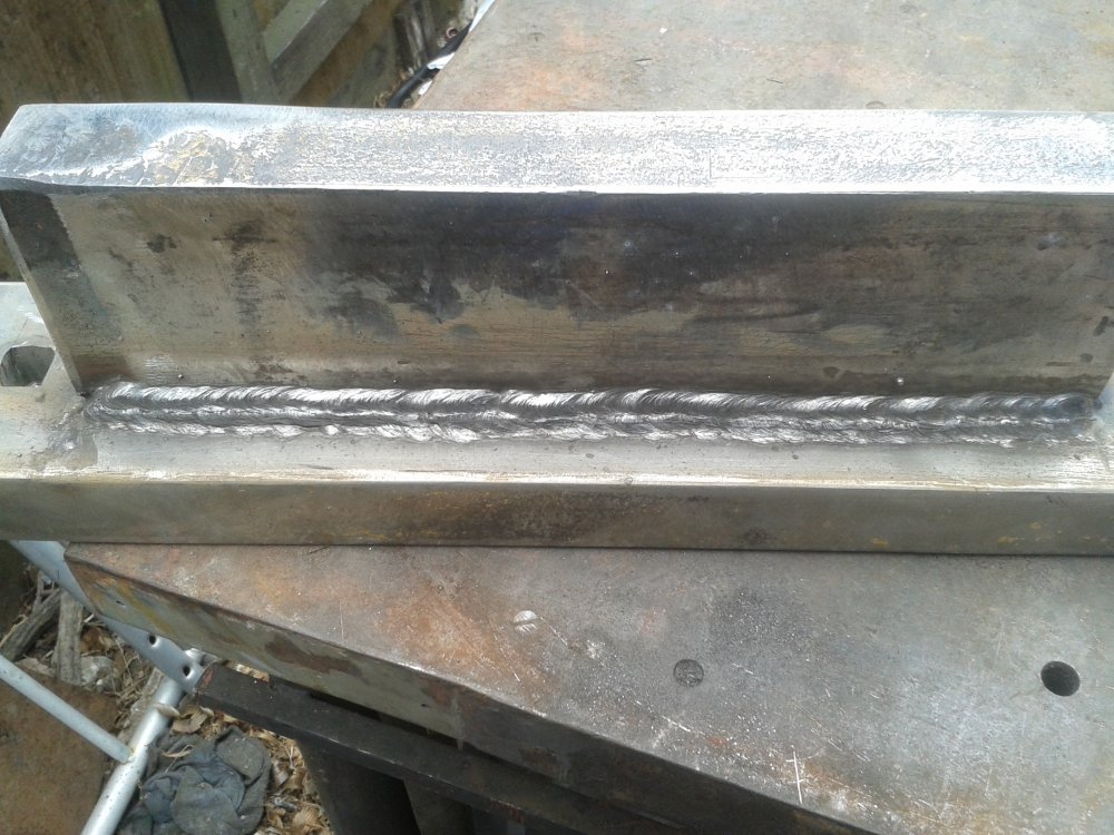

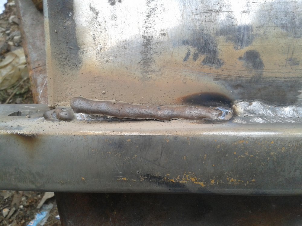

). Weld each side, then check it for square and run the next weld such that it'll pull it into square. Get loads of passes on each side, it'll make it more solid and it's all good practice.
