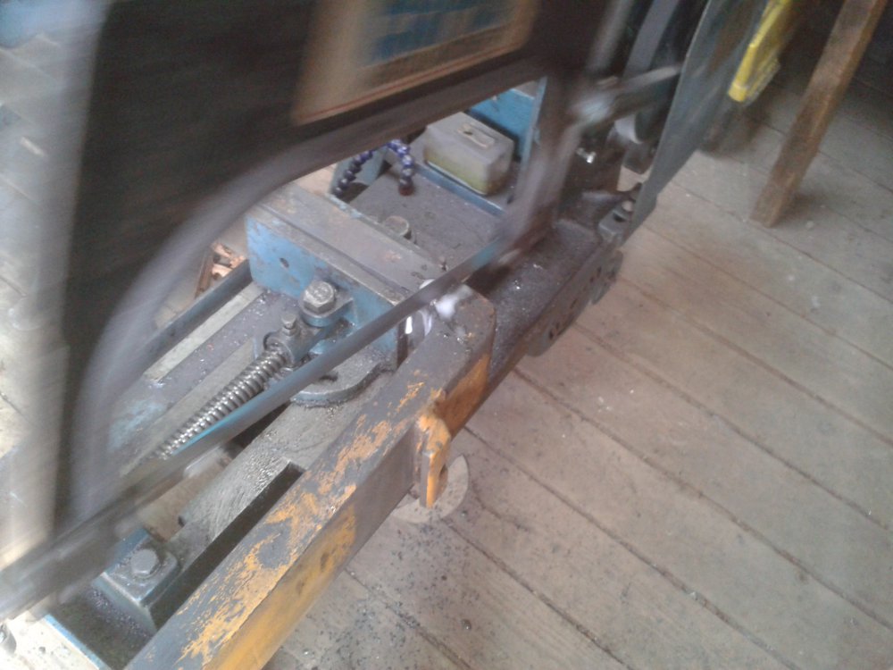

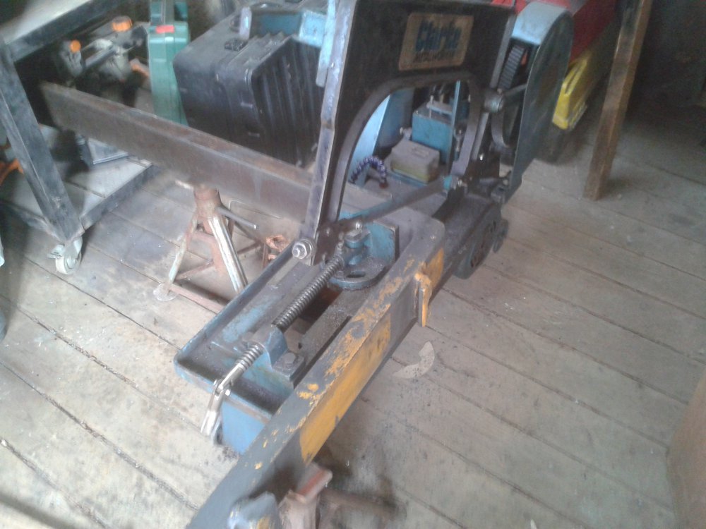

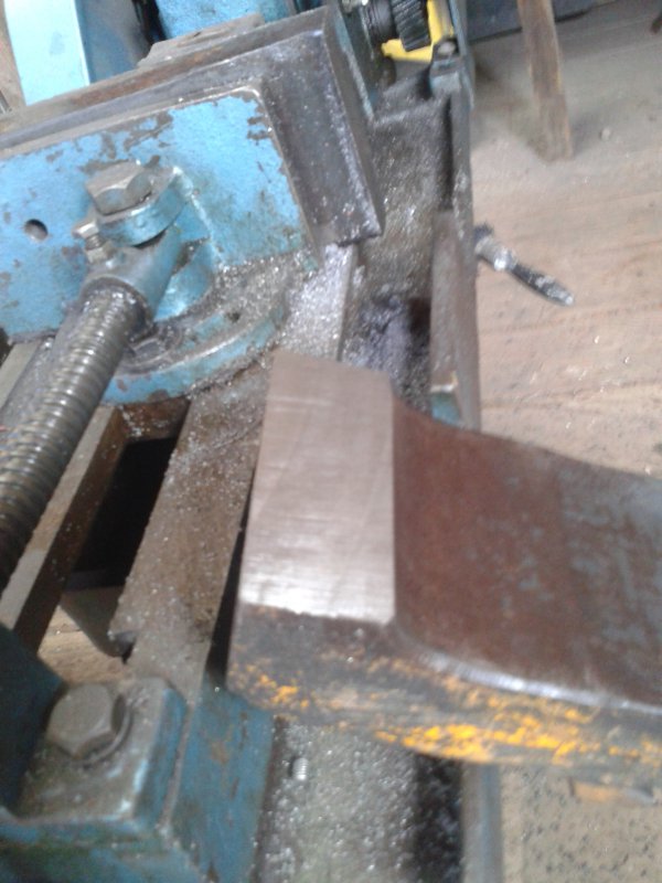

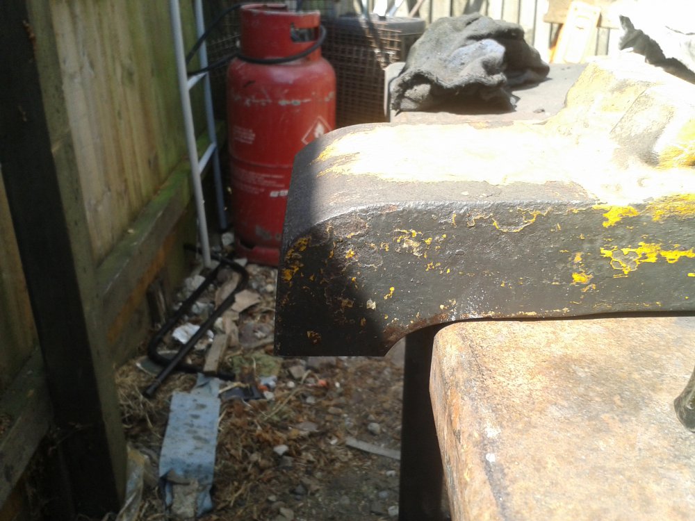

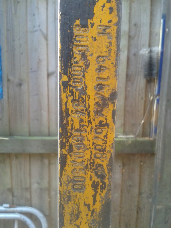

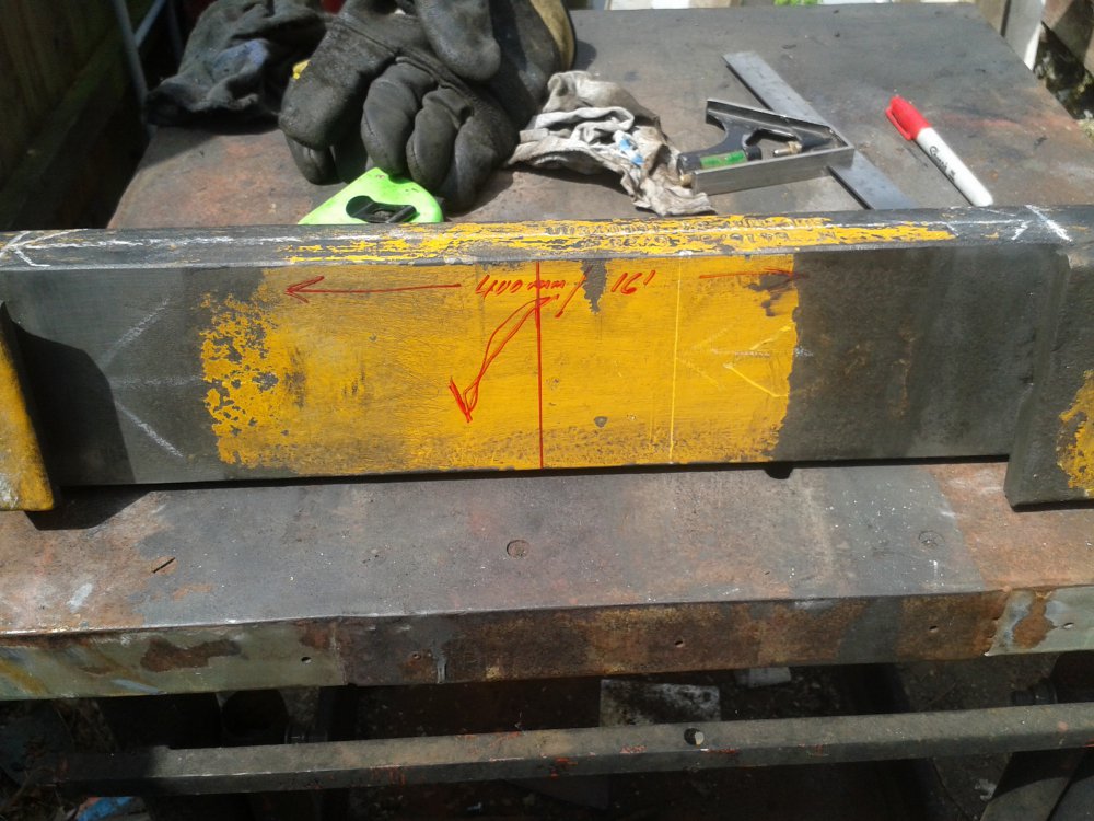

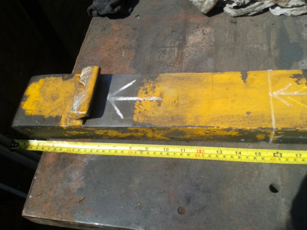

My search for a real anvil got me nowhere,reason being those that were good would cost a fortune,or were miles away,those that were affordable were rubbish.
So the other option was to make one,now i had ideas about one from a rail track,big no there couldn't get a bit,i even know guys who work on the rails,they cant even have any due to everything now being recycled and accounted for,blah blah blah.
Next thing from searching the net i saw another option of using a tine from a forklift,BINGO i cried theres a place near me that does service and repairs on forklifts bound to get one there,yer,er no,due to H&S rubbish they're not allowed to even sell the scrap ones they put in the skip,dont ask ok,but with a few minutes of me explaining what i wanted it for i managed to get one for a tenner(cap in hand and begging on all fours,bloody joke it was)
Right now i have it tucked away in the workshop with me looking at it i want to ask you clever chaps if any of you has made one from a tine before and what design did you find best,doing a bit of net searching theres a conflict to weather i make this up using the vertical method or lateral as it cutting and welding it.
Cutting it in bits is not a problem at all,welding it(i'll be using arc DC+) together i understand 4.0mm 7018 rods are the way to go,yer?
Erm what steel are tines made from?
As for a base i've got 2 options a large wood block or some big mother RSJ's to mount it on.
I'll post progress photos up once i get the green light in my head with the plan
Your input comments are welcomed
Cheers
