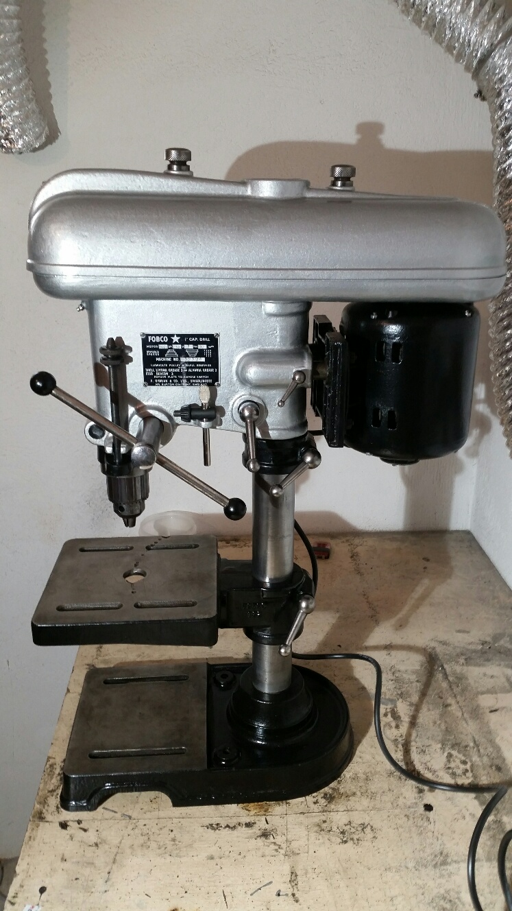

small drills fast ish speed and slow speed for larger drills. a spot of cutting compound if drilling steel cuts a lot faster and your drill bits last a lot longerThanks guys such a pity about the table.
What the best speed to have this on?
Thanks can you recommend a compound?small drills fast ish speed and slow speed for larger drills. a spot of cutting compound if drilling steel cuts a lot faster and your drill bits last a lot longerfill the holes on your table with jb weld it will make it look a bit nicer and less noticeable
