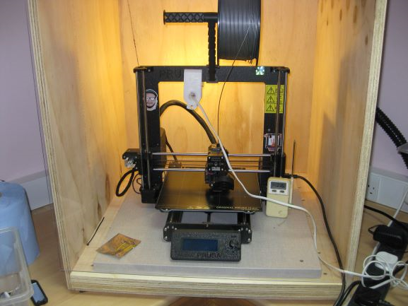

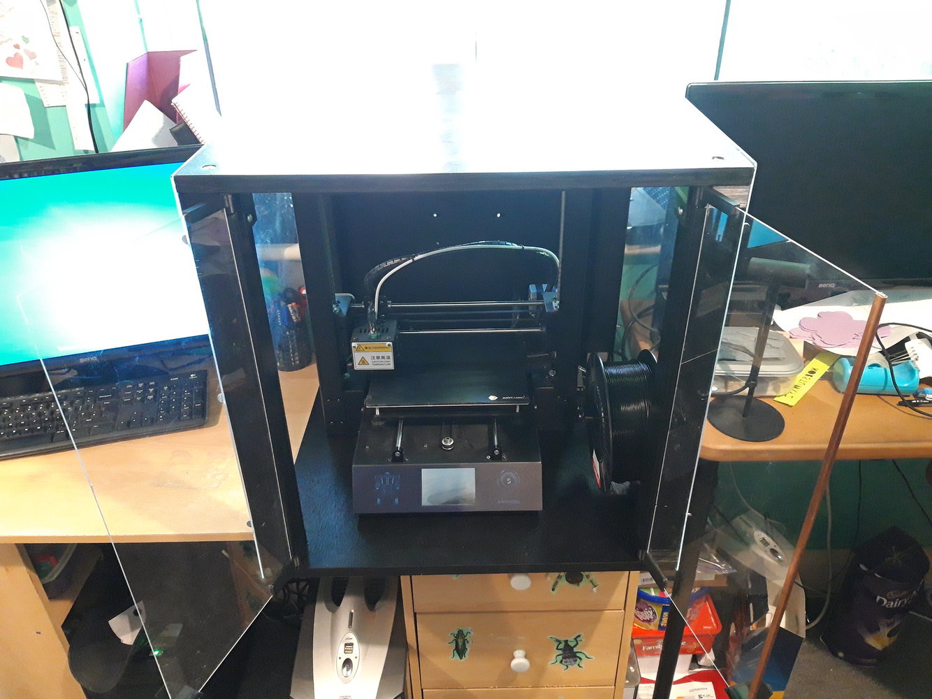

I have an enclosure ..a very substantial one at that .
It's had a polycarbonate sliding front added
So far it has not gone above 22 oC .. have plans for cutting a round hole in the back printing flanges & housings and attaching a thermostatically controlled 2 " computer fan on the back ....ducting heat out of the house through an outside louvered flap via a pond water discharge pipe .

If you do that then wherever the intake air is coming from will cause a cold draught over your print and negate the point of the enclosure.So far it has not gone above 22 oC when printing .. I have plans for cutting a round hole in the back , printing flanges & housings and attaching a thermostatically controlled 2 " computer fan on the back ....ducting excess heat out of the house through an outside louvered flap via a pond water discharge pipe .

I use ABS Pro.Watch the electronics getting too hot in an enclosure. That's why we haven't yet tried anymore ABS.

It will drag air in at the very top of the case front to an enclosed point 2/3 up the back wall , yes there will be some cooling effect but a simple slide across the hole baffle will allow me to regulate the air flow to a real baby breath pull to remove fumes . It will be a case of suck it and see , maybe even putting in a max & min temp range controller like I have made for my heated propagation UV light beds. I'll post more as things developIf you do that then wherever the intake air is coming from will cause a cold draught over your print and negate the point of the enclosure.
