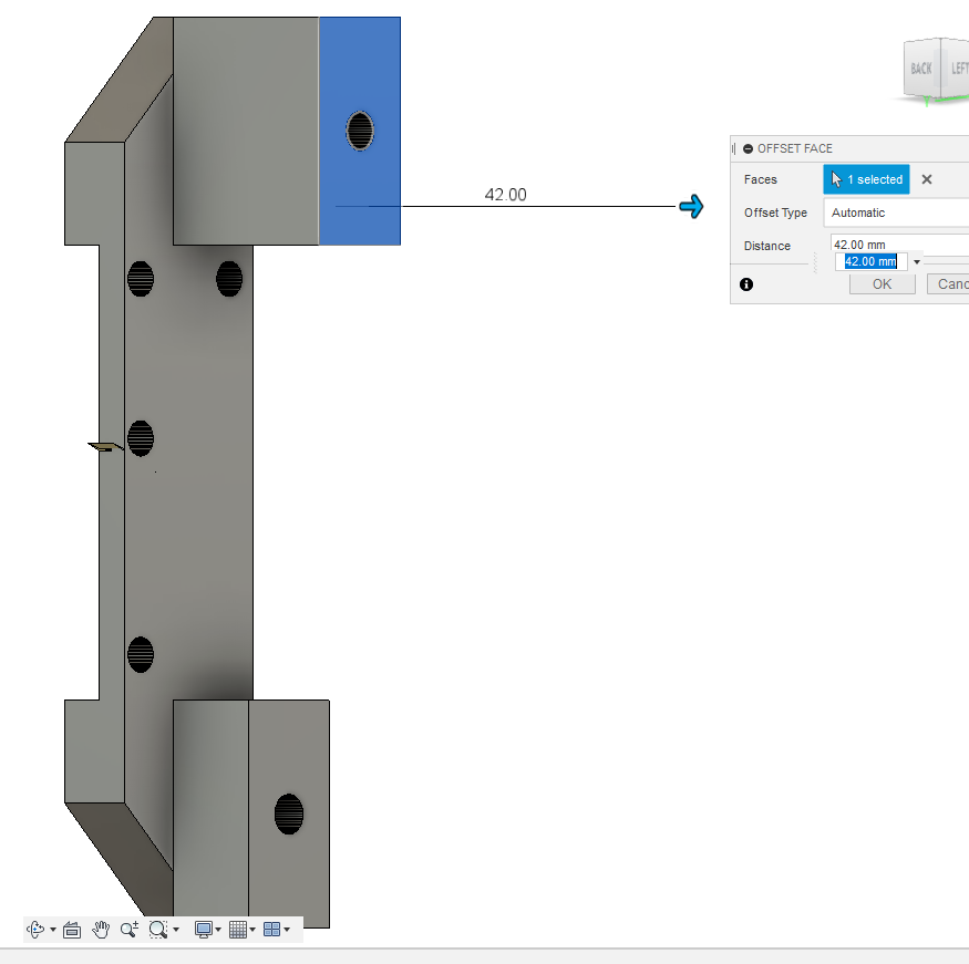

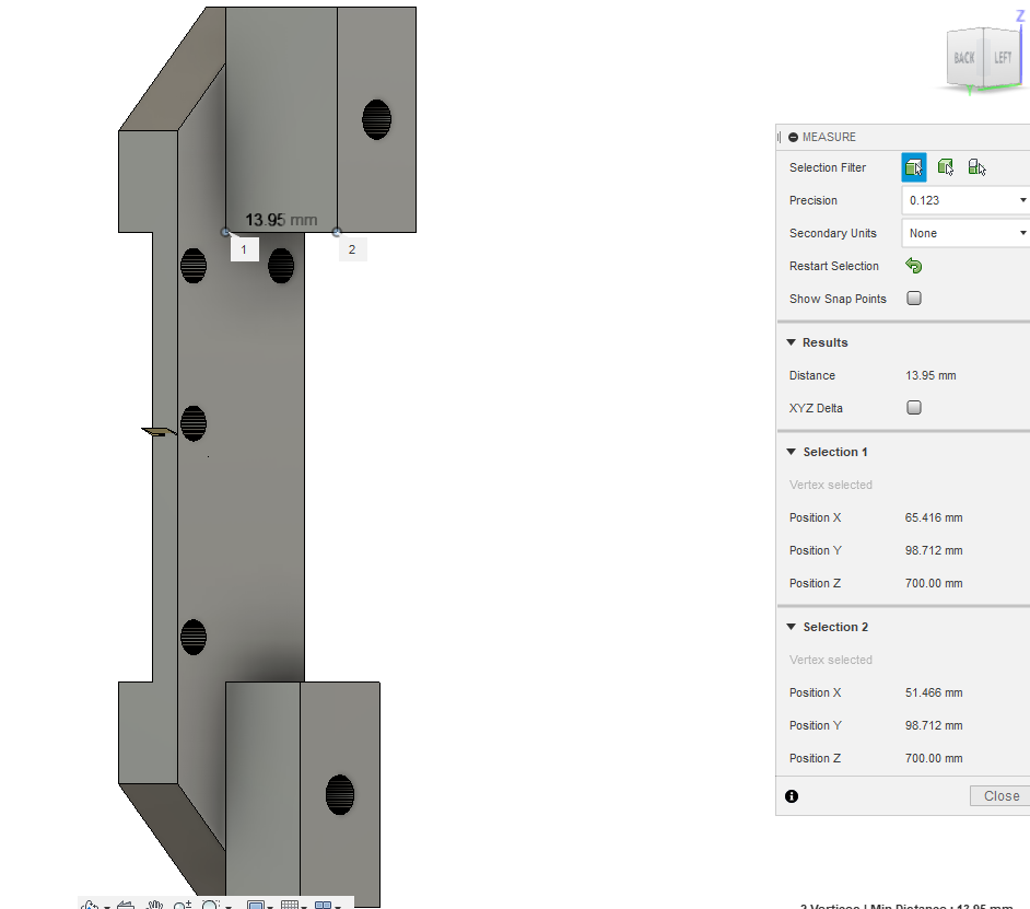

Yesterday I spent hours, litterally hours (in fact I almost found the solution in one of lars videos) lol but I was trying to work out how to extrude a section of a bracket. Sadly I cant see how to extrude to a specific length as it shows a much larger value than the measuring tool in inspect does.
View attachment 240086 View attachment 240087
