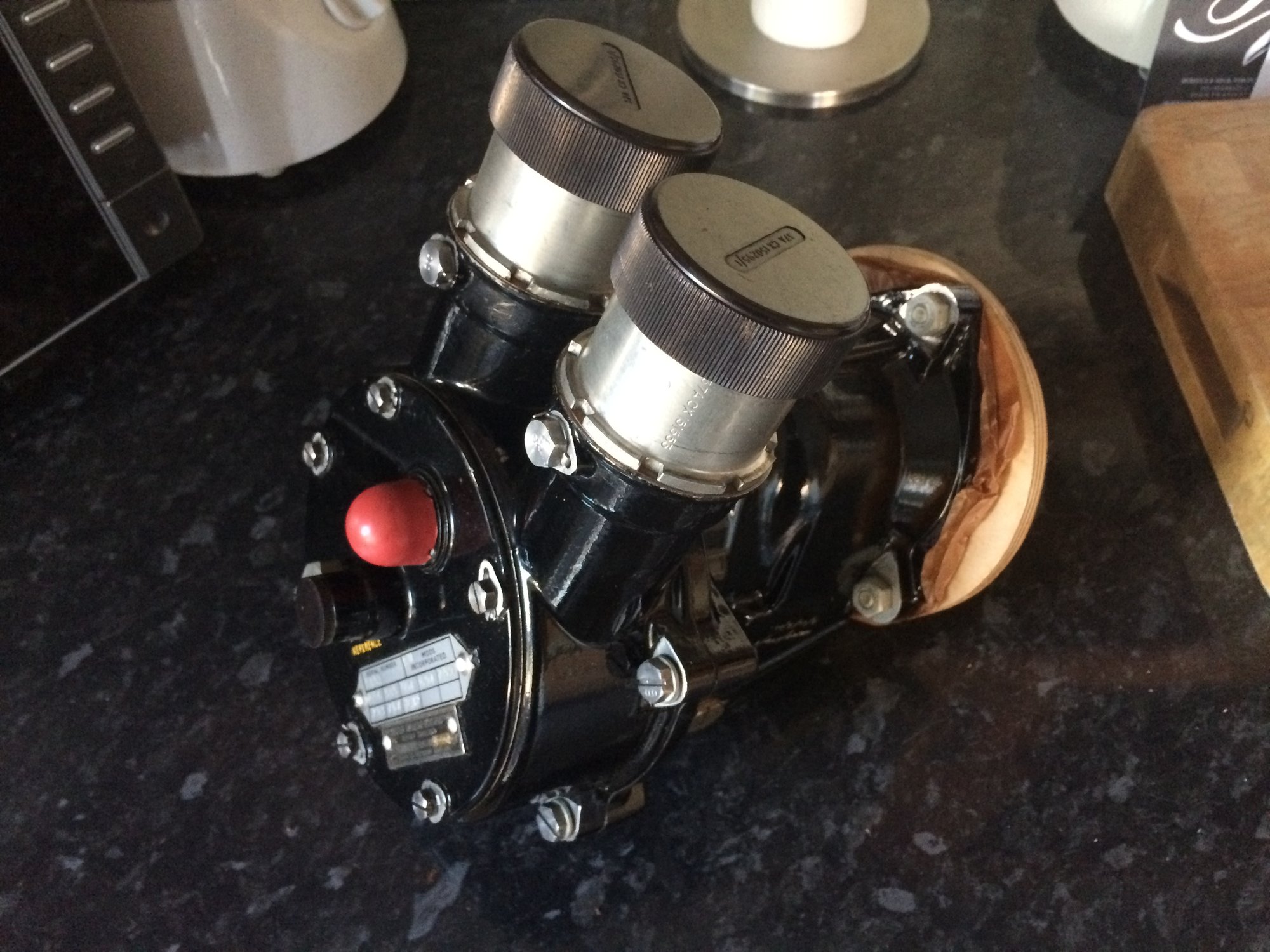

    Found a box in the loft with a reconditioned magneto in, probably came from Coley’s scrapyard. Dated 1966 and in perfect condition with a service tag too. :D

    As you do :D looks bloody clean. Handy to know where one is in case I need one!

    Tempted to stick it on Ebay so it can be become a lamp! :laughing:
  9. KemppiFrog Member
    Messages:
    3,183
    Location:
    Aquitaine
    Philistine!!!

    Looking at that mag again @Wallace , it might be for the 14cylinder Leonides major, as it doesn’t match whats fitted
