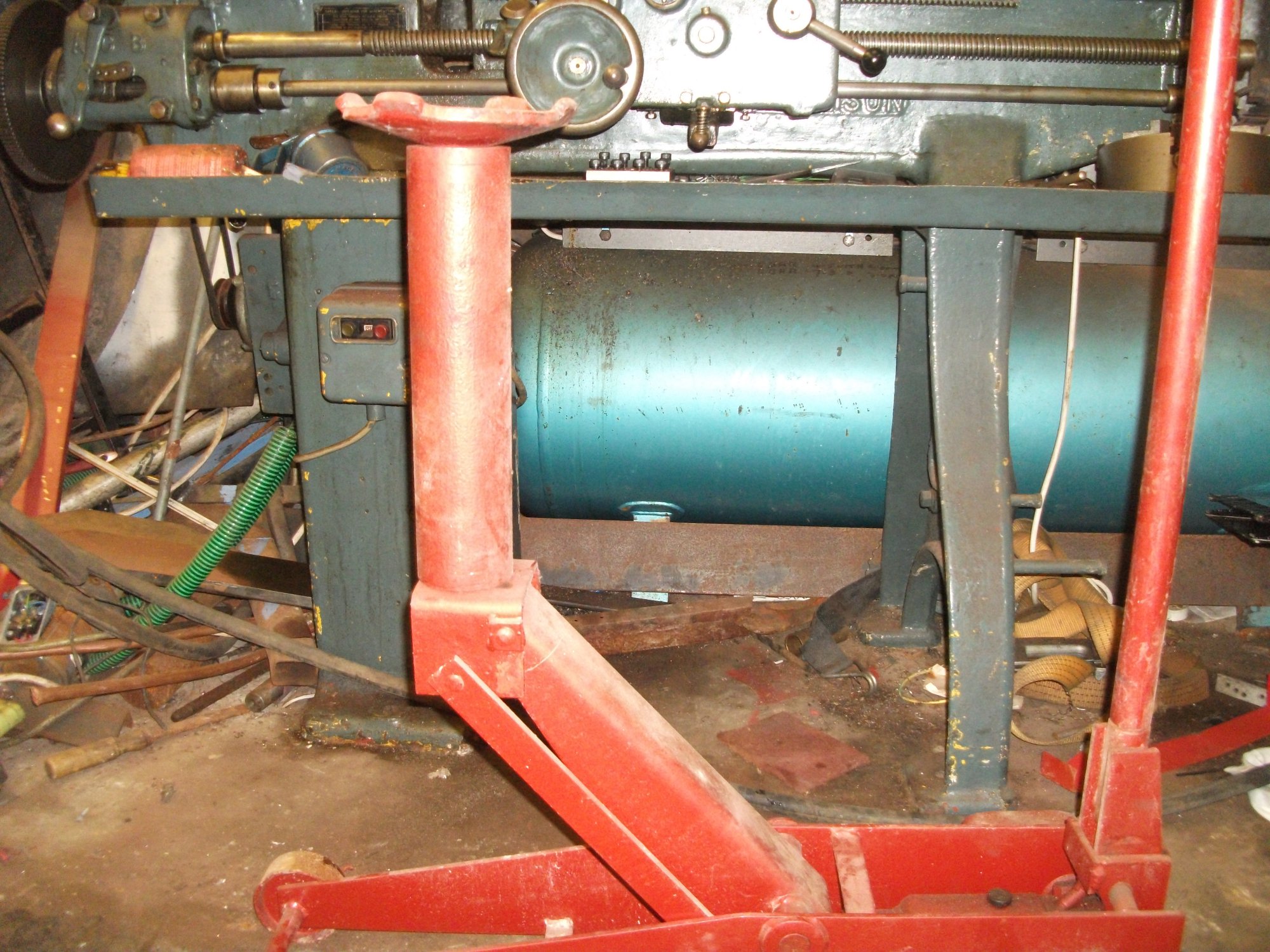

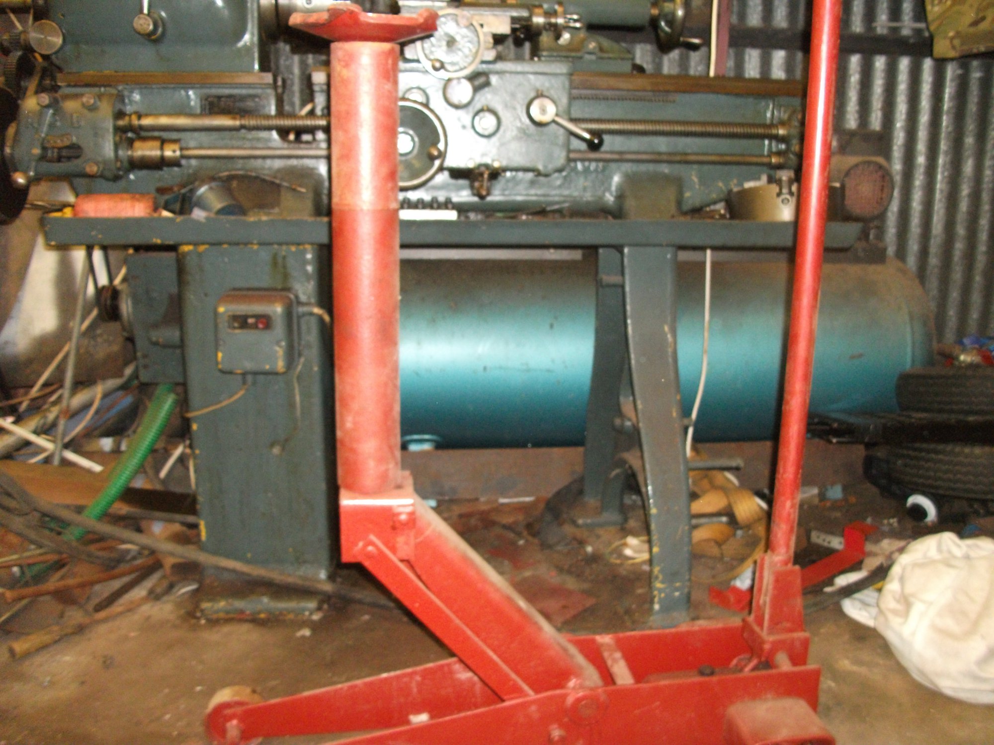

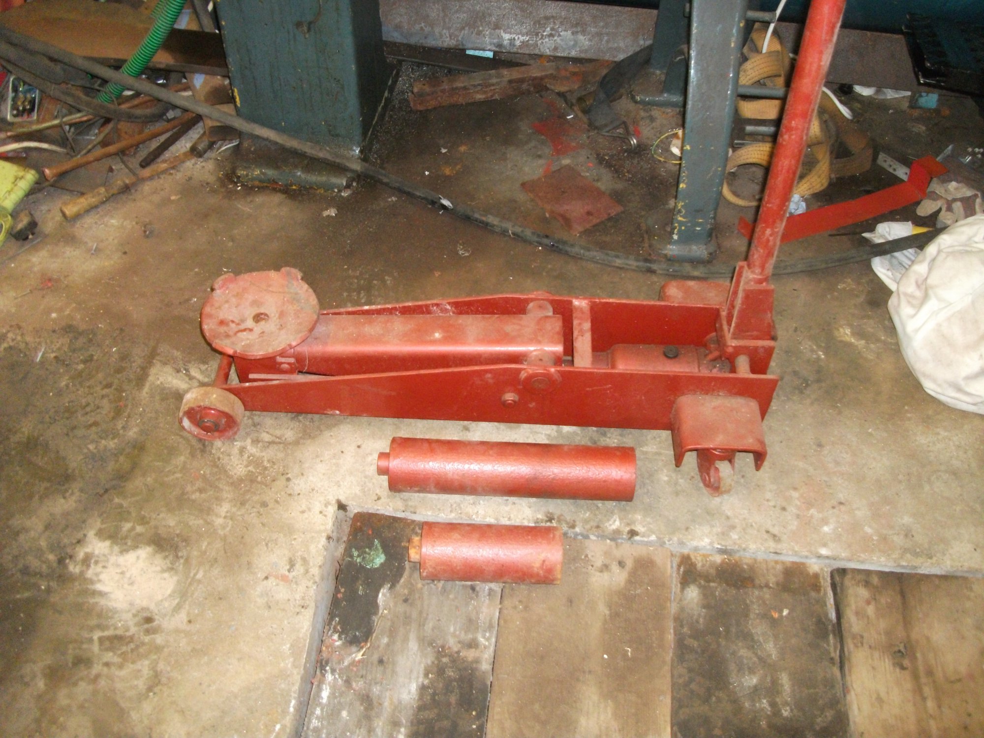

I have a 21inch trolley jack very substantial. I made some extensions for it and can lift a car on to builders tressels I convertedStill won't get it high enough to allow working standing underneath it.
In fact for sensible home use I don't think it's possible.
