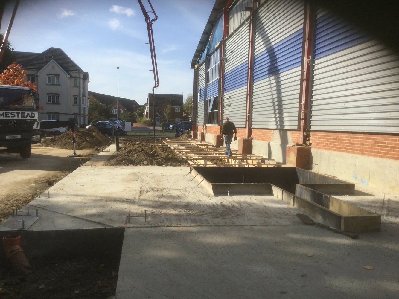

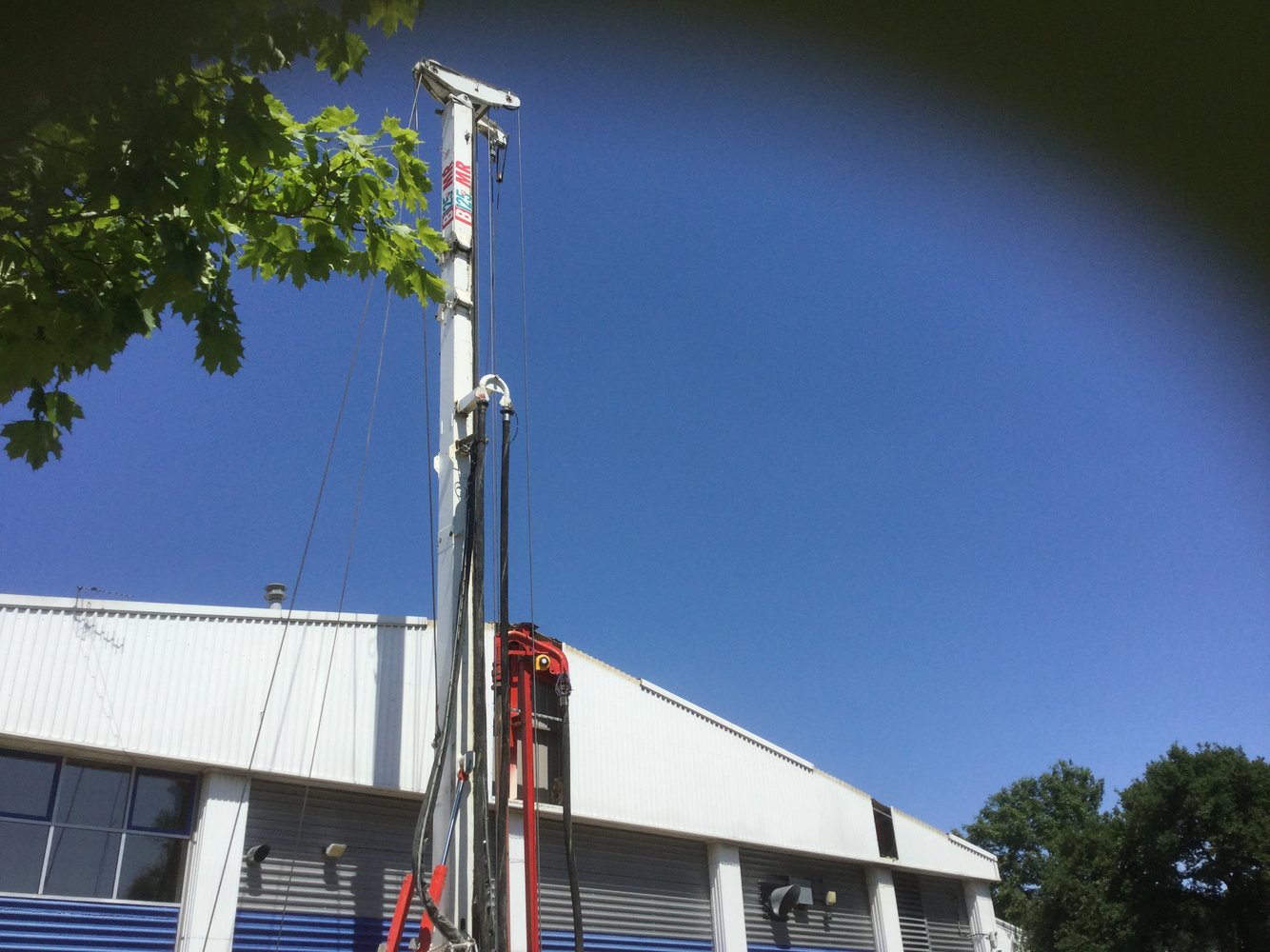

.Very nice, doubt they'd do much here other than having me spinning around hanging onto the motorExample, manual drill bits.

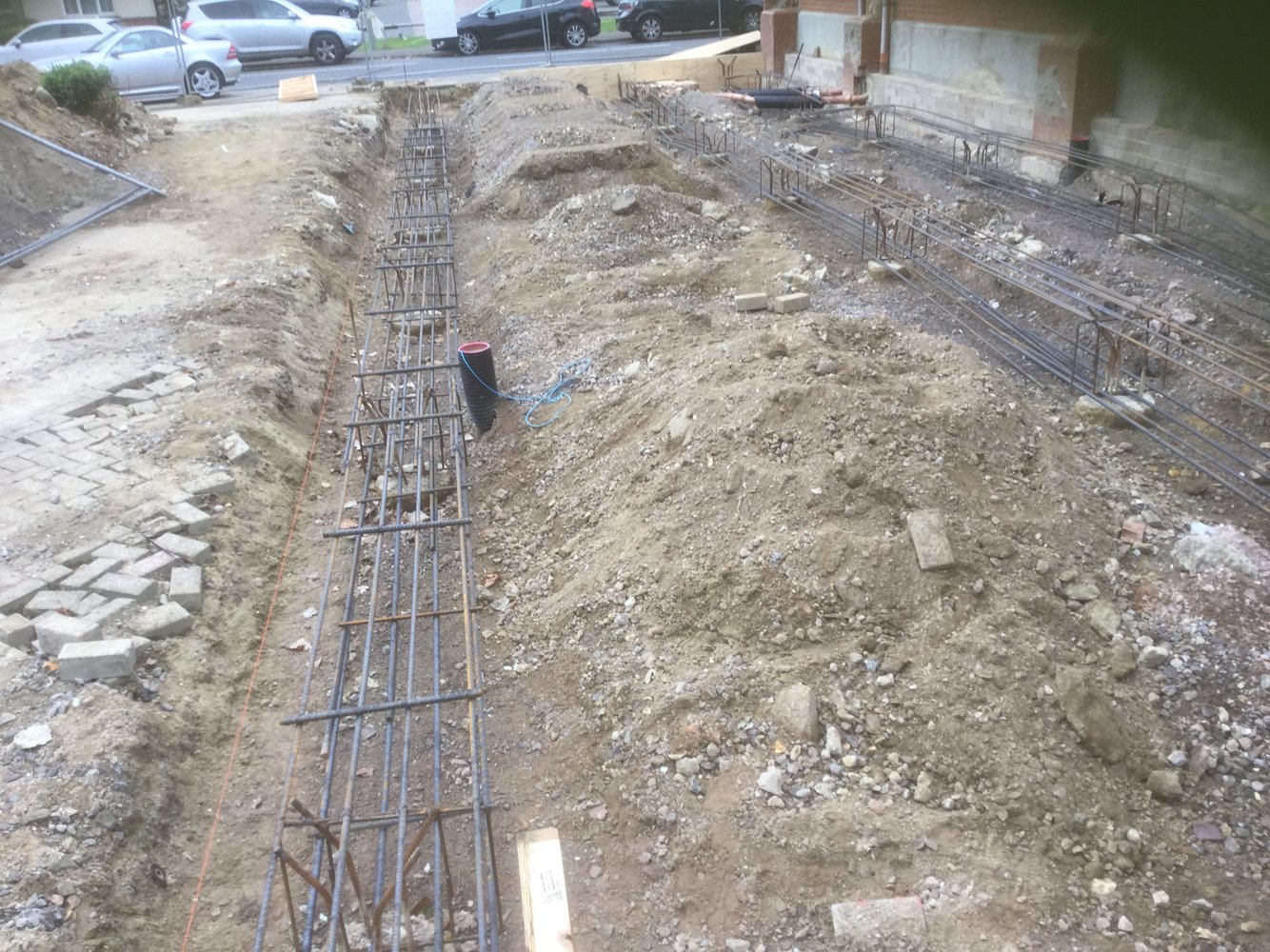

View attachment 412587 View attachment 412588 View attachment 412589 View attachment 412590 View attachment 412591

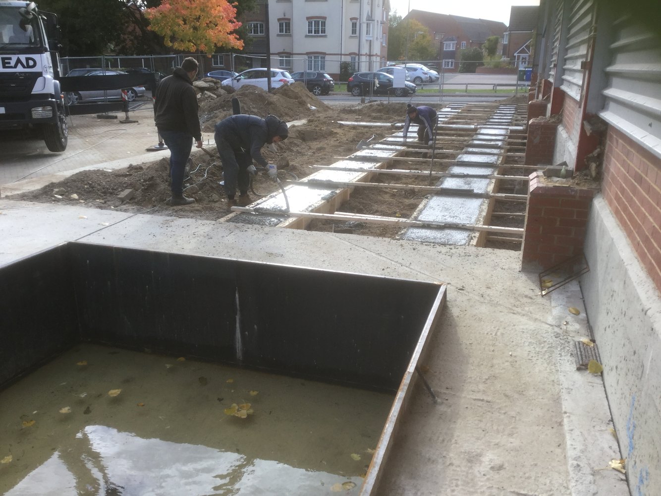

It was an option but they wanted to test 1st..being a tight Yorkshire man I went with digging.A gurt summer house at a clients place was supported on ground screws, never seen them before that but they seem to be common place now.

I drilled a 24" hole thru clay, blue clay and then shale (had smoke coming from the hole) min. 48" deep, with an auger attachment (rented for $75 a day) onto my small skid loader.No the volume and the surface area are important factors therefore a cylindrical hole has to be bigger than a square hole. If you made a cylindrical hole that fitted inside the square hole you would have a lower ground bearing capacity.
A 450 square hole can if need be be dug with micro digger. Whereas a augered hole would most likely need a 2.5t- 3t machine which isn't often a viable proposition for a back garden
What do you think they use here, then?When I lived in the Netherlands everything was built on piles...even tower blocks

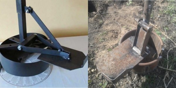

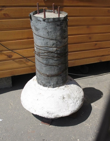

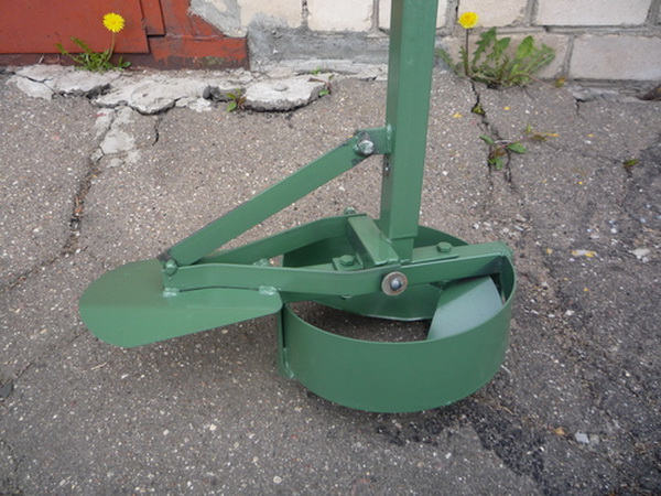

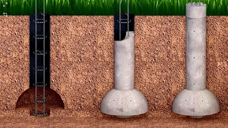

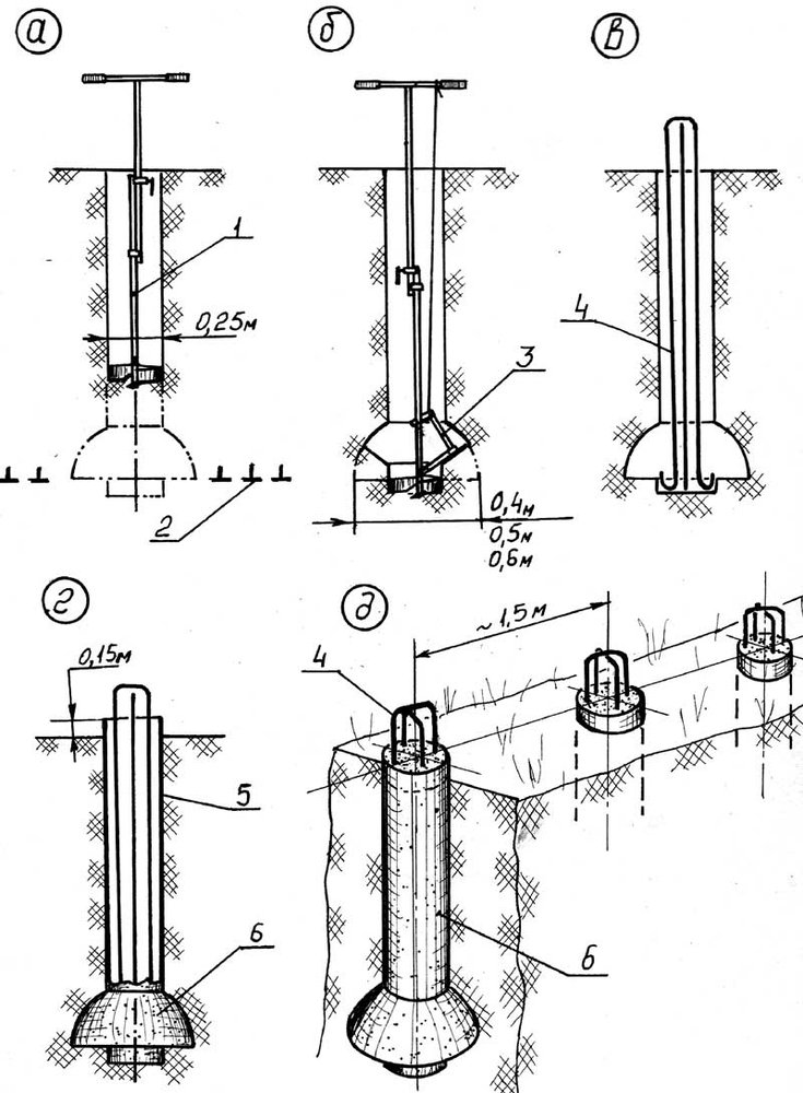

On my building I drilled 12-14" dia holes, and set 8" sonotubes with a re-bar cage & weld on bars on top. Qty (21) of them.I saw for a long time on the net drilling options that expand the bottom of the well. The concrete forms a cushion, with a larger footprint. Prevents pile pulling in winter, good pinching.

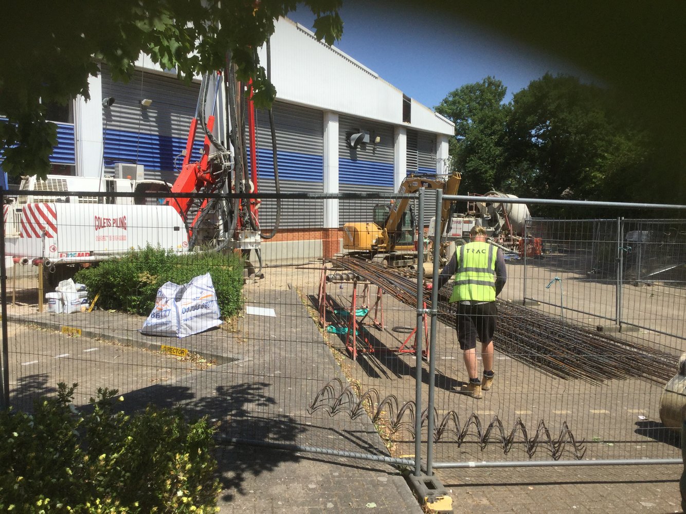

Talking to a mini-piling guy once he said they do a blow count to judge if the pile friction is high enough. This was tiny piles about 6" diameter that the guy was hammering in with a tubular weight. He cut and welded a point on the first tube then welded on subsequent tubes and kept walloping them down until his blow count was high enough to stop.
