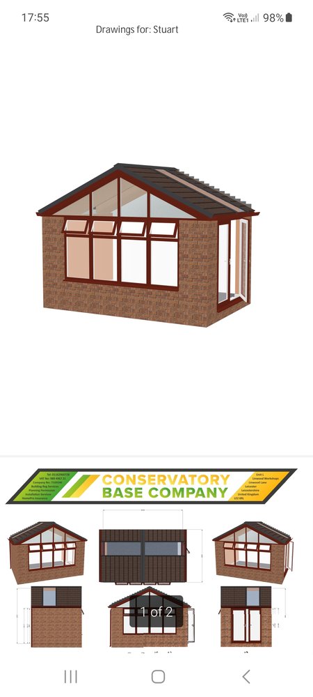

All the calcs are done, the manufacturer has pre approved the system with jhai(building control) so providing you follow the instructions(I broke the rules and read them ) so it's just a case of inspection/photos as required.That is interesting to see a modular build system for extensions.

It's going to look like this, albeit we decided to clad it as the brick slips are imperial so wouldn't match up to the walls. It's all sips and the roof is tiled with lightweight tiles, there's also 2 700mm wide rooflights that run from ridge to fascia..Is it going to be a glass walled and roofed structure?? Or is it brick above dpc with a tiled roof??
Independent building control are checking it. Local guys were exceedingly unhelpful, then they were upset when jhai notified them lolJust bear in mind that regardless if the system is building control compliant or not you must still make a building control application with your local authority and they will normally call out to inspect the ground conditions and foundation pad pour etc.
Without this, if you go to sell the house in future it would be flagged up and building control could insist that part of the founds are dug up for inspection etc if they didn't get an application at the time.
This is meant to assist and its no odds to me how you do it just bear this in mind.

It's a fully fledged extension so obviously has to be certified.
On paper it beats latest building regs by a mile

The area is clay so 1m, unfortunately the structure warranty needs 300mm below dpc so holes ended up @1.2m in the end. It's a typical modern build estate so top 450mm was horrible digging being full of builders crap. Because of this the holes all ended up between 550mm and 750mmI presume your in very good ground.
