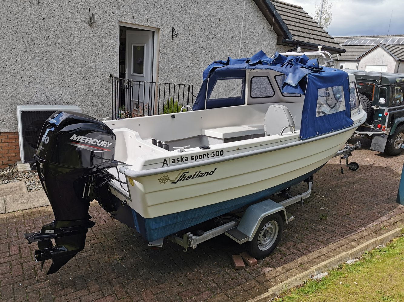

New engine out the packing case -
Engine crane essential for the 217 Kg outboard as my brother applies sealant to the bolt shanks -

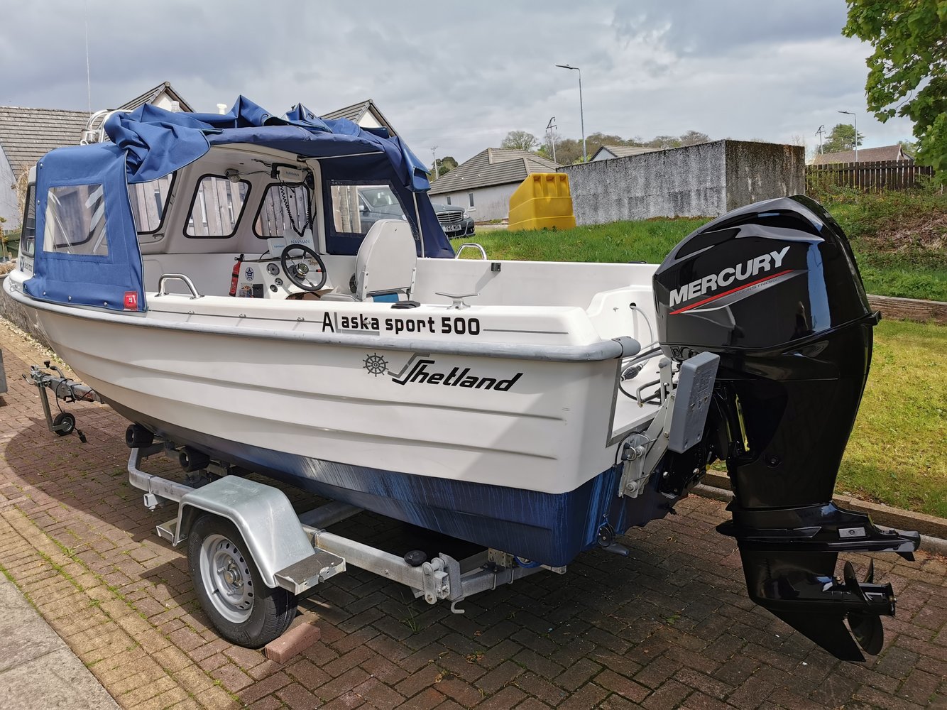

New engine torqued onto the transom -
It looks faster never mind only an extra 10 hp over the old engine -
Still needs a coat of polish -

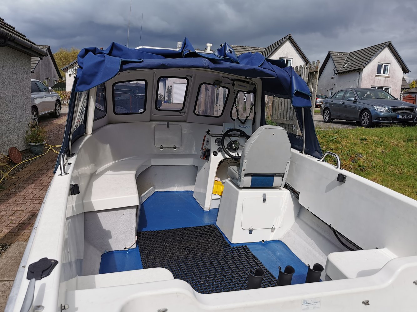

I have left my brother painting the deck, will fit the controls and start on the rewiring tomorrow, just happy to have the new engine fitted.
