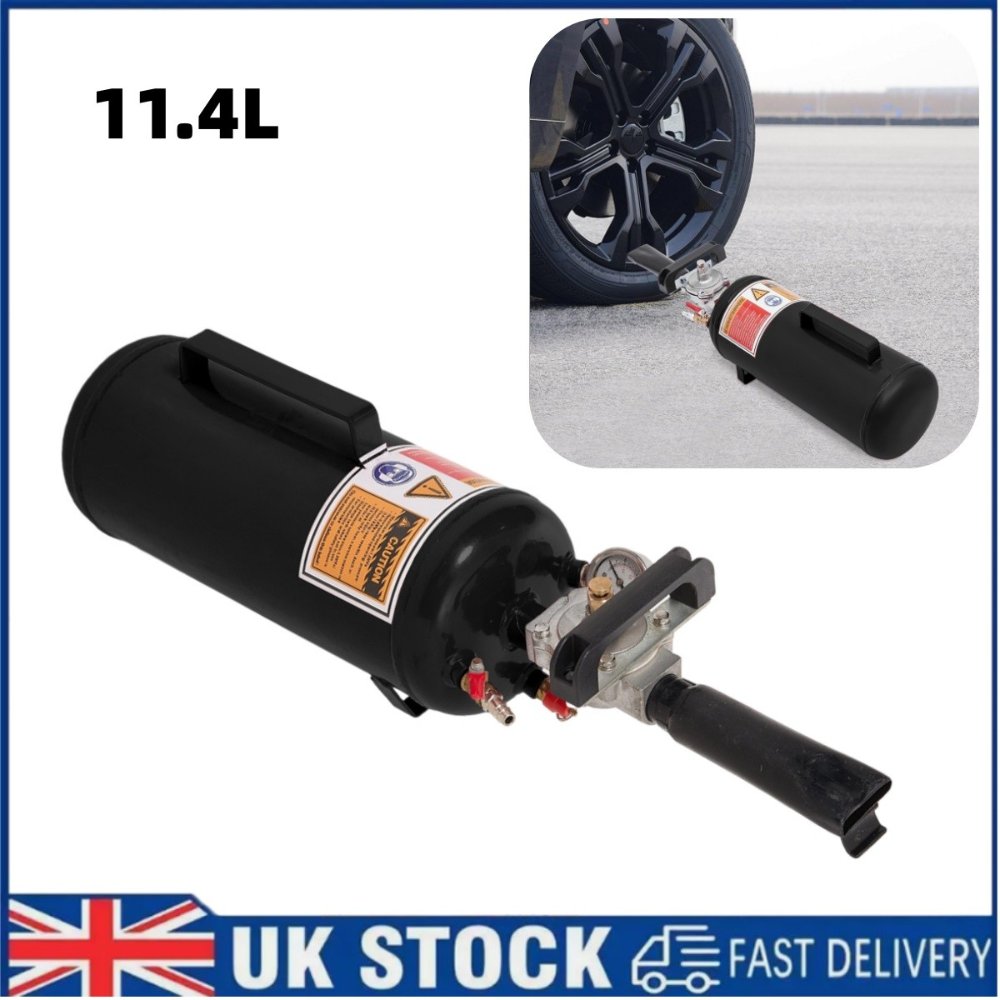

34" long, 1 1/2" pipe, appears to be roughly 1.1 litres.
So I think the big 9L version is a mistake, I'll try a 2L tank and a ball valve.
Mine was a c02 extinguisher but I bored the end out and tapped larger, to get more flowWould that old zip tap CO2 bottle I gave you be a good basis?
Maybe charge it as required off of a 12V compressor?

Yes thats what I'm thinking but the outlet may be small. I'm not sure it will matter as projectile is heavy and will take time to start moving.Would that old zip tap CO2 bottle I gave you be a good basis?
