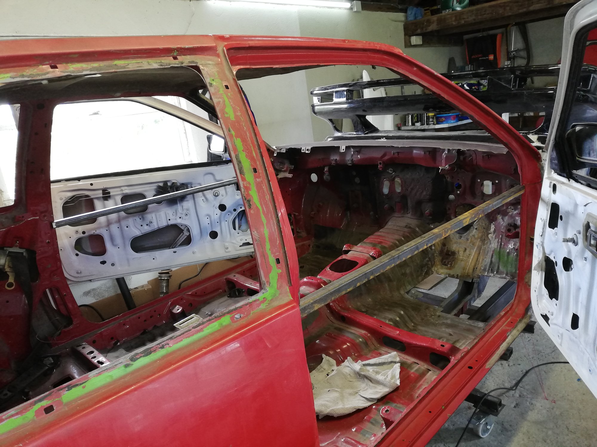

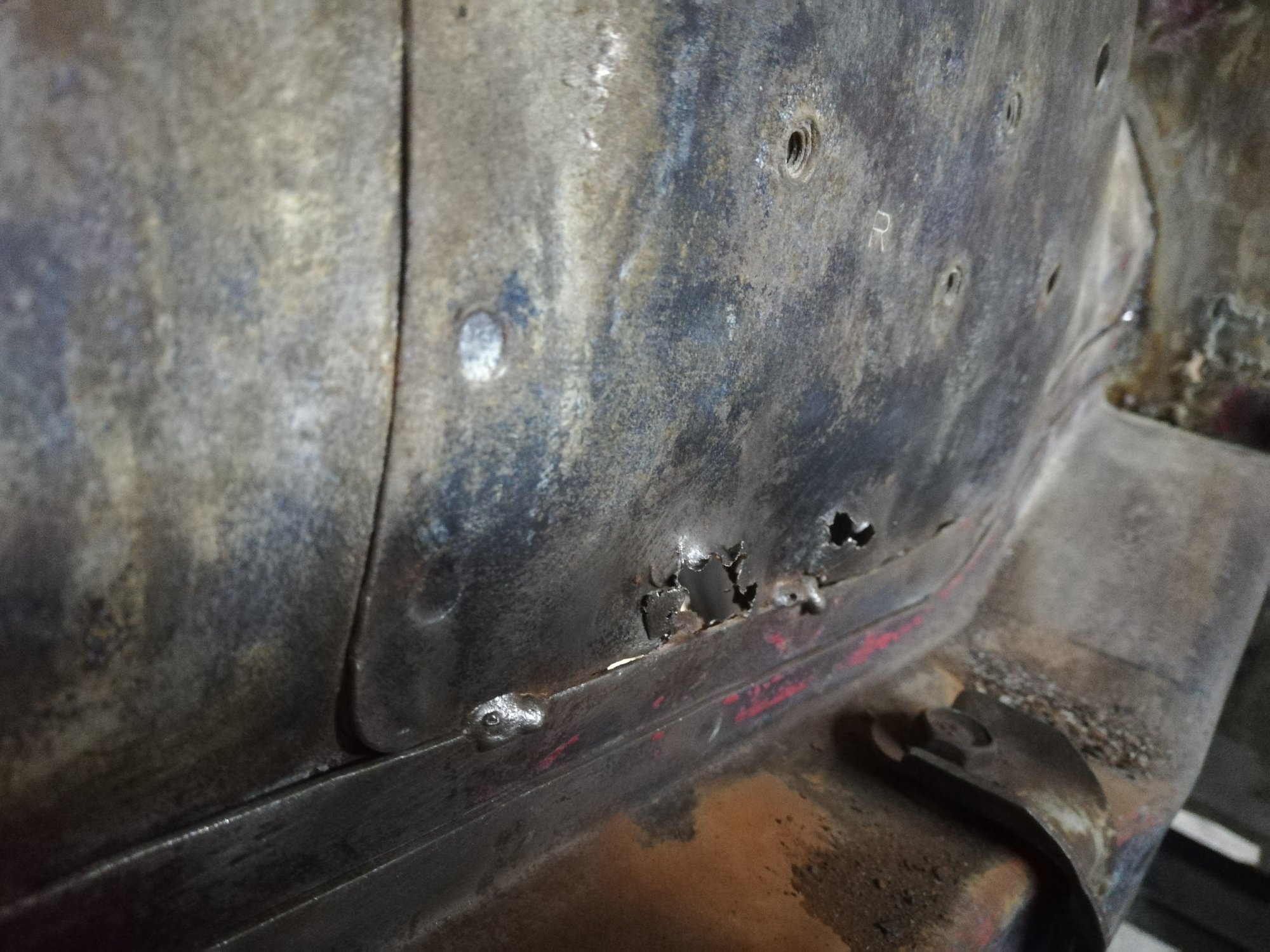

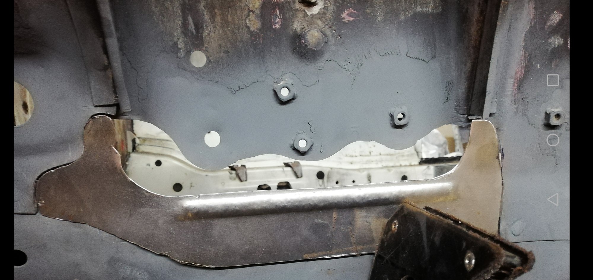

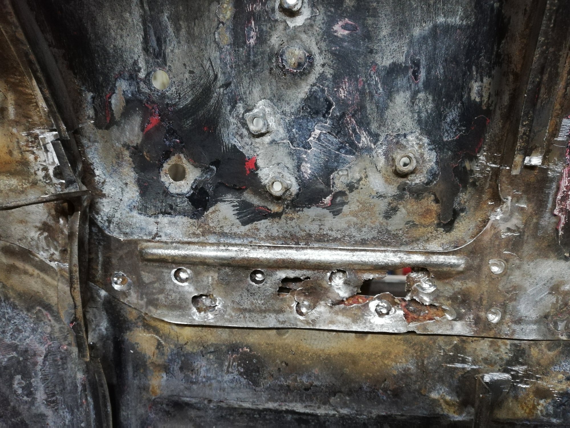

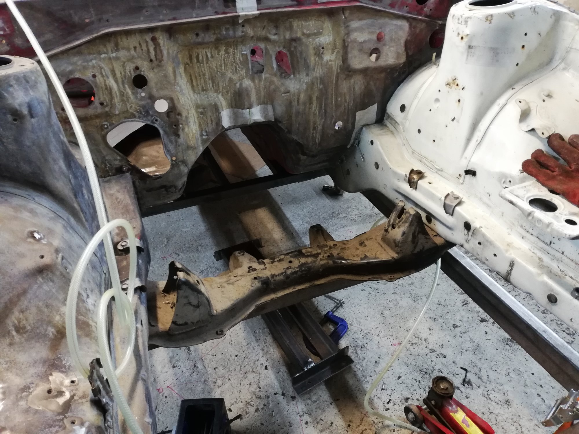

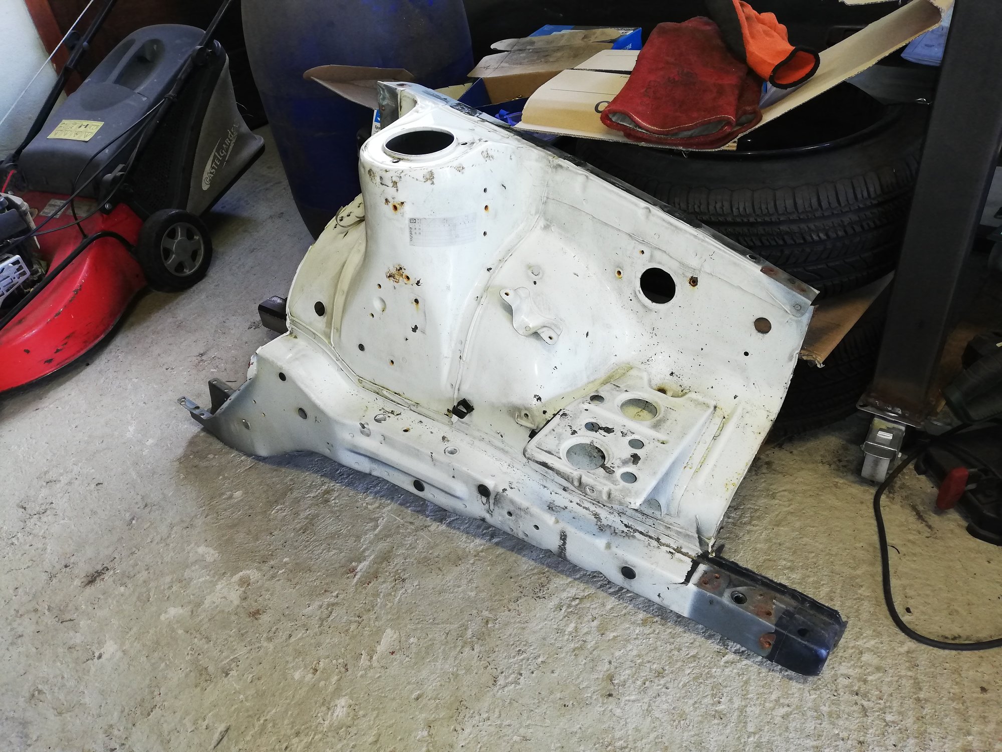

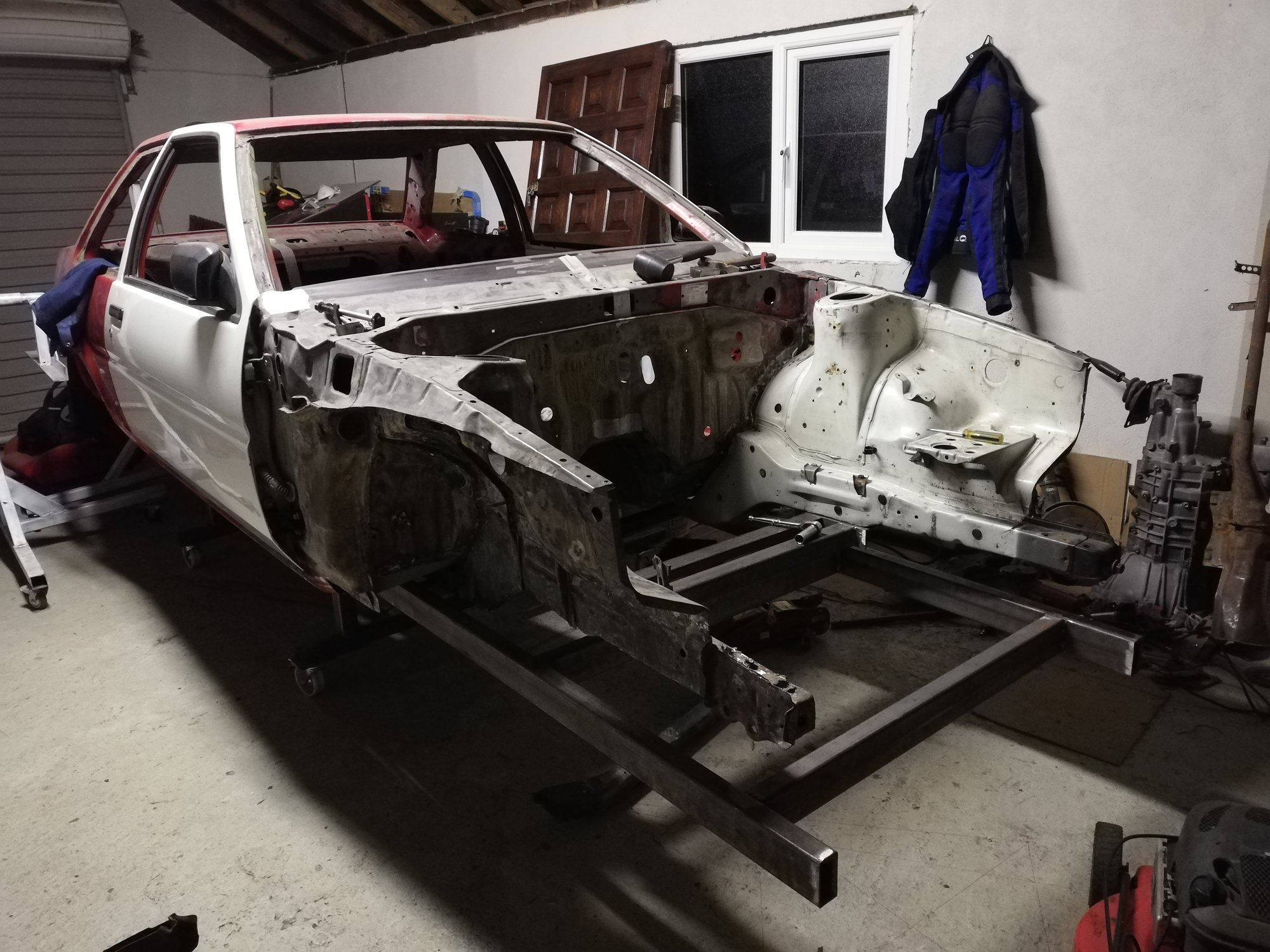

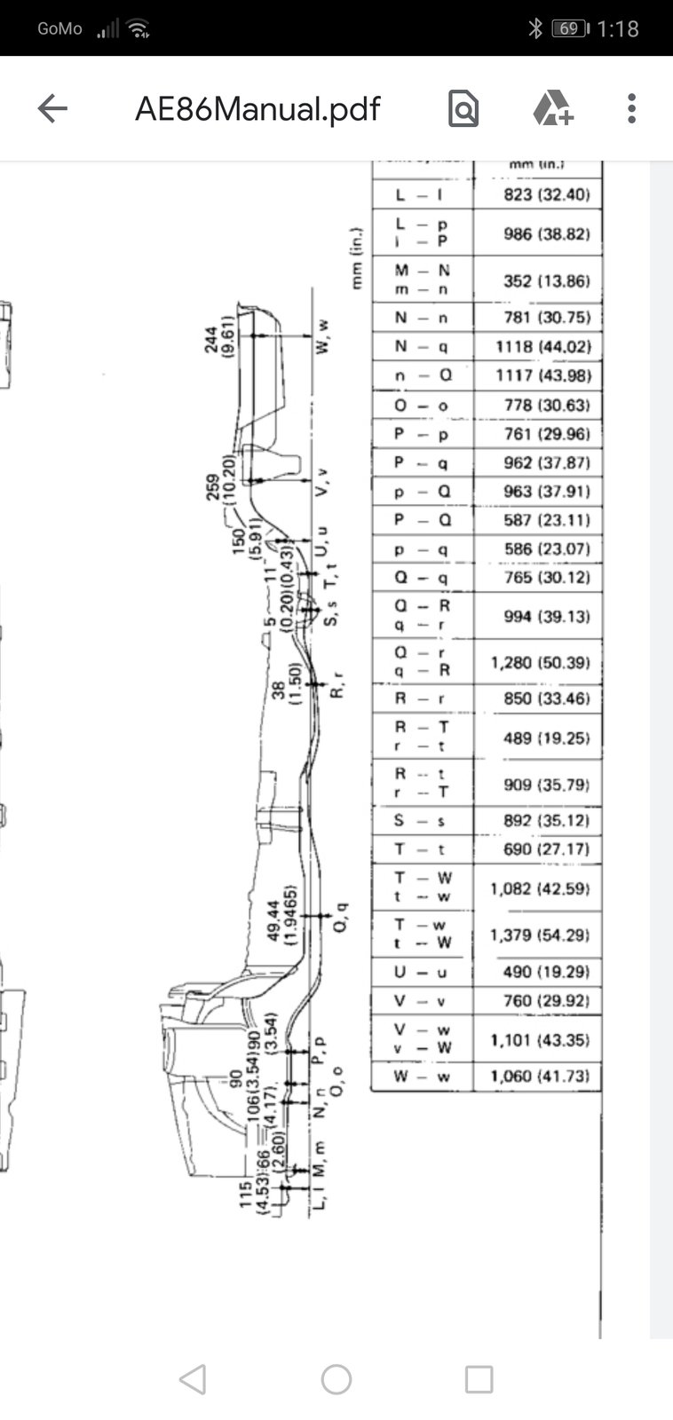

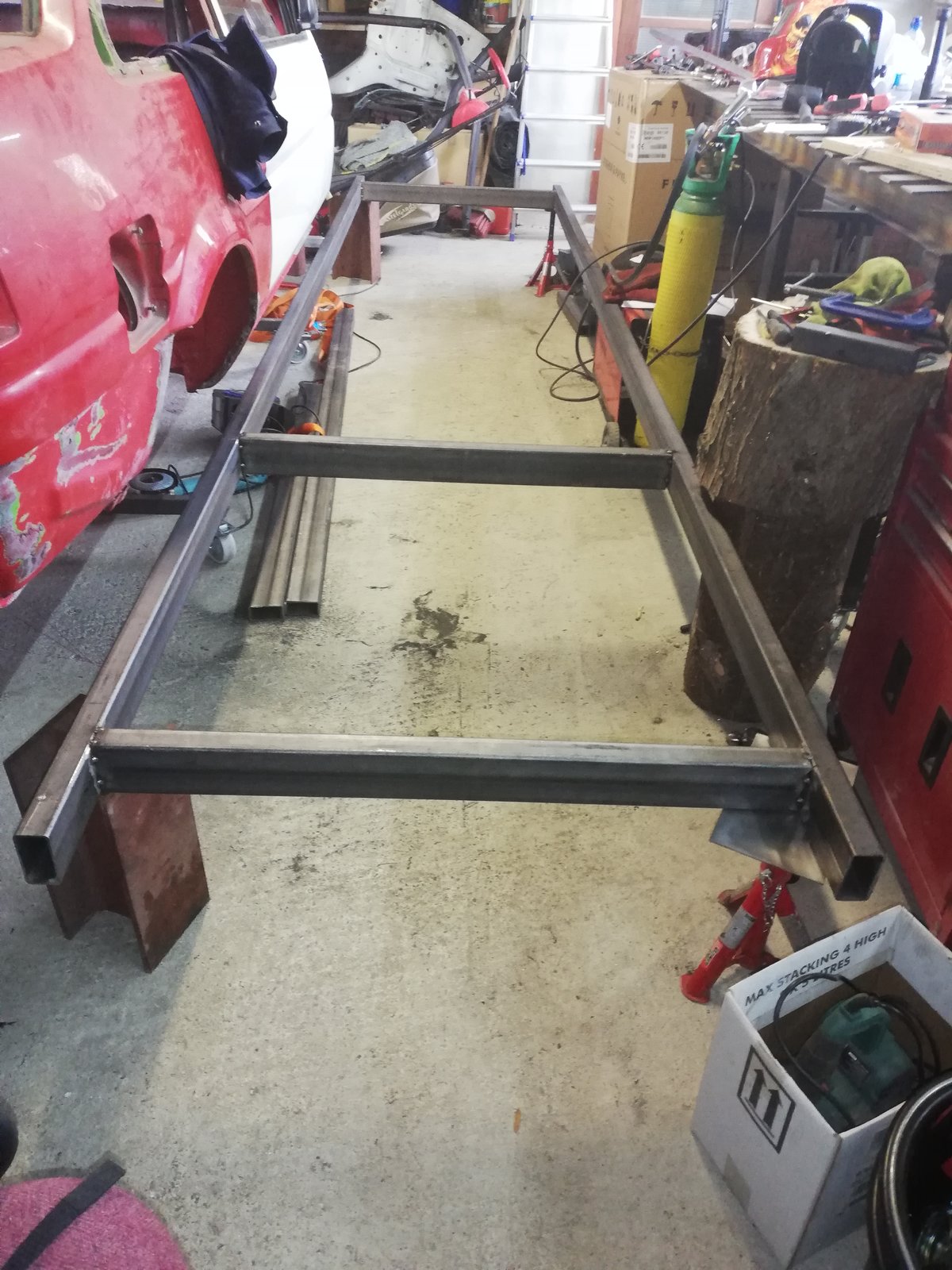

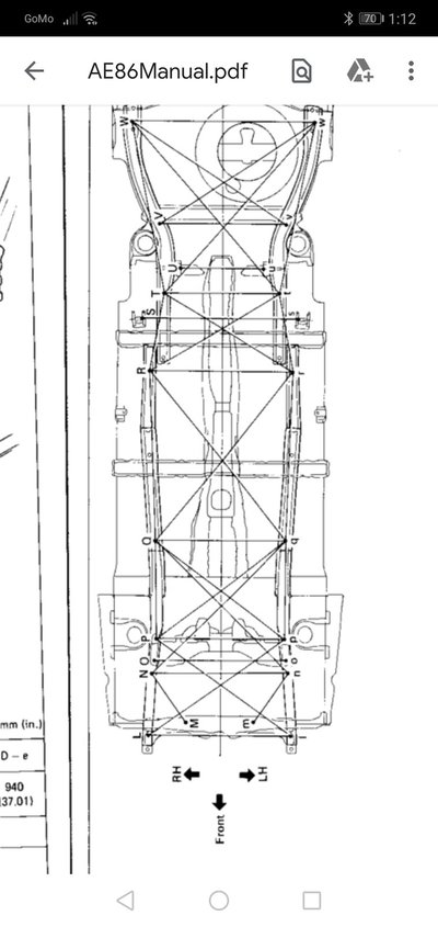

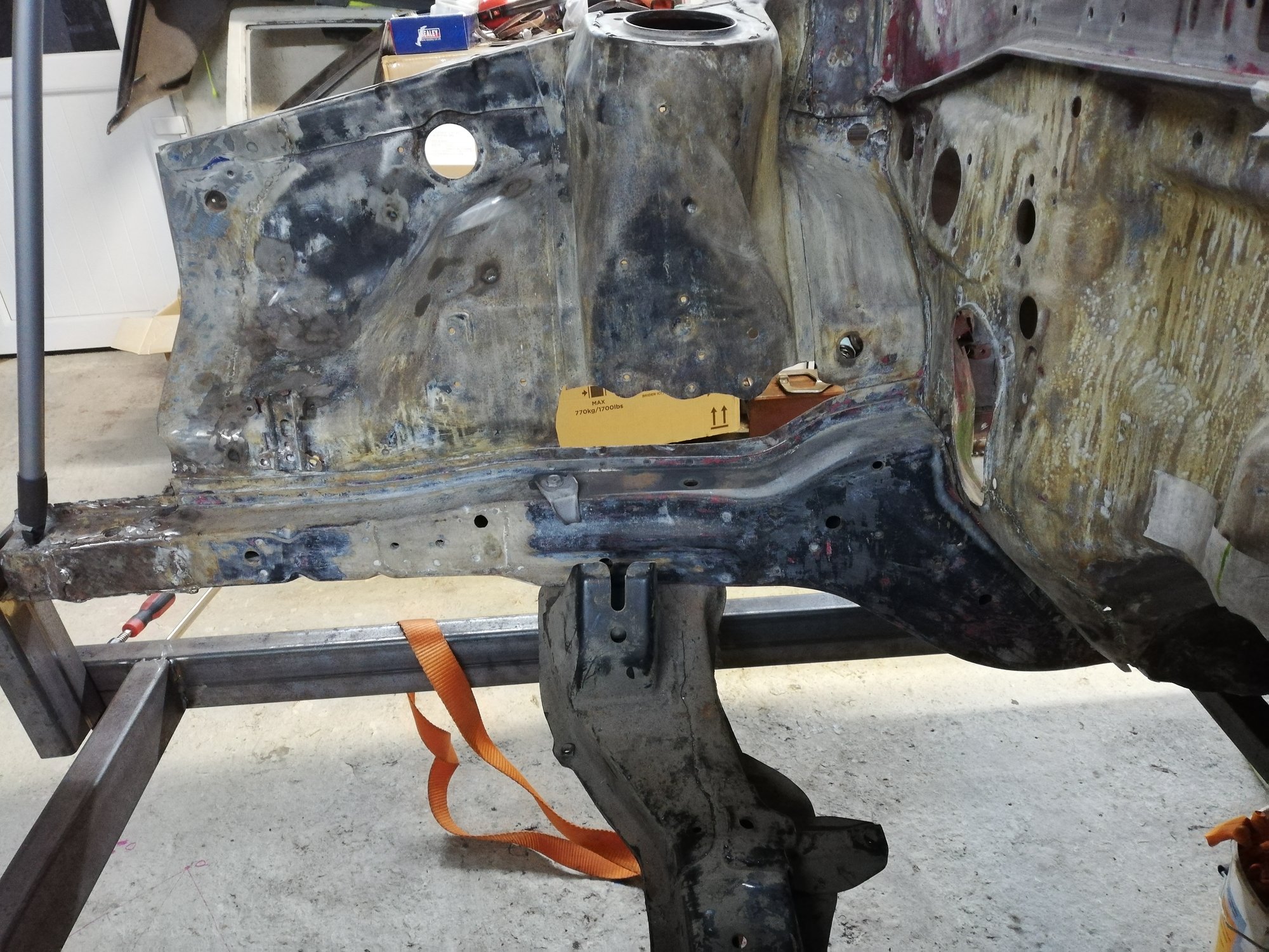

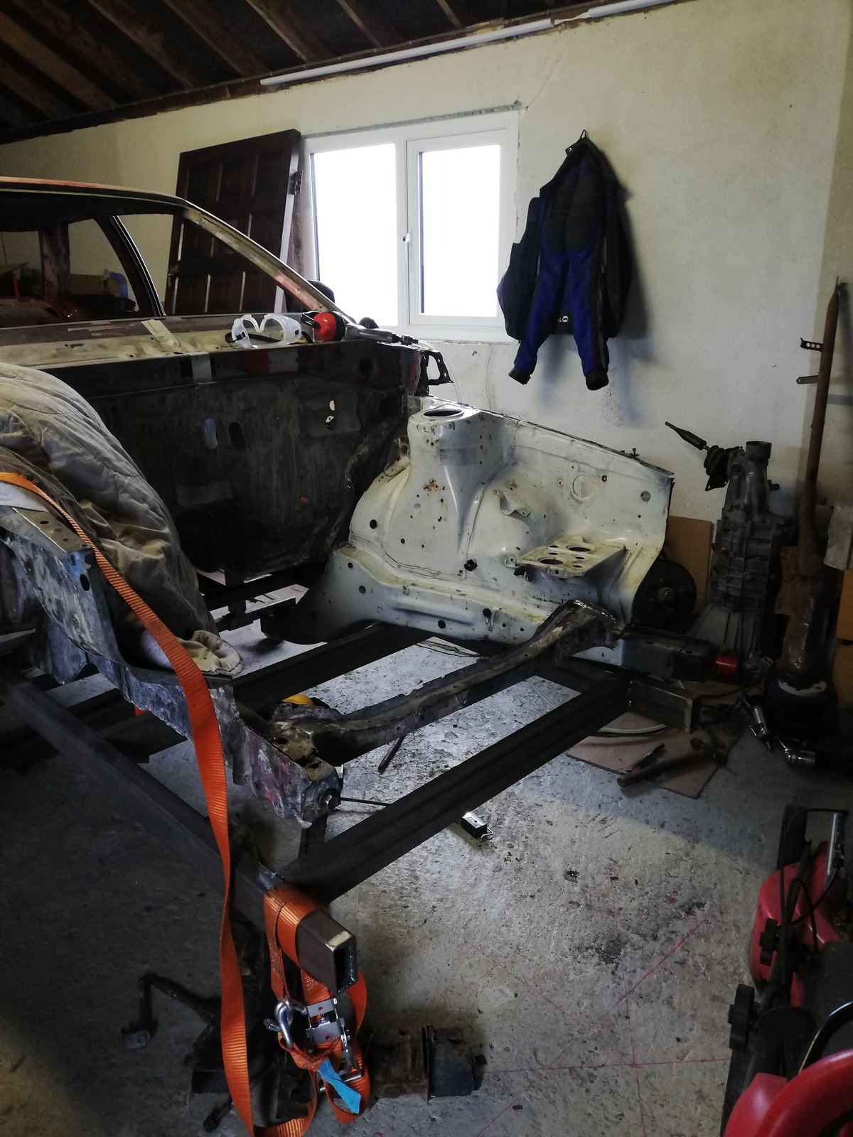

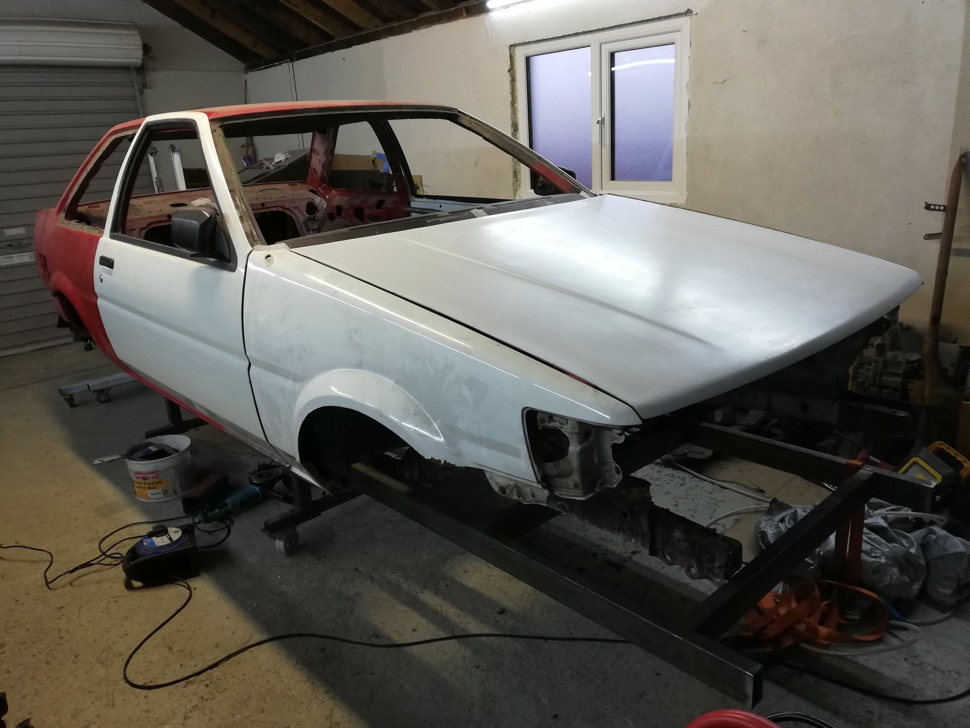

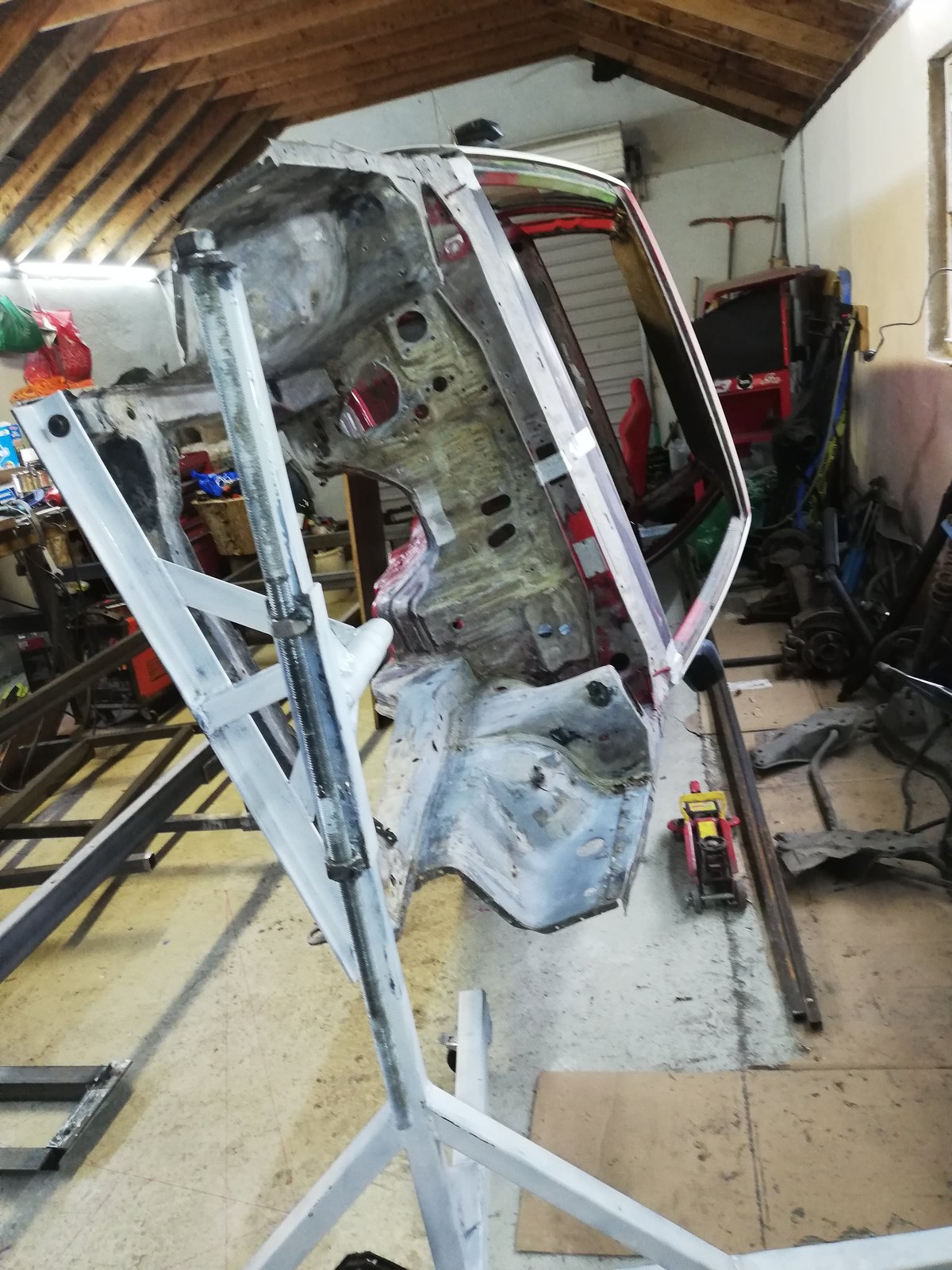

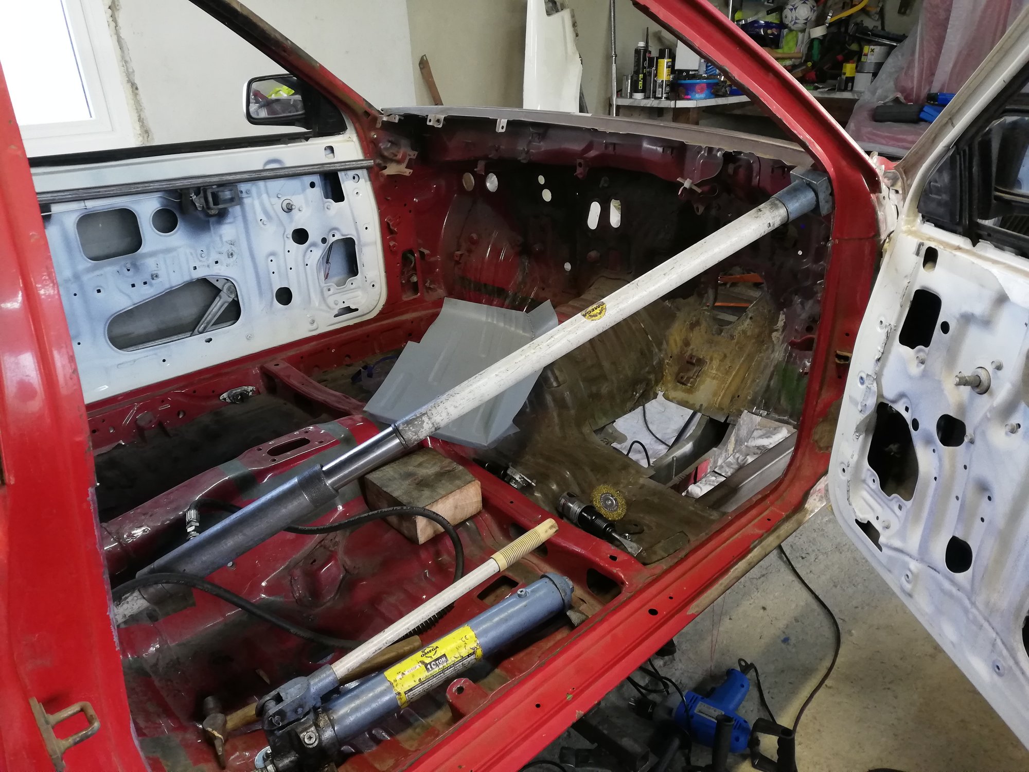

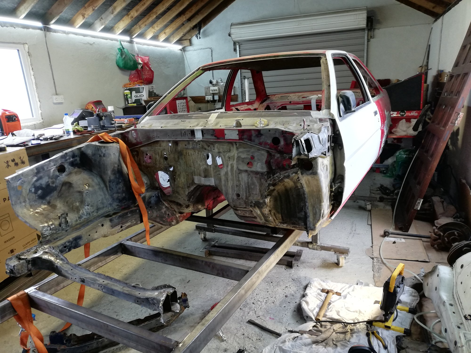

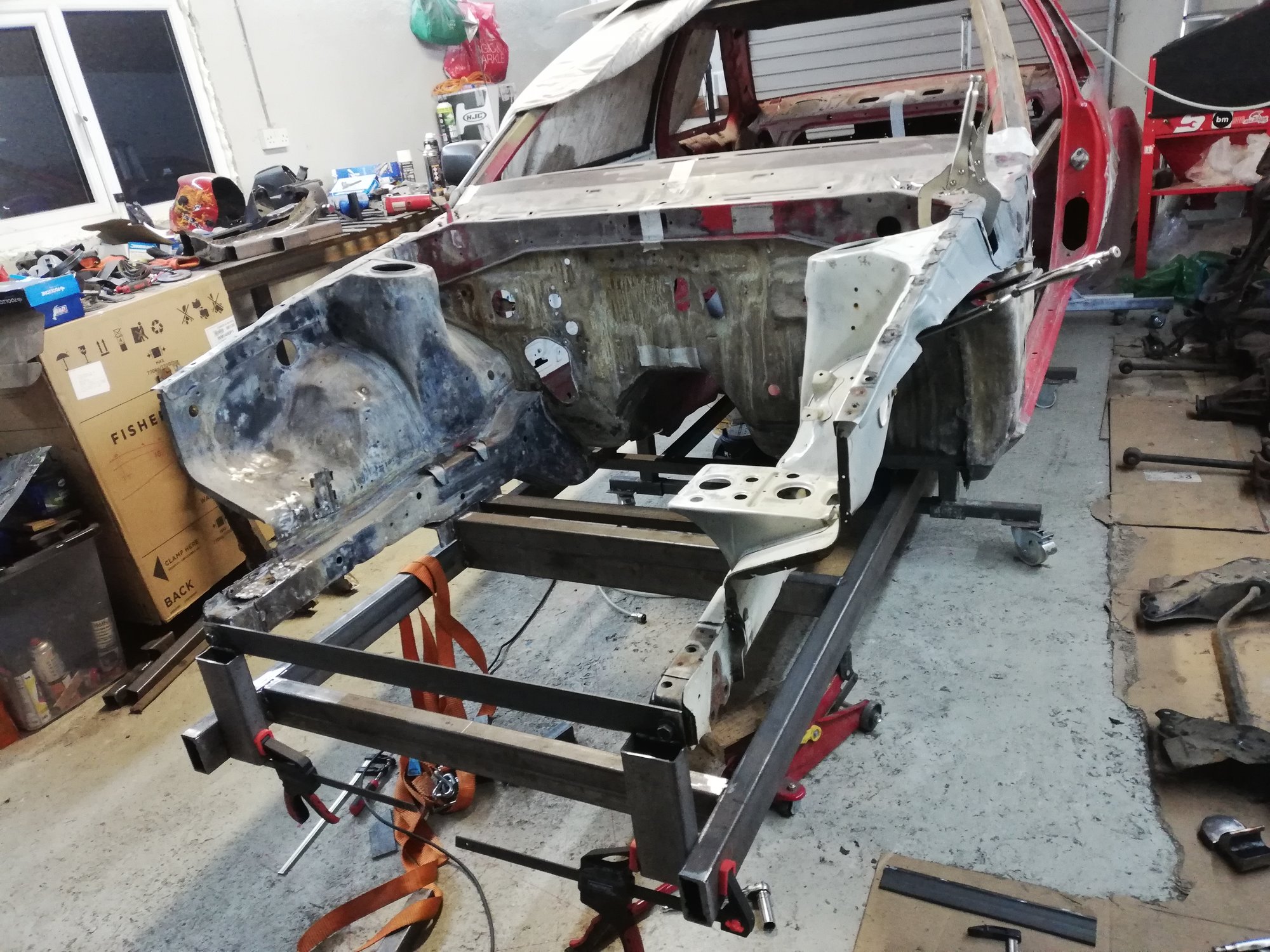

So, €250 lighter....a guy nearby who breaks these cars had an ad on fbook for this:
Straight and rust free, no signs of any repairs.

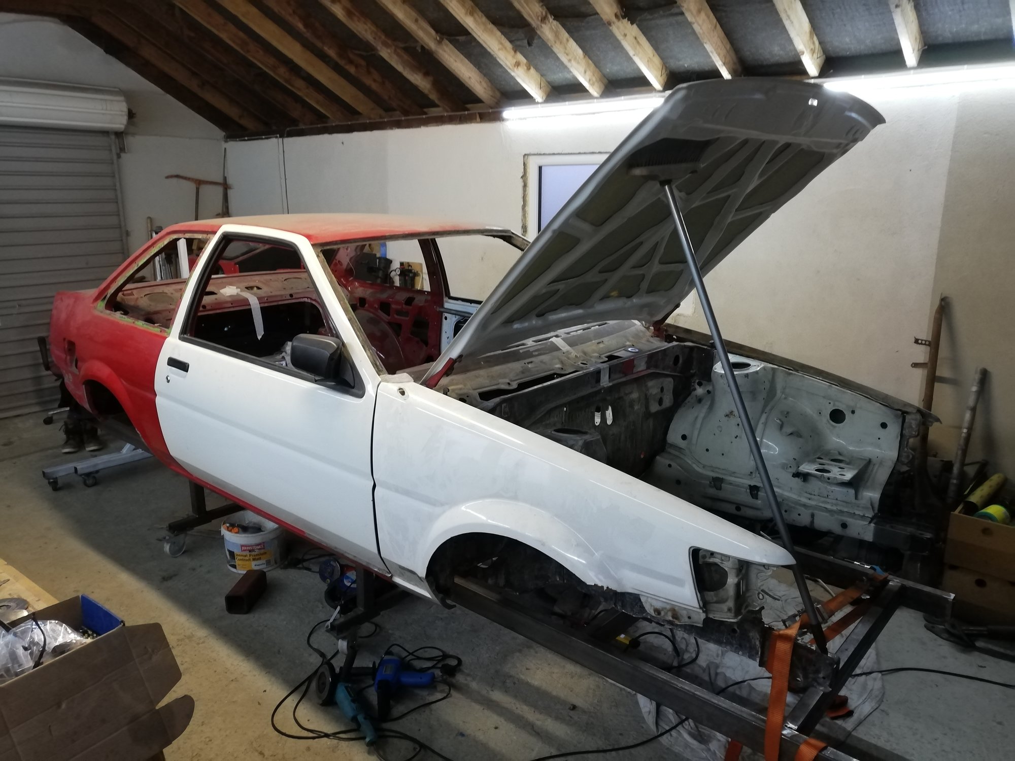

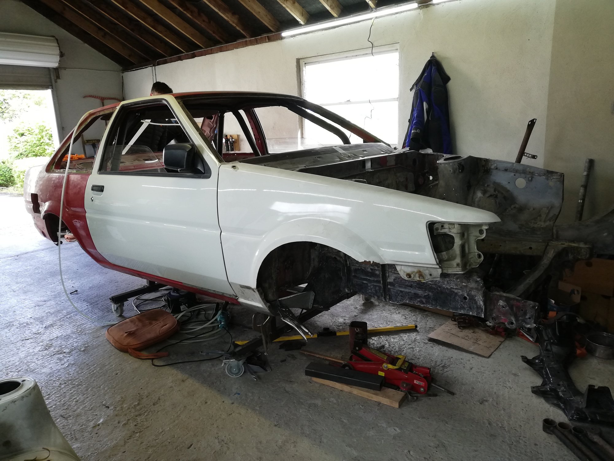

Test fitted the doors after measuring the openings which were slightly out. The passenger door is 100%, a combination of worn hinge and possible movement on the driver's side means it bangs off the striker but can be lifted closed.

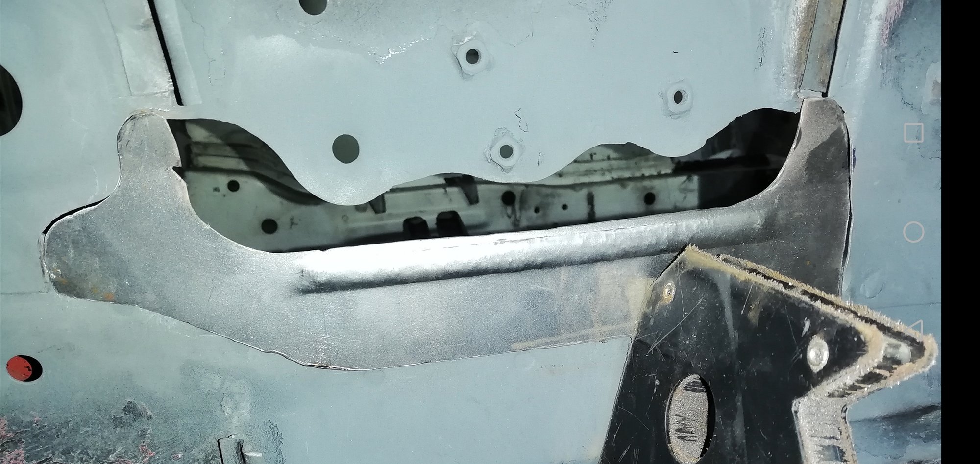

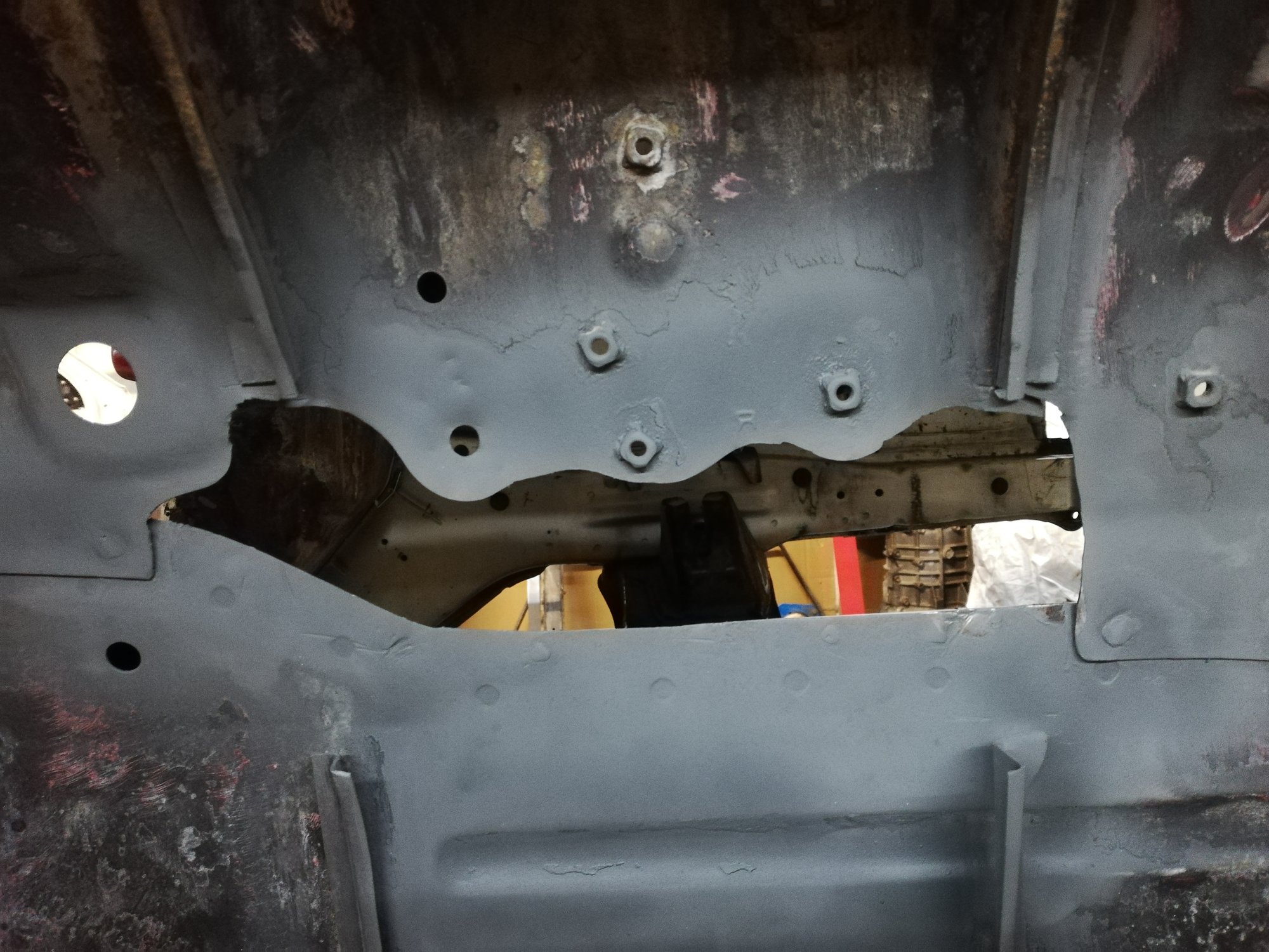

Worth noting that there is still a large hole in the driver's footwell and outrigger not fitted.
When closed the roof is slightly proud of the door (I'll have to recheck that it's the roof that's proud )

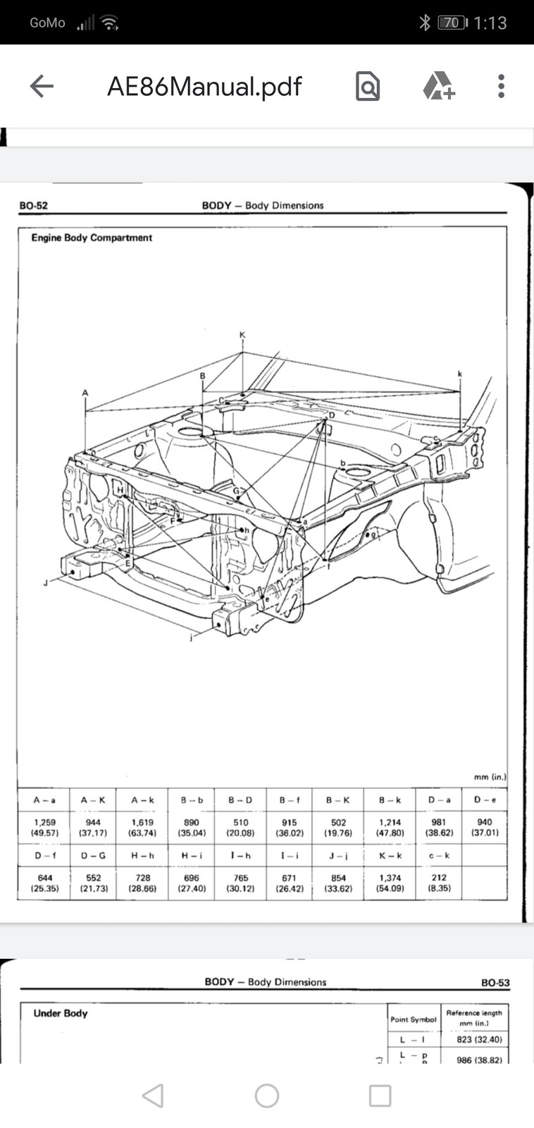

Conclusion: the shell needs to be fixed down straight and true so that my repairs from here on don't leave it twisted
Set the wing on for inspiration lol
