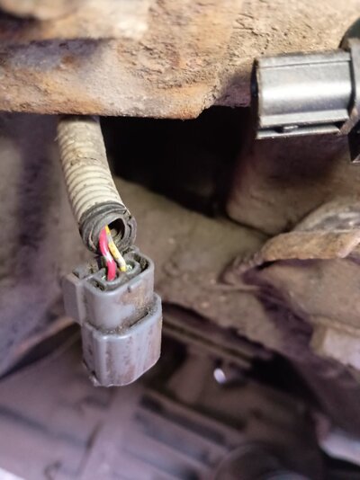

I think this will go well with the "older cars in the UK" thread here as this CRV has done nearly 200k!
I have a friend who's CRV has thrown a load of ABS and traction control lights on the dash, I checked it with my code reader and it came up with faults for the rear left wheel speed sensor so I replaced that but it's made no difference.
I then tried reading the live data (I know I should have done that first
When I looked closer I saw the green 'stuff' on the loom side connector but can't tell if it's green corrosion or the rubber seal that's rotted away.
I suppose either way it needs replacing so where can I get one?
I know someone here has posted a place that does all this kind of electrical stuff but I can remember where.
Any help appreciated.
