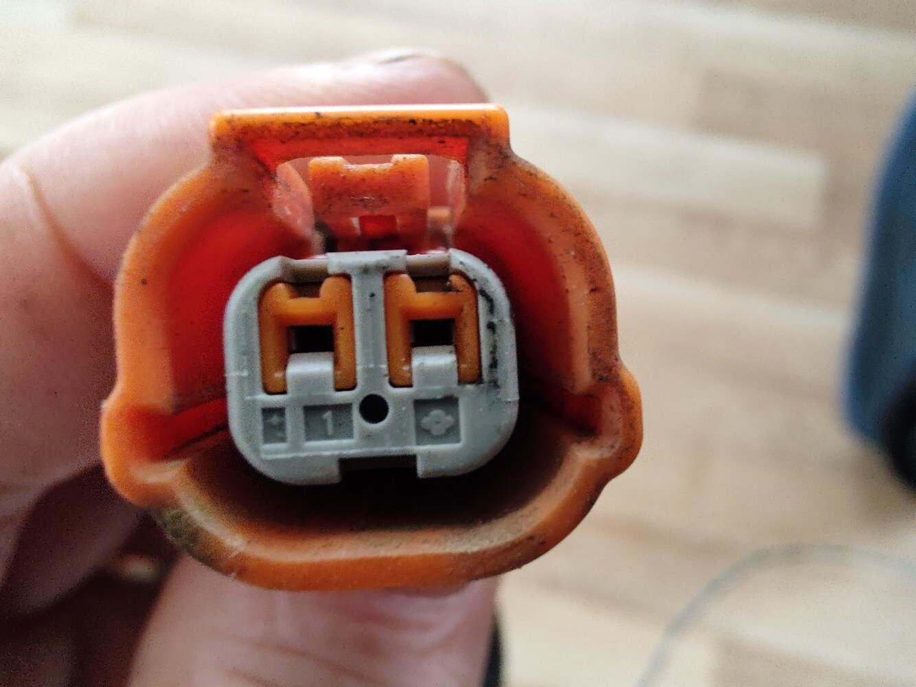

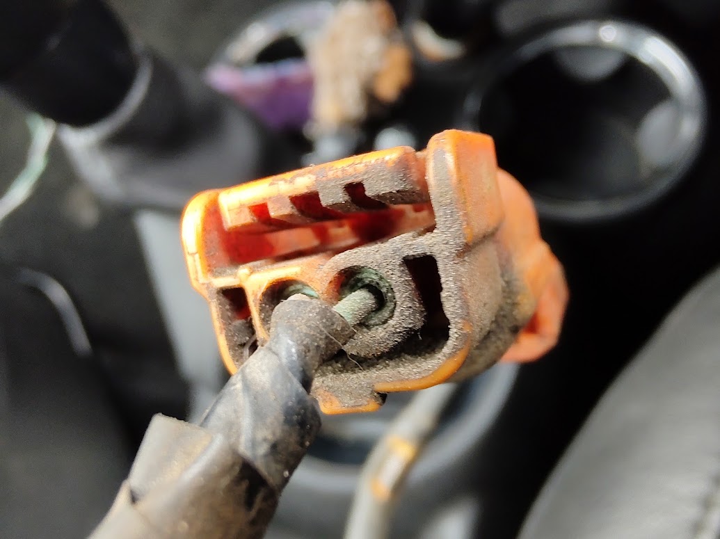

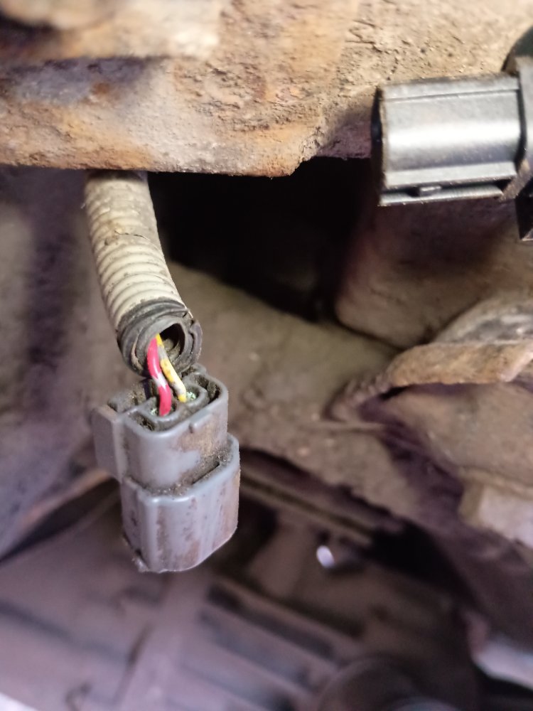

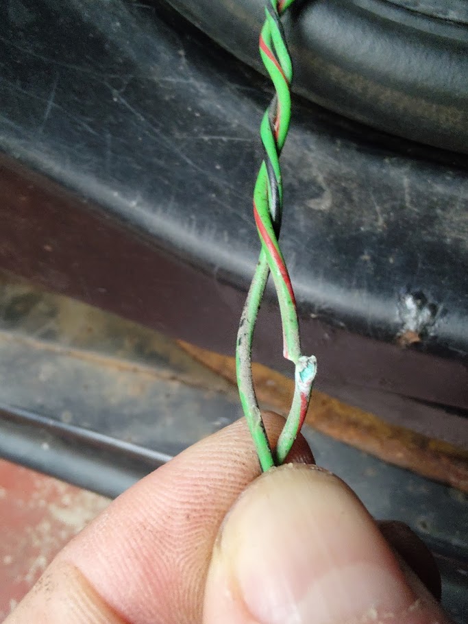

I have a friend who's CRV has thrown a load of ABS and traction control lights on the dash, I checked it with my code reader and it came up with faults for the rear left wheel speed sensor so I replaced that but it's made no difference.
I then tried reading the live data (I know I should have done that first
) and it shows a spike in the reading on that wheel over bumps so I'm now wondering if it's got a bad plug or wire.When I looked closer I saw the green 'stuff' on the loom side connector but can't tell if it's green corrosion or the rubber seal that's rotted away.
I suppose either way it needs replacing so where can I get one?
