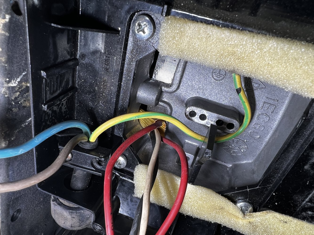

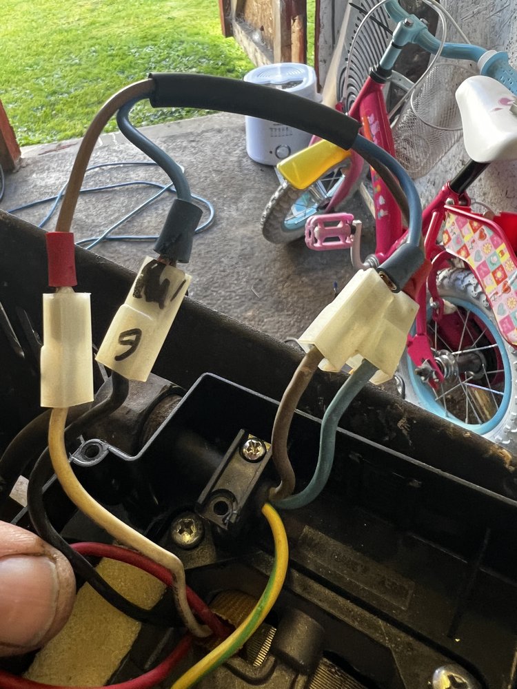

See my post #17 in this threadIf you are trying to get the motor running, do away with any other potentially interfering items - like that pressure sensor - for a start. Keep things as simple as possible

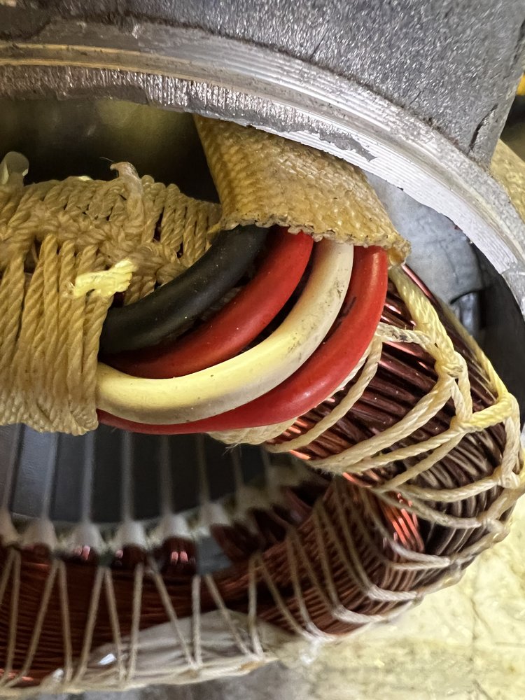

Red to red reads 1.5 ohms,black to yellow 0 ohms . I tried white to black and it read 4.9 ohms.Measure red to red, and black to yellow, nothing else connected.

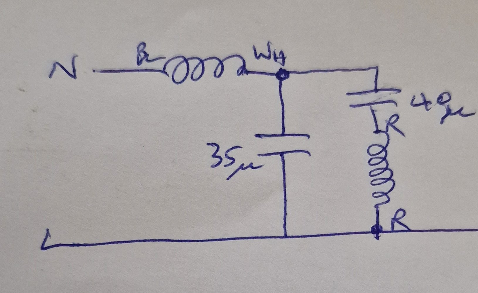

. I configured this wiring and the motor runs , so does that mean the capacitors are bad ? If I run it too long in this configuration it pops the fuse .Because there isn't oneHow does this work without a centrifugal switch ?

There are no capacitors connectedIf it runs then no the capacitors aren't bad. Is it working with a load?
The start capacitor in this case is rated 0-40uf, most motors with centrifugal switches have much higher capacitance for the start capacitorHow does this work without a centrifugal switch ?

Were these readings with the two red, black and yellow wires disconnected from everything else? It's just that you mention white to black and there's no white coming off the motor, white is a capacitor wire?Red to red reads 1.5 ohms,black to yellow 0 ohms . I tried white to black and it read 4.9 ohms.
With a single phase induction motor there needs to be one capacitor connected for it to workThere are no capacitors connected
There is a white coming from within the motorWere these readings with the two red, black and yellow wires disconnected from everything else? It's just that you mention white to black and there's no white coming off the motor, white is a capacitor wire?
