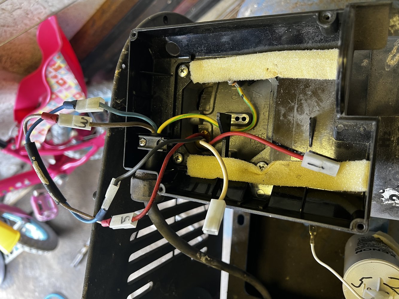

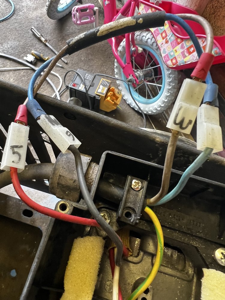

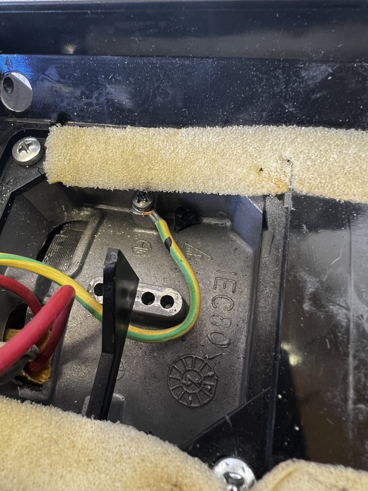

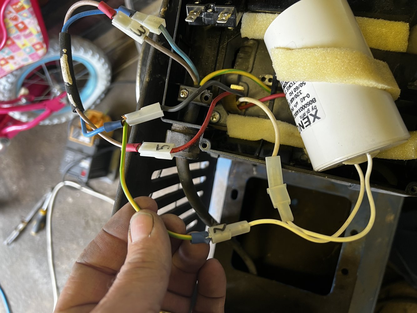

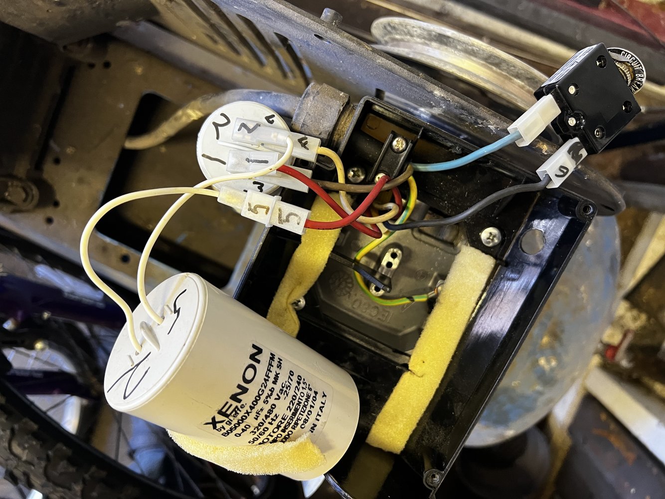

That's connected to the body of the motorOk, so if the motor has a white wire, where is the yellow wire that you mentioned earlier?
You're confusing things.Ok, so if the motor has a white wire, where is the yellow wire that you mentioned earlier?
Red to red looks good, as does the black to white. However the black to yellow reading of 0 ohms is concerning, that says you've got a short from a motor winding to earth. Did your meter read zero for this test (same as when you touch the red & black probes together) or did it read open circuit (same as when you don't touch the red & black probes together). Just wanting to check that I'm understanding your 0 ohms comment correctly that's all.Red to red reads 1.5 ohms,black to yellow 0 ohms . I tried white to black and it read 4.9 ohms.
