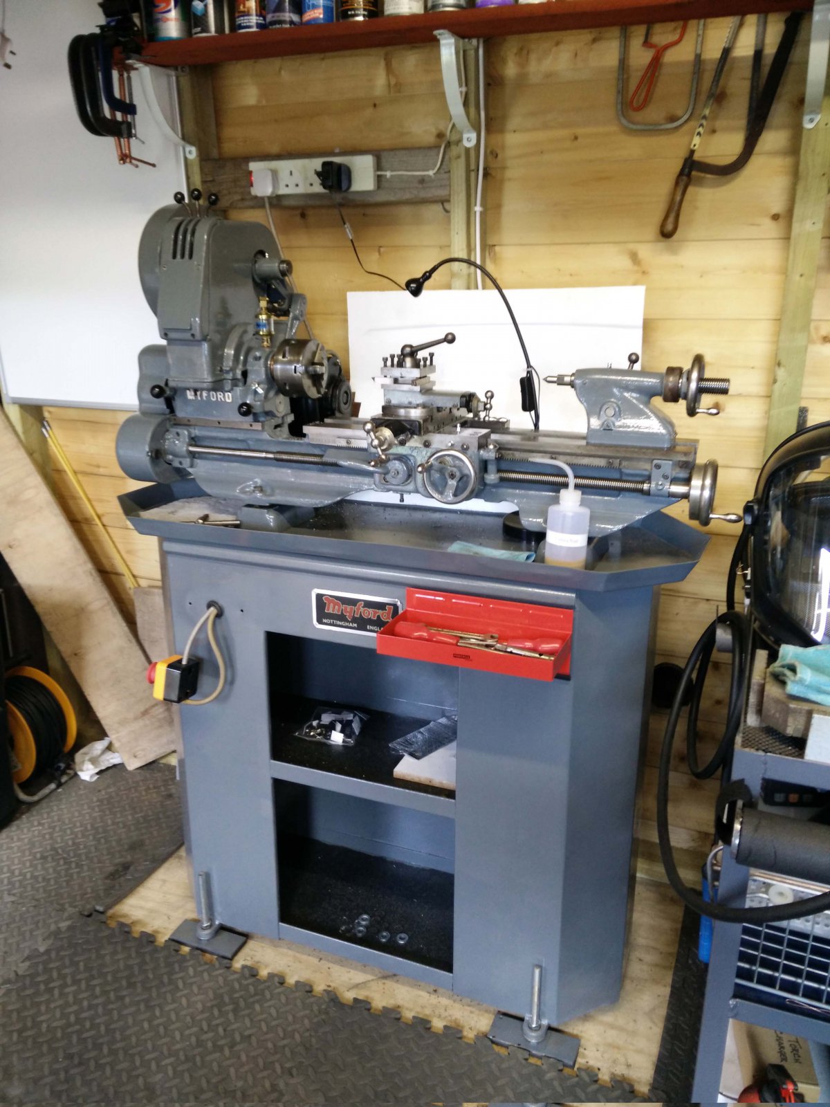

im only 5 pages behind the suggestion but I would remove the castors and fit a bit of hefty plate and box section in each corner, then attach the castors to these. If you make the upper portion big enough you can put some chunky threaded rod, or even cut down and bolt half a g clamp to it. This will enable you to raise the lathe with the bolts, or lower it onto the castor. Done right it will sit lower than the castor's alone
Not sure if the leadscrew has been oilers were full of grease which I suspect but I'll be oiling - may remove it at some point. My mate tells me it's possible to heat bushes to 'sweat' out old oil/grease, then leave them to cool in fresh oil - but it can only be done once. Anyone else heard of this trick?
