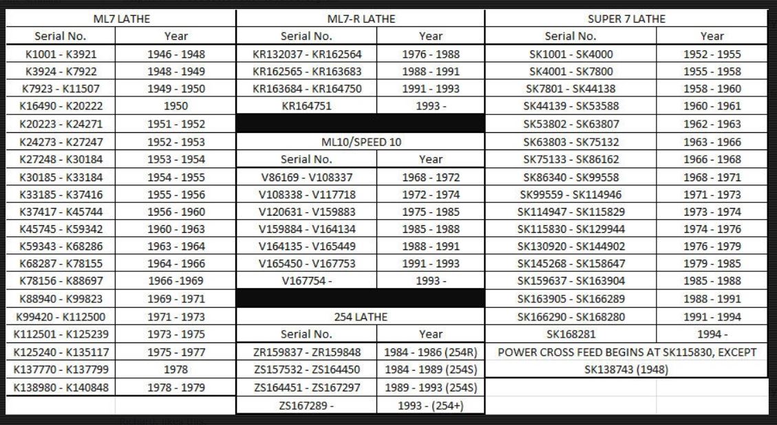

The serial number stamped on the bed is K123158 but unless I'm misreading the referenced production dates at lathes.co.uk here, http://www.lathes.co.uk/myford/page17.html that number range doesn't exist - would I be right in thinking he's a 1974 model?

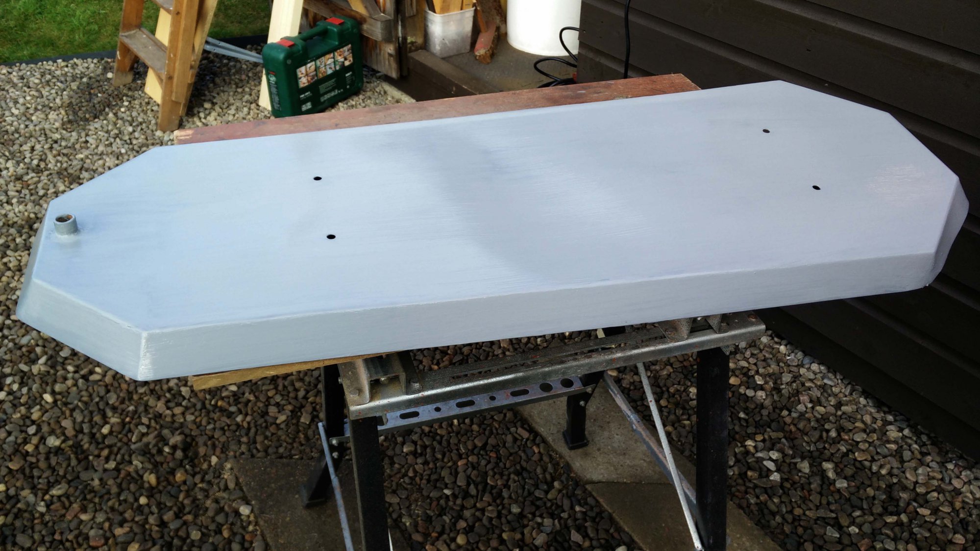

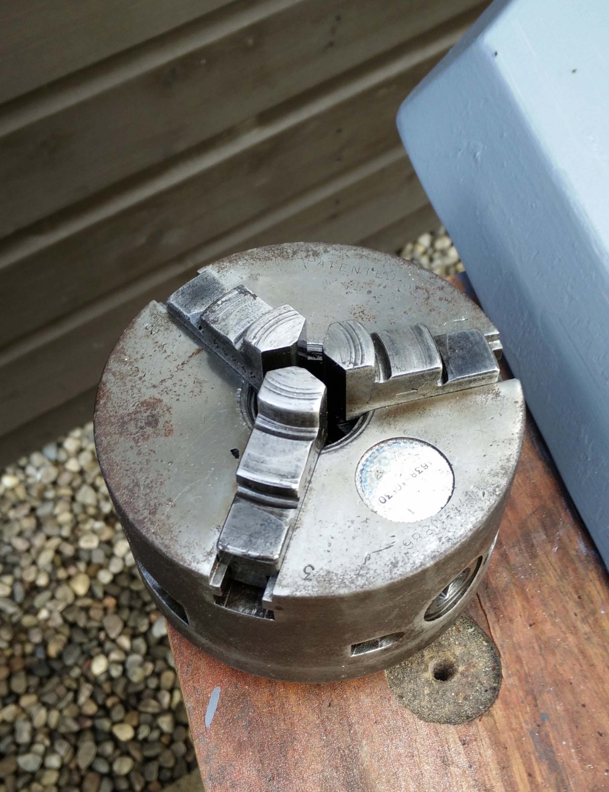

A couple of shots of what was achieved yesterday. Drip tray sanded and primer'd

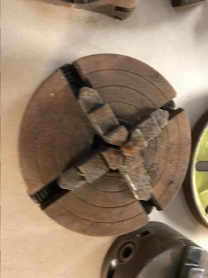

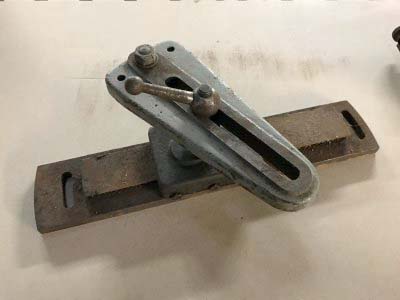

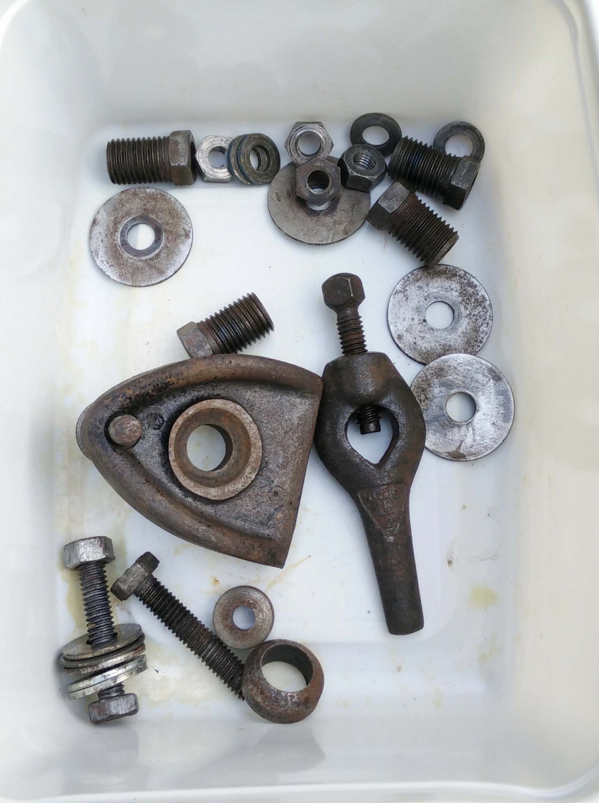

These bits came up quite well from the u/sound cleaner, not perfect but a good basis for a strip-down/final clean. 3-jaw is Pratt Burnerd
4-jaw needs a spell in the electrolysis tank

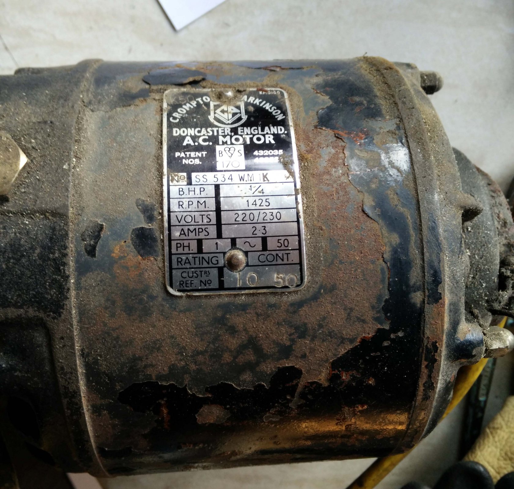

Motor may have been swopped out at one time, as afaicr the Tri-Levas came new with a 2-speed one. This ought to be perfectly adequate though. I'll ask in due course about wiring a Dewhurst-type drum switch in conjunction with an NVR in due course [I'm elektrickeraly challenged ]

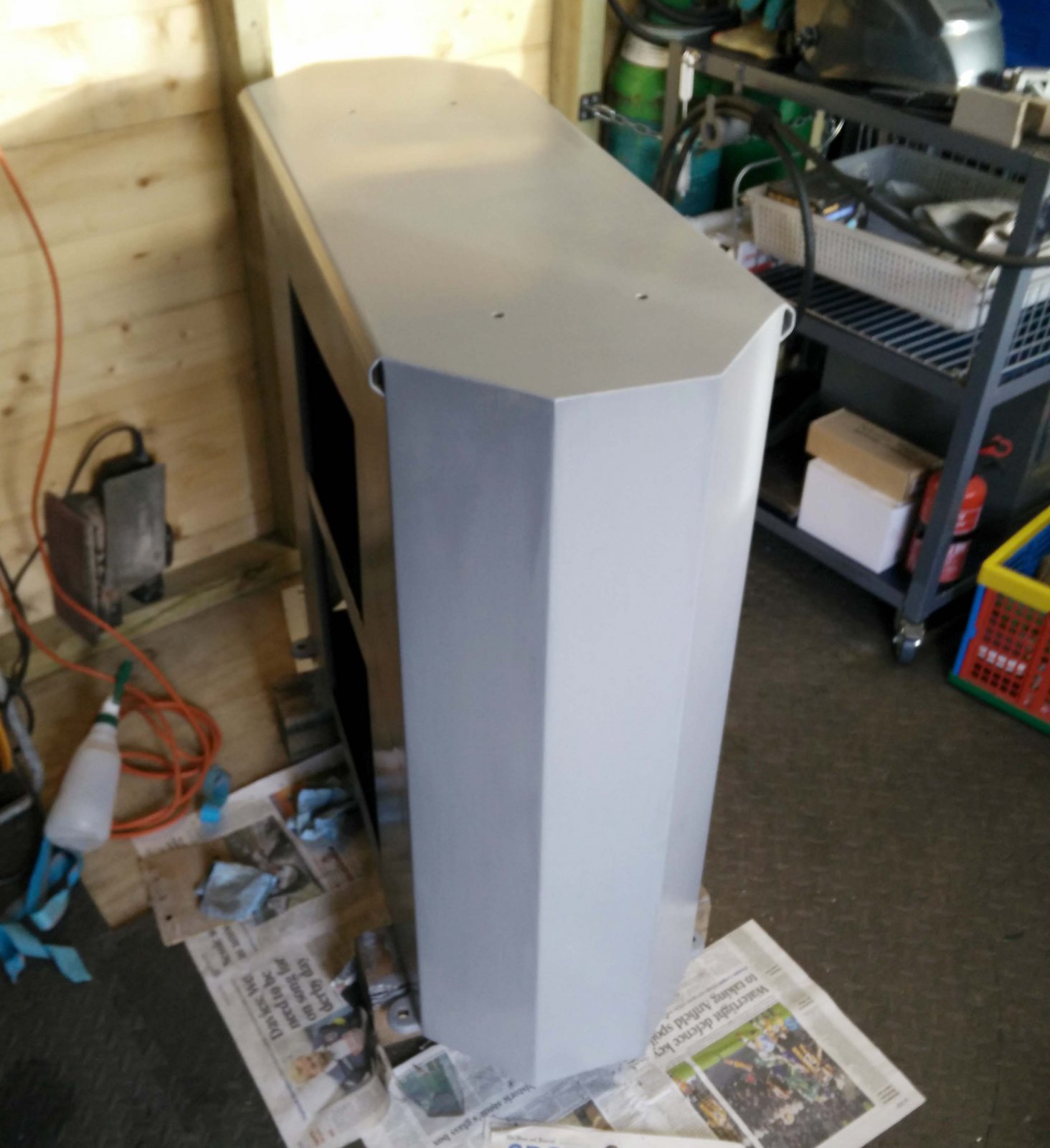

Tomorrow it'll be clean and prime the main stand. This promises to be an enjoyable project which I'm going to take my time with and enjoy, it's been years since I got my hands 'properly' dirty.
