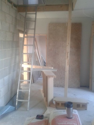

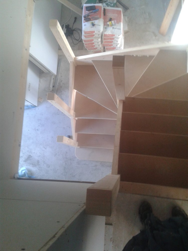

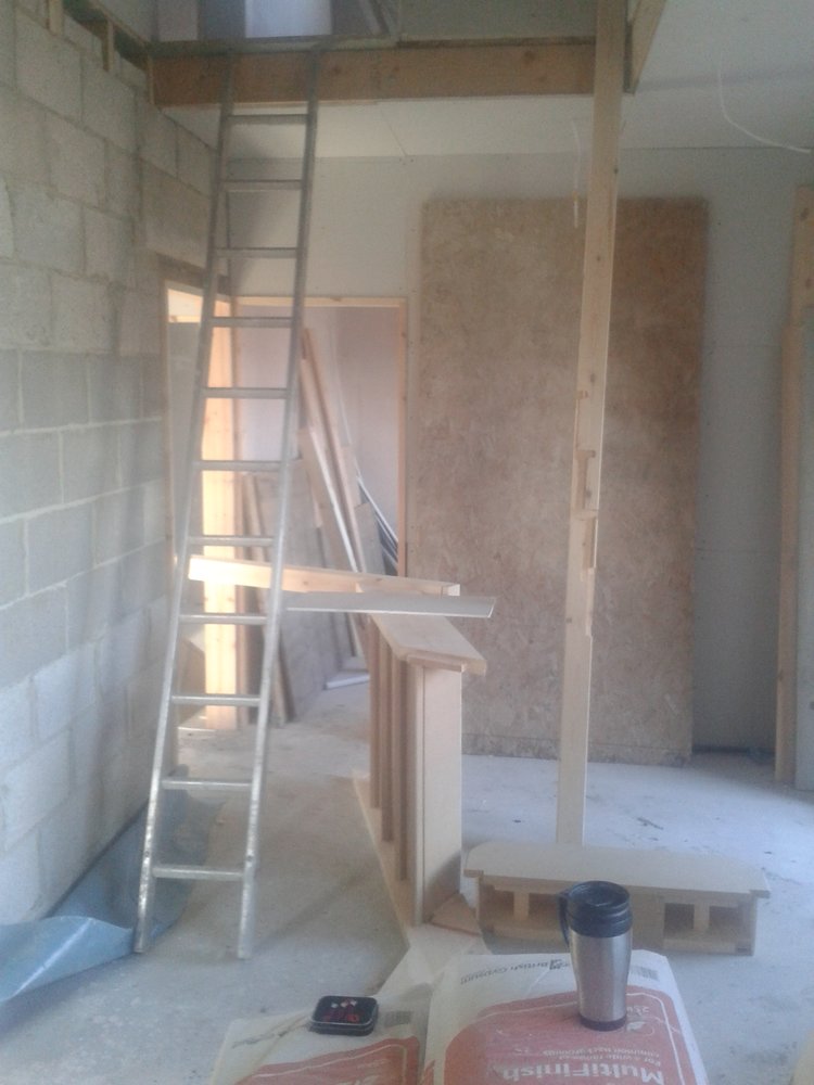

its normaly the angle thats wrongHas it been made over length and you trim the bottom off as above to suit?
I did and it is spot on, 2660mm floor to floor but the stairs supplied are 2683mmWho measured it?
I did and it is spot on, 2660mm floor to floor but the stairs supplied are 2683mmThey've agreed to supply a new staircase
having that extra helps ive known floors go out before and id rather trim the staircase to fitI did and it is spot on, 2660mm floor to floor but the stairs supplied are 2683mmThey've agreed to supply a new staircase
Problem solved then, what they supplied is too big. Ive only ever done two before. But when its got to fit (windows, doors, carpets etc) where ever possible get the supplier to measure. I learnt an expensive way, with a window, it arrived and didnt fit.I did and it is spot on, 2660mm floor to floor but the stairs supplied are 2683mmThey've agreed to supply a new staircase
Same here Gaz, 2-3mm is fine but 23mm is a bit too much!having that extra helps ive known floors go out before and id rather trim the staircase to fit
I was panicking as I thought it was my fault at first! A quick go on the tape measure proved otherwiseProblem solved then, what they supplied is too big. Ive only ever done two before. But when its got to fit (windows, doors, carpets etc) where ever possible get the supplier to measure. I learnt an expensive way, with a window, it arrived and didnt fit.
I got them to make the bottom step 23mm longer so when I fit the new wood flooring in the hallway the rise would be the same as the others. What they should have done (but didn't) is reduce the rise on each step to accommodate that and keep the same overall height.Has it been made over length and you trim the bottom off as above to suit?
Normally cut the feet in the stringer and first step, this allows scribingI did and it is spot on, 2660mm floor to floor but the stairs supplied are 2683mmThey've agreed to supply a new staircase
The first step is cut to the floor to get the first step level in all planes.Not sure what you mean Matt. Could you explain it to a numpty please?
