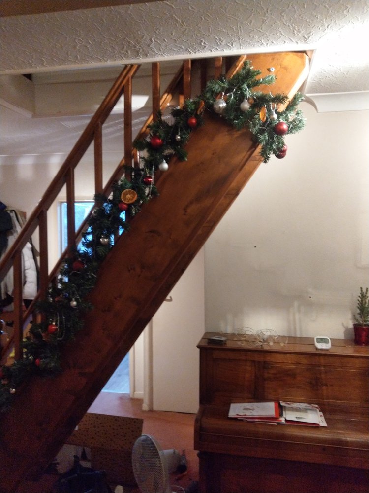

No the opening will need to be widened but there's hopefully enough space before the next joist.Should be a nice easy one for you.
Does the footprint match the existing opening?
Headroom should be fine but the bannister clearance needs checking.Pretty sure your going to need a building notice on that.
Use the stairbox plans along with info on widening opening.
Eg doubling joists. Coach bolts every 600mm etc
Confirm headroom and banister handrail clearance with them.

Just allow for it with staircase width. Don't forget to cater for plasterboard/plaster or timber trimsNo the opening will need to be widened but there's hopefully enough space before the next joist.

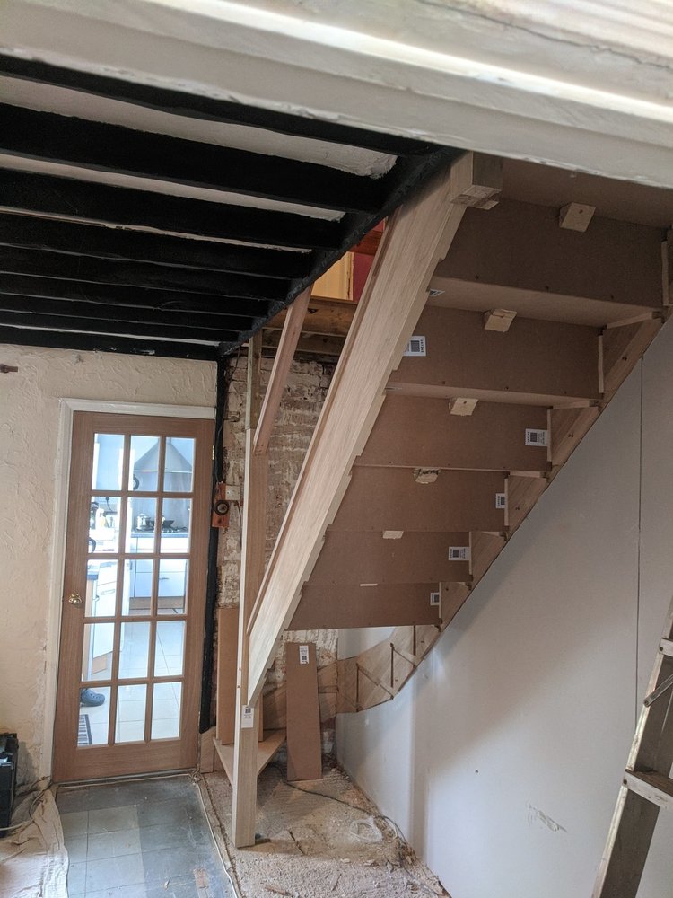

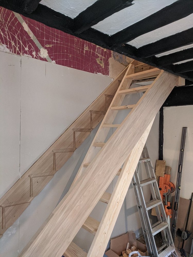

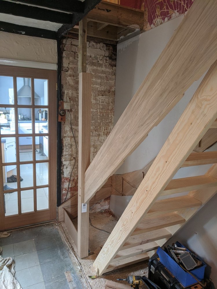

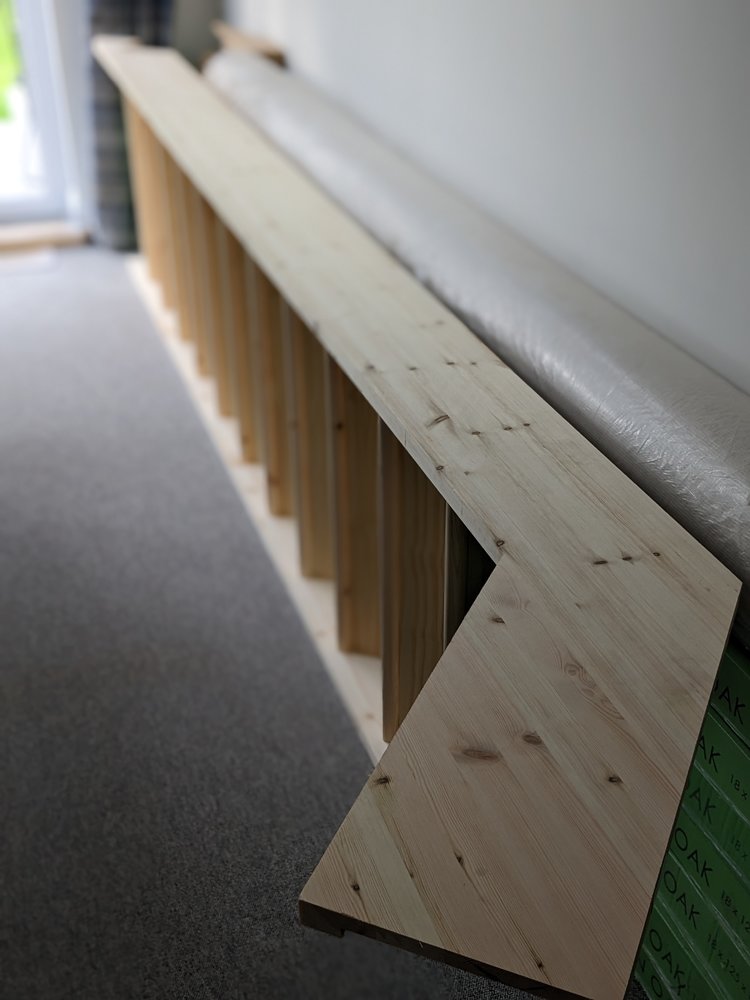

I think this will be in bits. What's best other than the time to build it?Last one I did it arrived in bits. No access. Had to build it in place.
Not hard to build them.I think this will be in bits. What's best other than the time to build it?

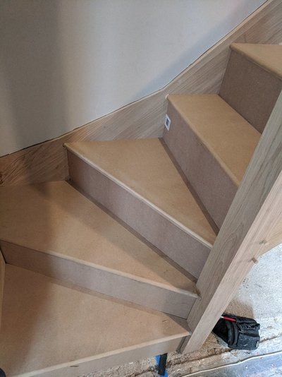

Pic 3 is how I'd expect a part built to arrive. Without the newel posts fitted.Instructions are good and comes with pu glue for skeleton guns

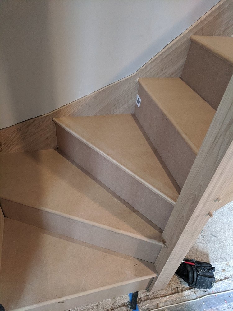

View attachment 379395 View attachment 379396 View attachment 379397 View attachment 379398
Yup.Is that a stairbox one?
I would have gone for full line myself but with the oak they needed to keep the cost down. 32mm thick.Personally speaking, I think the turn shown in the pictures above by @eLuSiVeMiTe looks better. Removes that square boxy look, adding character to the house.
Not a fan of the mdf treads, how thick are they? When I looked there were quite noticable differences between suppliers of material specs.
