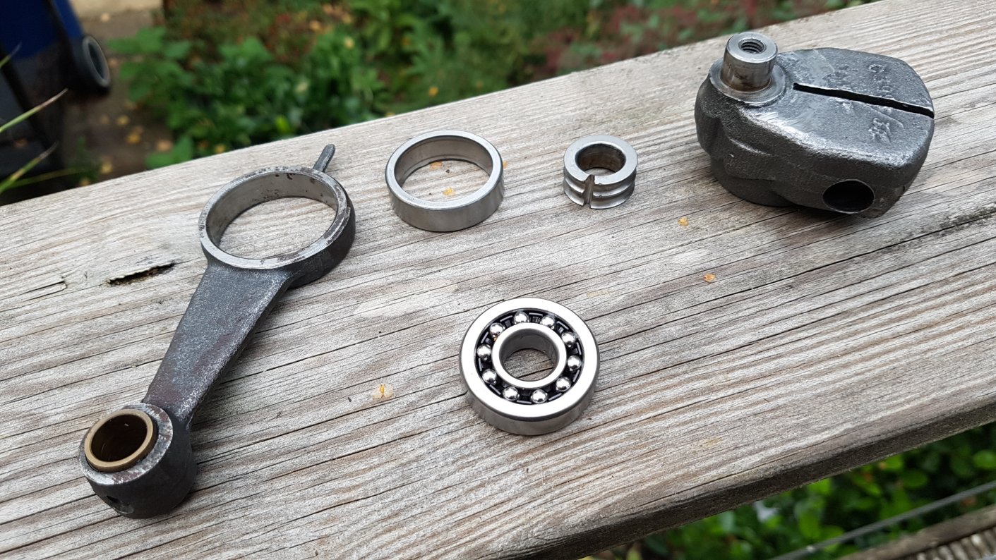

Have you a couple of large sockets, one for the housing and one for the bearing race? If SWIMBO is out, put it on the gas stove to get it really hot. Or use a blow lamp. Then support on the larger socket and cosh the race out with the smaller socket.
And as doubleboost suggests, if it is really hot, use gloves like a tea towel, don't put them on.
