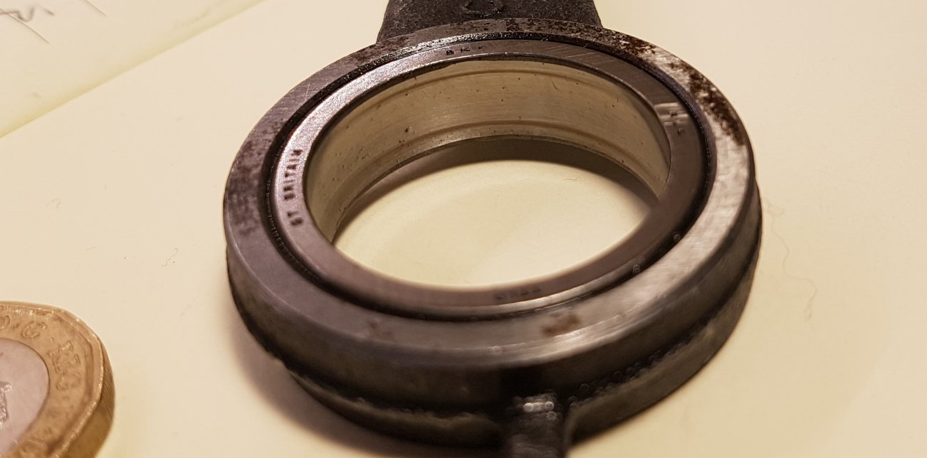

What a load of balls...The op's bearing is a spherical ball bearing also known as a self aligning ball bearing.
Spherical bearings are plain bearings, encountered on rose joints (or rod ends), also known as "pillow balls" when used in Motorsport applications, such as when replacing a compliant rubber bush.
Spherical roller bearings use rollers instead of balls, also known as self aligning roller bearings.
