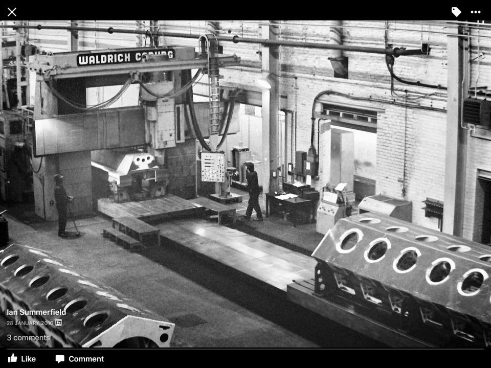

A picture of an extremely large milling machine that was broken up and scrapped when the factory I once worked in closed down after the company was taken over and asset stripped. Broken up so that it "didn't fall into the hands of the competition". I believe it was , or was at one time , the largest milling machine in Europe with a bed of around 100 feet ( one being machined , one on one end being loaded , one on the other end being removed.)
Yeah , it 'was' Mirrlees Blackstone in Stockport. They built the world's third ever diesel engine. Bought out by MANDo you have any idea what those engine blocks are for out of interest? They look like rail or marine V12s, Sulzer or English Electric perhaps?
I’d have got it out given the opportunity!A picture of an extremely large milling machine that was broken up and scrapped when the factory I once worked in closed down after the company was taken over and asset stripped. Broken up so that it "didn't fall into the hands of the competition". I believe it was , or was at one time , the largest milling machine in Europe with a bed of around 100 feet ( one being machined , one on one end being loaded , one on the other end being removed.)

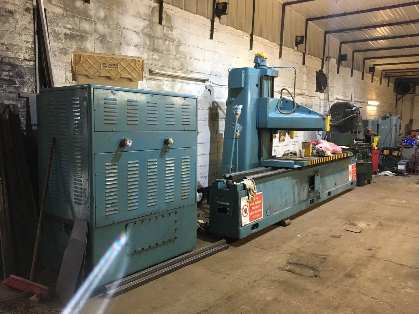

Flipping hell thats tidy in there!
Another instance of needing the finger emojiFlipping hell thats tidy in there!
That's not your cave in the unit is it?Another instance of needing the finger emoji![]()
