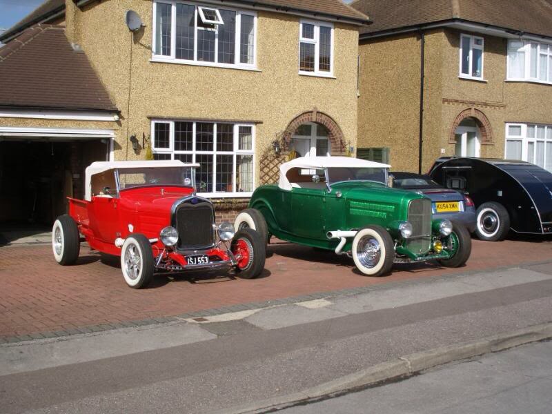

  19. langy
    langy langys rodshop
    Messages:
    6,099
    Location:
    London
    I
    I drove it with the front off as it's easier to get to stuff to adjust.
    I've driven fender less cars for the last 30 years without any problems, it's a C&U issue and can be a very grey area.
    My other car and Sue's car
    mike os and brokenbiker like this.
