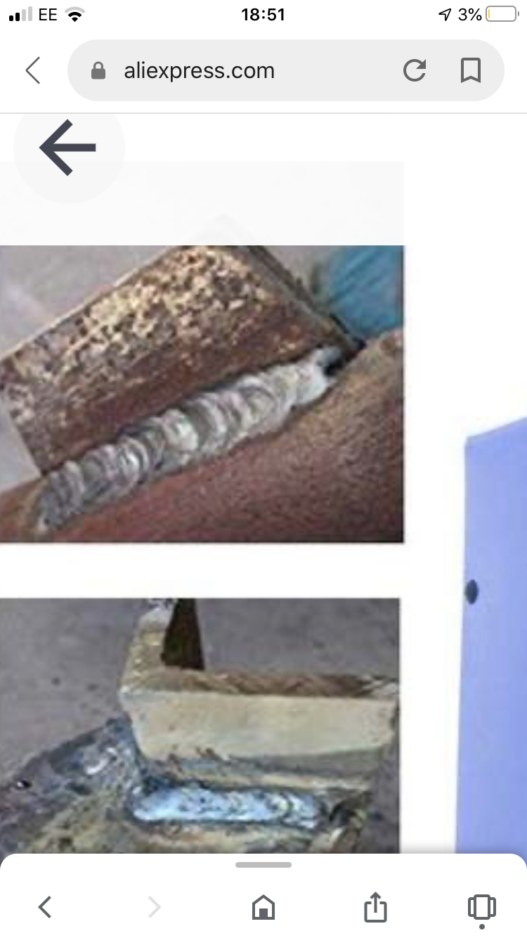

If these machines won't take the disposable argon bottles then I may forget the whole thing and get a cheap plasma cutter,.....I would love to move up to a TIG machine one day but realistically I can't afford or justify one. I've just learnt about these 3 in 1 types so you can see why I were interested in the first place??
