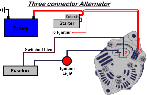

http://westfield-world.com/daihatsu_alternator.html
It's the lower one for the warning light, I wouldn't worry till you start it and if need be replace the rectifier pack in it
