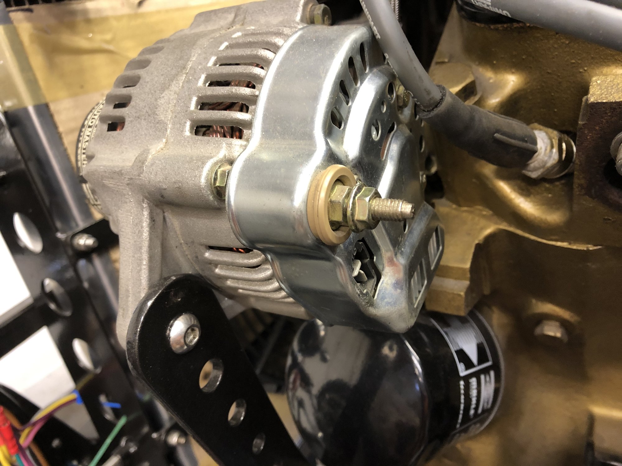

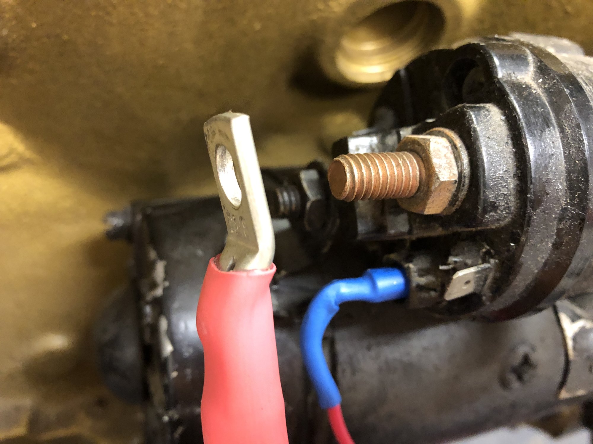

I was thinking along those lines, if I have enough stud left, or I can make a threaded adaptor.
Use a bullet coupler and crush one end down until it is tight.

Becareful going off appearance - mate fitted a recon starter to a Skoda Rapid in the early 90's - couldn't work out why it refused to start even though it spun over lovely . . . new starter was reverse rotation to the correct one!

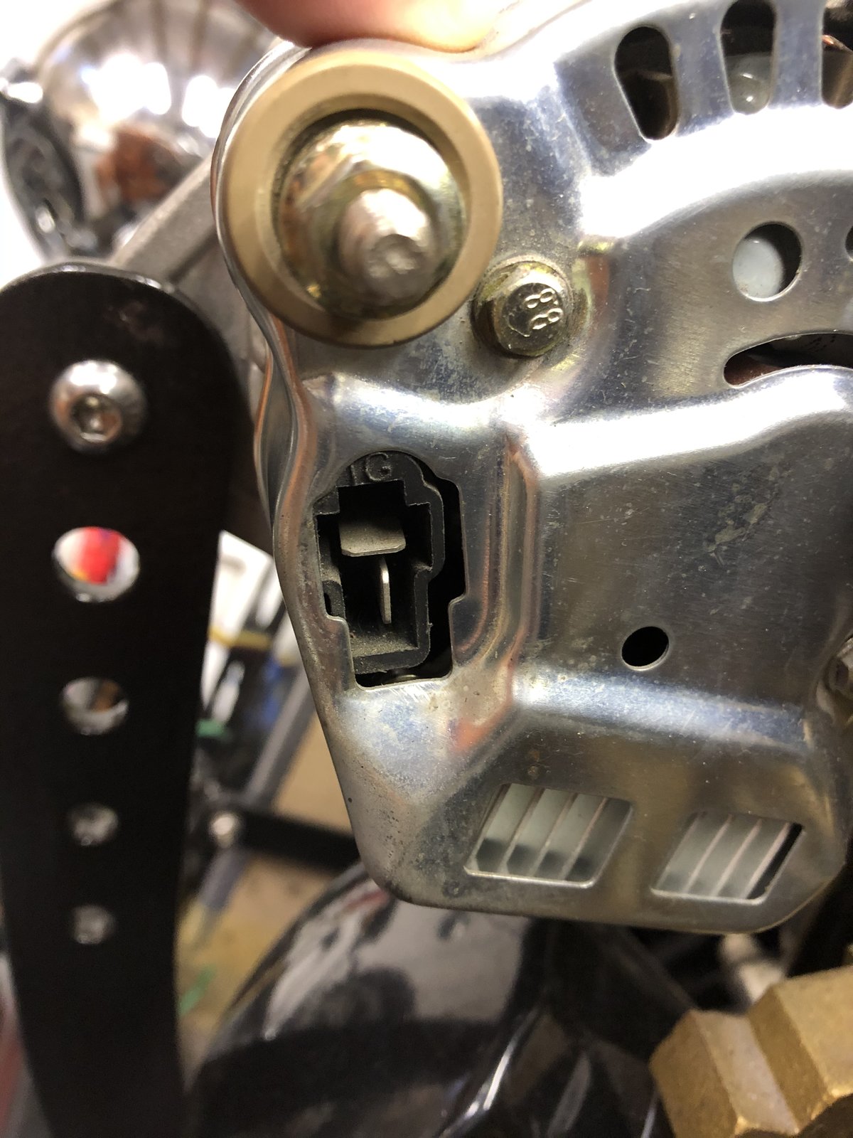

One terminal will be for the ignition lamp and the other for +12V excite, likely the one marked IG. Big fat one run it down to the starter motor supply from the battery.
I thought the bulb goes in the exciter wire, and thus goes/cancels out when there is 12 volts power coming from both ends?
yes, this is right
I can't remember what the other spade connector is for, but you don't need it, you can try the warning light bulb on one connector and if it doesen't work swap to the other connector, there's no risk of damage etc.
yes, this is right
