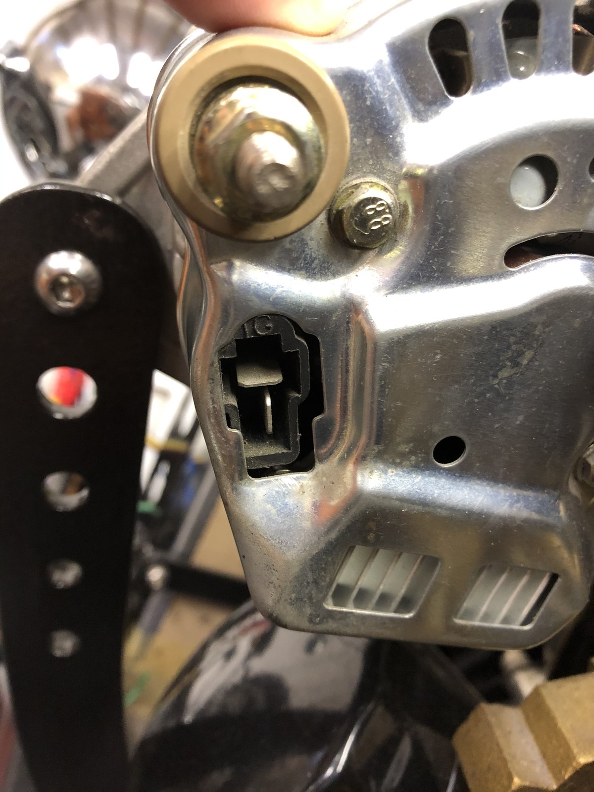

You don't HAVE to have an ignition light on the dash. You could put it in the engine bay or use a relay or resistor. That is how to power up an auxilliary towing relay.
You are going to loom all that up I take it? I wouldn't be too keen on running through that conduit though, fluffy loom tape would make it look very smart and keep it from damage. Use cable ties to get everything together first.
I have some loom sheathing that’s is split down the side, fasten it on with little cable ties every couple of inches. Going to test it all works before that though. Should be okay in the conduit, but not as much room as I had planned......
