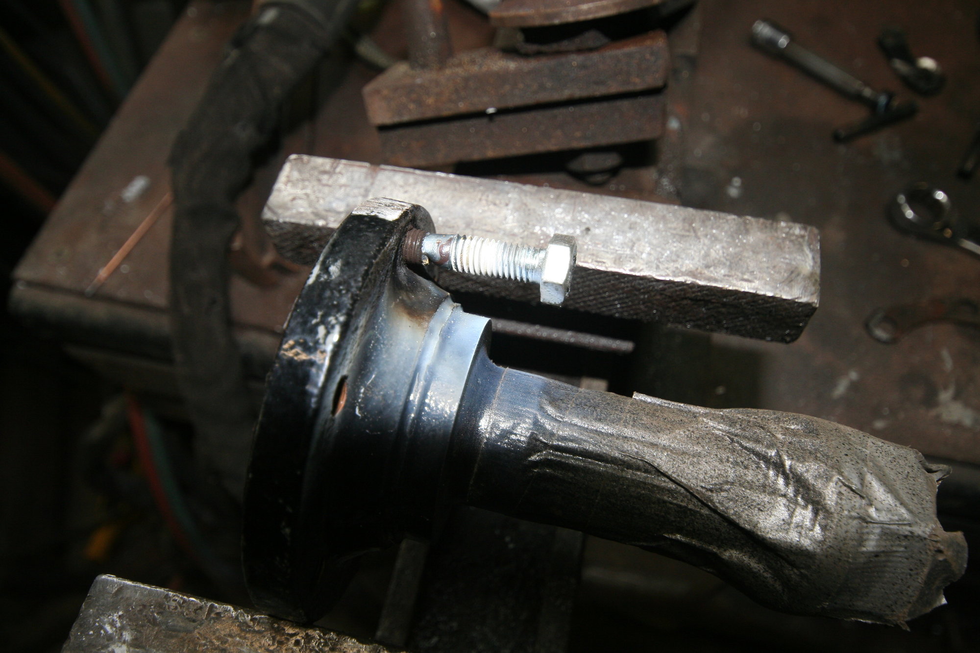

While I was painting the drive shafts I noticed a socket head bolt was missing (or at least most of it was.)
I tried unbolting the rest of the bolts but no go, so cut all the heads to split the flange from the CV joint.
Didn't think to take a photo but this is what a previous person had done to try and get the bolt out.
It looks like they had just tried to drill it out but if you look carefully you can see that they had also cut through the flange into the bolt with a junior hacksaw.
There wasn't much bolt showing
But I was able to weld a 8mm bolt to the broken threads and screw the broken bit out.
I then hammered a bit of aluminum pipe into the bolt hole to prevent filling the hole with weld, vee out the saw cut and weld it up.
Clean it up, chase out the threads and job done
