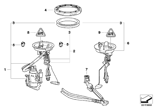

I have just remembered in the splitting or sucking jet pump pipework there is also somewhere a little check valve that sticks, mine had, IIRC and could be allowing the fuel levels to draw unevenly.
Cheers for the information. ..will go have a look after a mug of tea.....I have just remembered in the splitting or sucking jet pump pipework there is also somewhere a little check valve that sticks, mine had, IIRC and could be allowing the fuel levels to draw unevenly.
