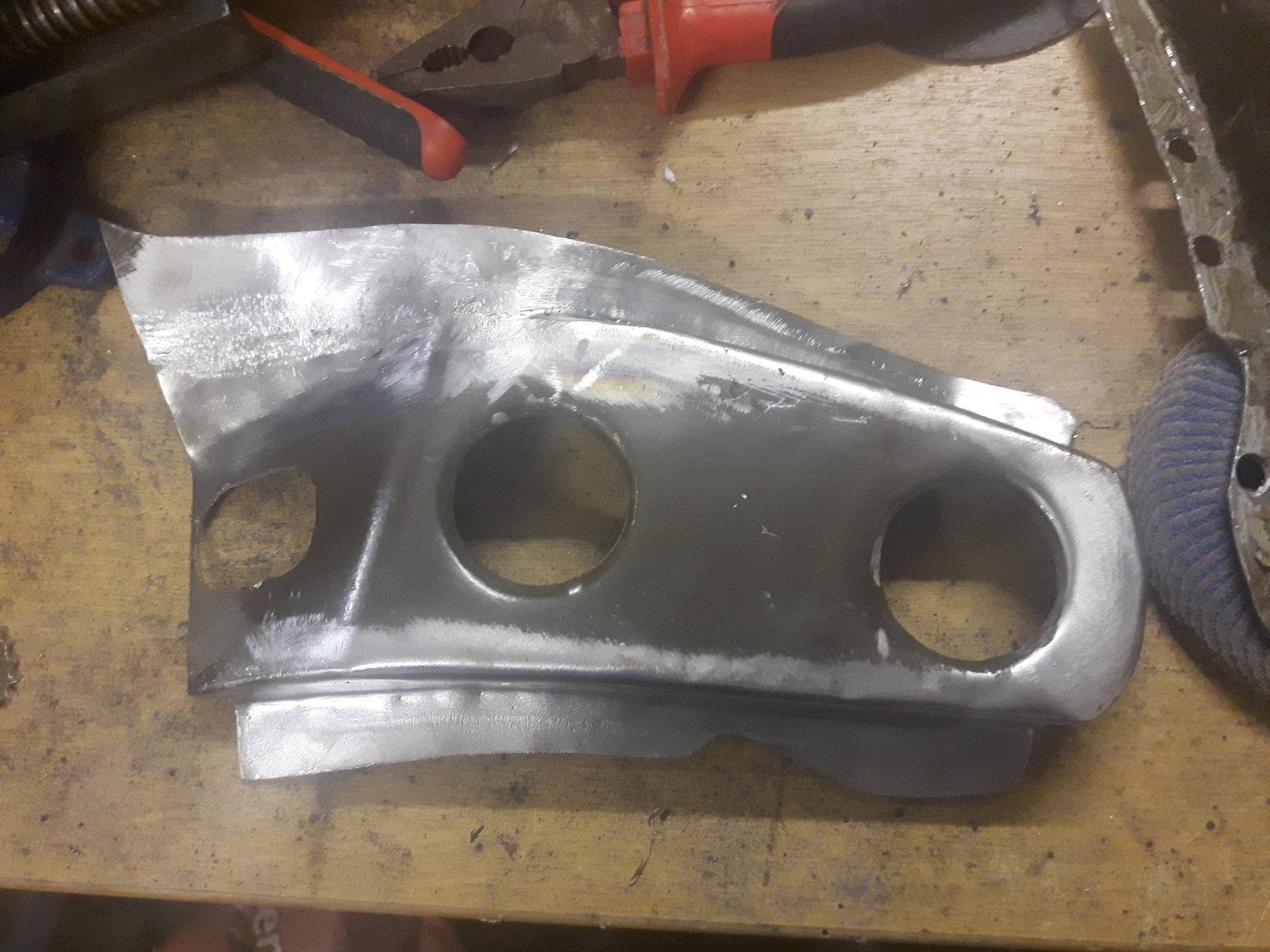

One part I am particularly proud of was the front jacking point/outrigger. You can't buy them so fabrication was the only option. Made it from the shelf from the locker I had......

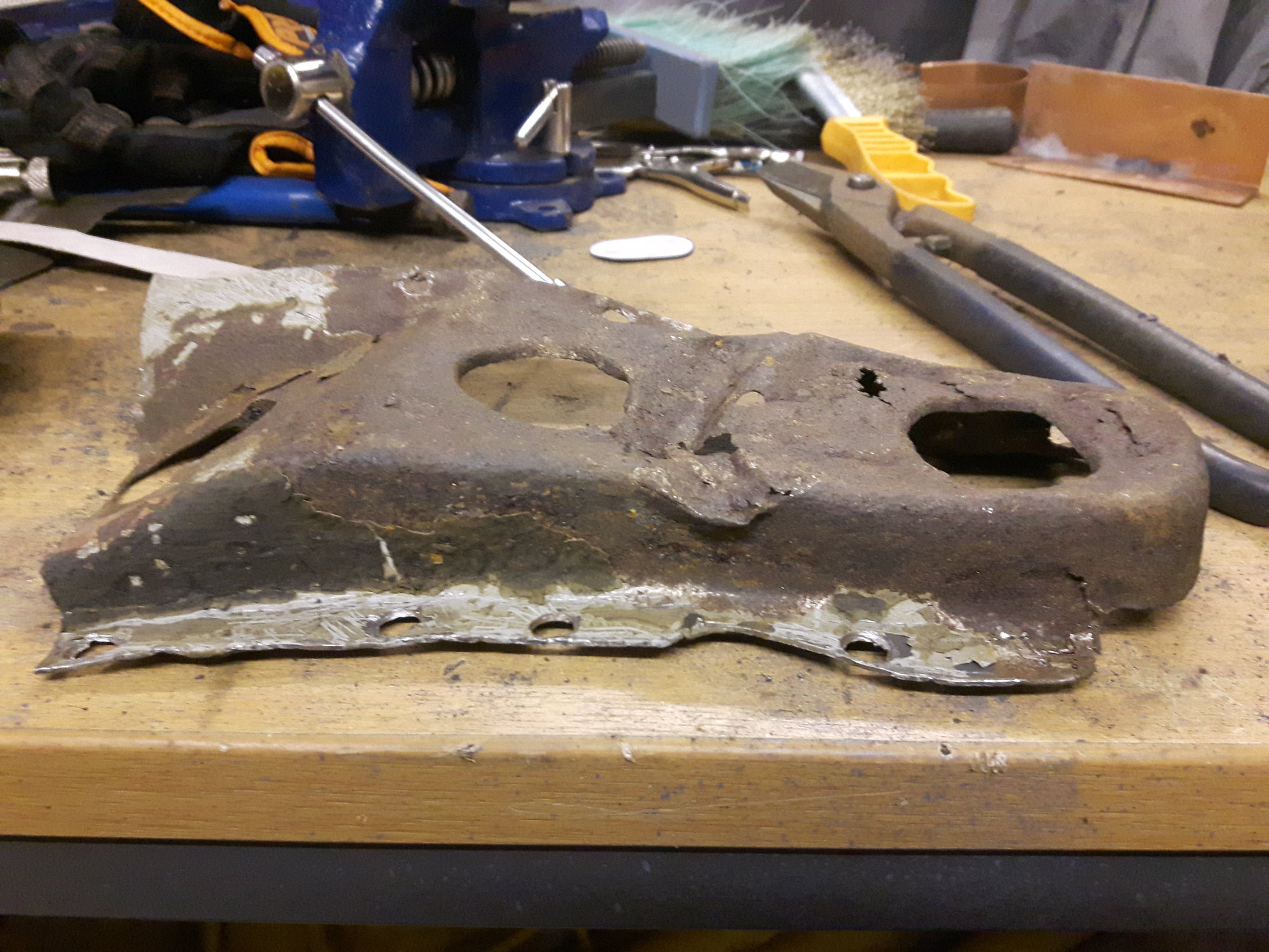

It's a real mess but I managed to bash it back in to some sort of shape....

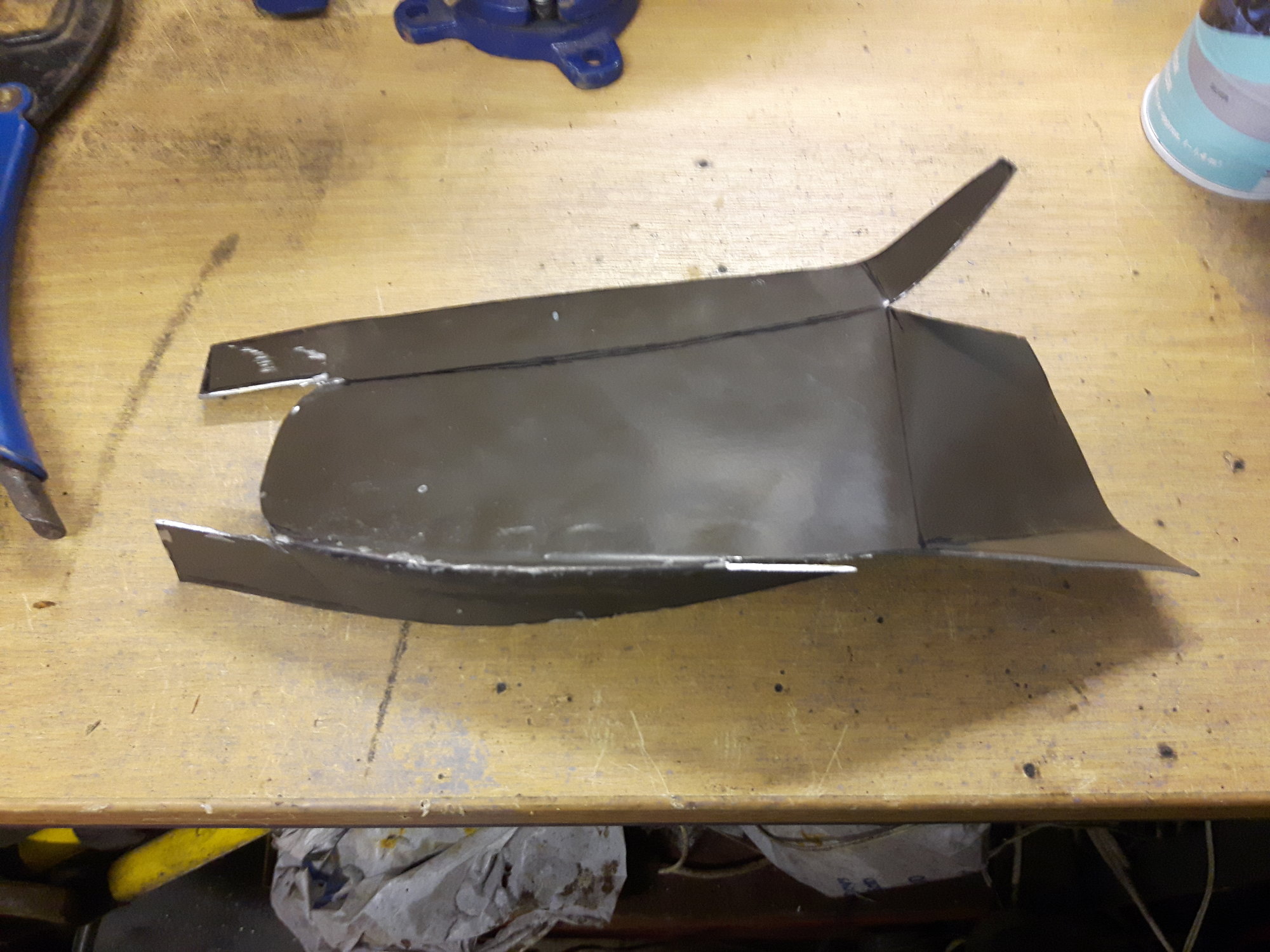

Made some card templates and gave it a go...

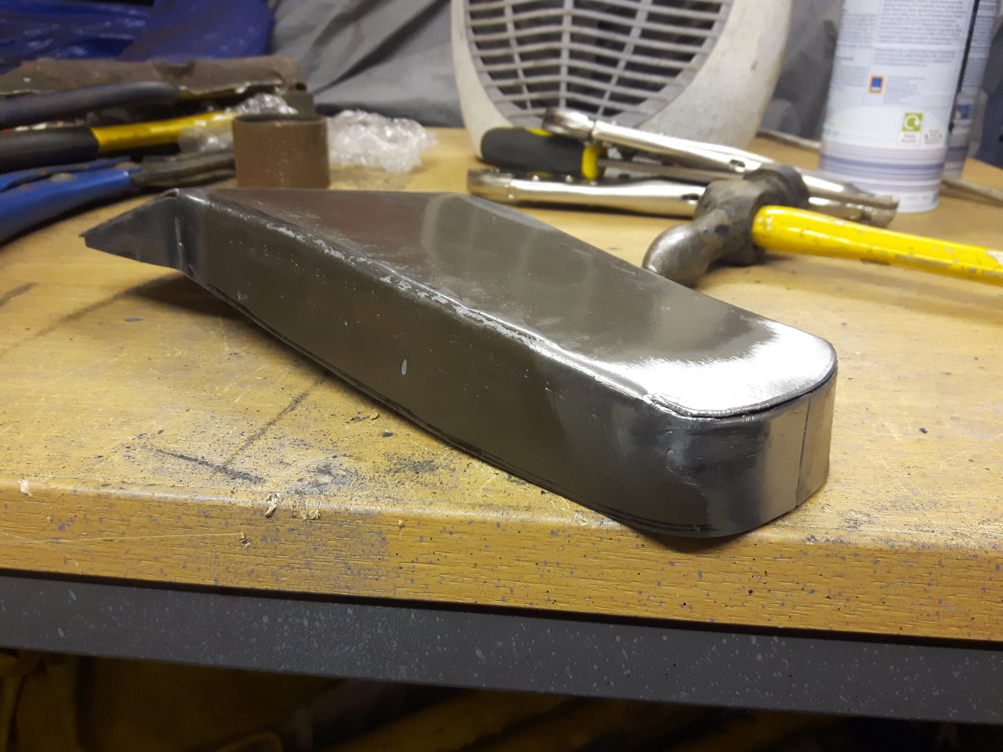

Had to make it from multiple parts as I don't have a stretcher or shrinker.......
Then had to make the flange around the outside.

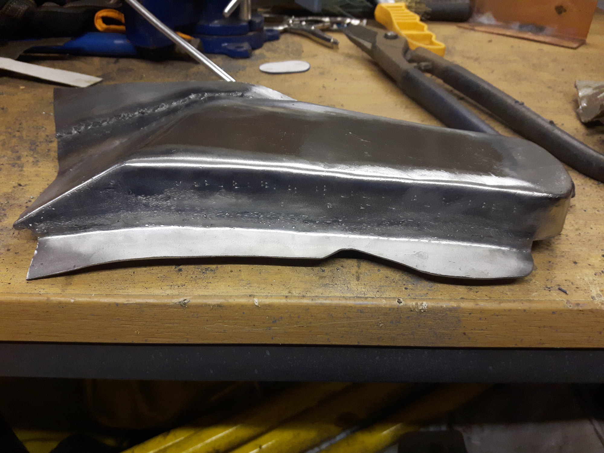

Looks reasonably close.....

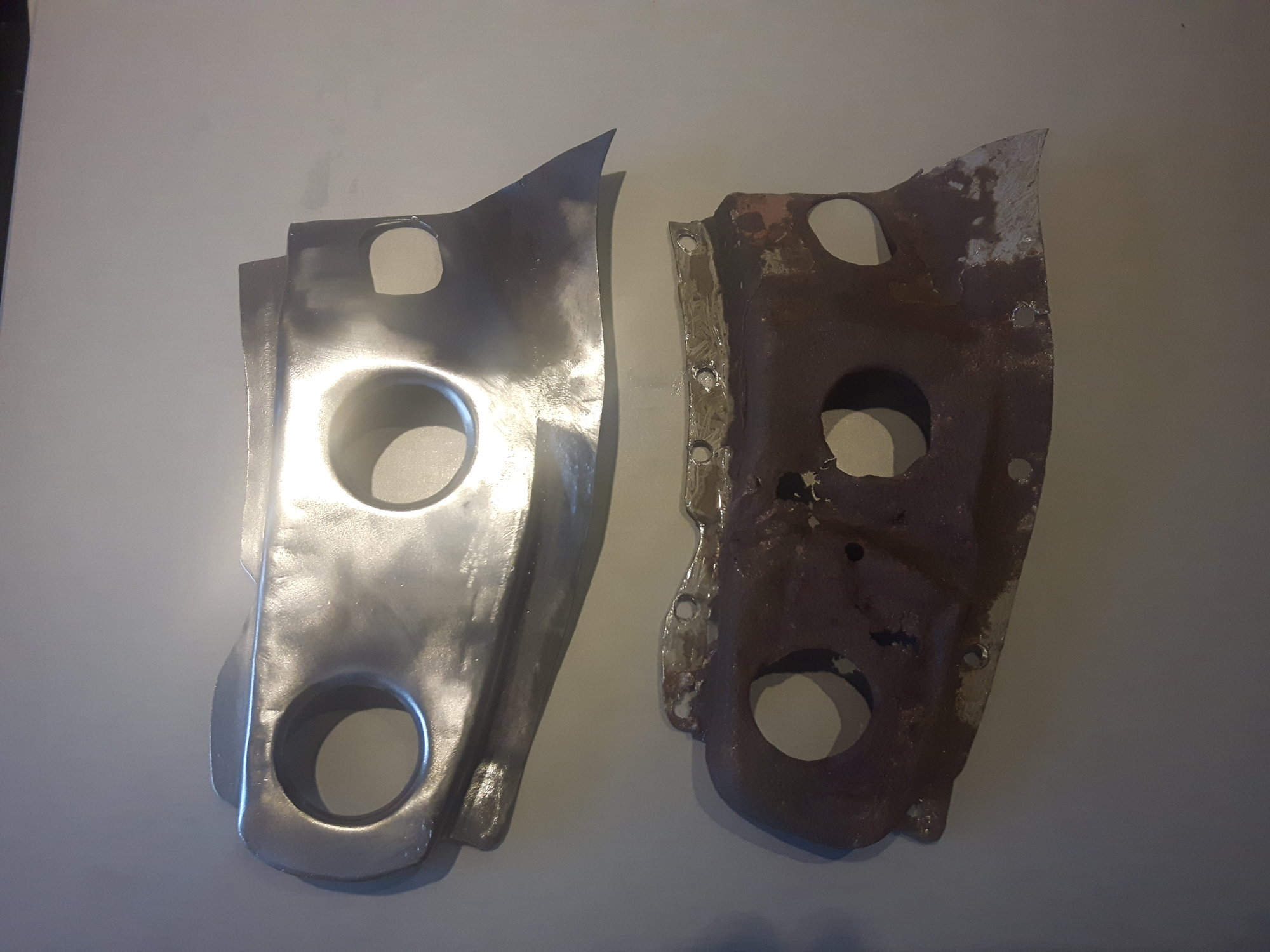

And the finished article for comparison with the original.......
