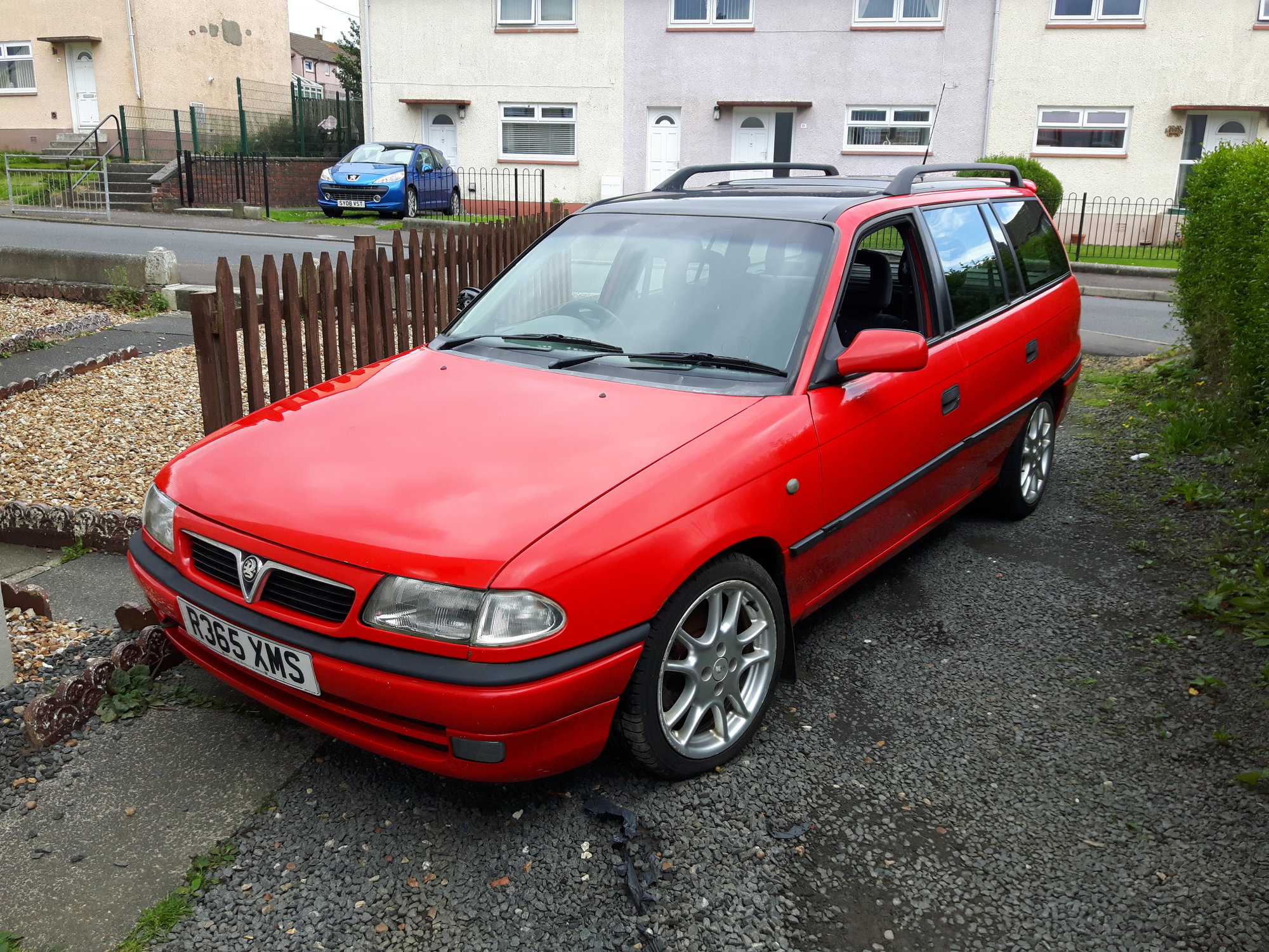

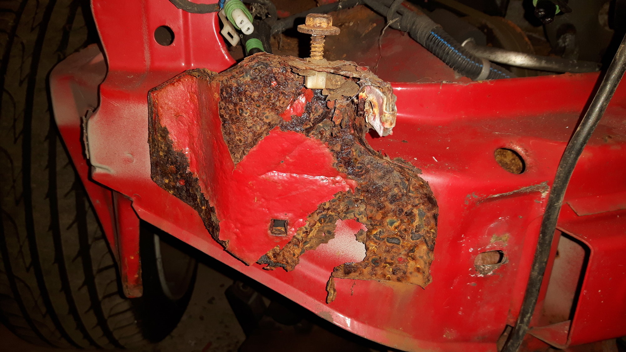

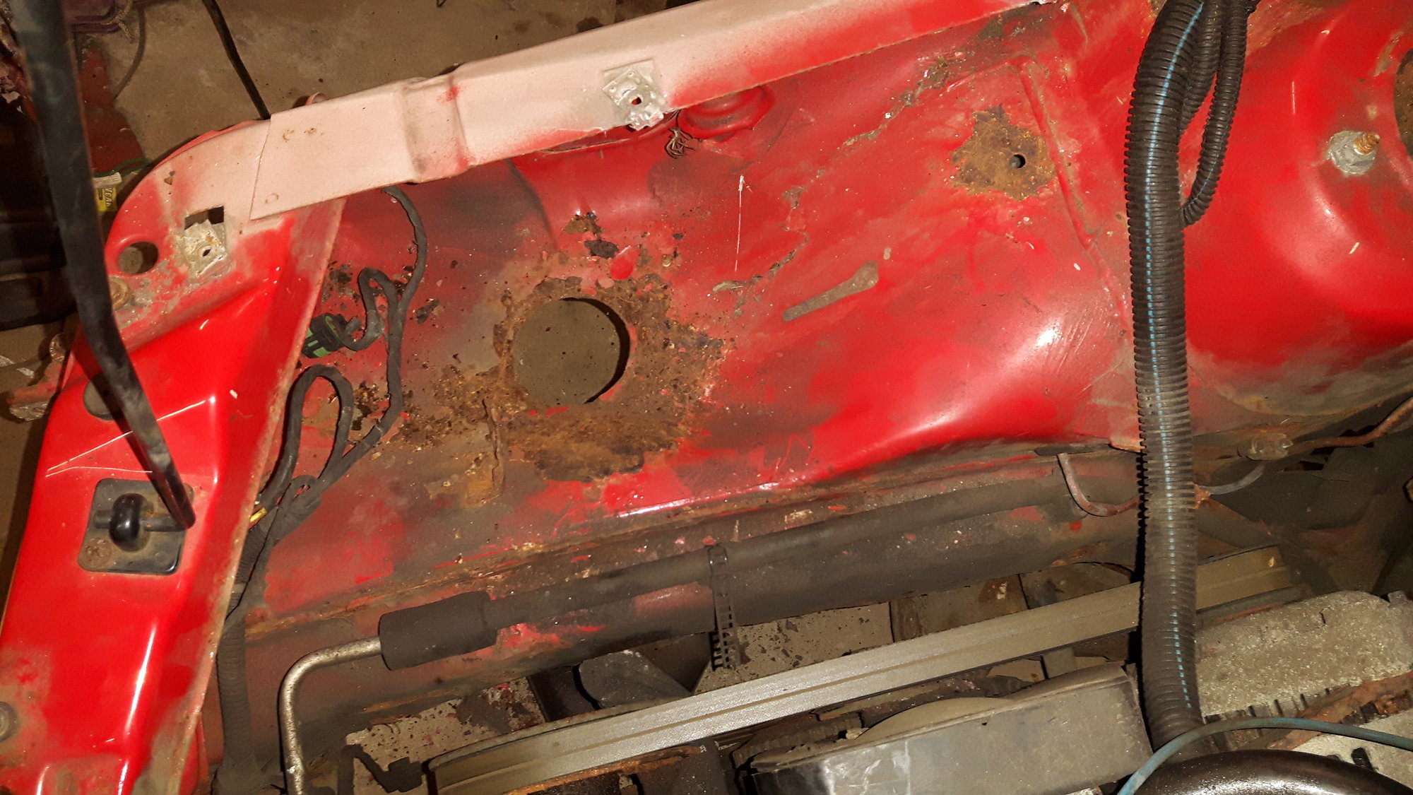

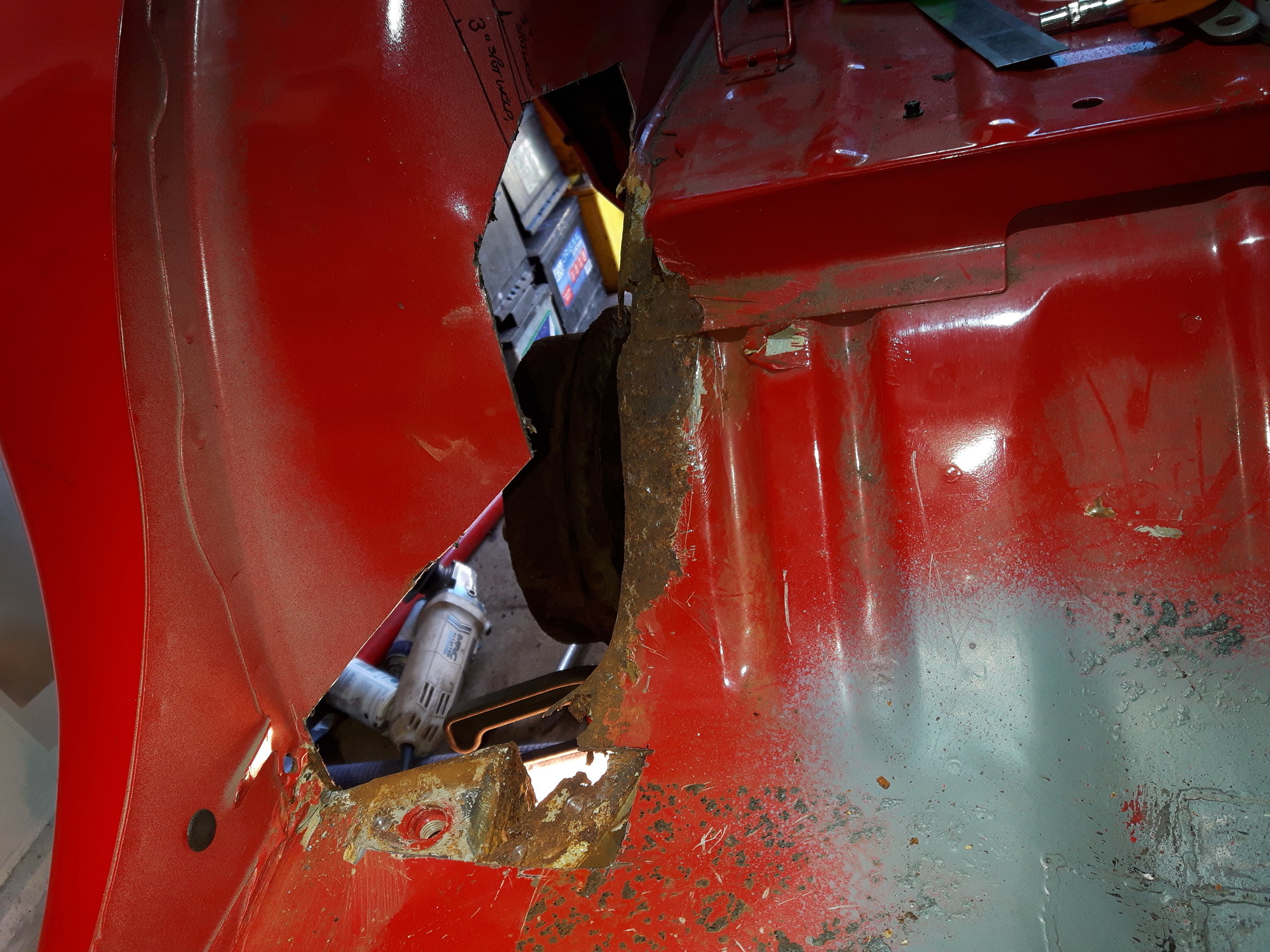

    At first it seemed not too bad. A little rough around the edges. Generally quite nice looking for a 20 year old motor.... 20170731_150347.jpg 20170731_203318.jpg
    Unfortunately that didn't last long.....
    It all went downhill from there.....quickly..
    Just got the front bumper off and it wasn't looking promising
    And that was just what I found within a few minutes...... 20171111_222147.jpg

    Aye, it's an Irmscher exhaust, decals, spoiler and wheels. It's nothing fancy, just a 1.6 8v
    But I always quite liked the look of it when a couple of friends owned it before me. To be honest if I'd known it was as bad I'd never have taken it on as although i was a Vauxhall mechanic and served my time on them I have absolutely no idea when it comes to bodywork. This is my first attempt. I thought it would be a cheap way to practice my welding and fabrication skills on a car in got for free as I was intending in doing a camper van self build so it was cheaper to screw up a free car than an expensive van. I only took the car because it's last owner begged me to so it wouldn't get scrapped. But to be honest, now I'm glad I did. I'm really enjoying it and learning a huge amount. Even my welding skills are.....not bad.....lol. Definitely an improvement from when I started....
    The 90's were good years for Vauxhalls. Some pretty tough classic motors. I'd love to get a cavalier or nova but I'll see how I do with this first....

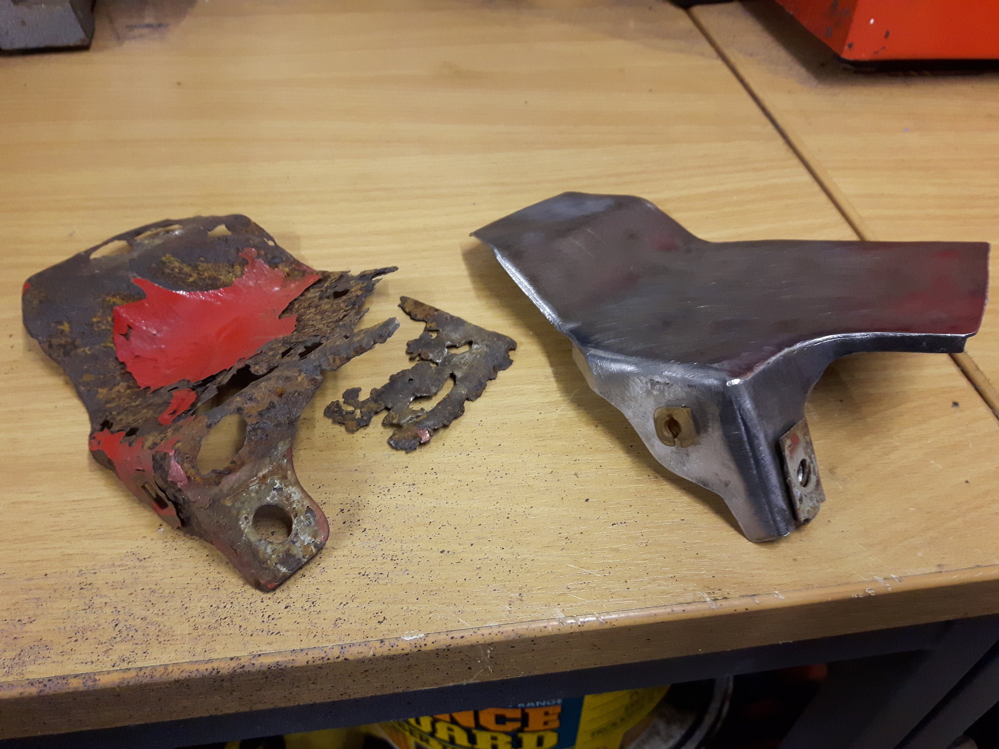

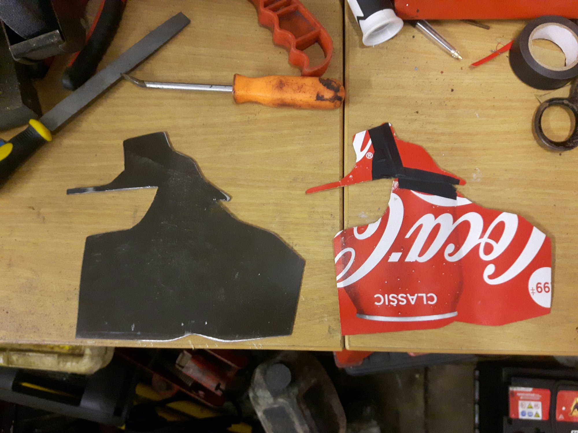

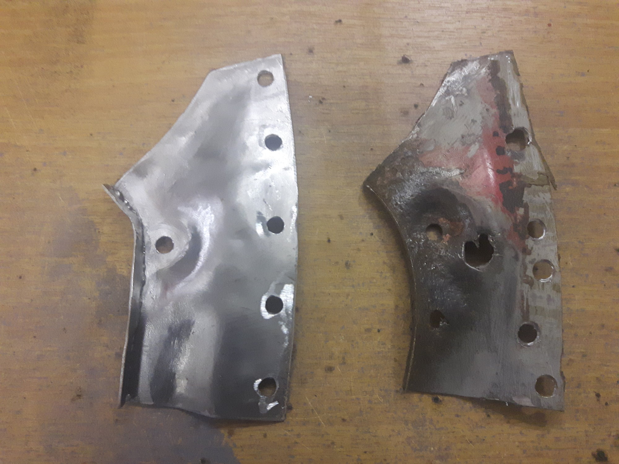

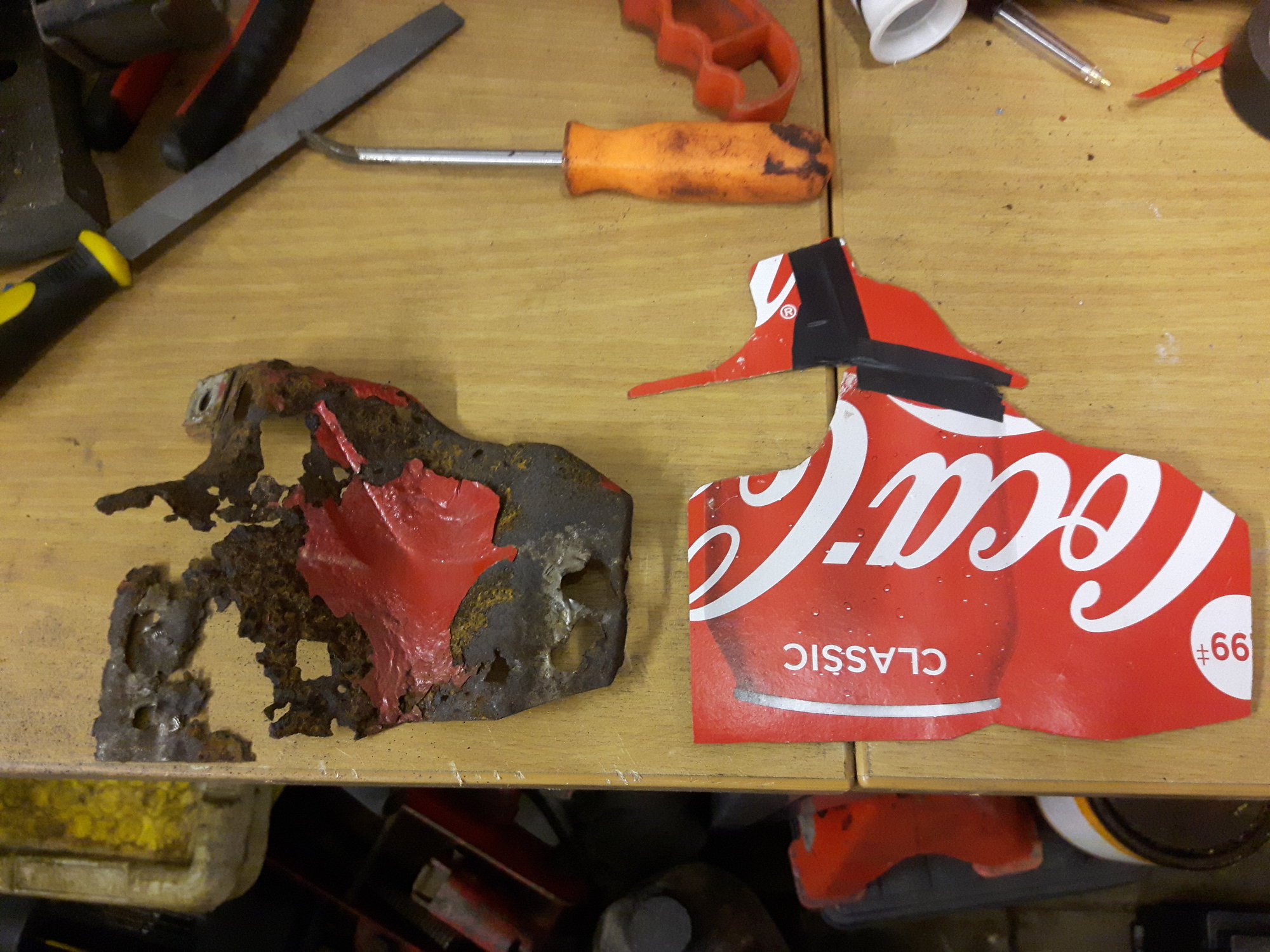

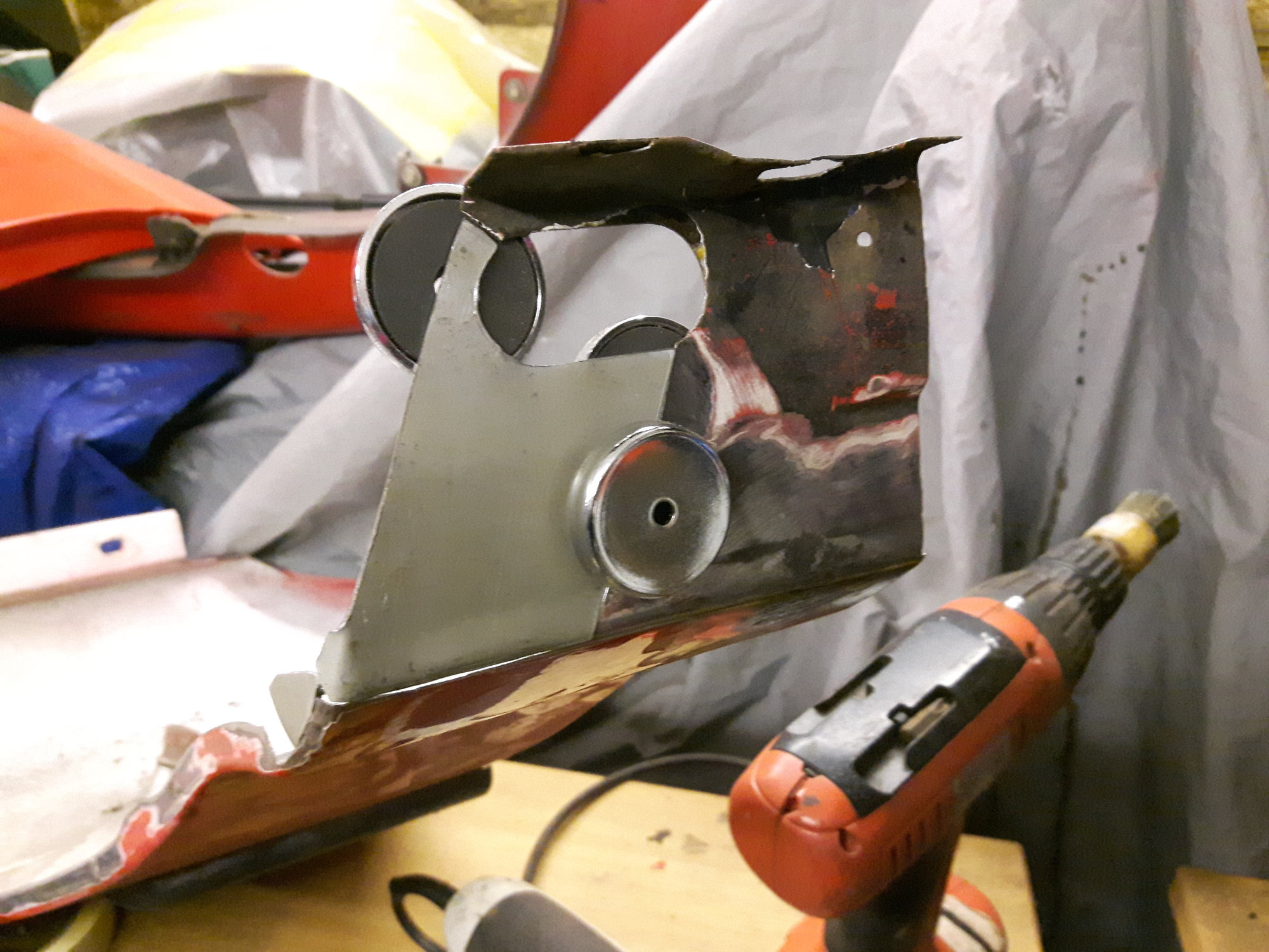

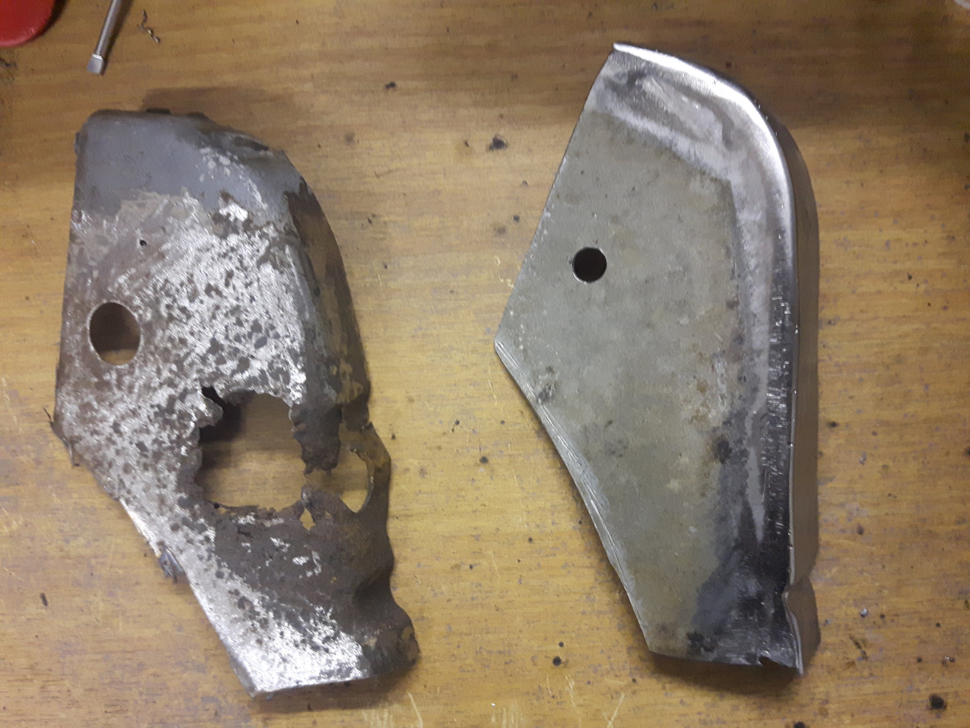

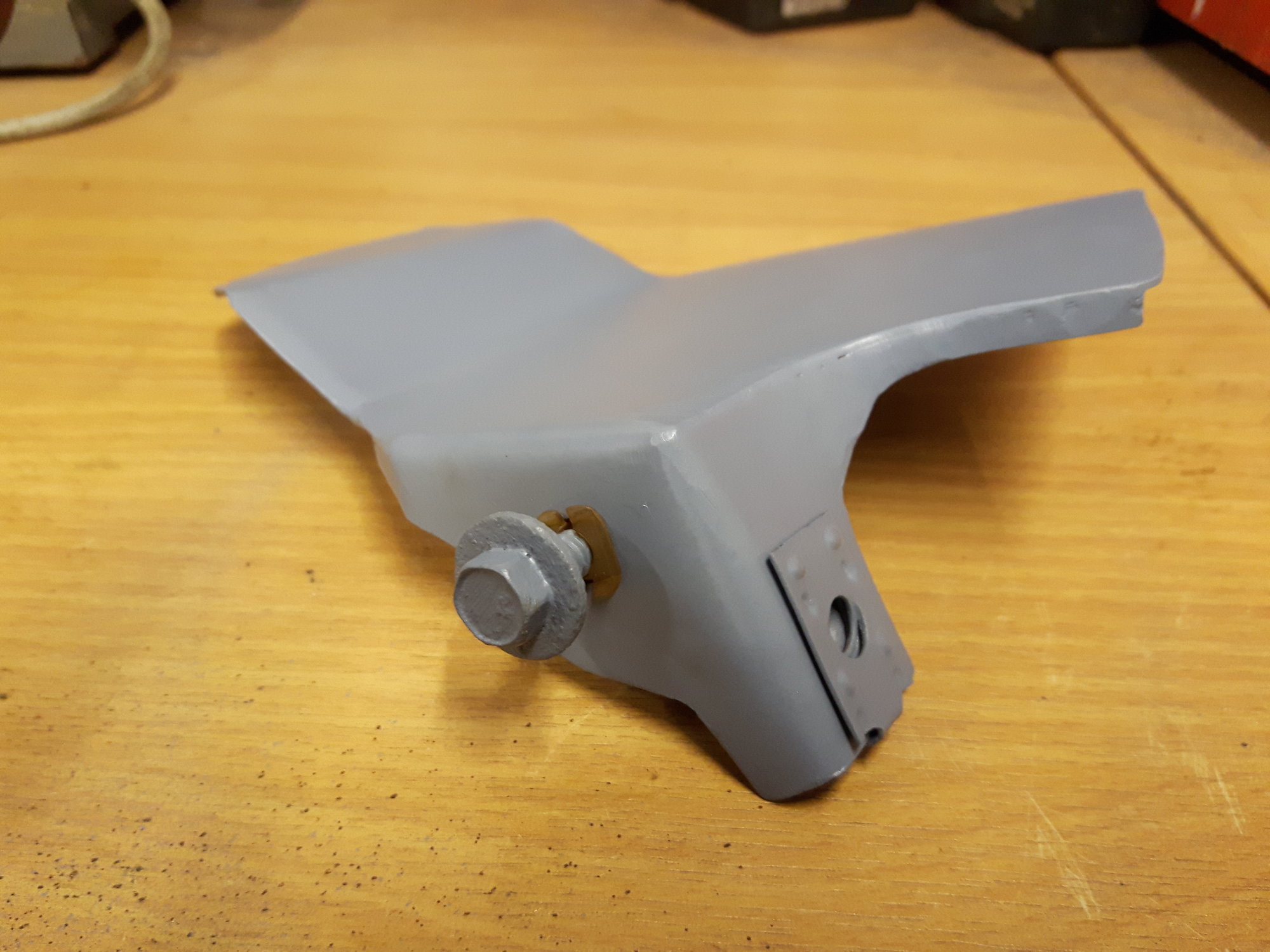

    I started off at the front end on some brackets that nobody would see if I made a mess. 20171120_202349.jpg
    It was way beyond saving so I decided to break out the pen and cardboard.
    It actually worked out pretty well....
    The finished article....
    It looked almost genuine when fitted....

    how are the arches? worked at a vauxhall bodyshop when they still roamed the earth
    Matt Thomson likes this.
  8. Matt Thomson
    Matt Thomson Member
    Messages:
    81
    Location:
    North Ayrshire, Scotland
    The arches????

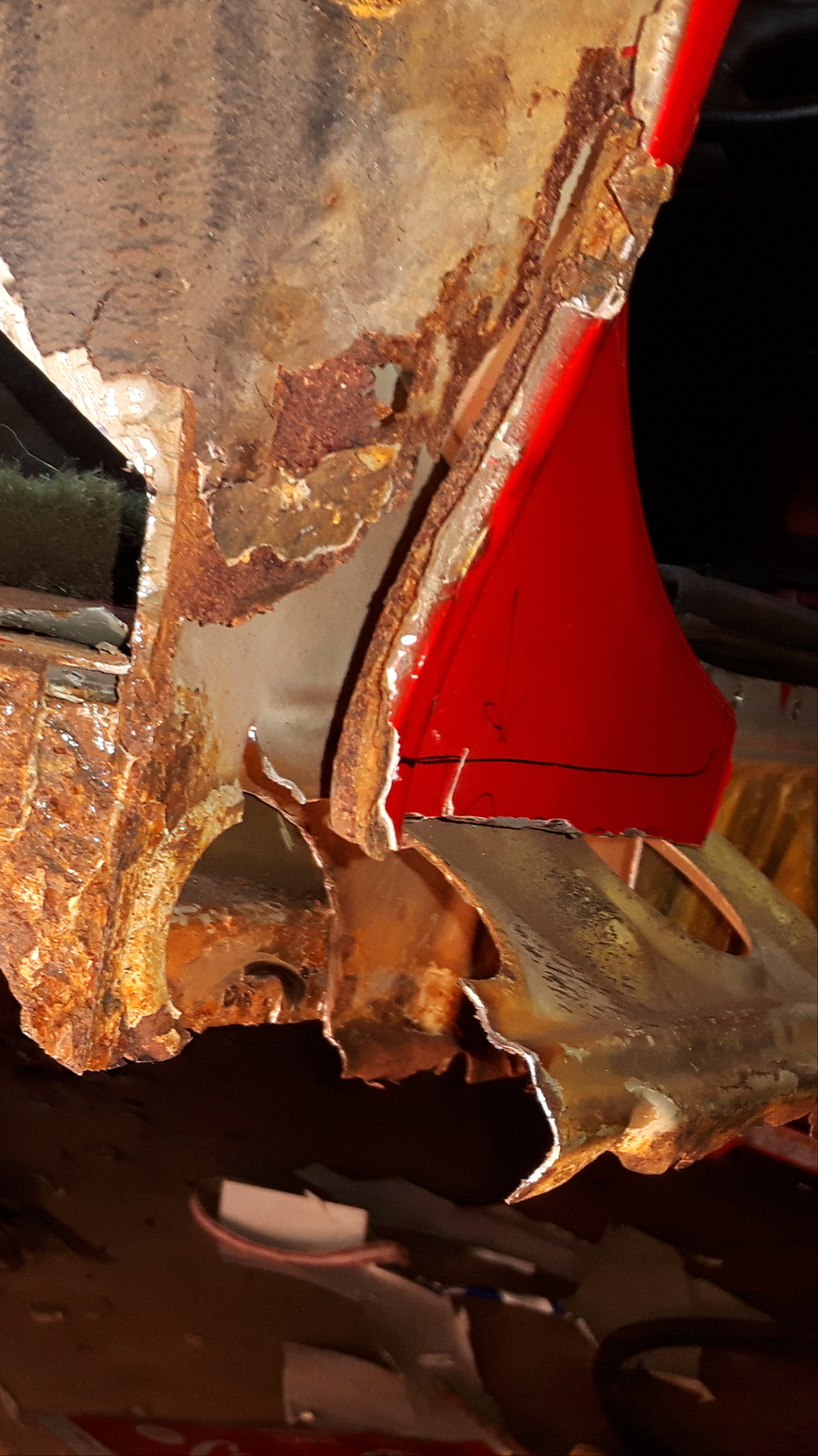

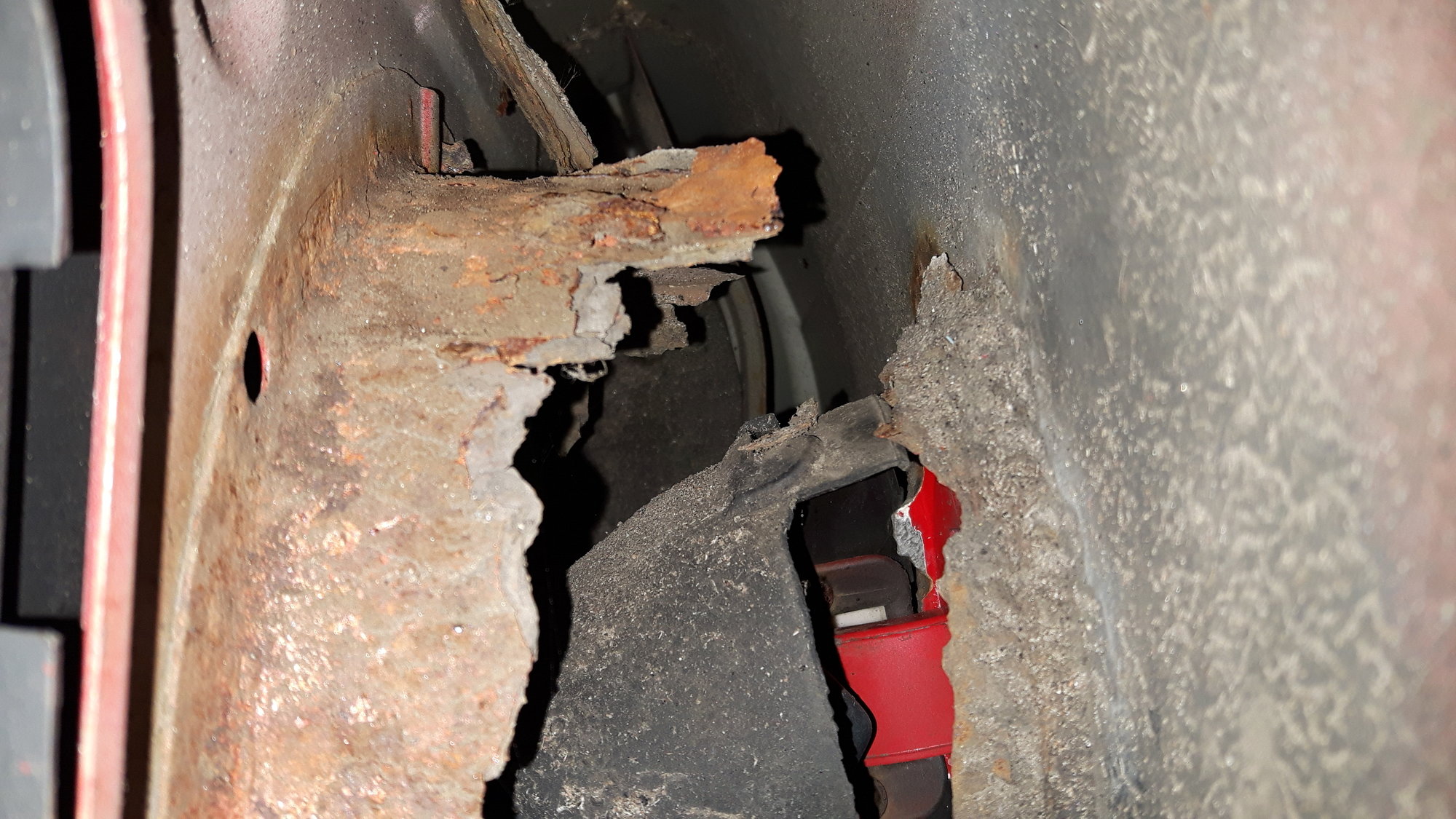

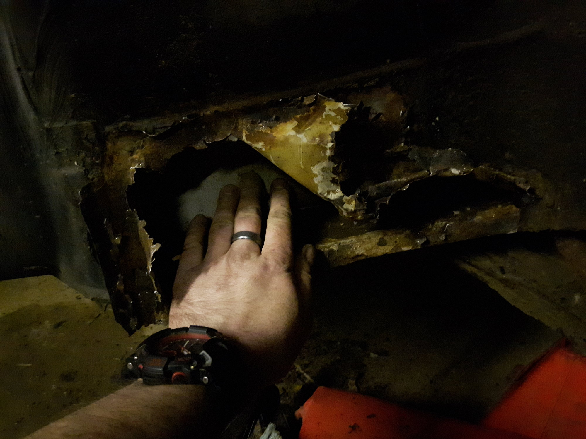

    Outside......surprisingly good at a glance....
    The inside?? Well........a picture says a thousand words......
    That started off as a 1" hole behind a previous repair........
    Ended up a bit bigger.......

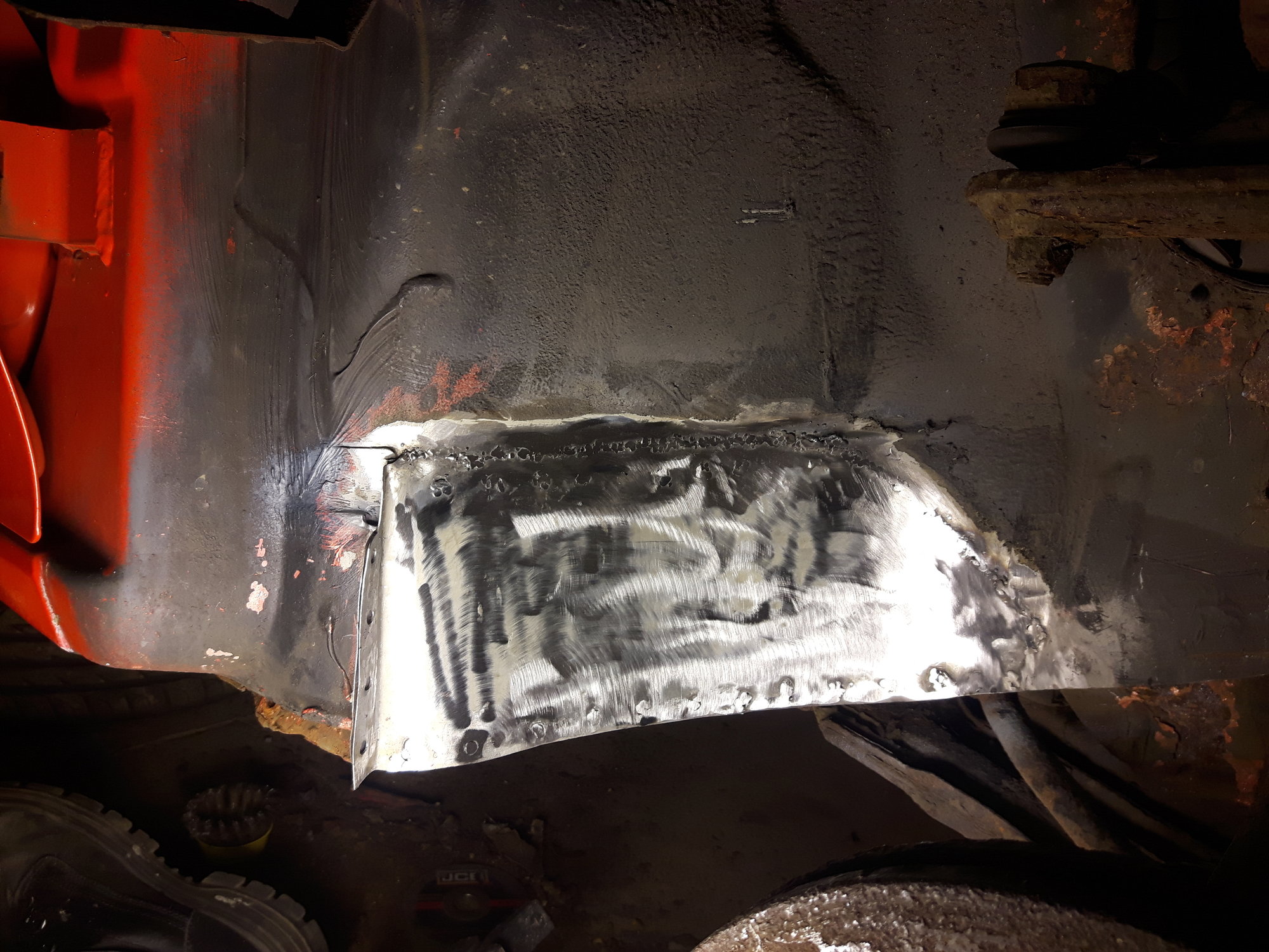

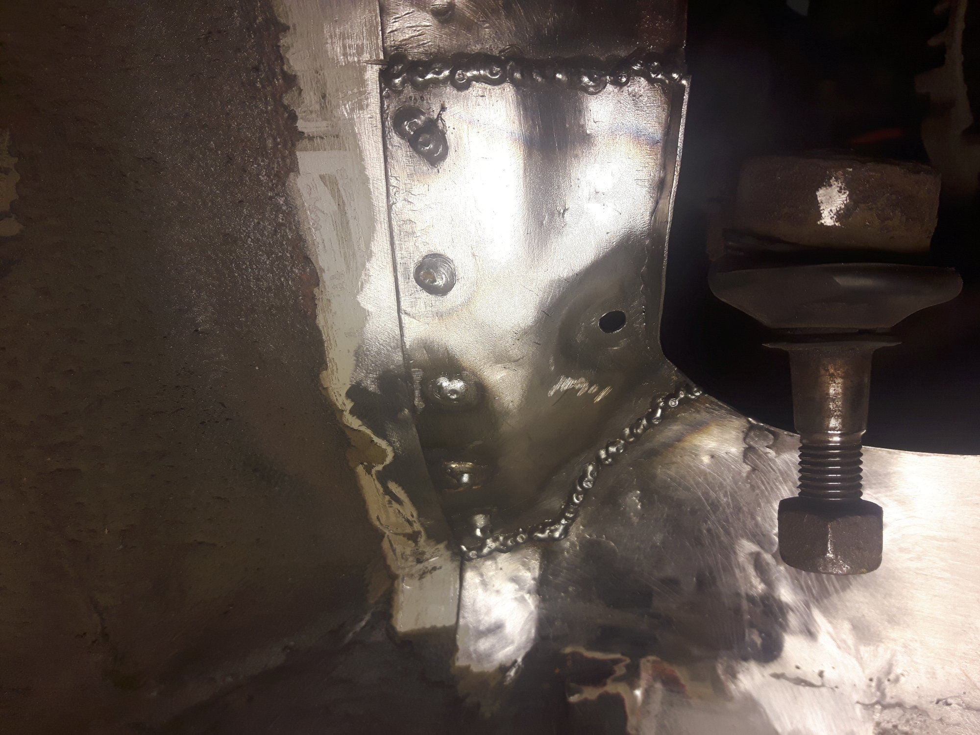

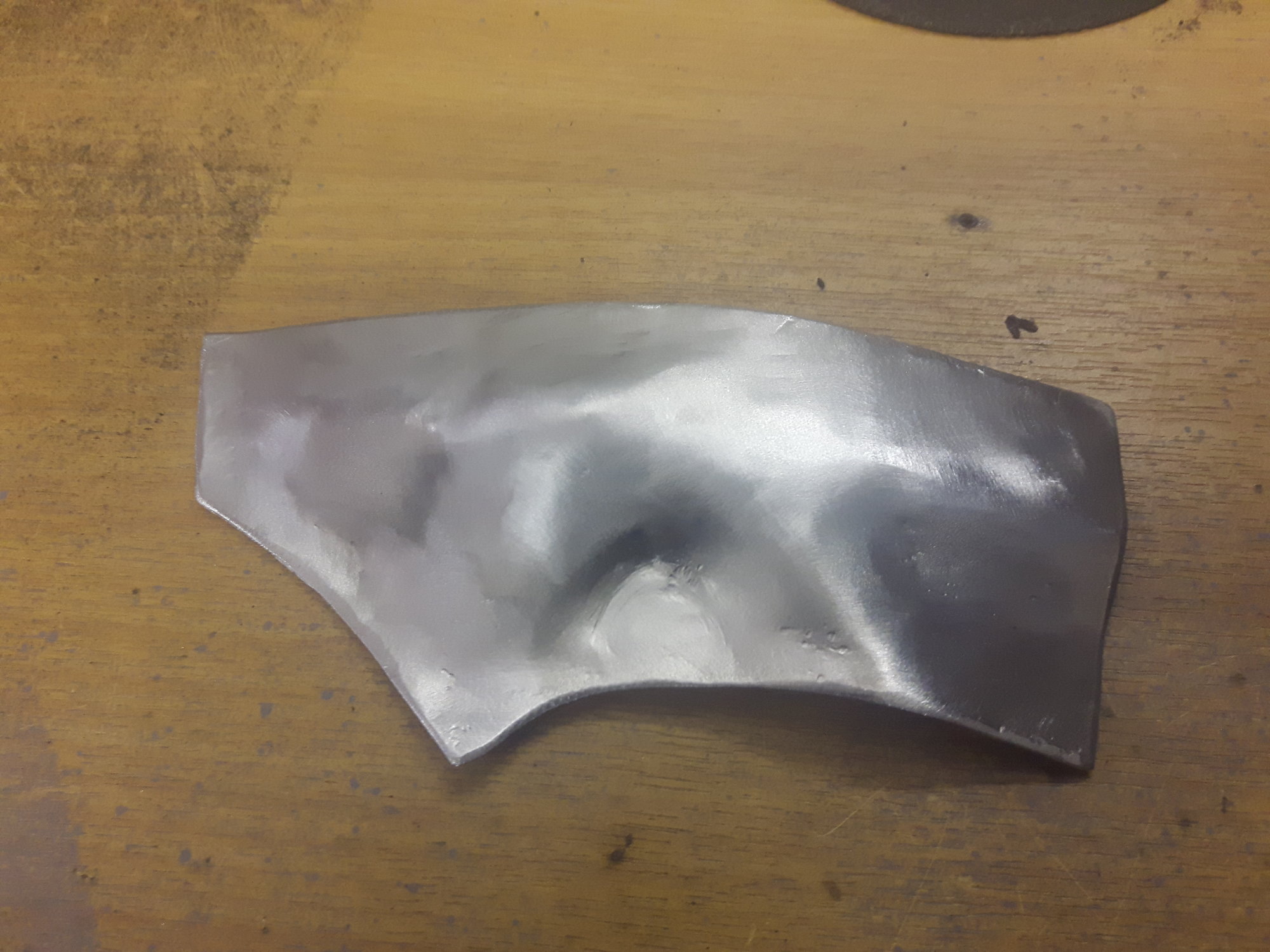

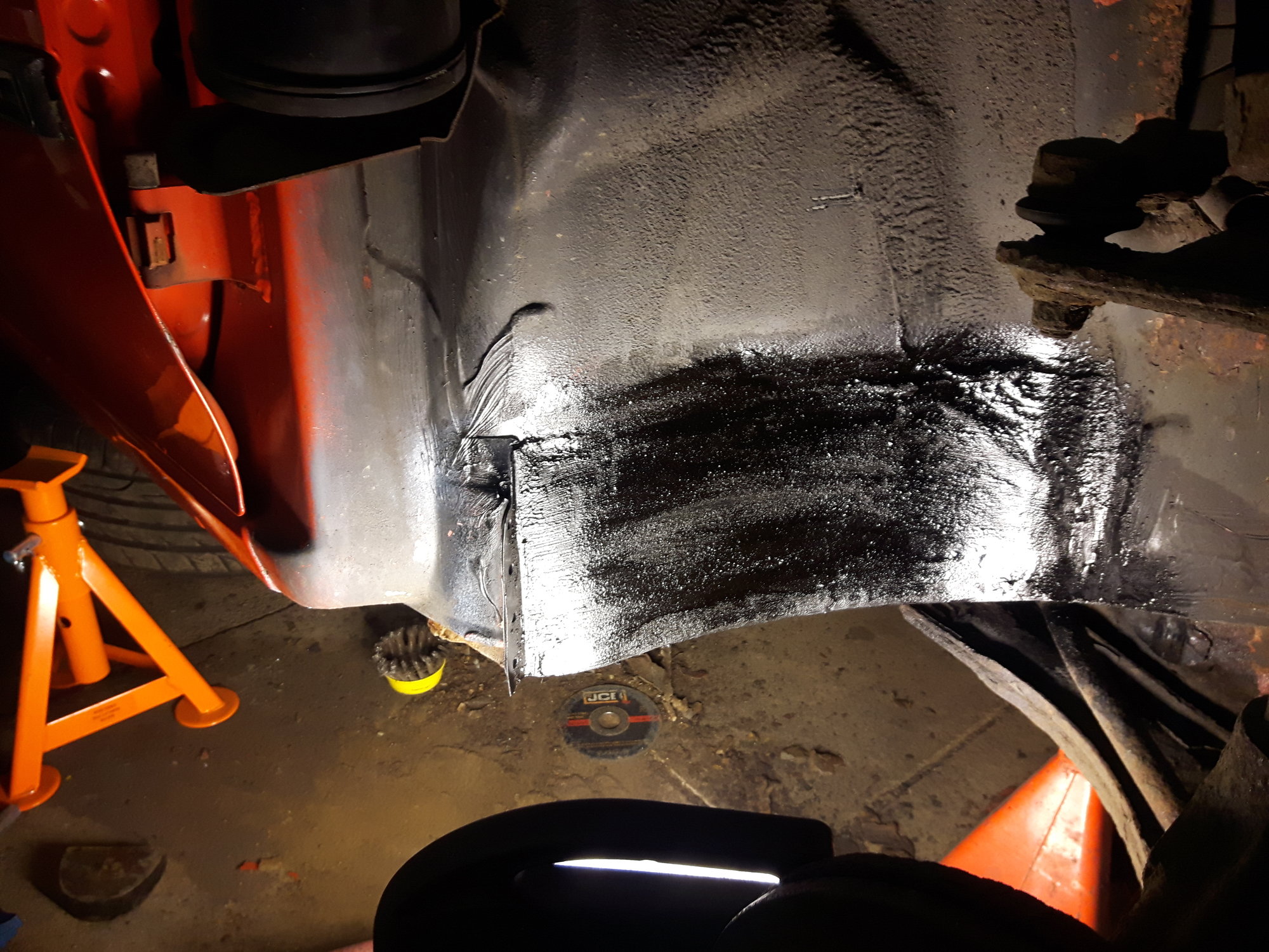

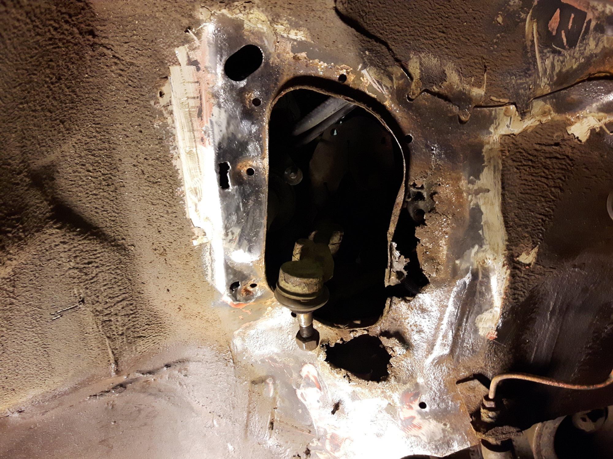

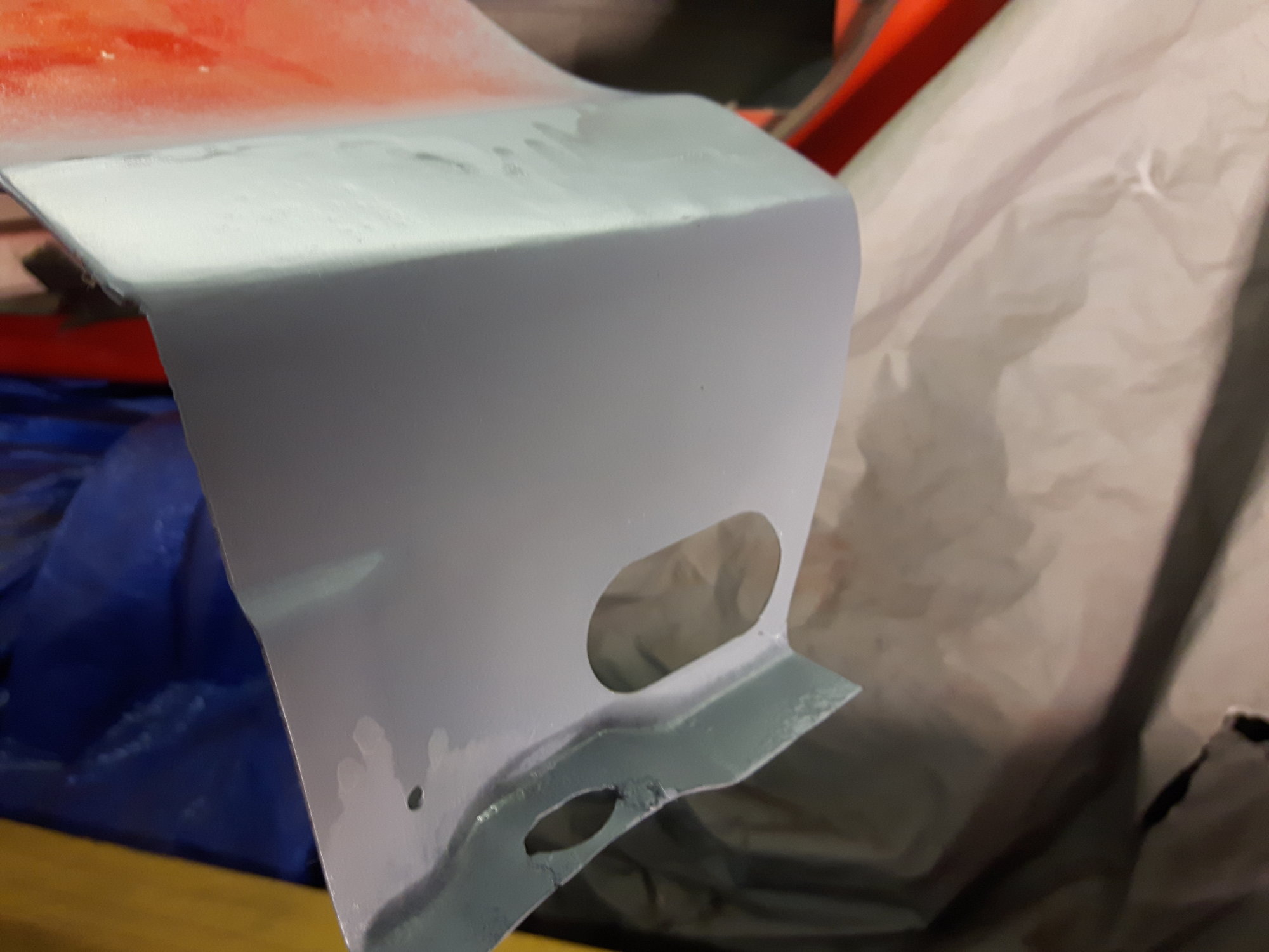

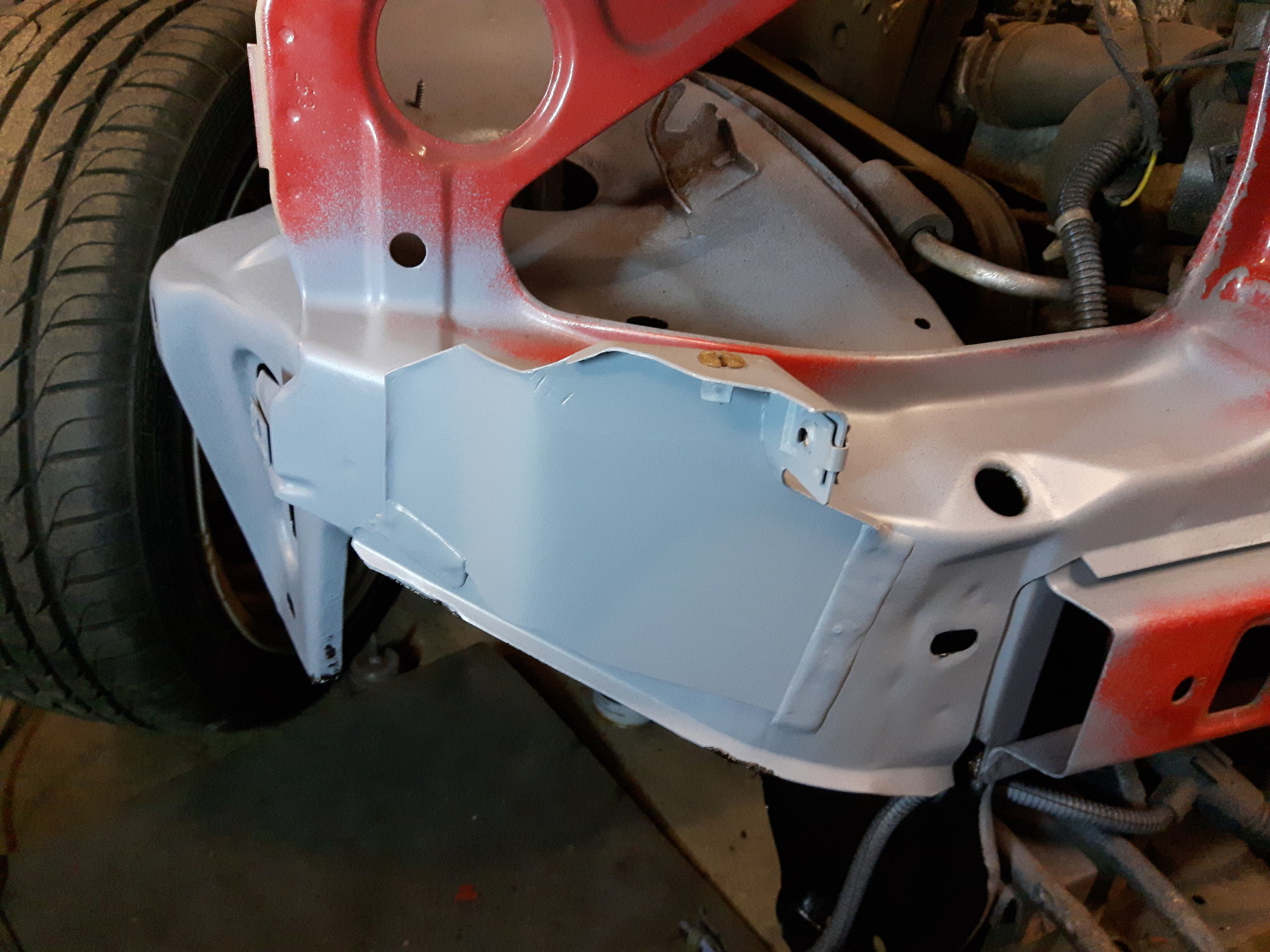

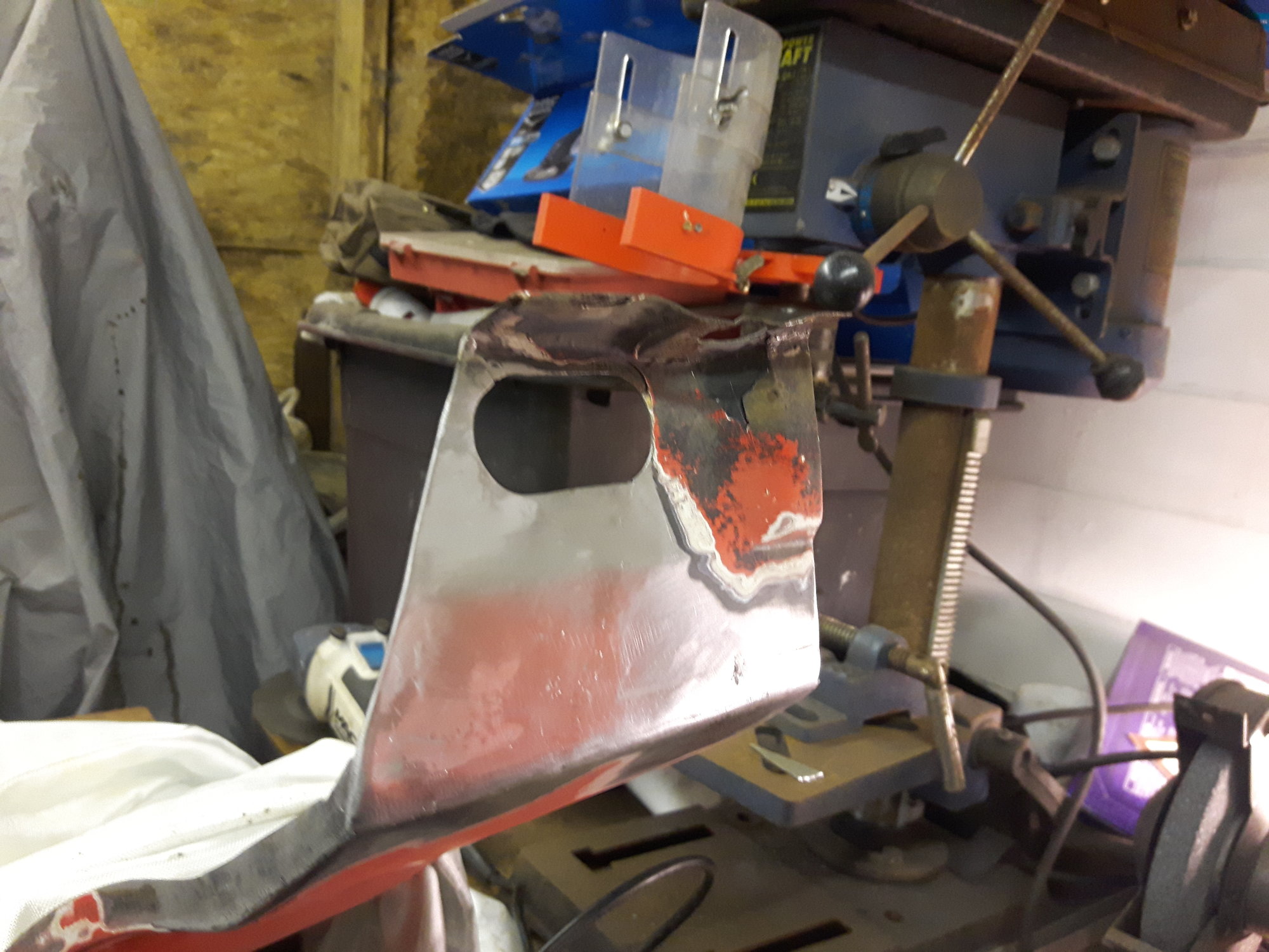

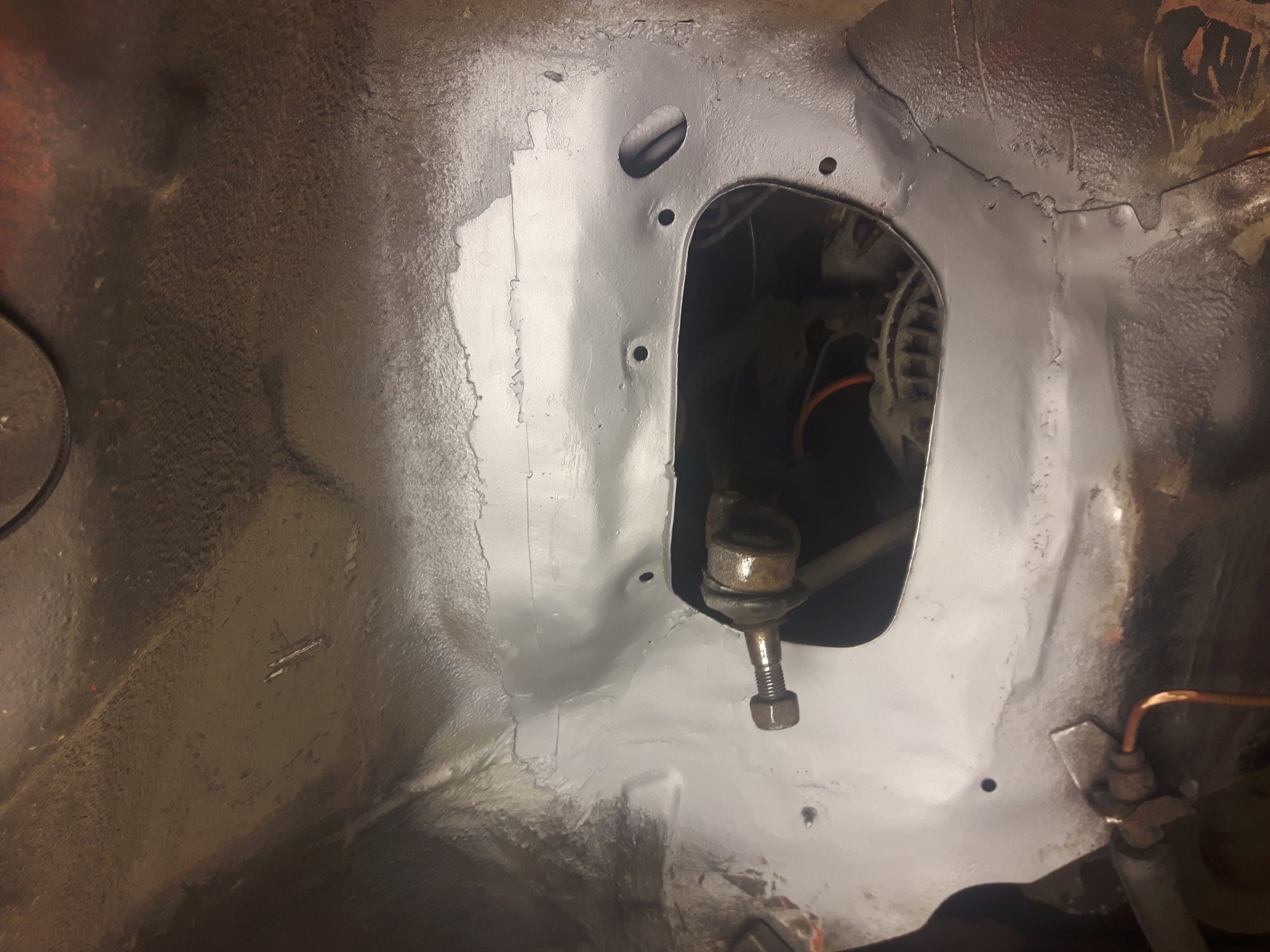

    The front inner wheel well wasn't much better. It was like Swiss cheese...
    Decided to cut up an old steel locker and made some repair panels for around the steering arm hole.....
    And used a ball pein hammer and an old bag of cement to contour the odd shaped sections...
    Like for like it actually turned out not too badly.....
    And with a good grind and some zinc primer was almost passable .....

    ok you asked for comments...looks like aerosol stone chip straight on bare metal?
    if its a keeper epoxy primer like jotun jotamastic is 100x betters and will protect it best

    Ooh, which part?? The black patch with my hand in it or the silver part round the steering hole??

    the black stuff?
    anyway all the hard work youre doing , epoxy will protect it properly if thats what you want

    Ah, right I see. The patch was zinc coated, painted both sides with an etch primer, the areas that were getting exposed to the heat of the weld got zinc weld through primer then the whole thing got a coat of primer after the weld then aerosol tetrosyl. I'll need to look in to this jotamastic stuff. Can't say I've heard of it, but yeah all that info is good as I've plenty to learn. I definitely want to protect it as I'm intending in keeping it a while and rebuilding it properly....

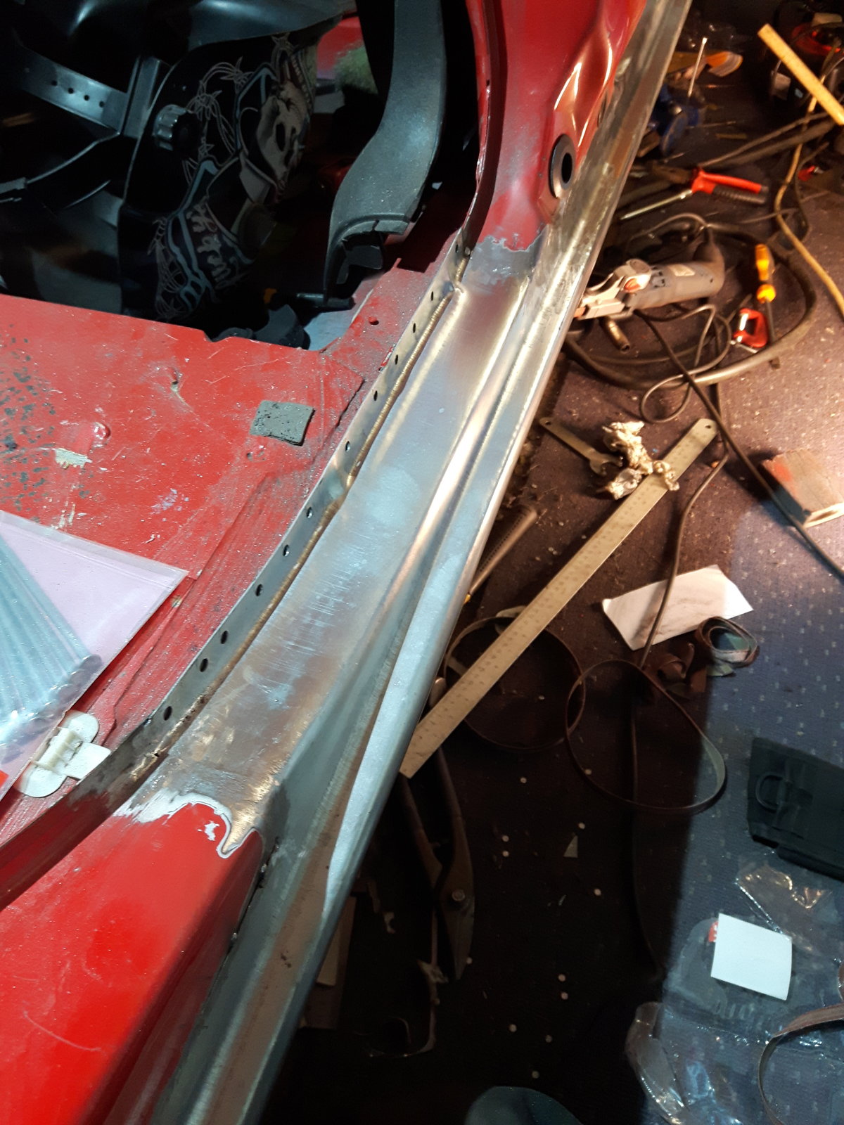

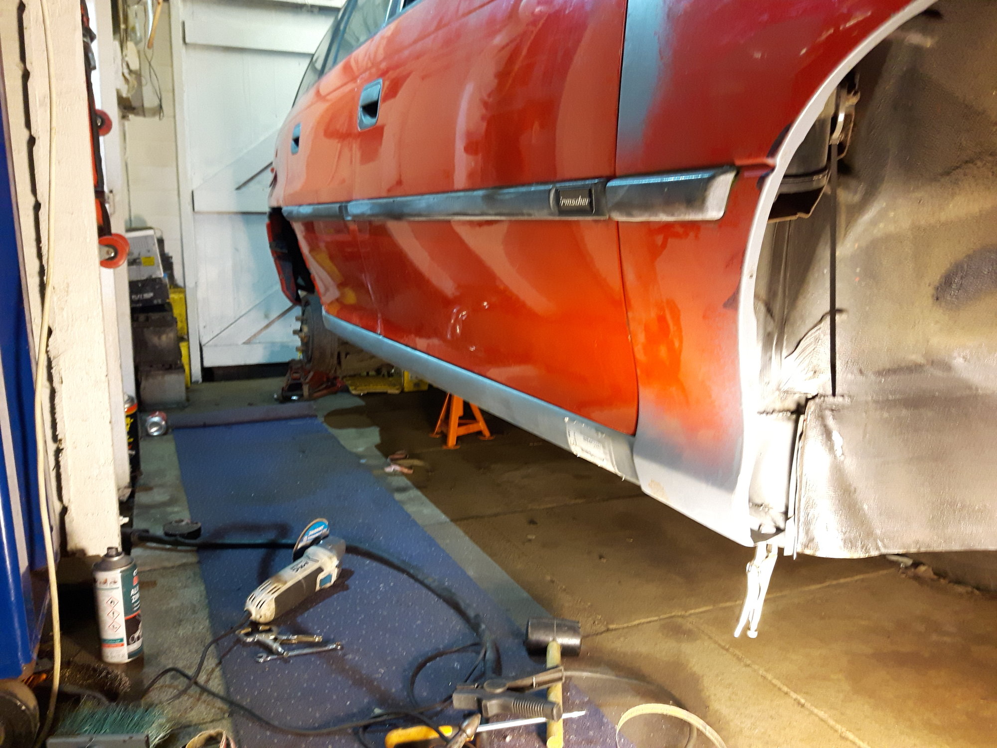

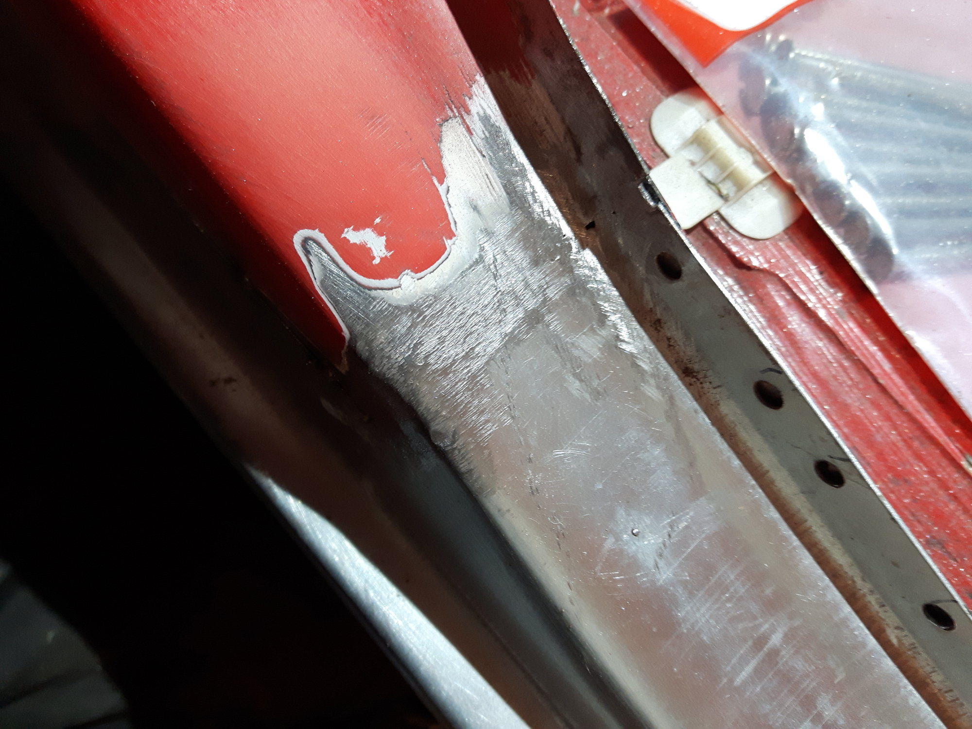

    The sill was an absolute mess..it was nothing but sealer holding rust and shoddy repairs together.... 20171216_172620.jpg
    That had rotted through and made the bottom section of the wing disappear......
    I reckon it turned out not badly, but was a pain in the backside as I was using gasless flux cored 0.8mm wire. It was after a chat with someone on here that I sorted out a big gas bottle and changed to 0.6mm for the thinner bodywork stuff, but still worked out OK in the end.... Didn't even need filler, just gave it a coat of primer to keep it sealed till it gets painted...

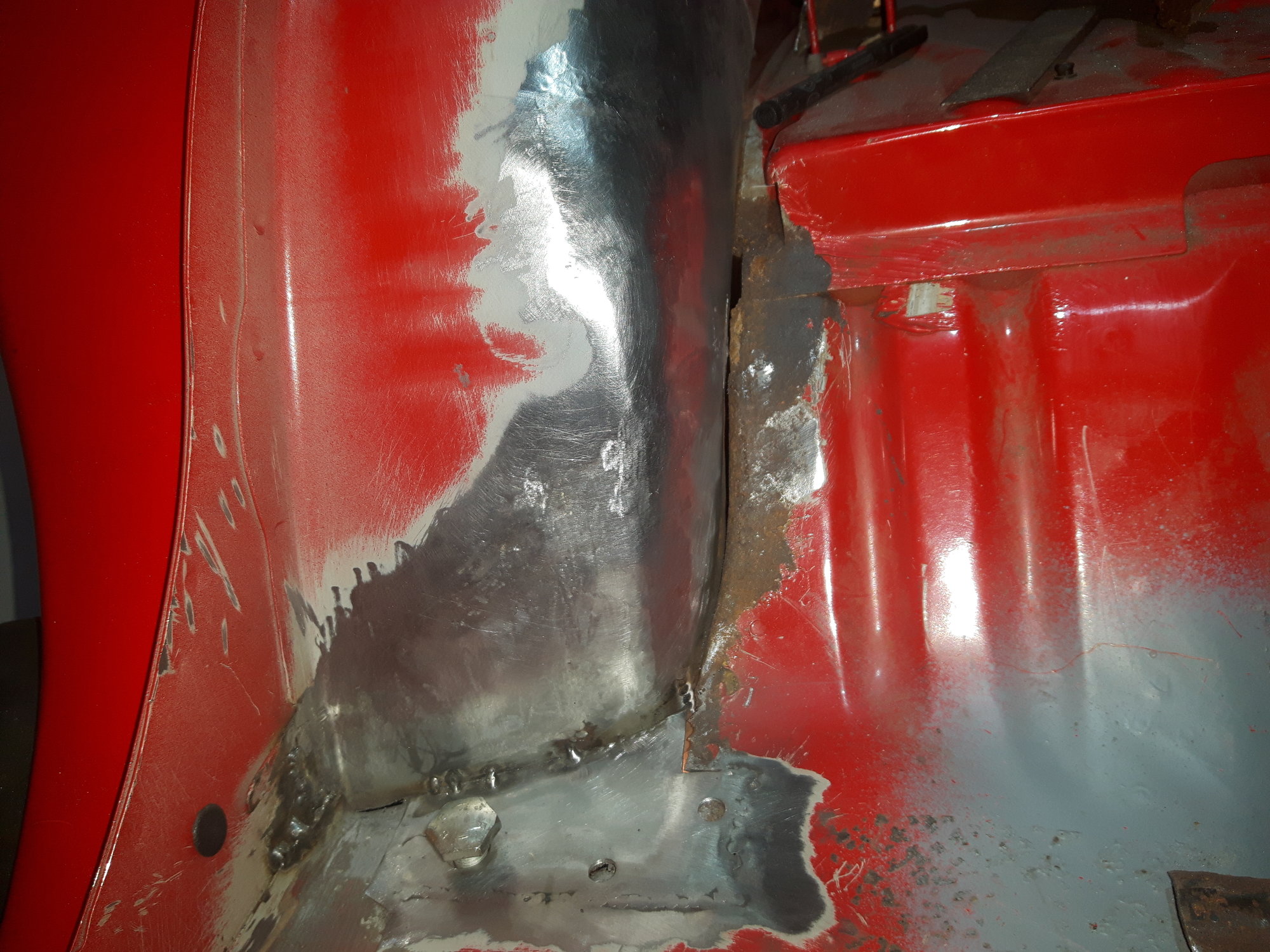

    Thanks, I appreciate that. It's been a bit of a learning curve. I make the odd patches and panels at work but they're all aluminium and pretty flat. Easy enough to make. Any of the complex stuff the metalwork shop deals with that. I just fit them rather than making them. It's a bit of a challenge, but that why I'm really enjoying it, it's a bit of a change from the norm. The inner arches shouldn't be a problem, I managed to source some replacements from Germany and now I'm feeling a little more confident I've decided to save myself a lot of hassle and time by just replacing the whole rear quarter. It wasn't an option to start with as they were coming in at around £300, but I managed to locate a supplier who had it delivered for the grand total of £35. Buying the individual repair panels comes to more than double that, and there's still the welding and fitting. I reckon it might turn out OK as I recently fitted the sill back on after a lot of cutting and fabrication and my welds were pretty invisible... I had to rebuild the inner sill at the rear and the inner wheel well too. It was a horror show in there. Even to the stage that the jacking point could be pulled off with my bare hands. Some scrap metal and ingenuity had it back looking quite reasonable.

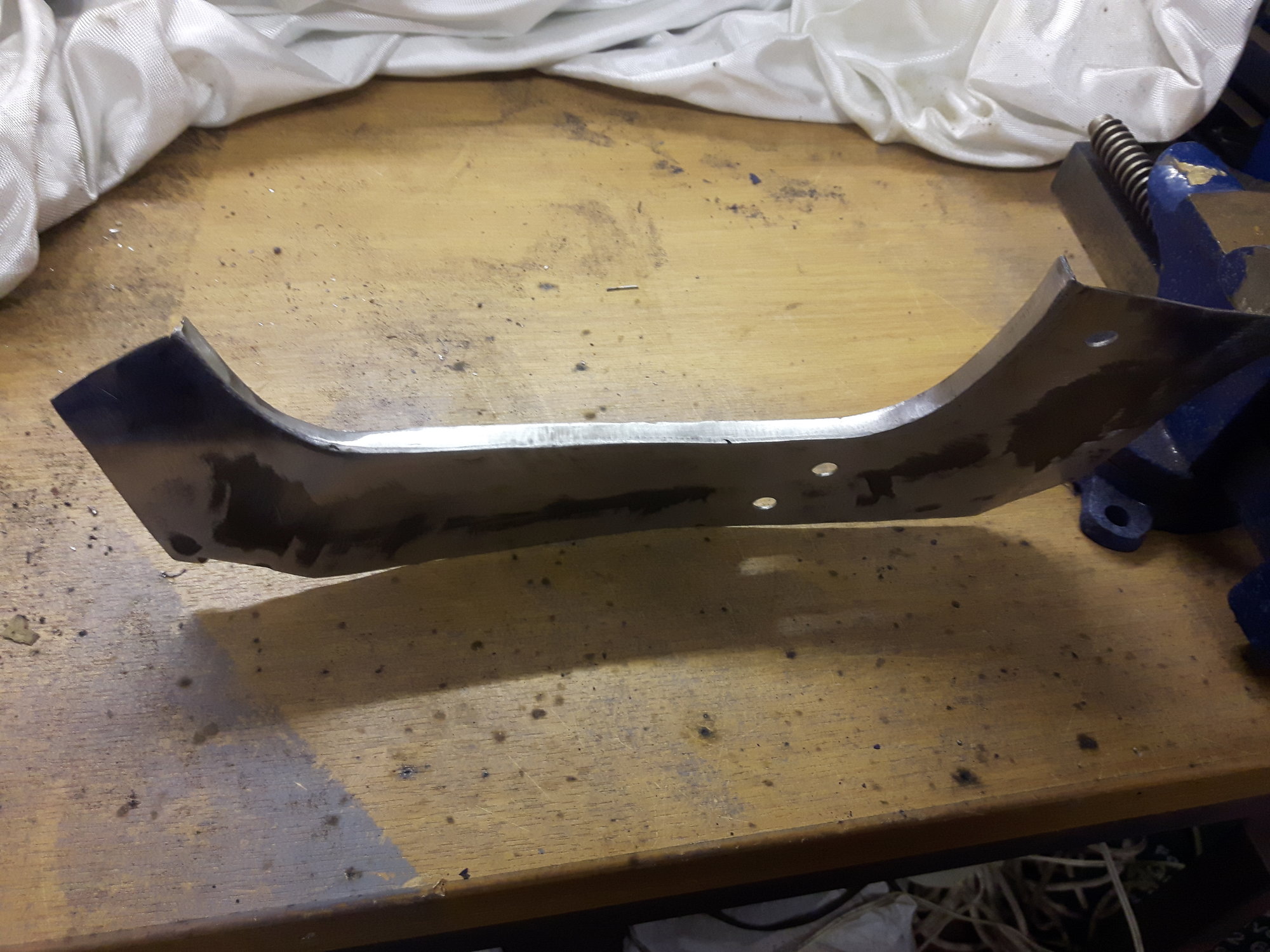

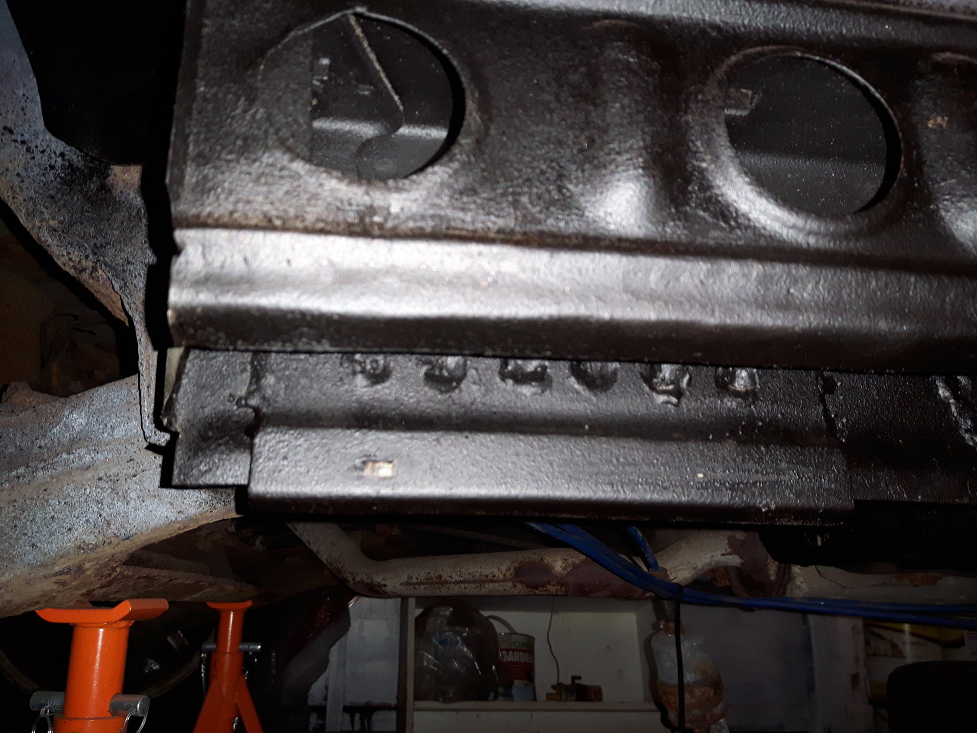

    The front corner of the chassis leg was rotten so made one of those up.
    The back end of the sill and wheel arch were non existent....
    A lot of mig wire, hammering and beer later....

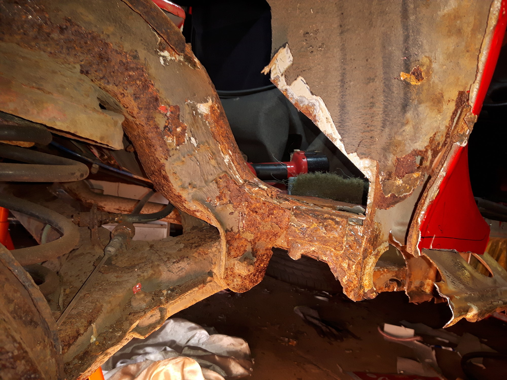

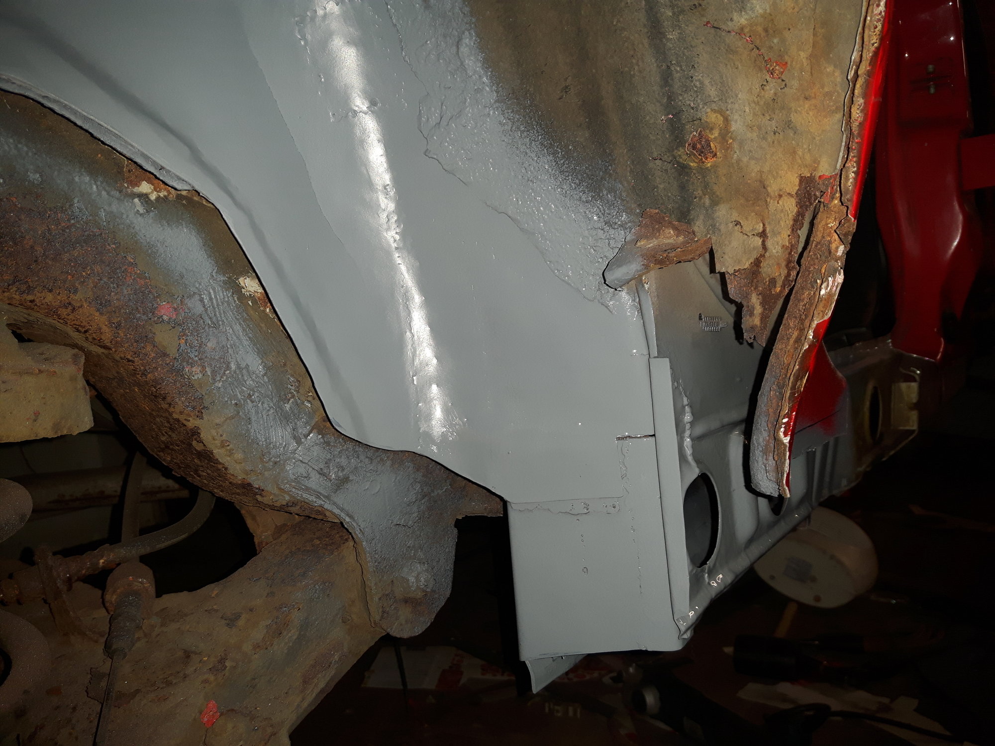

    The inside of the wheel well was a mess and the seat belt was anchored to nothing.....
    But again, beer and wire fixed that too....
    I'm quite proud of the wheel well, especially since it had to be made from a few different parts as I don't have the tooling to make something as curved as that. It looks like one piece.

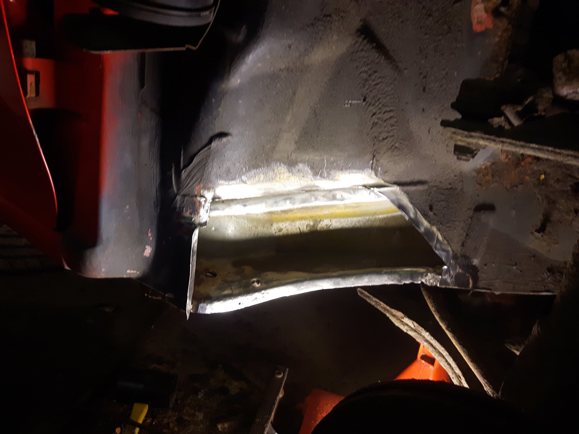

    The inner structure of the sill was gone too, again sheet metal, bench grinder and hammers fixed that..
    Finally put the new sill on and for a pattern part it wasn't a bad fit but did have a joggle missing at the front for the wing to recess in to.
    The welds look quite smooth too..they're a bit scratched looking as I only had 60 grit belts for my linisher.....
    All in all though it worked out pretty nice. It's given me a little more confidence to tackle the more difficult stuff.....
    As you can see the wing sat out a bit because of the missing joggle but I cut it and reshaped it and it sits quite nicely now.
