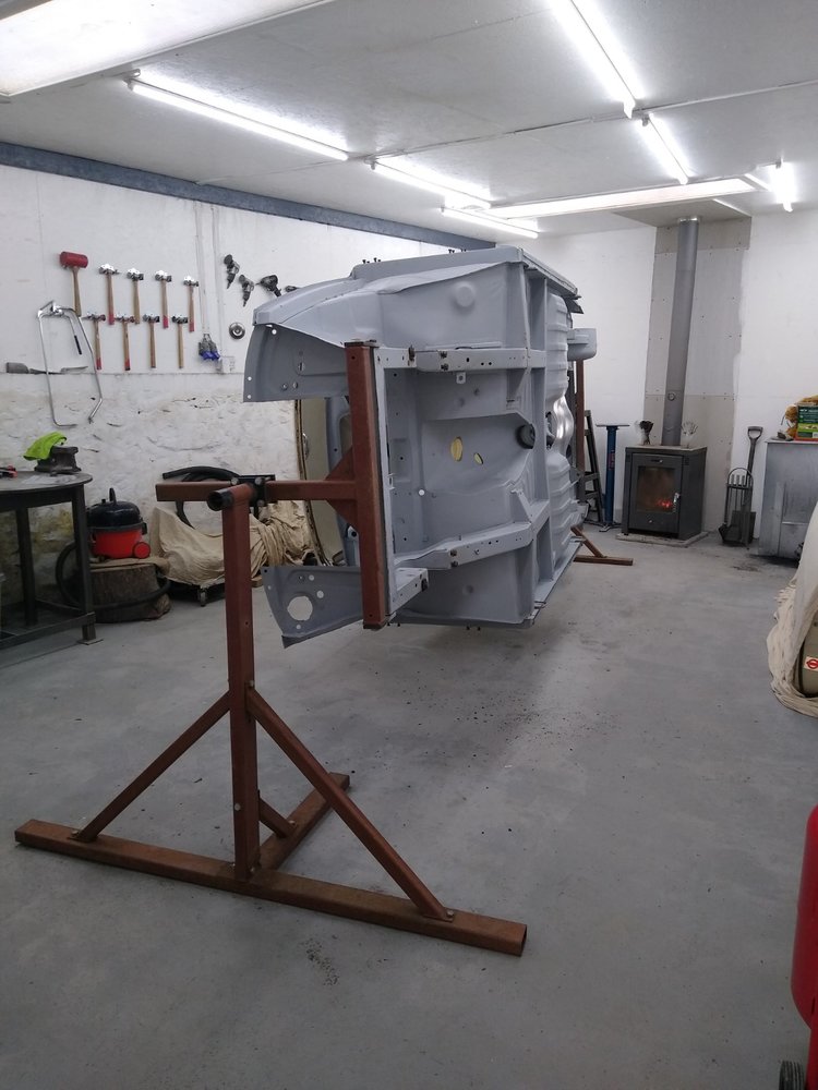

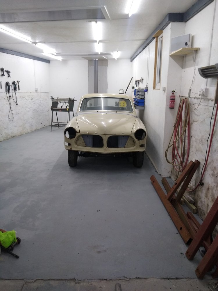

Looks fantastic, one day, one day, I keep telling myself.
Thanks.Very nice work area and love that rotisarre !

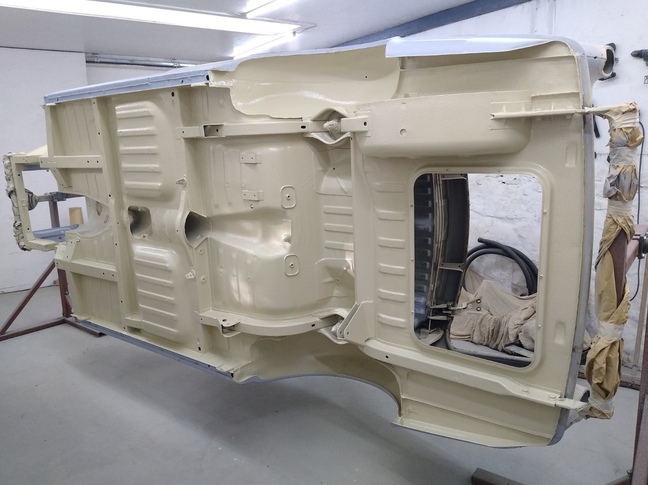

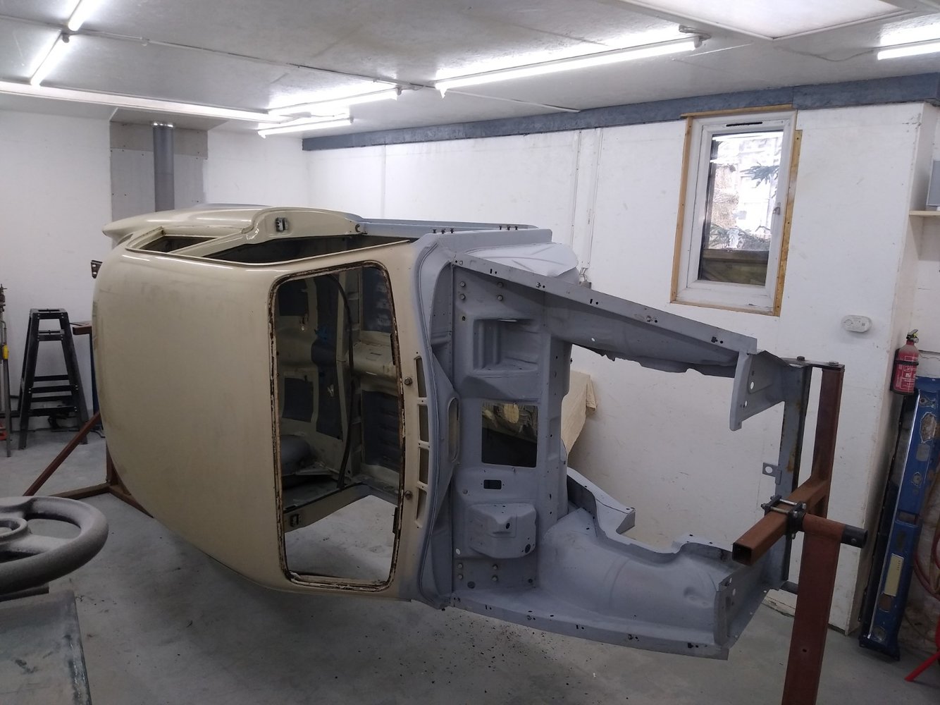

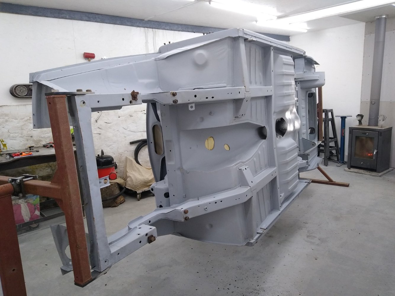

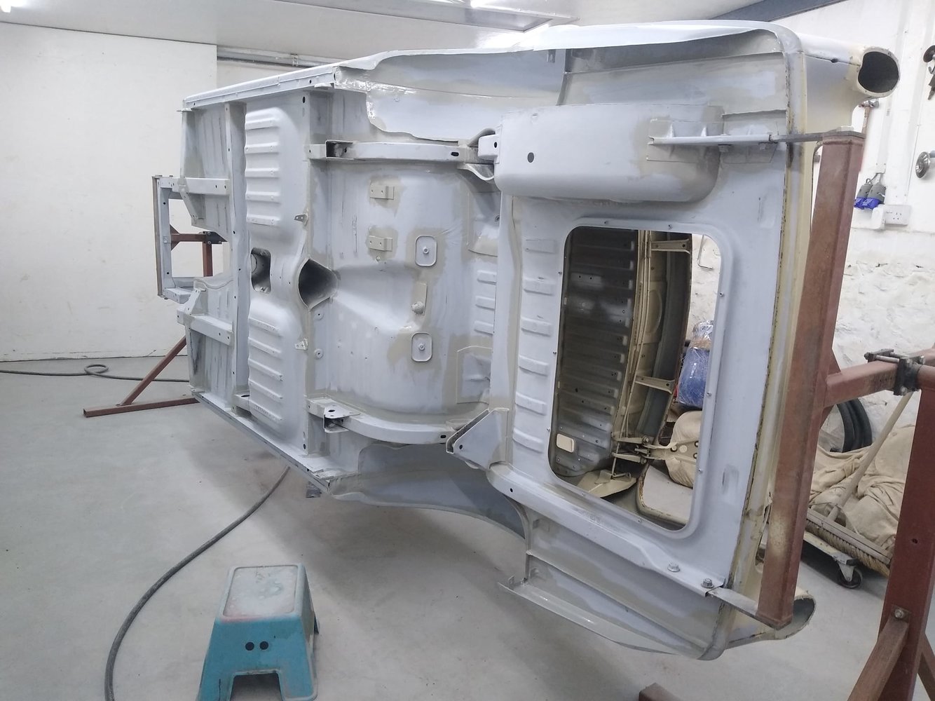

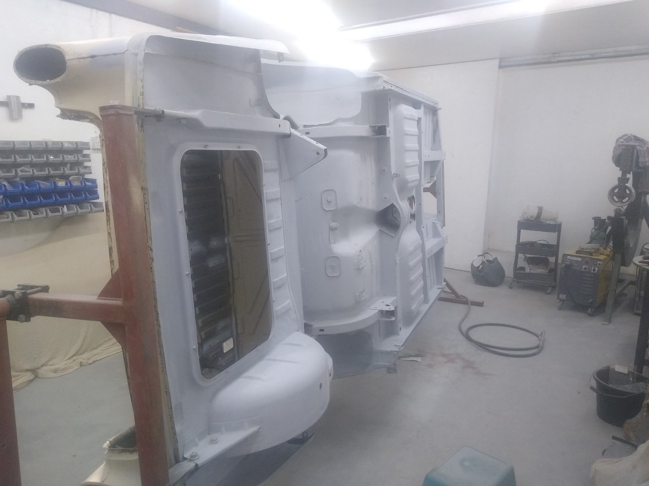

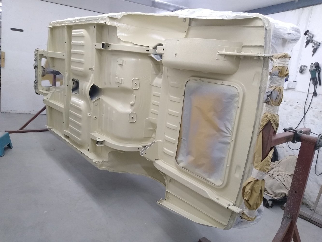

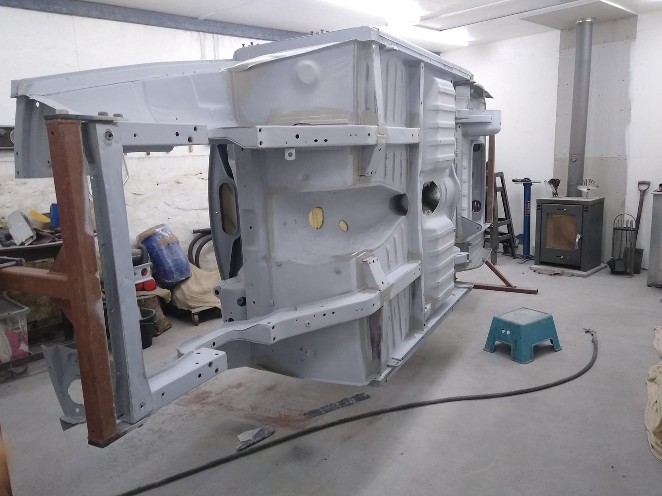

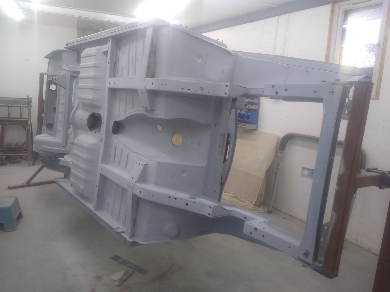

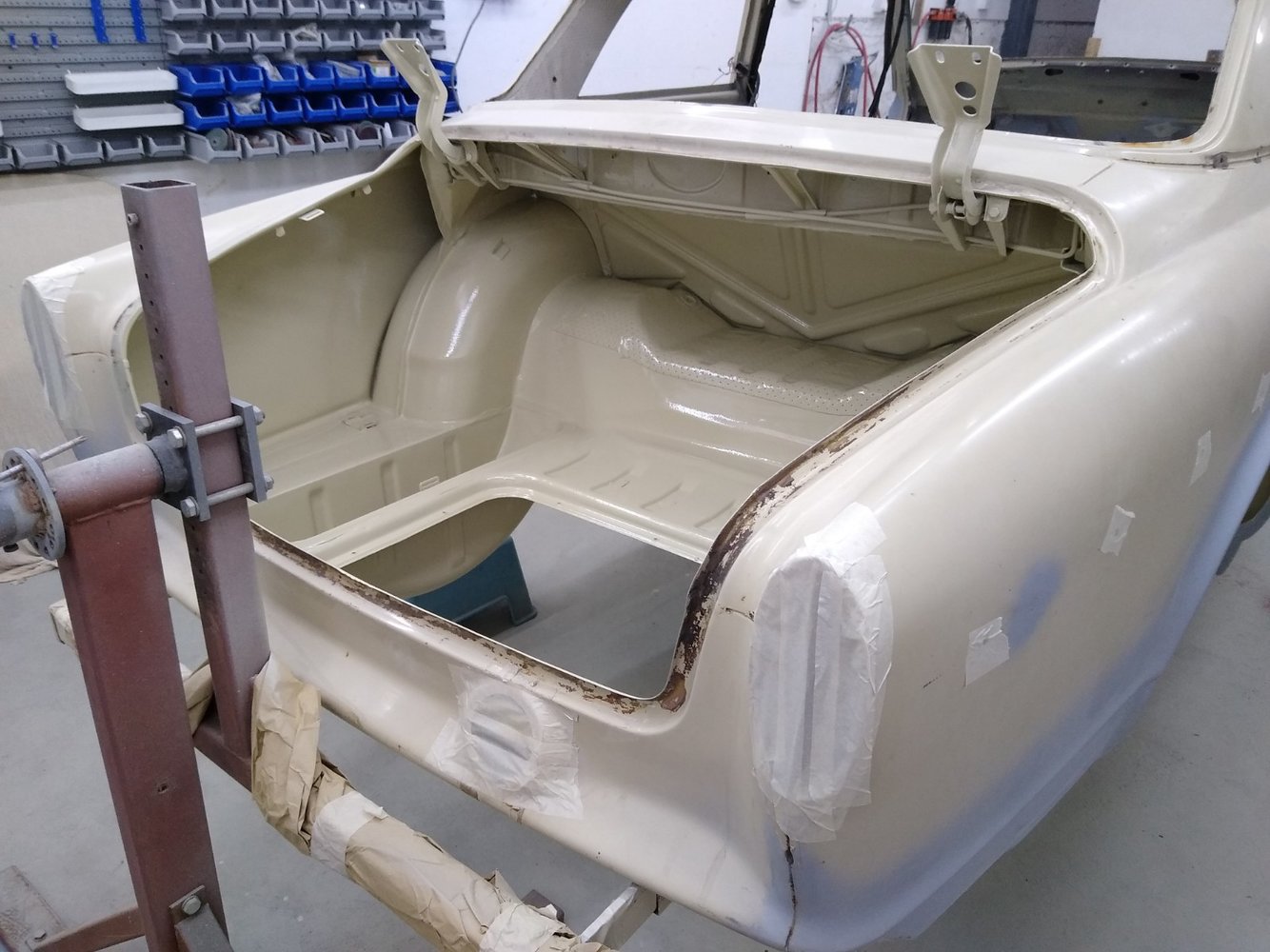

The RX8 in the pic underside was all cleaned and painted crawling underneath with all the ****e falling directly on you real character building but it never went bare shell like this just the underside with axles , tanks , dropped etc.

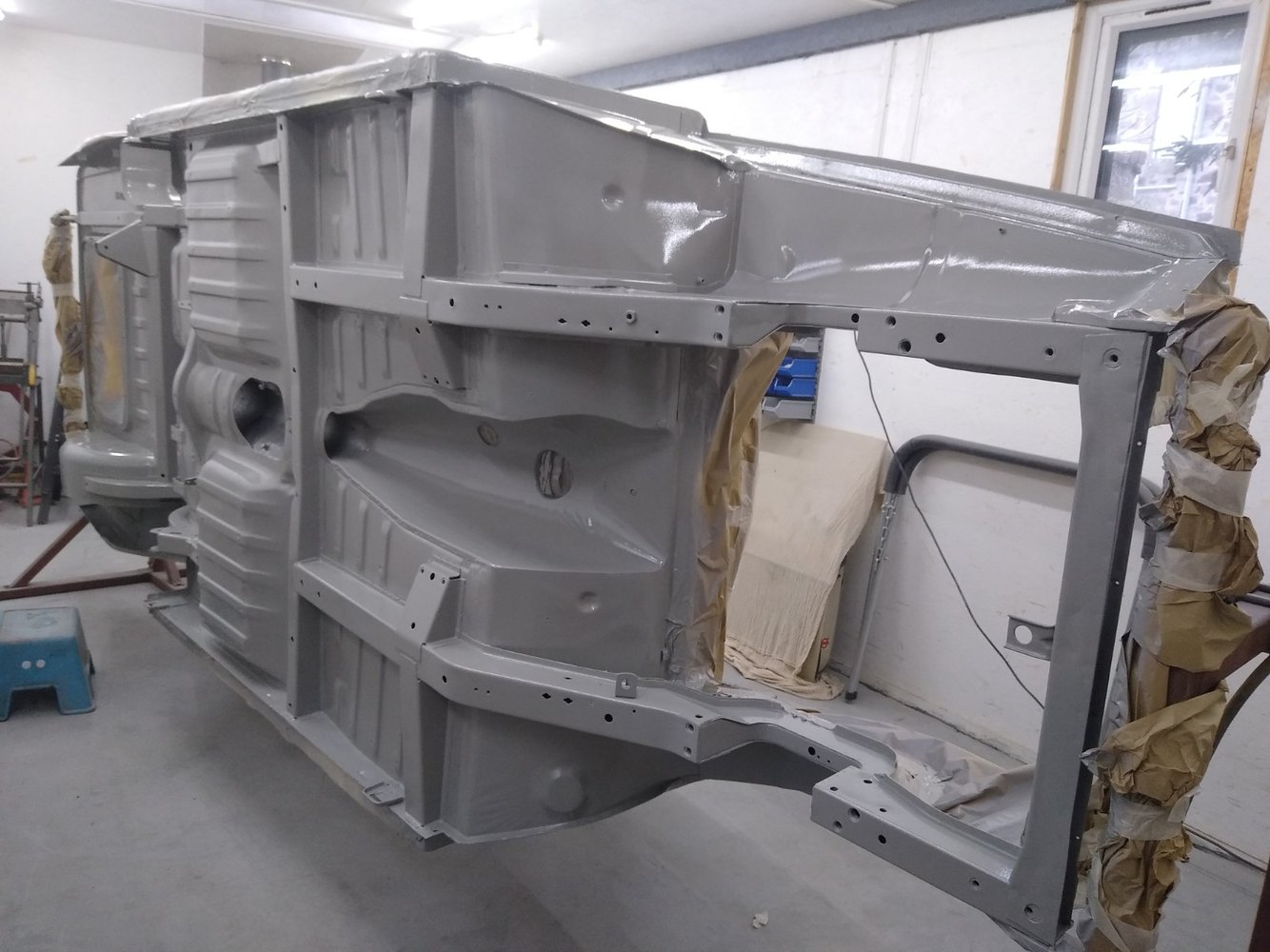

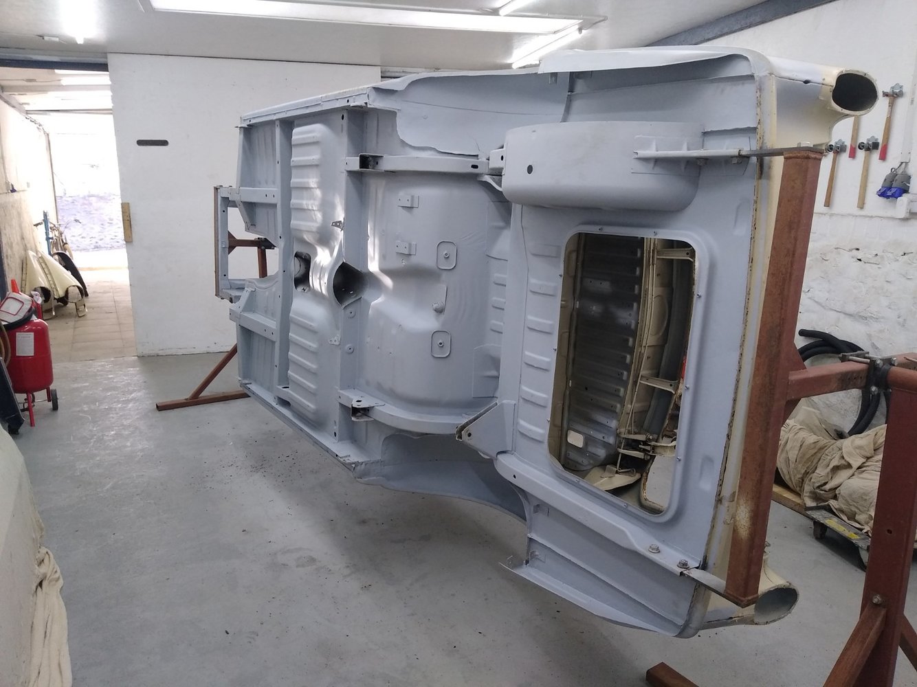

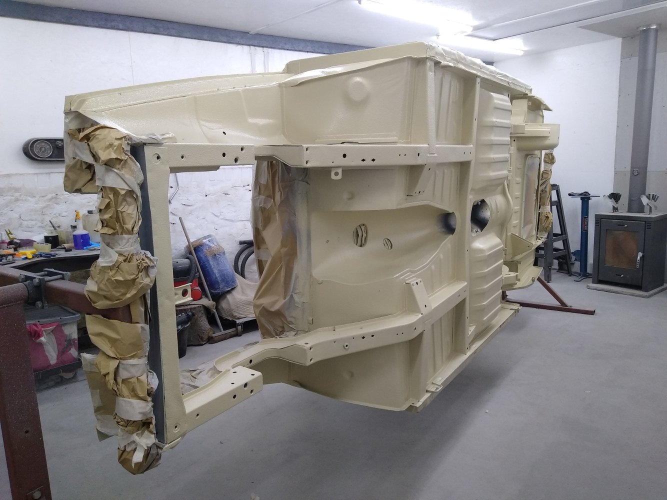

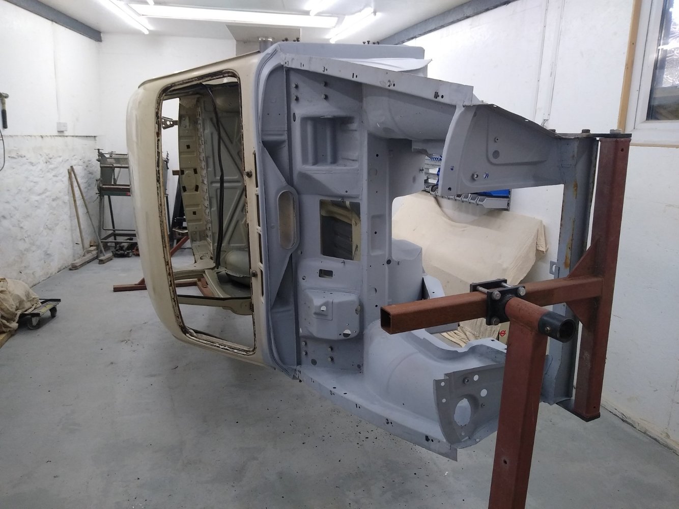

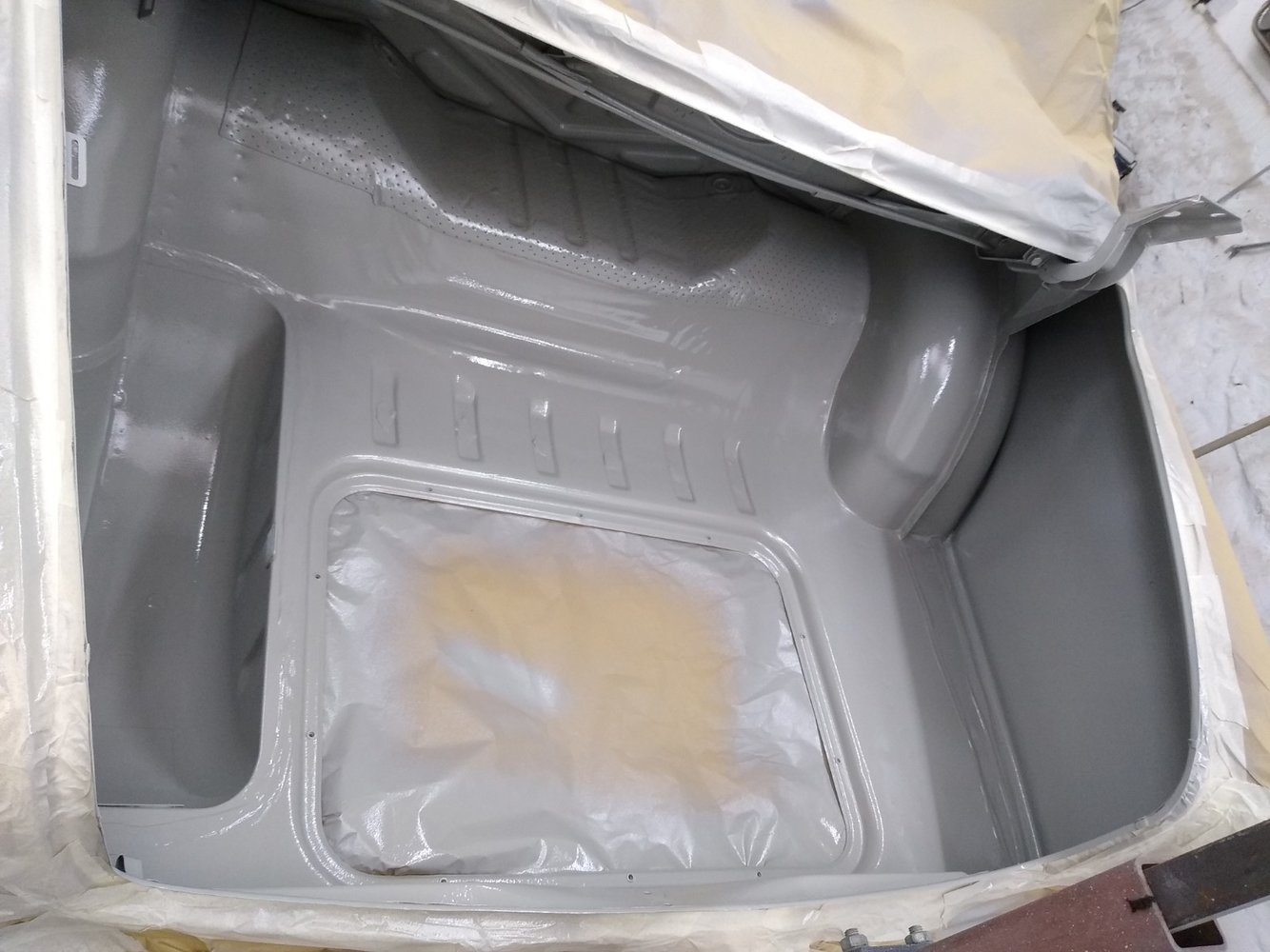

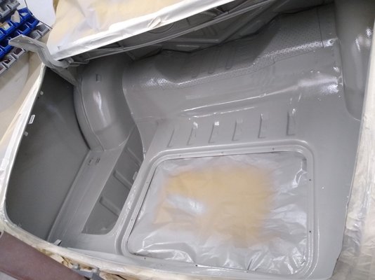

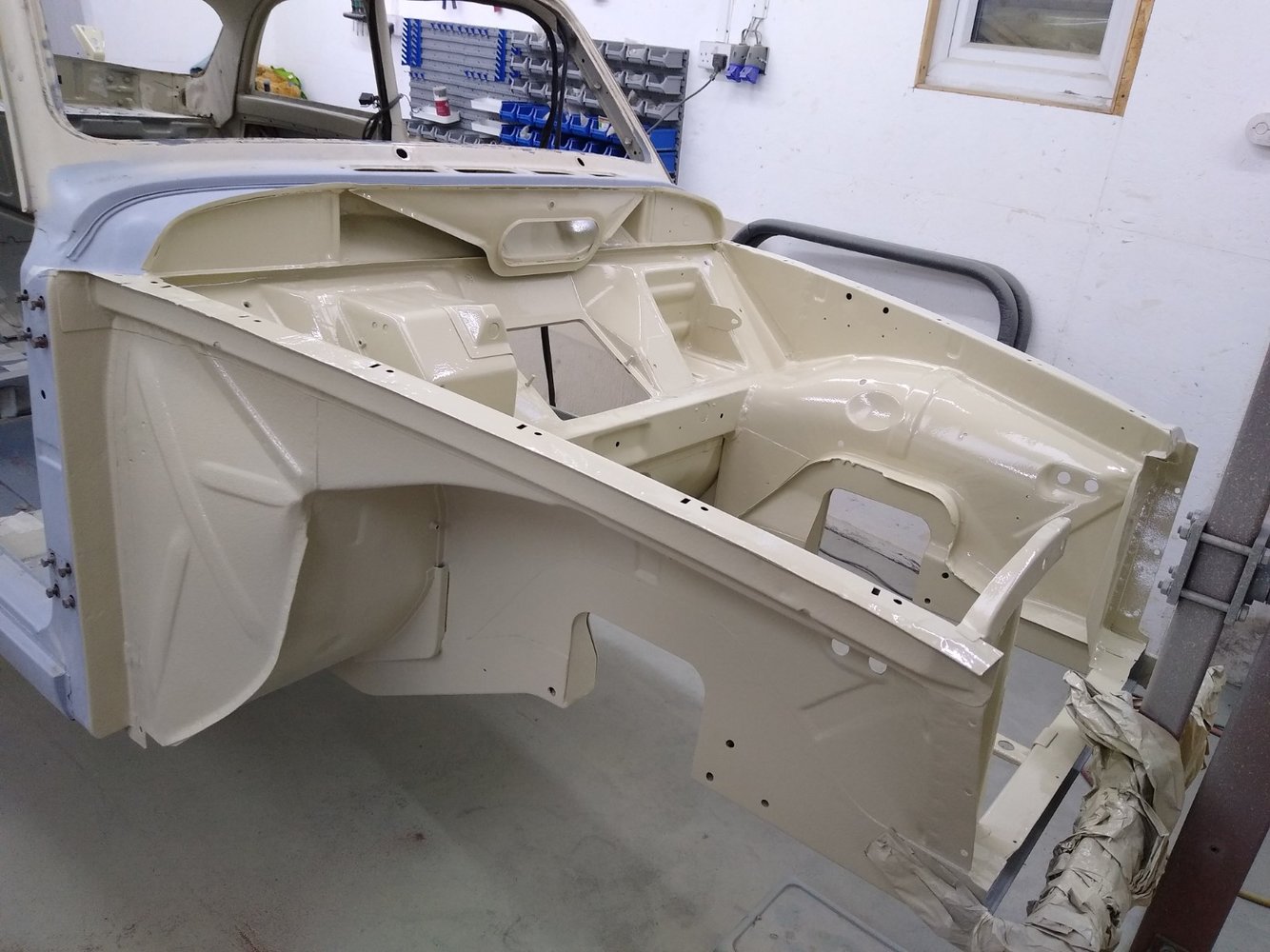

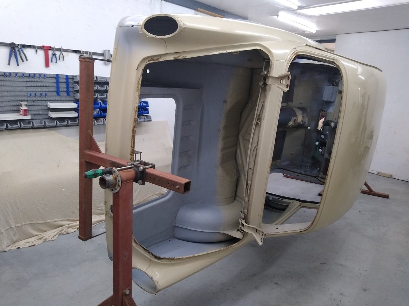

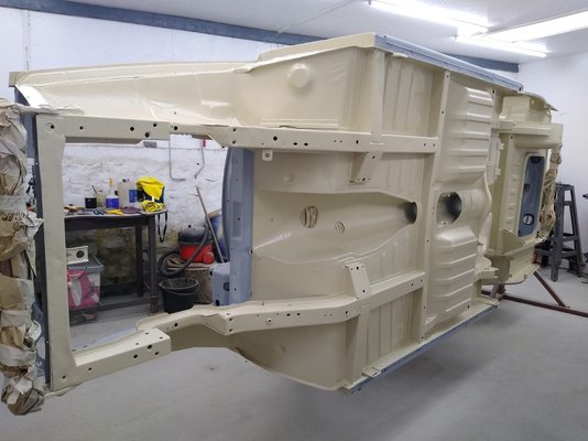

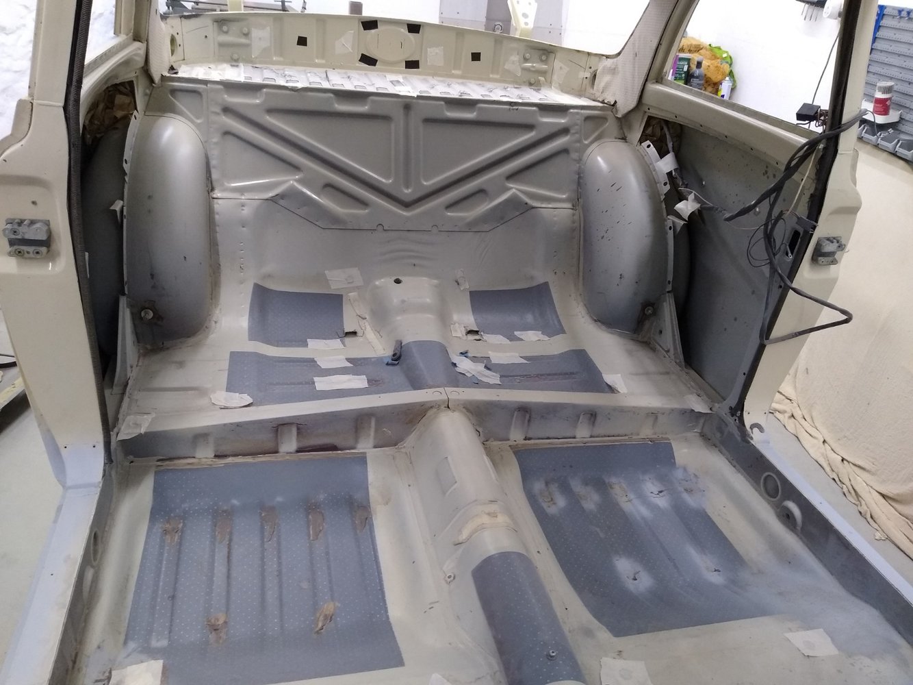

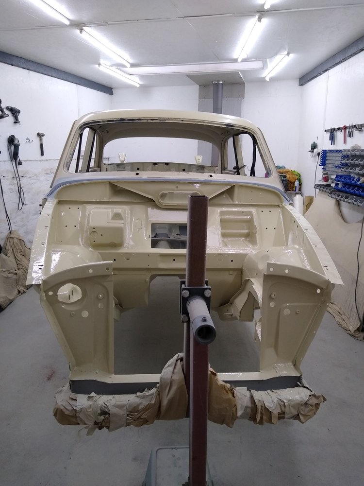

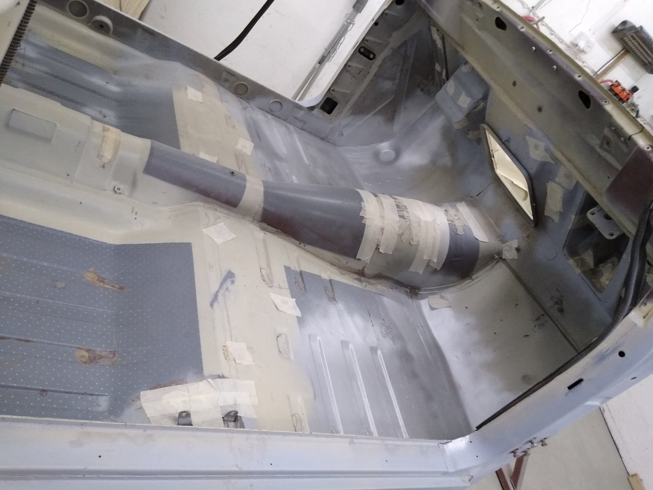

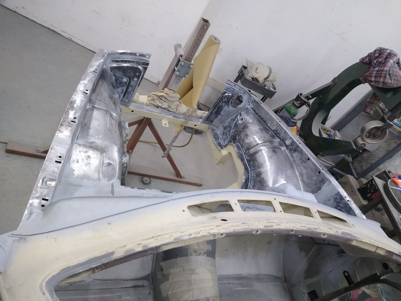

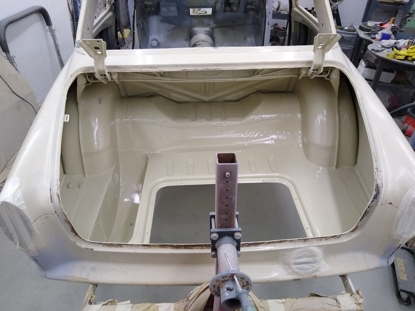

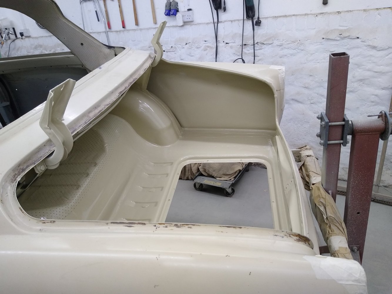

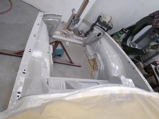

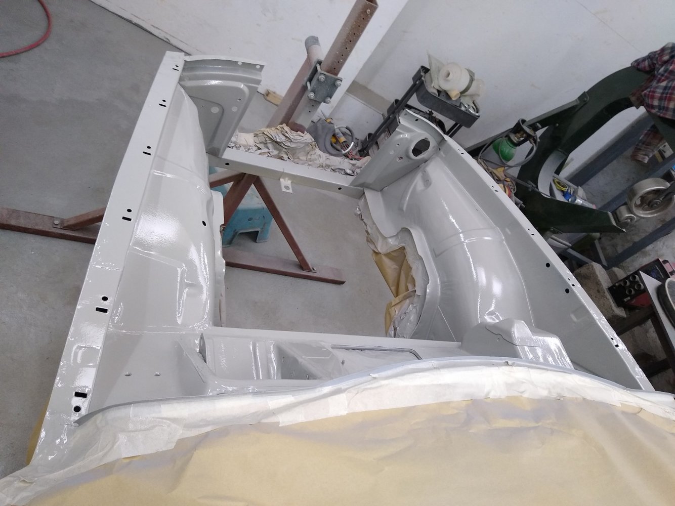

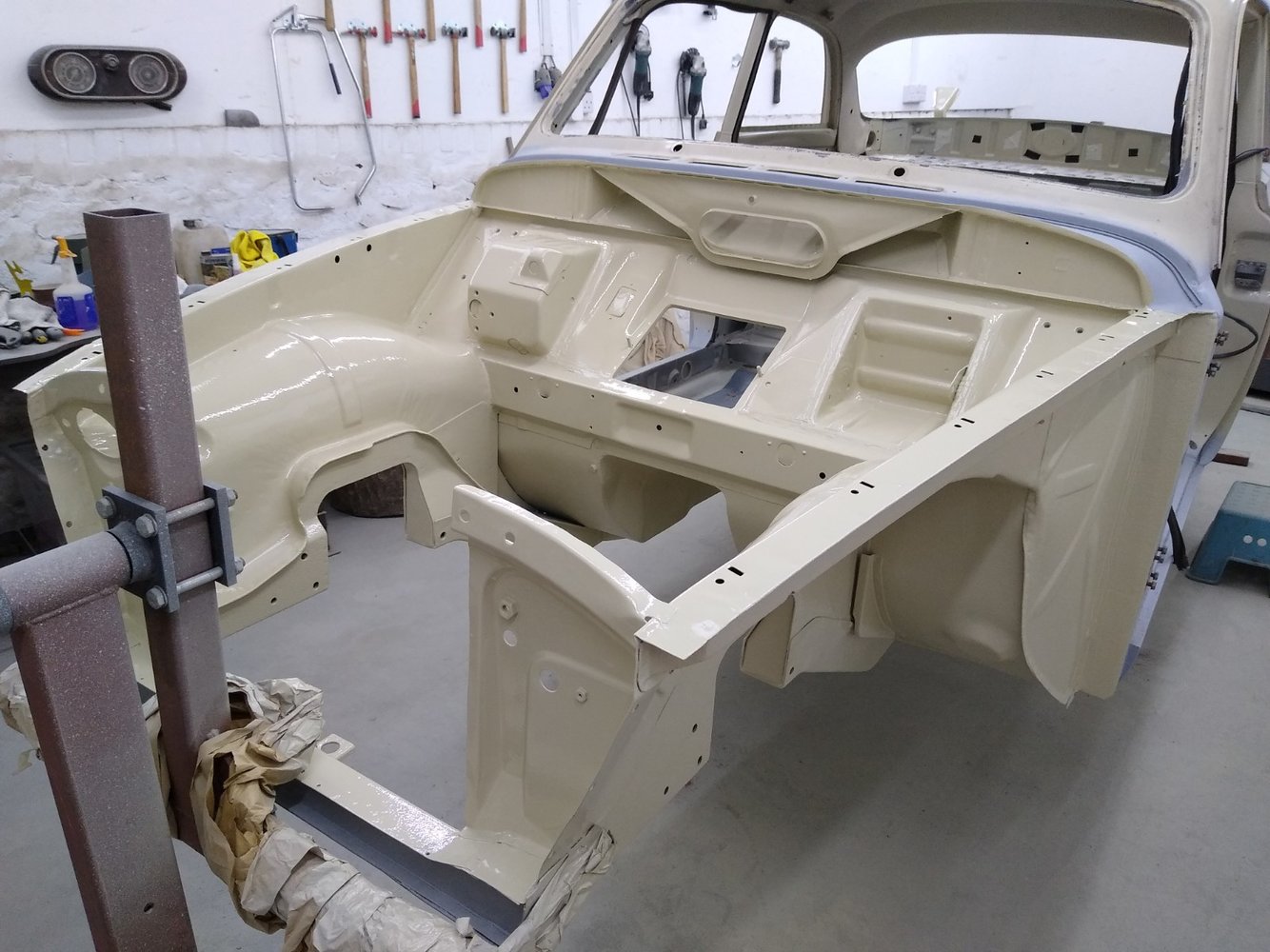

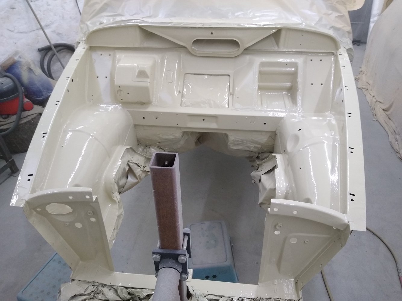

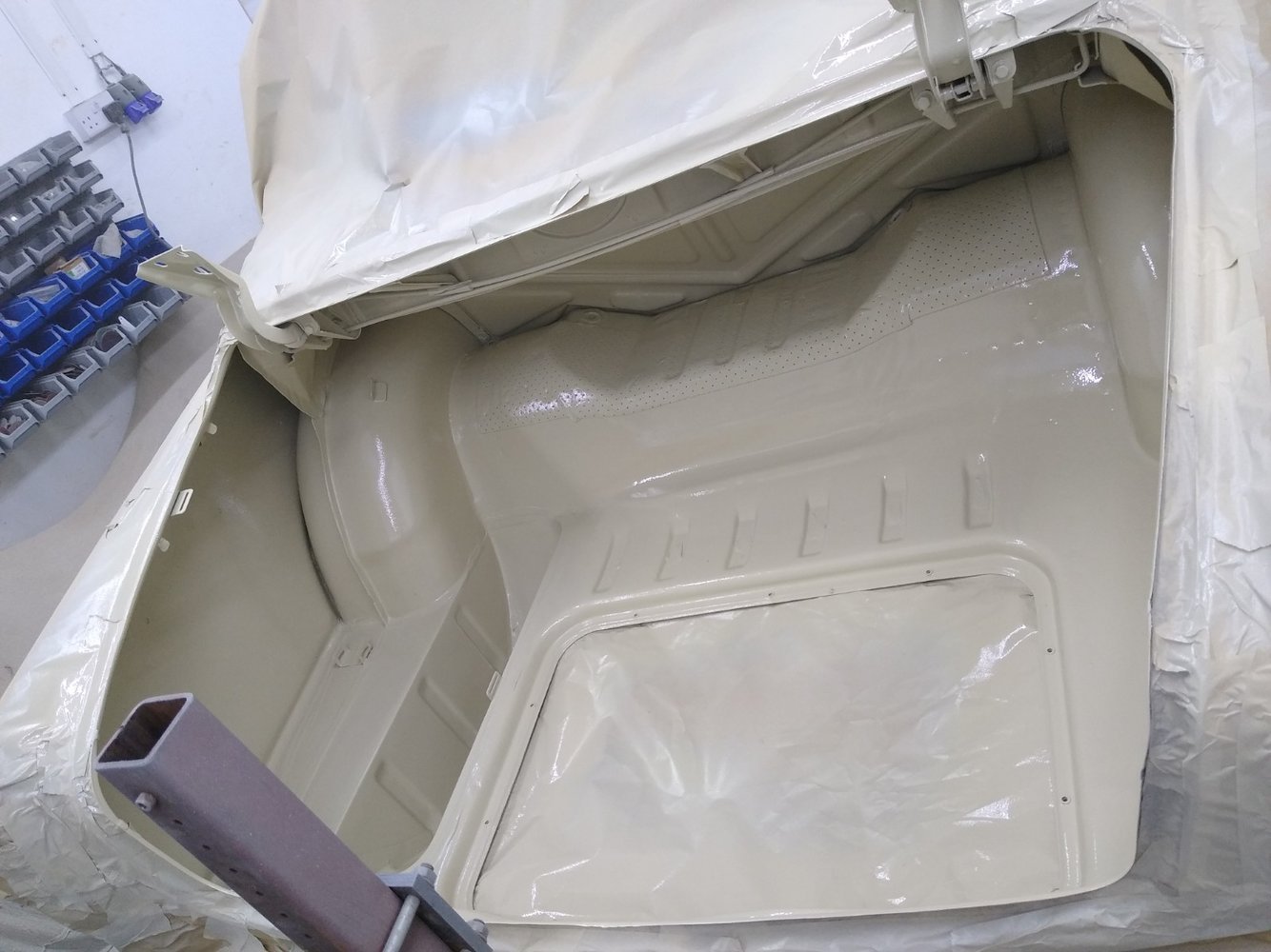

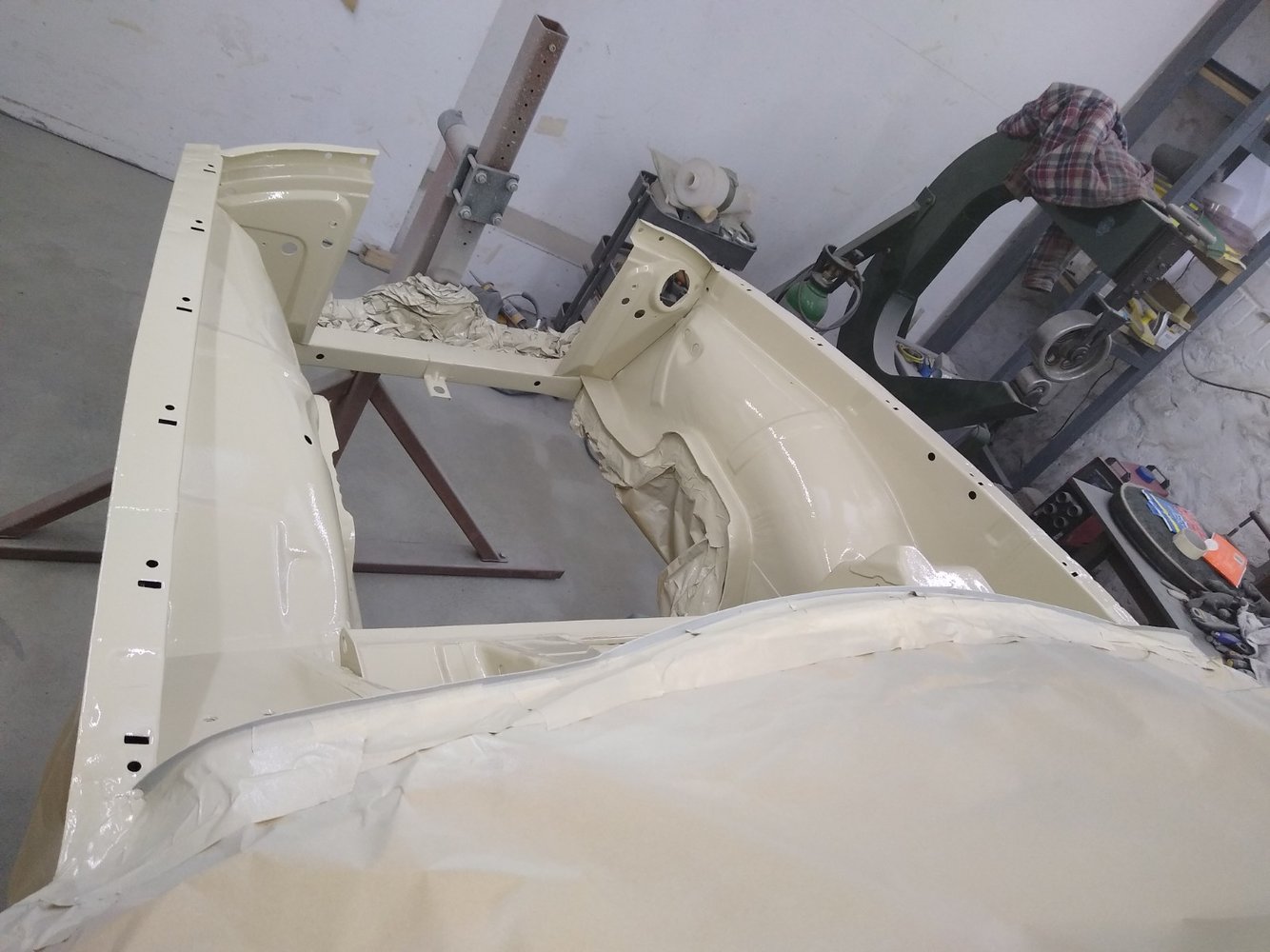

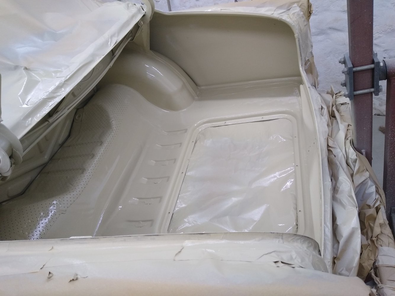

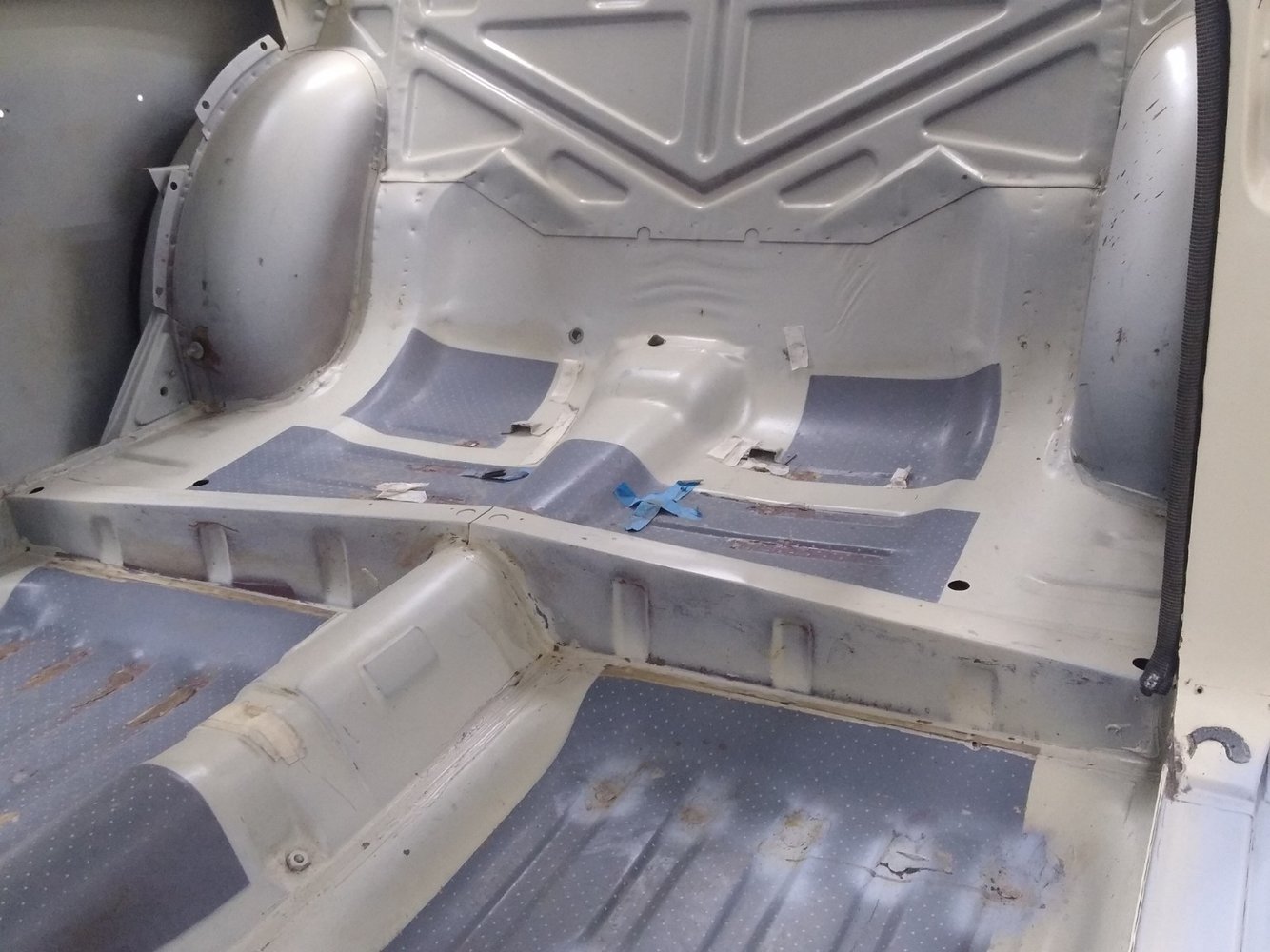

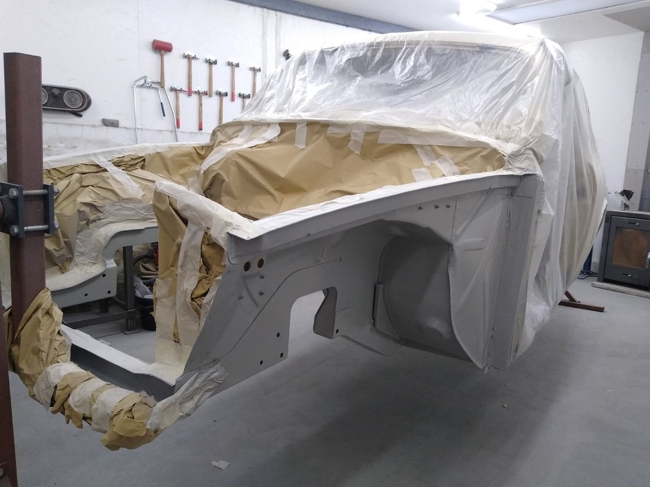

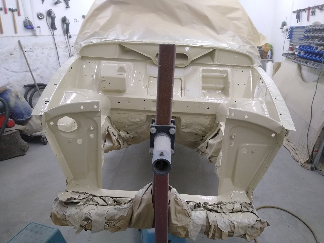

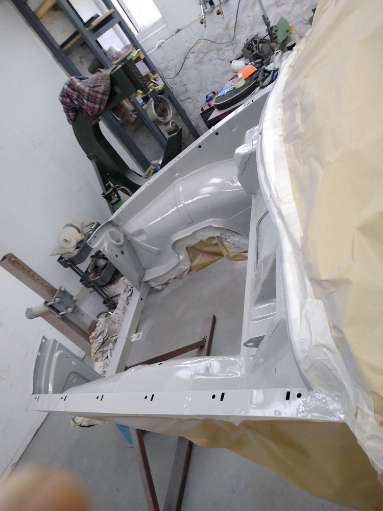

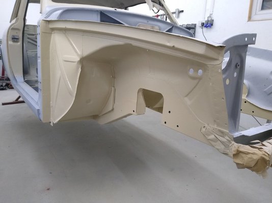

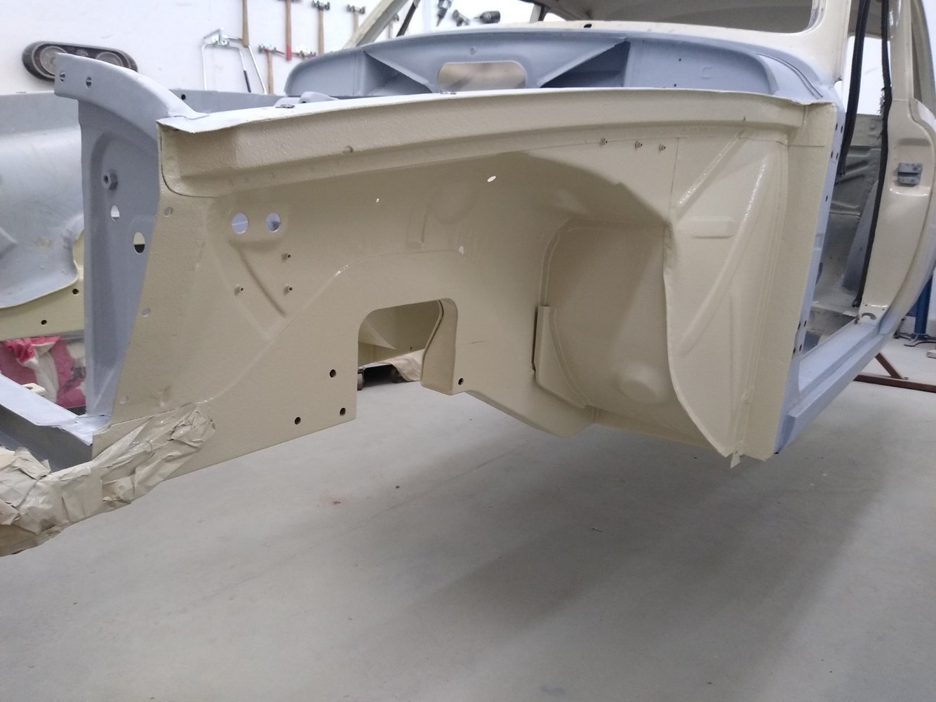

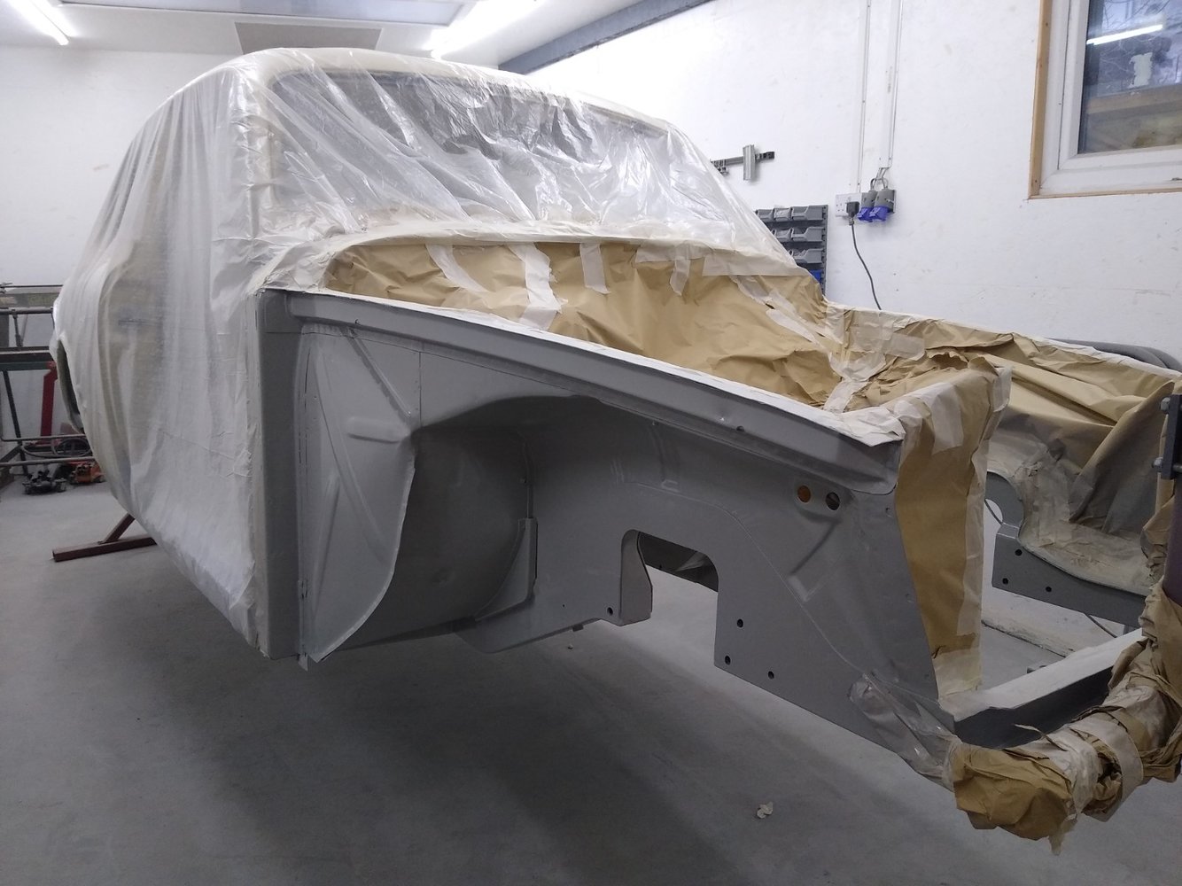

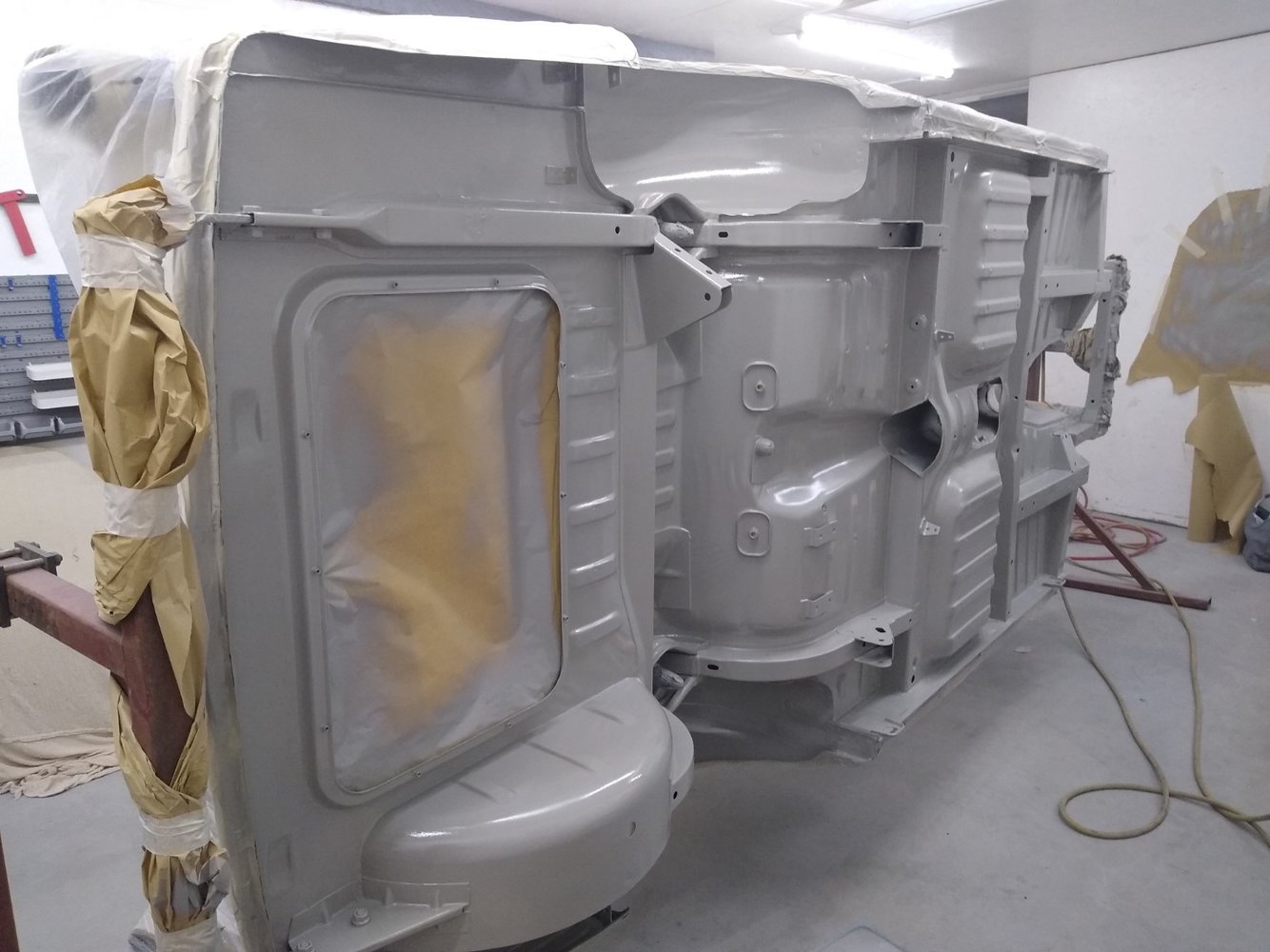

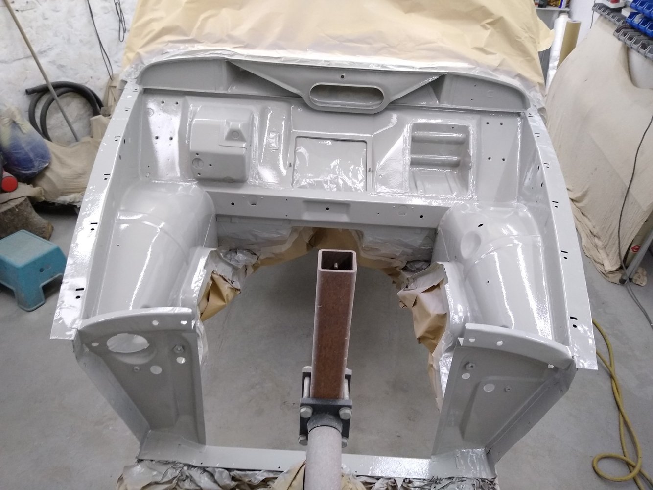

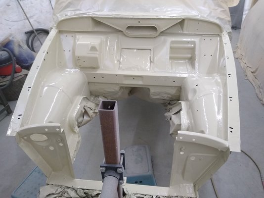

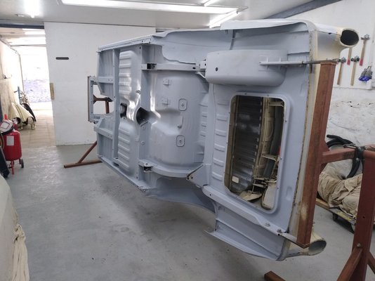

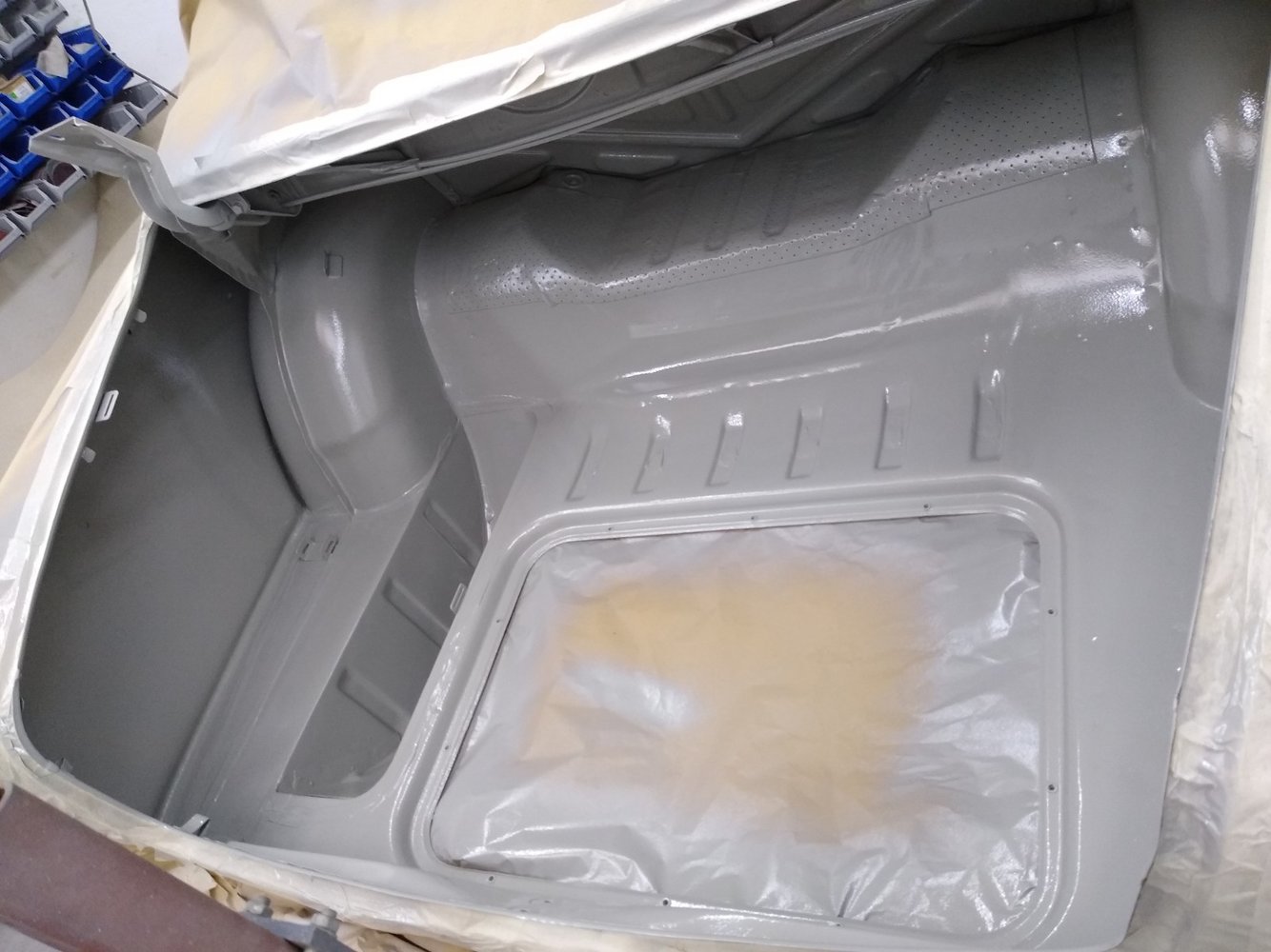

Looking fantastic and great work. What epoxy did you use ? And what was the window before you applied your raptor please ?Got the epoxy primer on today, Raptor Stonechip next.
View attachment 337438 View attachment 337439 View attachment 337440 View attachment 337441 View attachment 337442 View attachment 337443 View attachment 337444
Jotamastic 80 WG and 24hrs but that's just how it worked out. Main thing is get it on before epoxy is cured and after the epoxy has flashed off nicely. So anywhere from 1hr to a few days should be good. I have good heating in the workshop so coatings dry well.Looking fantastic and great work. What epoxy did you use ? And what was the window before you applied your raptor please ?
