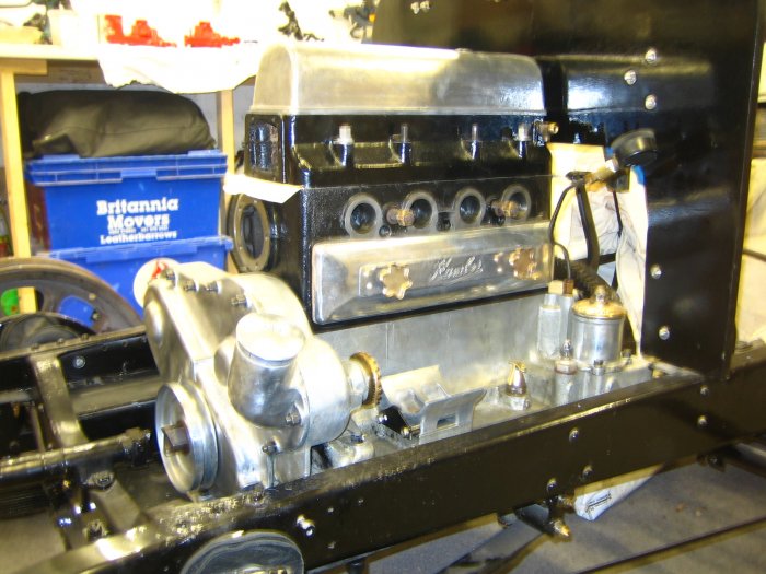

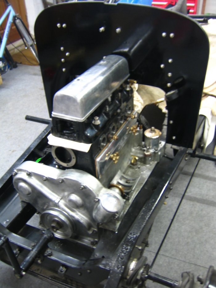

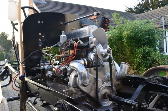

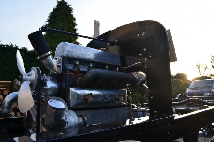

It actually looks like a pretty good design, the inlet goes straight above the piston and both valves can be a lot bigger than in a pure OHV or side valve design.
IIRC they called it single side valve. Rover did indeed use that layout.
I've seen it called Inlet Over Exhaust(IOE) also.
