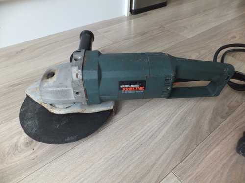

Then, continuing my mission of trying to actually finish some jobs I determined to finish cutting the large bit of rail track into two smaller bits. This is where it went a bit south. My pal realised something was up when all the sparks were going skywards, he came over explaining the grinder should be going the other way, go on then, have a go:
As yiu can see, he had to press the trigger with his thumb, it really could do with being turned 180 degrees to have the trigger in the proper orientation. If anyone has any suggestions I would welcome them. Meanwhile, finished the job so result anyway.
Aye looks like that is what has happened, someone has had the gearbox off and put it back 90 degrees out .Does the gearbox have 4 screws you can remove them rotate it
