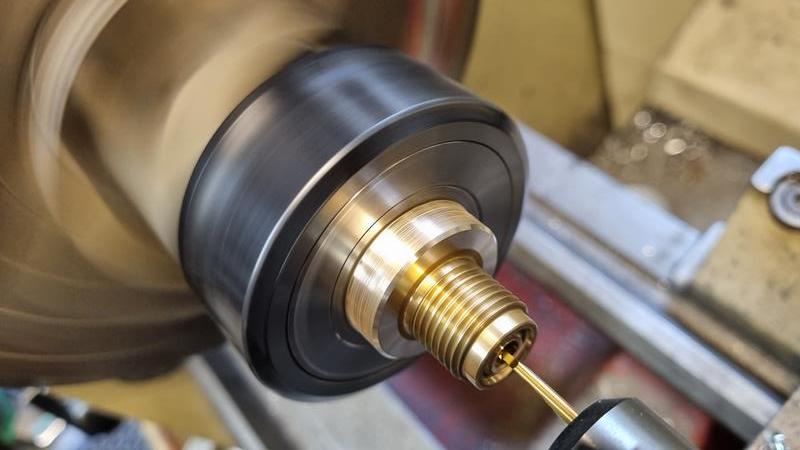

What is it going to be?Well, I got stuck in, had my Weetabix and made a start, Heavy Engineering today, first off, using a 3mm boring bar to clean up a pressure cylinder valve unit:

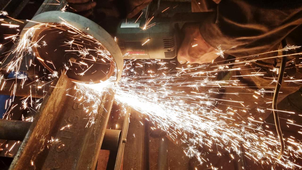

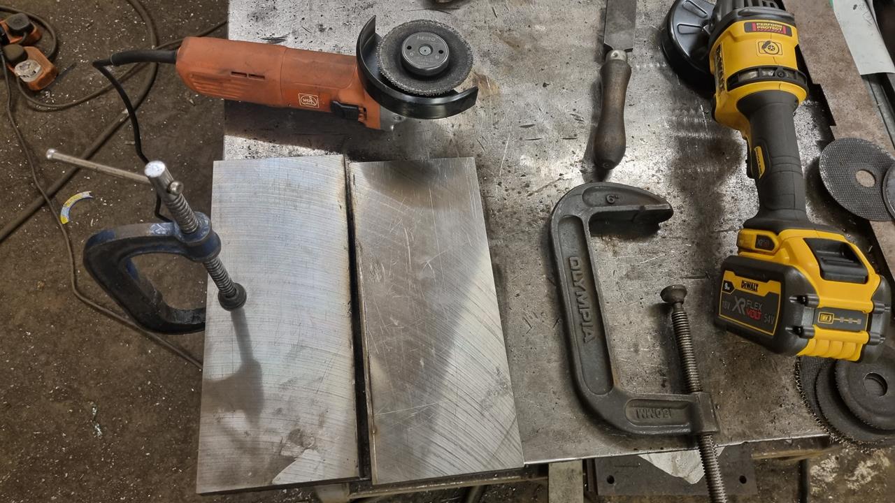

Then I finished an **** of a job, slit a 20mm Titanium plate up the middle. Going to look for a GOOD dust mask in a minute as the dust and fumes were awful and I have more to do tomorrow. At first I thought "crikey, it is going through this quick" as the angle grinder sank downover, until I realised it was just eating disks:
Needed the Fein 240 volt tool to finish off as the battery gave in on the heavy Dewalt:

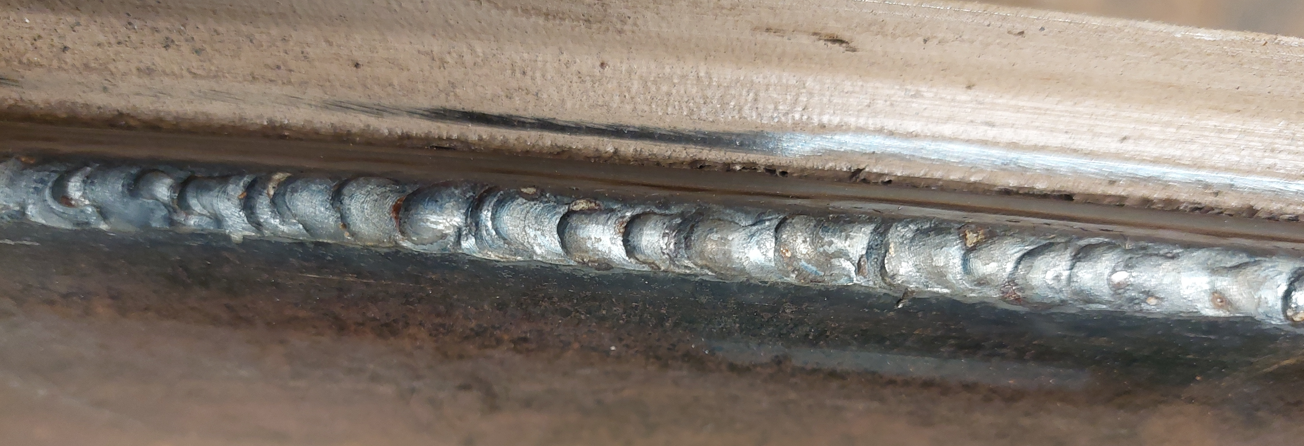

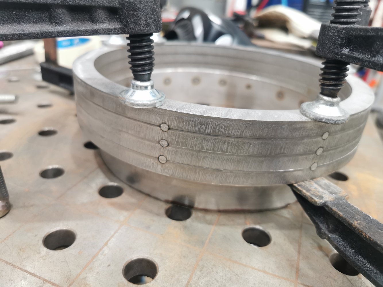

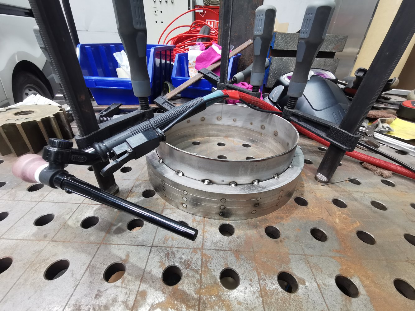

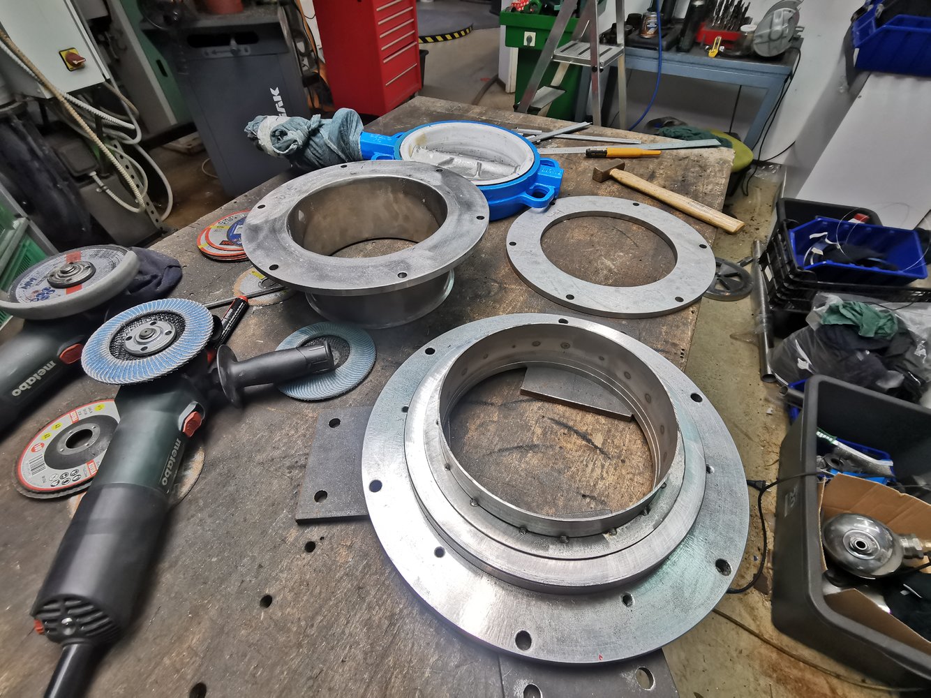

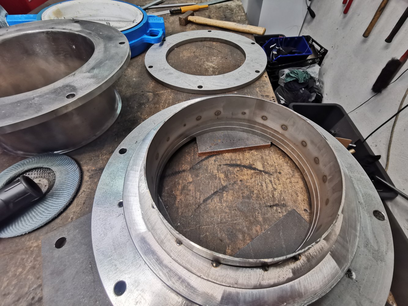

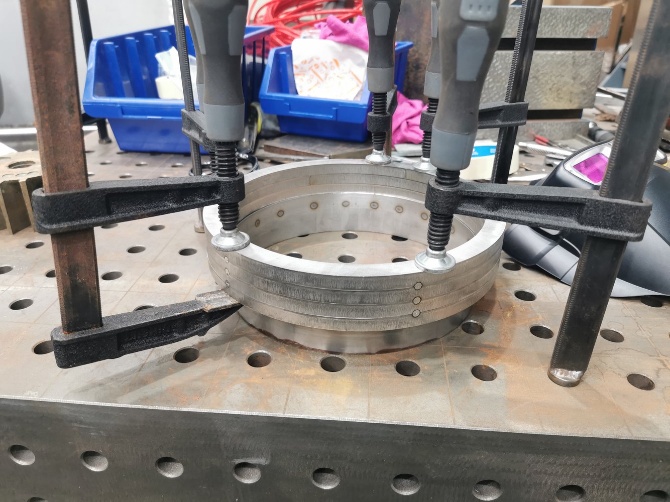

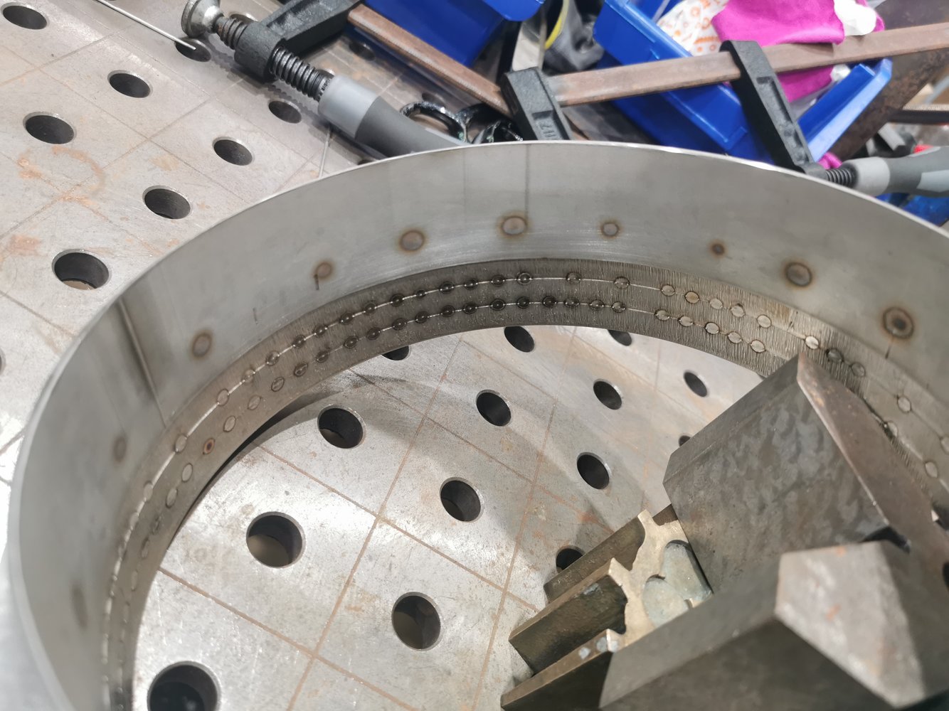

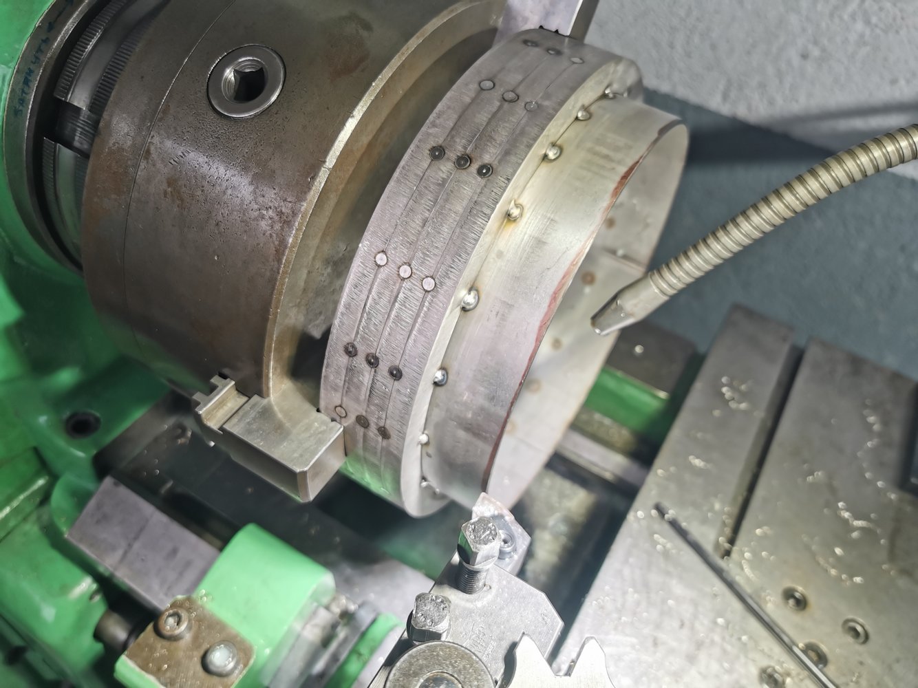

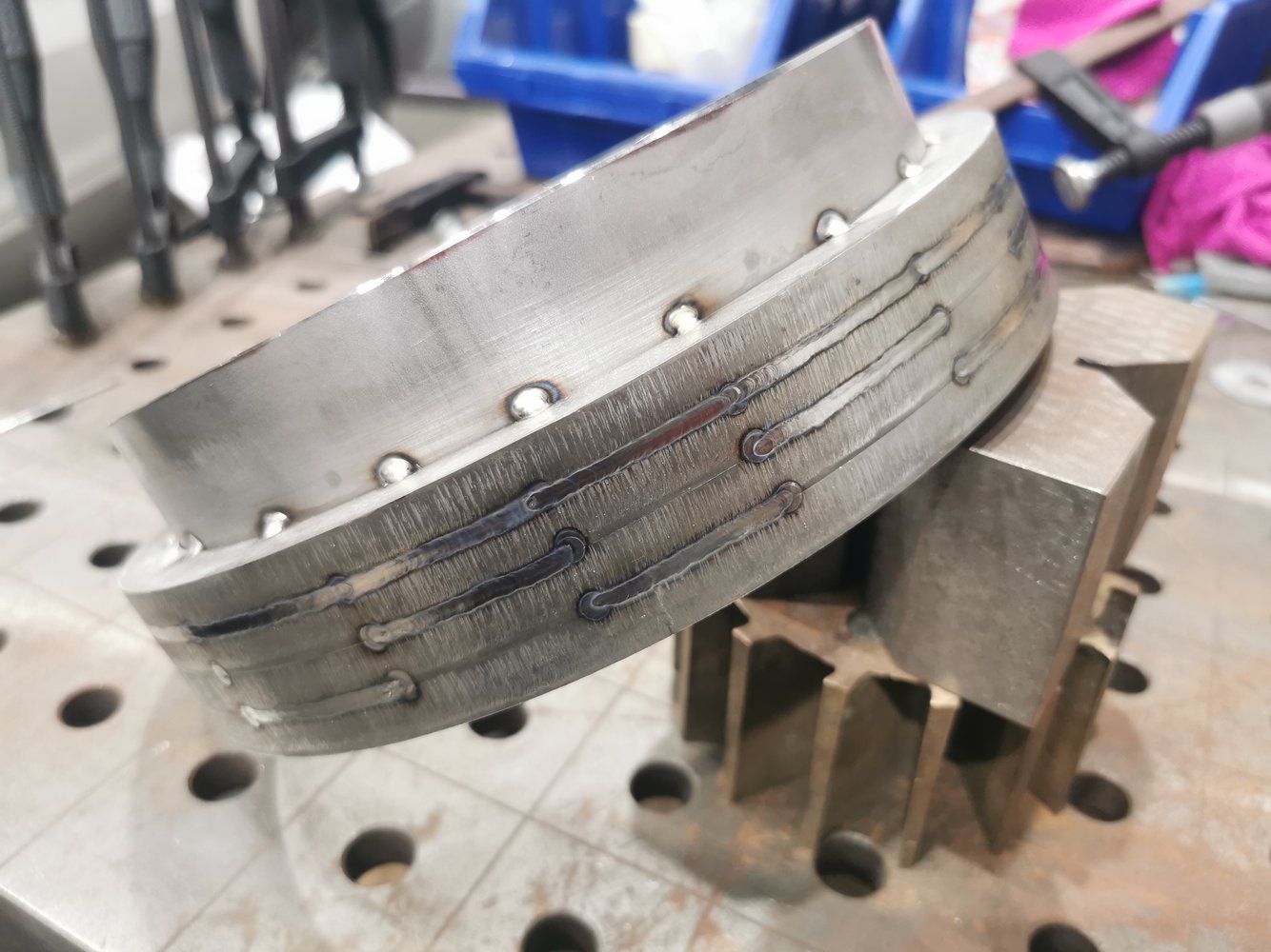

Parts #2Matryoshka principle: reworking the valve, the inner diameter should smoothly change from 225 to 204 mm. Type-setting insert 70 mm high, made of 10 mm thick plates and a pipe section. TIG welding, angle grinder, lathe and laser cutting. Parts #1.
